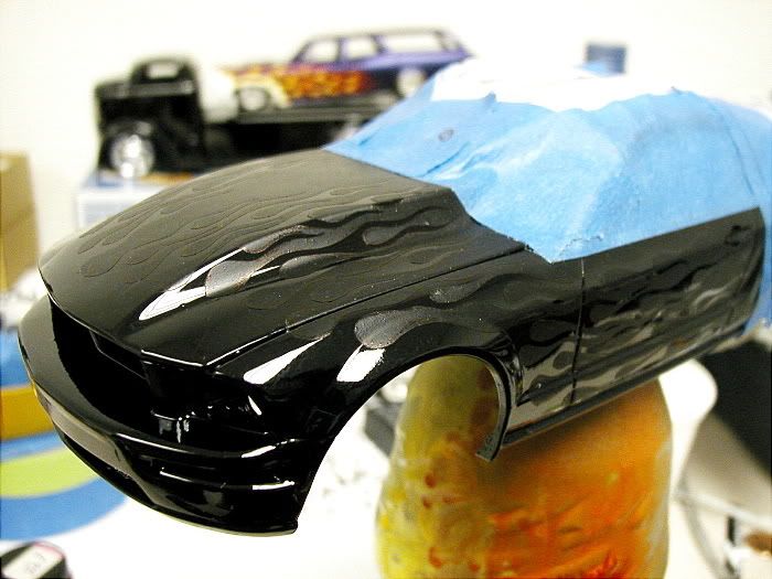

Brian Nehring Posted February 9, 2009 Author Posted February 9, 2009 Another awesome paint job! I would like to know what you use for masking! Jody Thanks Jody, For doing true fire I do not use any masking, I use shields that I've made to get various shapes when I need them but most of what you see here is free hand. When I do my traditional style flames I use a liquid mask that I mix with water to about the consitancy of milk and I shoot it through my airbrush. Dry it with a hair dryer between coats, spray on 6-8 light coats. Draw the pattern on with a sharpie and trim it with an exacto knife. Brian
Smart-Resins Posted February 9, 2009 Posted February 9, 2009 Very cool! Two quick questions, what kind of liquid masking do you use? Second, what do you make your shields out of? I have seen some different ways of doing these true flames done! Eventually I want to be able to! Of course, right now I am still trying to learn how to even use the airbrush! LOL. I am getting decent with alclad, but nothing else so far. Jody

Brian Nehring Posted February 13, 2009 Author Posted February 13, 2009 Very cool! Two quick questions, what kind of liquid masking do you use? Second, what do you make your shields out of? I have seen some different ways of doing these true flames done! Eventually I want to be able to! Of course, right now I am still trying to learn how to even use the airbrush! LOL. I am getting decent with alclad, but nothing else so far. Jody I use a liquid mask made by Hobbico that I get form my local hobby shop, you can get a similiar product from Micro Mark called Mask-it. The shields I use I made from some transparent plastic that I got from Hobby Lobby, it's the same material that paint stencils are made from. You can also use card stock, I've even made them from subscription cards from magazines, you just cut them in various shapes with different curves. Thanks Brian

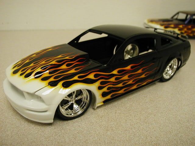

Casey Posted February 13, 2009 Posted February 13, 2009 Those are truly some nice-looking flames, on both the '57 and the late model 'Stang. You've got great talent.
