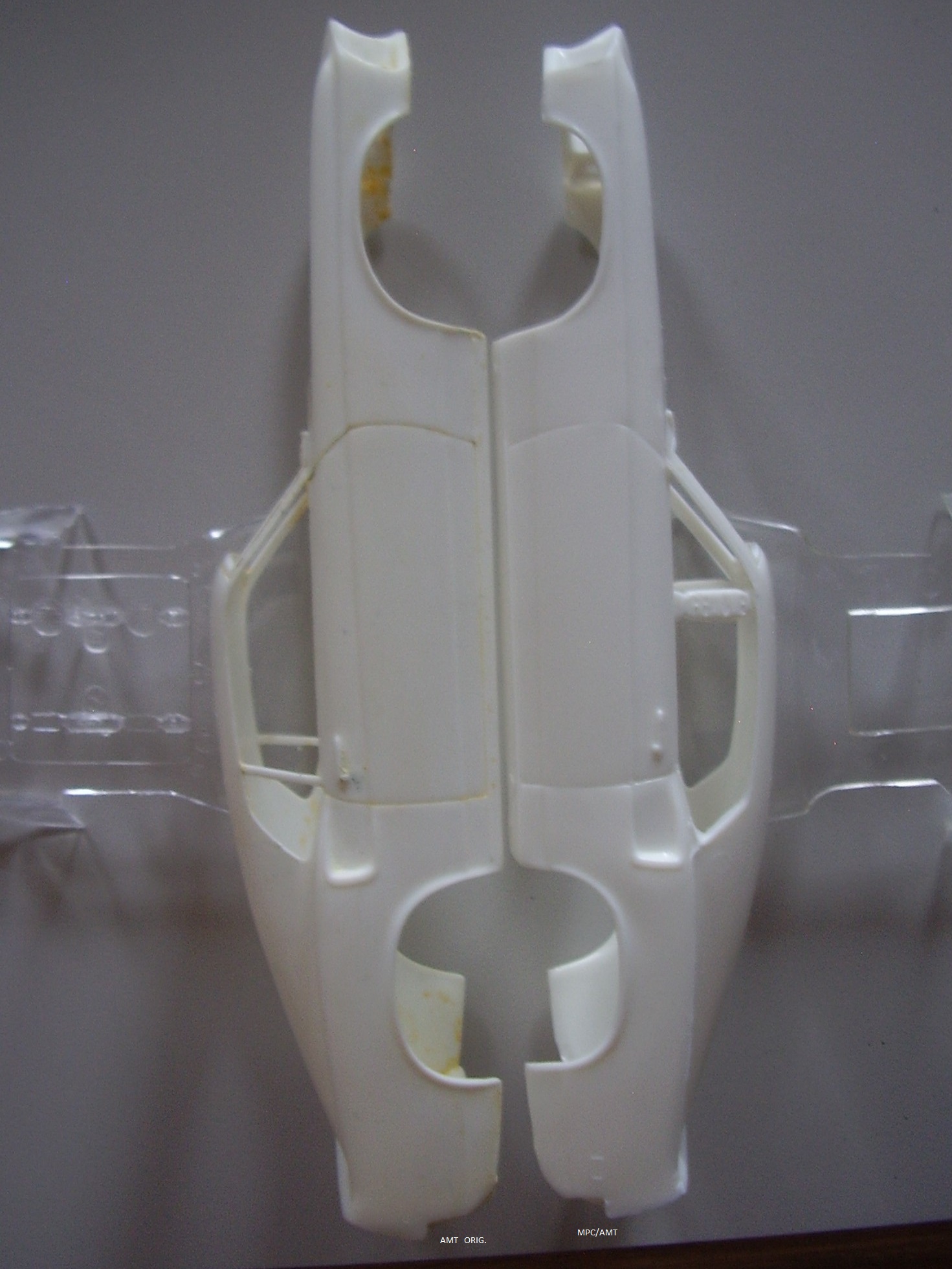

mk11 Posted March 15, 2015 Posted March 15, 2015 (edited) Every once in a while these cars come up in discussion but I don't think I've ever seen a real comparison done. Soooo, here's a few pics for the historians and the generally curious ...  mpc on left, original amt middle and revell on right  hoods: mpc, amt, revell dashes: amt, mpc, revell  bodies/grilles: mpc, amt, revell  tails: mpc, amt, revell  The mpc body noted is currently badged as amt, available on any street corner you could name. Seems to be re-released every couple of years and is definitely underscale in some proportions. The original amt body was modified into a long nosed funnycar and never reissued in original form. The revell f/b kit was an '80s issue originally, reportedly copied from a 1/10 scale '70 wooden master used for the 1/24 monogram '70 boss 429 kit. Very well done kit but for the woebegone mess at the front  mike Edited August 20, 2017 by mk11

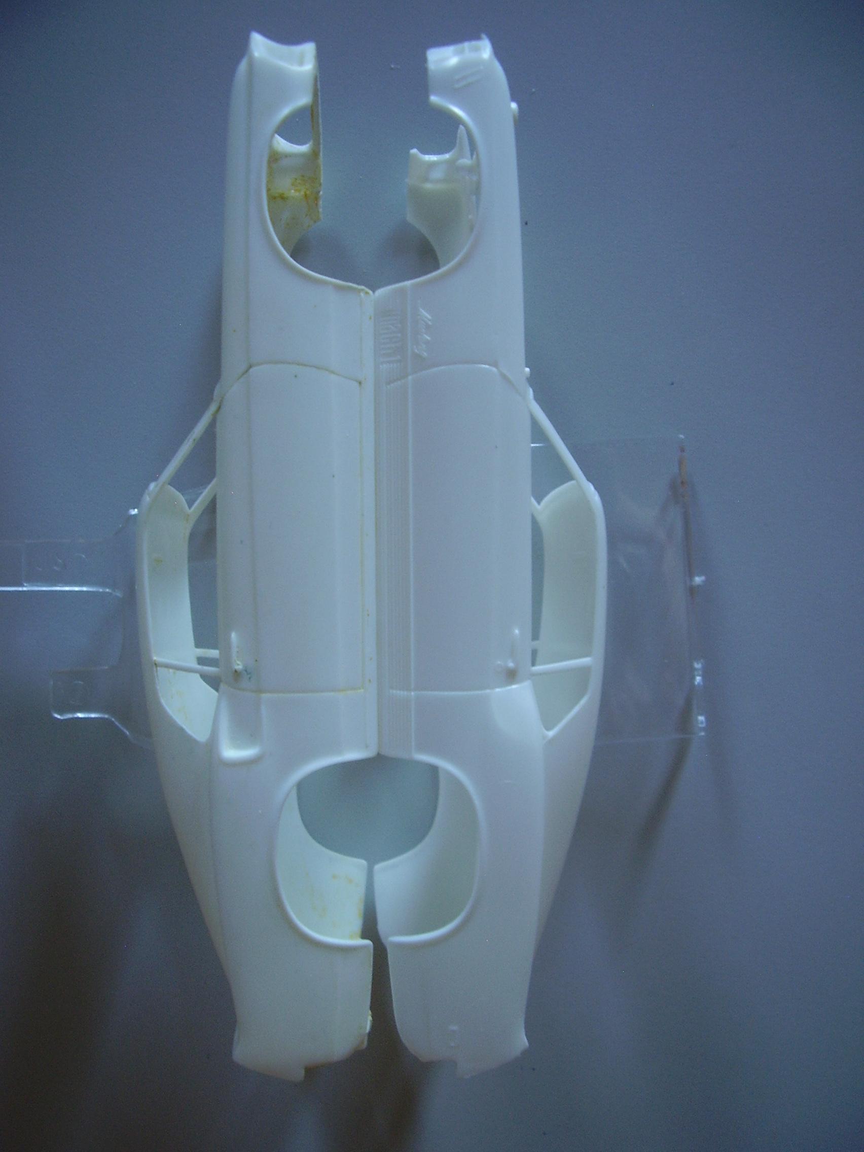

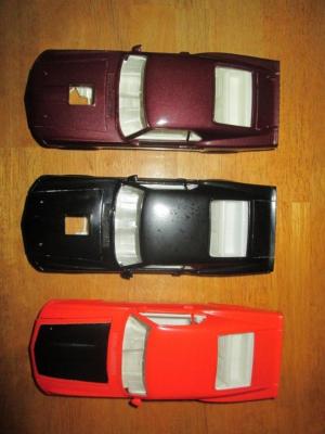

mk11 Posted March 16, 2015 Author Posted March 16, 2015 (edited) Here's a profile comparison... revell top, amt middle and mpc bottom  ...and a pic showing the revell 1/25 '69 shell alongside the monogram 1/24 '70 shell clearly showing the two shared a common source  While the flawed front fenders on the master weren't real obvious on the '70, they became painfully so when the '69 parts were applied.  side by side amt '69 and mpc '69 bodies side by side amt '69 and amt '70 bodies Edited January 28, 2019 by mk11

Snake45 Posted March 16, 2015 Posted March 16, 2015 Excellent pics and comparo and matches my impressions exactly. Revell, best detailed chassis, engine, interior and body quite nice except for the complete backbirth front end. AMT, best body overall and definitely better front end than Revell. MPC, undersized (somewhere between 1/26 and 1/28). Body not perfect but overall better looking than Revell. Also, front valence panel seems to be too shallow, giving the front end a raised look. With a little work, can be built into a presentable (if small) model.

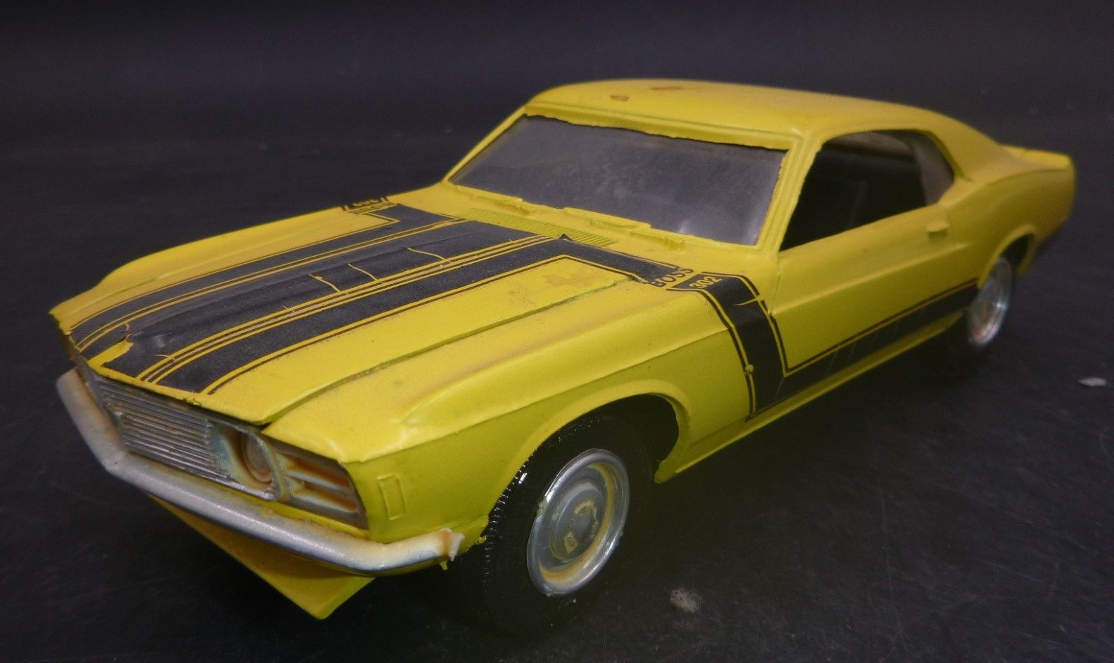

mk11 Posted March 16, 2015 Author Posted March 16, 2015 (edited) The pics aren't as clear as I'd hoped but you get the idea. I just missed picking up missing link's last copy of the '69 a couple of years ago. The mpc body isn't all that bad; the hood is the same size as the amt part and I think the windshield opening looks better. The amt body could probably benefit from some upper windshield trim finessing a la the F350 and the current re-issue '66 Fairlane/Comet body. Another historical bonus I happened upon the other night was someone's thoughtfully provided photo of the '70 blue crescent parts (from the big auction site) so I'll add that one with a pic of the '69 amt kit...  '69 amt  '70 amt  better view of retooled '70 chassis... Mach Won parts mpc super stocker parts '70 mach won chrome shot (one of three); recycled whole from the '69 long-nose funny car kit palmer '70 Edited January 28, 2019 by mk11

Snake45 Posted March 16, 2015 Posted March 16, 2015 Here's a profile comparison... revell top, amt middle and mpc bottom ...and a pic showing the revell 1/25 '69 shell alongside the monogram 1/24 '70 shell clearly showing the two shared a common source While the flawed front fenders on the master weren't real obvious on the '70, they became painfully so when the '69 parts were applied. mike Never noticed this before, but look how much shorter the sheetmetal is ahead of the front wheel openings on the Revell vs the other two. I wonder if that shortness is part of the problem?
