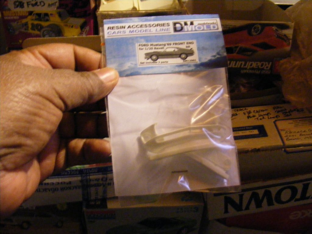

I received my resin parts from DMould Resinworks today, which is 15 days from when I ordered the part on line, and paid for it through Paypal. The parts came in a small box which originated in Russia.
1969%20Mustang%20Transkit%20001_zpsx7ryo
1969%20Mustang%20Transkit%20005_zps1dkqi

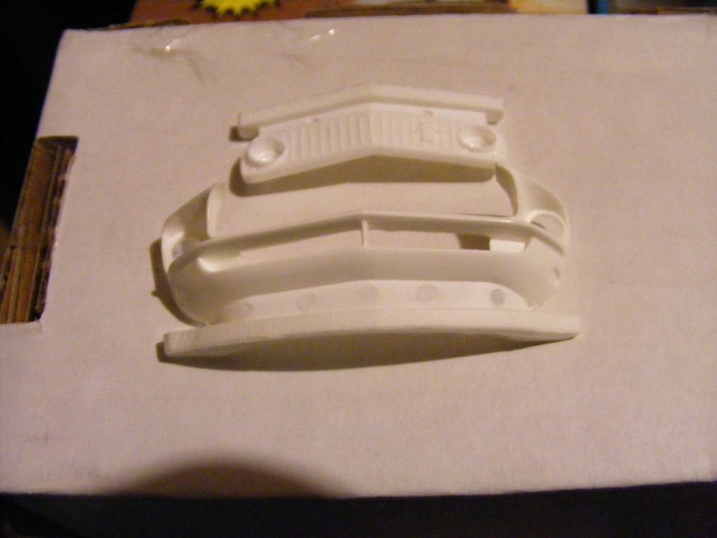

Inside the box was a small packet, which consisted of a Headlamp/Grille surround and a new grille in crisp, clean smooth white resin.
1969%20Mustang%20Transkit%20007_zpswwstn

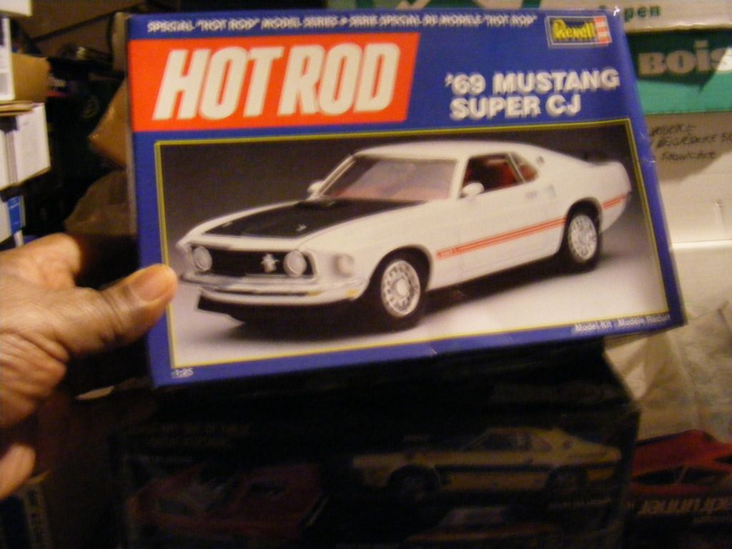

The quality of the parts is reminiscent of what I have gotten from Replicas and Miniatures, and Historic Racing Miniatures, in that it was hard to discern these parts from the white styrene. They were that nicely done, and they were very well cleaned up of flash. I did a test fit on a kit body I have,
1969%20Mustang%20Transkit%20008_zps11ng2
and while there has to be an adjustment of the fender (thinning out the underside of the upper fender edge on each side, due to the realignment of the headlamp buckets, and cleaning up the flash from thh kit body) the part fit was pretty good, and vastly improved the looks of the model, virtually eliminating the droopy looking front end. They also reshaped the grille opening, and added a correct surround moulding to the part, as well as a replacement grille. It looks great. Unfortunately, I am not able to show my model with the grille attached, as I did not mount the grille to the car permanently, as I have to do some clean up of the kit body before permanent attachment of the resin part. In finger fitting the part, I am quite confident that this part will look much better than the original kit parts once properly attached to the car. I suggest that you work one side at a time when you attach the resin parts. I recommend this transkit if you intend to build this kit.

Ron, you're a fairly experienced builder so I'm curious if this commentary was solely the result of your attempts to match the resin front end with the kit body, or did the resin caster include some helpful instructions?
...and while there has to be an adjustment of the fender (thinning out the underside of the upper fender edge on each side, due to the realignment of the headlamp buckets, and cleaning up the flash from the kit body) the part fit was pretty good, and vastly improved the looks of the model...

Whenever I get a resin part, I test fit it to the styrene to see how it fits. What I did was to set the hood onto the body, and place the new resin part where it is supposed to go. I noticed that the resin part sat about 1/32" below the fender line. At first, I thoght that the resin part needed a little clean up, as most do. In this case, I compared the ridge arond the backside of the styrene part, and the resin trans-piece, and I noticed a difference between the two parts. The flange around the bucket of the resin part was not as deep as the kit piece, and that is where the interference lies. With a little file work on the underside of the fender, and the fit would be perfect. On this kit, the styrene front end is a fiddly fit also. I know that because I have another one that I glued the front end on, and I was not too happy with how that process went. I got it on with even gaps, but I had to do a little file work on that too, so like I wrote before, I do not see much of a problem with the fit of the new piece, just as long as you work carefully to get the fit right. It is best to work one side at a time with either front end allowing the glue to dry completely, and you should smooth the edges and the mould lines from the fender.
There were no instructions on how to install these parts onto the car from the resin caster, as they go on the same way as the kit part. Maybe I should install the part on the car so you can see what I am writing about. I was not planning on this build right now, as I have several others to do, even though the red Q-Code I posted is very tantalizing.
