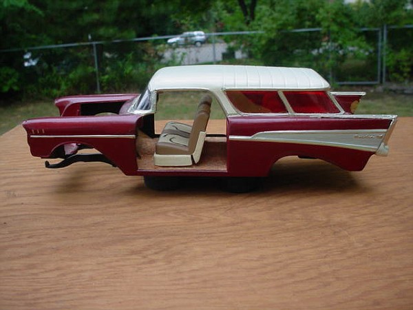

Tom Geiger Posted July 3, 2015 Share Posted July 3, 2015 Crummy photo of a model that I started a long time ago and never finished. But the side trim was done by first spraying the insert with Testors Silver, and then Bare Metal Foiling the trim around it. Quote Link to comment Share on other sites More sharing options...
