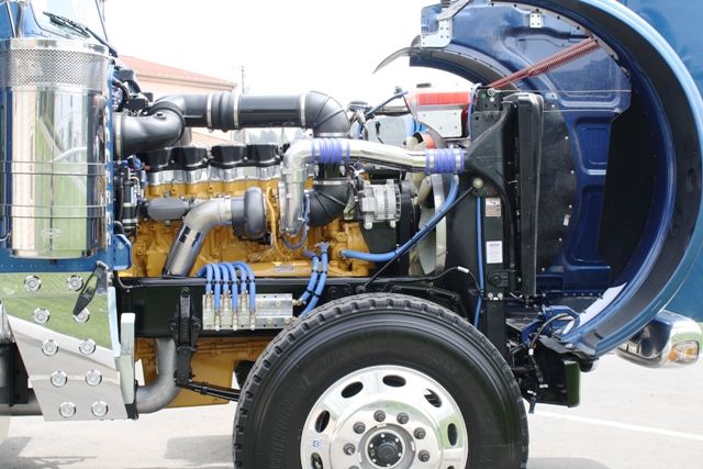

vincen47 Posted August 31, 2015 Share Posted August 31, 2015 (edited) Hey guys, anyone know what this is attached to the frame with the blue lines running to and away from it? Probably something with the coolant system, but I don't recall seeing it before. It is a Pete 389 glider with a Reman C16 from Kustom Truck. Beautiful engine. Edited August 31, 2015 by vincen47 Quote Link to comment Share on other sites More sharing options...
Mike T. Posted August 31, 2015 Share Posted August 31, 2015 Cary, that is a central distribution block for the coolant.The lines (2) come from the engine,1 is a supply line , the other is a return line.The other 6 lines coming out of the unit will go to the cab heater, bunk heater and the other 2 would likely be there to connect to an auxiliary power source (generator or APU) or it may just be there for future use.Same thing as the supply lines,1 is a supply line and the other is returncoolant. Quote Link to comment Share on other sites More sharing options...
