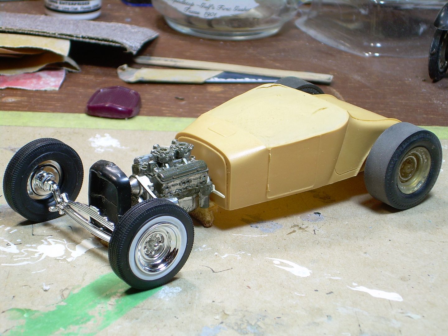

Ace-Garageguy Posted September 10, 2015 Author Posted September 10, 2015 (edited) Decided on this one. Least bodywork, and a good few of the new Revell '29 kit parts will show. First mockup is kinda close, but no cigar. Biggest correction needed is that the radiator shell (old AMT, chopped) needs to be higher relative to the front tire-tops. Engine needs to go a tick lower relative to the body, too. Side shot shows there's enough ground clearance to have some leeway to go lower there, which may be necessary to get the tail a tad lower relative to the tops of the rear slicks. Rear tires are vintage Revell Racemasters, with vintage Revell chrome-reverse rims from the '57 Chevy (old opening-door kit). Front wheels and tires are new-release AMT '36 Ford. Front axle is new Revell '29 kit, as will be the brake backing plates and finned Buick drums. Engine is a vintage Revell smallblock Chebby parts-pack unit. Edited September 10, 2015 by Ace-Garageguy

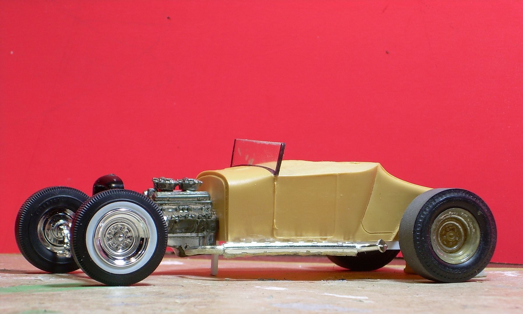

Ace-Garageguy Posted September 10, 2015 Author Posted September 10, 2015 (edited) Heavily channeled cars are tricky to get to look right from every angle. Lots of them end up looking squashed. Many end up with overbites or monkey faces, and often, the top of the grille-shell ends up higher than the cowl. You have to be willing to tinker and fiddle, sometimes a lot, to get a car that doesn't look dorky. I raised the grille shell, extended the lower edges of the body shell to represent the bellypan, mocked in a windshield and side pipes, and a pair of headlights (again from the NEW Revell '29 kit). Adjusted the proportions all around just slightly. Getting there. I ALWAYS try to dial-in the look, stance and proportions BEFORE cutting or committing to gluing or modifying anything. Now that I'm pretty close to the final look, I know what the wheelbase is going to be...close, anyway... so I know how much frame modification I'll need. The rear of the frame needed an additional amount added to the zee to get the ride height in the ballpark, so I cut it through the rails on a line parallel to the forward edges of the vertical members at the zee, and plunked the resulting stub down on top of the rails. I can get away with this (in this case, it's shortened the frame a bit) because there's enough length in the rails to let me fit the new front crossmember that will take the suicide axle mount. The headlights need to come up slightly, and the grille-shell and body need to go down a little. Still, I'm close enough to get on with the chassis building and do the adjustments as work progresses. The inspiration car (this is the only photo of it I've found) appears to have its grille a tick higher than the cowl. I don't want that. The rear of the car also appears to be lower relative to the tires than my model so far. I DO want that. The real car appears to have had the floor dropped between the rails, to get the seating lower, and a partial bellypan built to conceal it...and it makes the car seem lower. The real car also appears to have front tires with a bit shorter sidewalls than my mockup pieces, and I'll be looking into getting something to represent those too. Getting all these things to work together takes a critical eye, effort, and time. Edited September 10, 2015 by Ace-Garageguy
Dennis Lacy Posted September 10, 2015 Posted September 10, 2015 The 2nd attempt at proportion looks really good to me including the often hard to get right overhead view. I also like the very subtle forward rake. Looks like about an inch difference if this were a 1:1 scale car. Not a fan, at ll, of the stink bug stance some hot rods have. One of the things I think a lot of people get wrong on low slung cars like this is a stupidly long wheel base. The radiator shell/grill should be no further forward than it needs to be for engine clearance and the axle should be a half foot or less in front of the grill (basically the room that is required for a cross member tube and spring perch. Some cars have the front axle a foot + ahead of the grill and it just looks dumb. Carry on!
