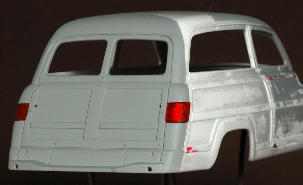

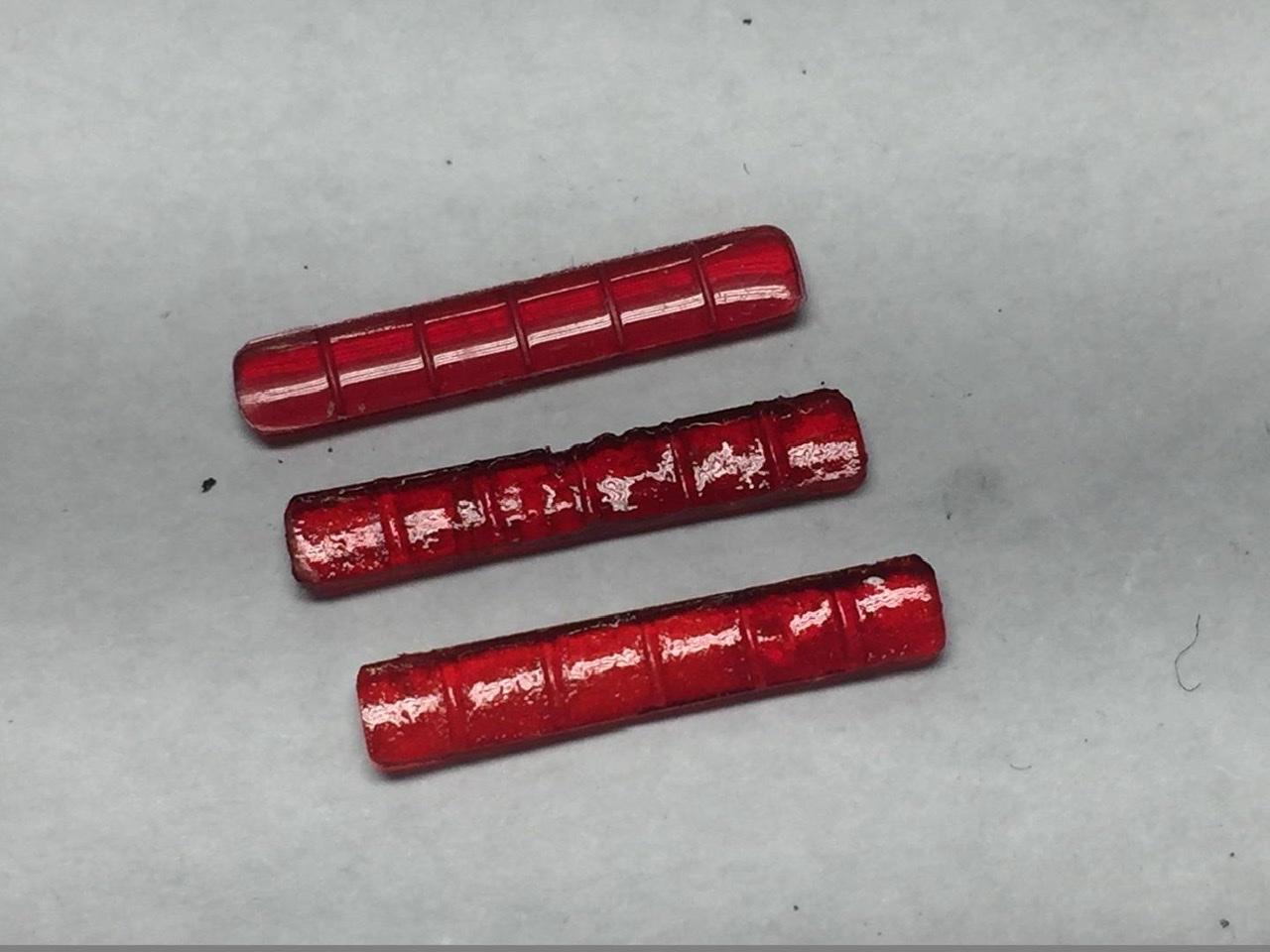

Foxer Posted September 10, 2015 Posted September 10, 2015 (edited) You may need a large sprue to cover those lights. The idea is to sand and file them to shape then polish them with progressively finer sandpaper, like a paint polishing kit. It you can find a chunk of clear that will cover the shape and contours of the lights it can be done. I just made some contoured tailights for a 49 Merc that followed the contour of the rear fender where I cut out a hole for them. I used Bondic to easily cast them in a matter of minutes. This material is a light cured clear plasticThese also had to be sanded and polished but I an very happy with the taill light possibilities the Bondic opens up for a non-resin caster. Here's a link to a thread I posted about how I did it and other things I've used Bondic to make. Edited July 30, 2017 by Foxer Quote

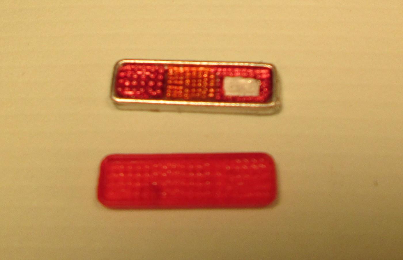

NOBLNG Posted May 25, 2020 Posted May 25, 2020 I cast these from Bondic by pressing the original (Top) into some silly putty. I then painted them with Tamiya X-27 clear red. A nicer job wouldn’t be difficult.? Quote
