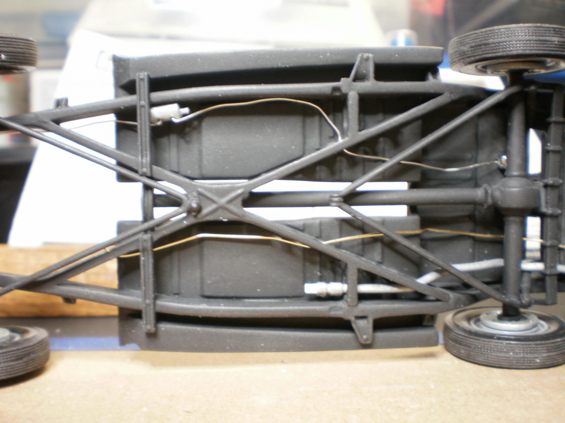

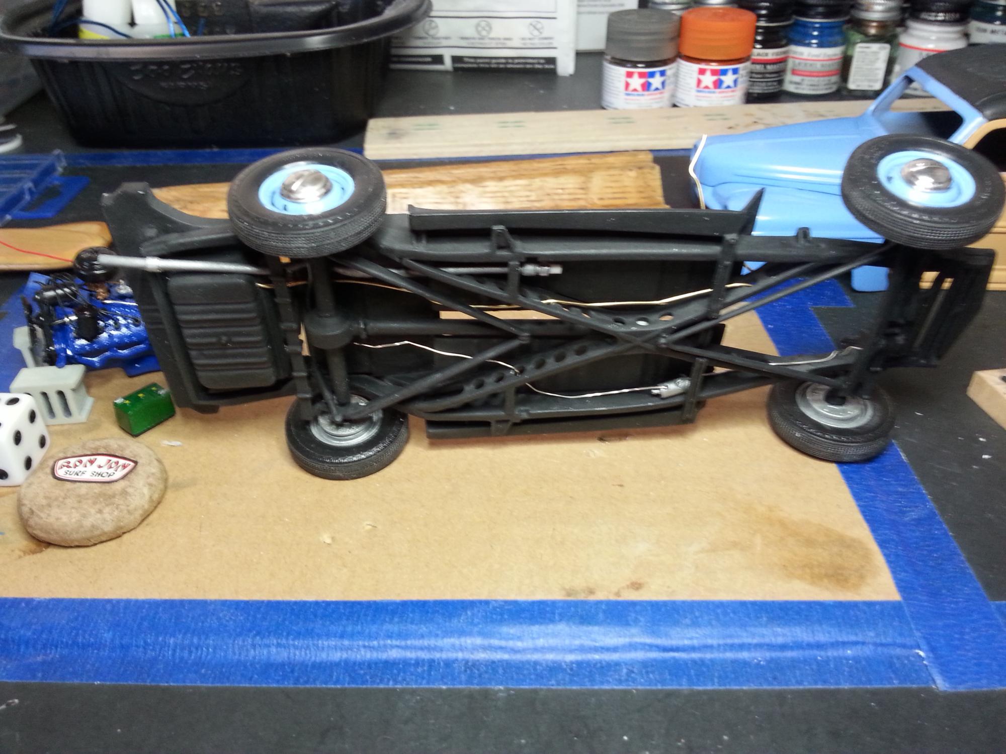

On the bench today is my Revell '48 Woody model. The first thing I did after reviewing the photos on the box of the 1:1 car and their built model was to commit to lowering this Retro beach wagon substantially. So the frame and springs were built as a unit while a good deal of surgery was being performed. By sinking the cross-members into the floor pan and shortening leaf spring heights I think I got where I needed to be. The result is a much more modern ride height. I'm aiming for a "new look but with vintage drivetrain", posibly the thing a Surf Shop might own. Also the front bumper mount was eliminated along with the signal lights under the headlights. All in all a much cleaner look. The rear hatch was opened by judicious use of a scratch awl. Brake lines and fuel lines were run under around and thru the famous Swiss cheese frame holes these Fords had. Makes detailing the undercarriage a lot of fun.

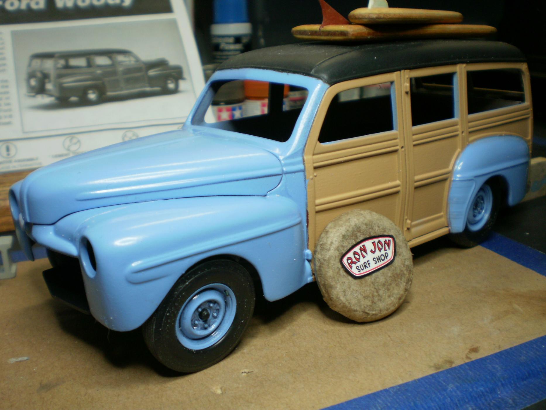

The flathead V8 got a Parts by Parks distributor and coil, and a throttle rod and fuel line for good measure. Steelie wheels complete the look, the've got valve stems added but will also receive some tire weights before this one goes on the shelf. I rushed the black paint onto the top over still moist primer, and blew the mess dry with a hair dryer. It's my personal technique for causing distress on tops and upholstery, and it worked like a champ here too. There's a fine line that results in just enough cracking and patina, try it some time with a scrap body. Anyhow stay tuned, I'm going to get the windshield foiled and that flattie mounted up in coming days.
