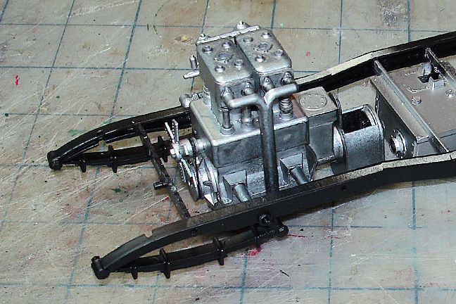

Harry P. Posted November 24, 2015 Posted November 24, 2015 I've been on the lookout for this kit for years... finally found one at a reasonable price on ebay (reasonable because someone had already started it; the engine and part of the chassis was already built). It's a 1901 (more on that later) Bianchi, in 1/16 scale. Like so many of these old Japanese 1/16 scale kits, they have been released under various brand names and box art over the years... I happen to have the Bandai release. This is the box art... As you can see, the box art is an illustration, not a photo of the real car. And there is no model year listed. Which brings me to the question about the actual model year. This has to be one of the most mysterious cars I've ever tried to research. After many searches online, I managed to find only one image of the real car, this one, on a site that covers the history of Bianchi. They list it as a 1901... Virtually all other mentions of this car online refer to either the 1/16 scale model kit, or a 1/43 diecast... and all of those call this a 1906 Bianchi. So not only couldn't I find any info or photos of this car, I couldn't even get a definite model year. EDIT: Thanks to Christian (Junkman) for the model year. It's a 1906.

sjordan2 Posted November 24, 2015 Posted November 24, 2015 (edited) I would assume that the engine colors would be very close to to the typically Italian FIAT and Itala racers you've already built. Edited November 24, 2015 by sjordan2
Harry P. Posted November 24, 2015 Author Posted November 24, 2015 Probably. But I've already decided this one is going to be built curbside-style. There's plenty of visual interest here with that unusual bodywork... nobody is going to miss the engine. My only problem is trying to decide what the color scheme will be. I have several ideas i mind, but haven't decided yet.Actually, the engine in this kit is identical to the Itala kit I built recently. Obviously they reused a lot of the tooling when they made these old kits. It even says "Itala" on the gearbox. This looks to me to be the Itala kit with a different body.

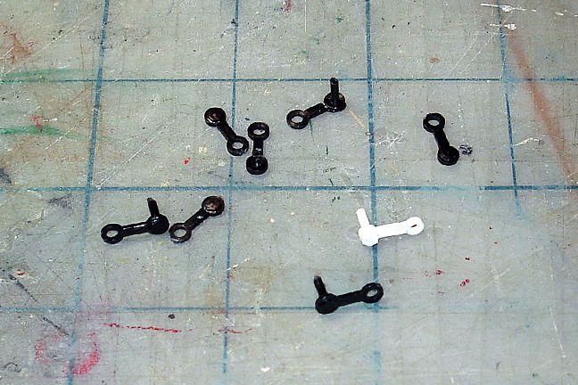

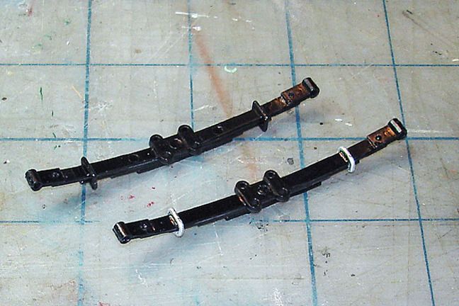

Harry P. Posted November 25, 2015 Author Posted November 25, 2015 The kit springs are built up with individual leaves and shackles. Two of the shackles were missing, so I made new ones of soft silver wire... One of the spring mounting brackets was also missing, so I used one of the kit pieces as a reference to scratchbuild the missing one out of styrene tube and strip...

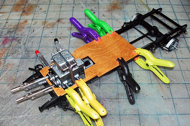

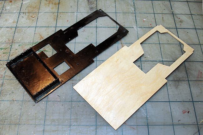

Harry P. Posted November 25, 2015 Author Posted November 25, 2015 I replaced the kit floorboard with a new one made of wood. I laminated two pieces of 1/32" birch veneer, with the grain of the two pieces at 90º to each other, to minimize warping. That enclosure on the kit piece is the battery box under the driver's seat. I won't be using the motorized parts for this project, so no battery box will be needed. The new floorboard was stained and super-glued to the frame rails. In the photo you can also see the rear brakes. Typical for most cars of this era, there are no brakes on the front wheels.

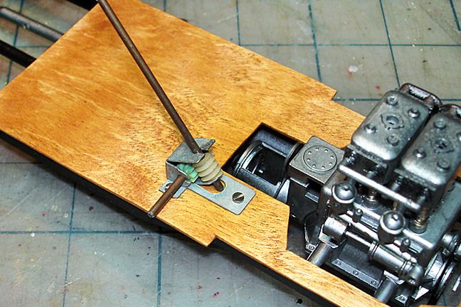

Harry P. Posted November 25, 2015 Author Posted November 25, 2015 Using the kit floorboard, I marked the location for the three holes to mount the steering gearbox. I attached it to the wooden floorboard using some leftover Pocher kit hardware (they usually supply more than you need)...

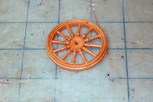

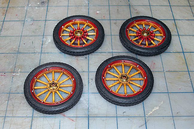

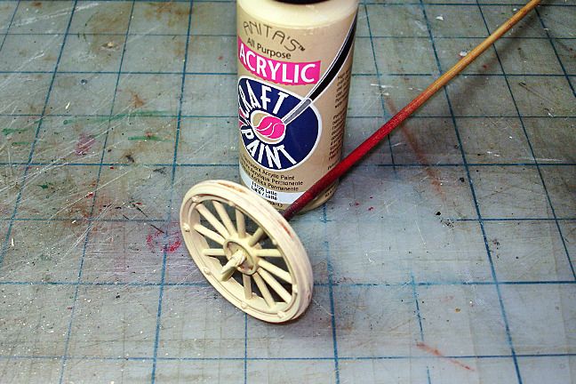

Harry P. Posted November 25, 2015 Author Posted November 25, 2015 As usual in kits of cars from this era, the wheels are molded all in one piece. In reality, the wooden wheels, the steel rims, the rim clamps, and the rim bolts were all separate pieces. So in order to give the wheels some realism, you have to rely on paint detailing to make it look like there are more pieces involved than there really are. Here is one of the kit wheels, molded in a sort of "wood' color, I suppose... Step one is to brush on two coats of acrylic craft paint. I used a color called "Latte," but the exact shade isn't critical. All I need is a generic light tan color... The next step is where the "magic" happens. I dip each painted wheel into a can of Varathane oil-based wood stain, let the excess run off, and blot the wheel gently with a paper towel. The stain actually gets absorbed into the acrylic paint, and when dry the result is a pretty realistic looking "wood" wheel. Since the stain I use is oil-based, I use a dehydrator to speed up the drying time for the stain. After the stained wheels are dry, a brushed on some acrylic red for the rims and the center area of the rear wheels. I also painted each rim bolt head silver... And the final step is a black wash of Future and black acrylic paint that not only brings out the detail, but also gives the flat acrylic red paint a nice gloss. The finished wheels...

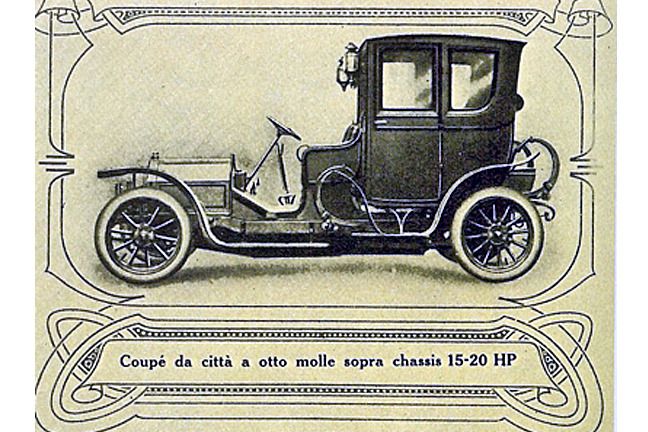

Junkman Posted November 25, 2015 Posted November 25, 2015 1901 is definitely a typo, which sadly seems to have infiltrated the internet to a large degree. In 1901, Bianchi was still building quadricycles with DeDion engines.The 15-20 HP, which this model represents, wasn't released until 1906 and remained in the lineup until ca. 1910.Like most other car manufacturers back then, Bianchi only delivered the chassis. Some Italian count had this town car built on it and the real car was displayed in themuseo nazionale automobili in Turin until it was sadly claimed by a fire in the 1970s. This was after Rio had measured it up for their 1:43 diecast, and IMAI, the original Japanese issuer,for their 1/16 scale kit, a reissue of which you are building here. Apart from the Rio diecast: there was also a 1/32 scale kit by Aoshima: and a ca. 1/16 scale battery powered plastic toy by the Spanish firm Guisval: which was most likely patterend after the IMAI kit.
sjordan2 Posted November 25, 2015 Posted November 25, 2015 (edited) Since this was shown in the catalogue, and it was a common style among many manufacturers including Ford, it strikes me that there must have been more than one Bianchi like this. This picture was identified as a Ford -- probably a custom for the top-hat class. (I'm not sure if I believe that). But I've found similar styles among other brands. The model kit was issued in 1970, and like most antique automobiles, there's no telling how many different paint schemes it may have experienced between 1906 and then. Therefore, I suggest that Signore Pristovnik should choose what suits his taste. Edited November 25, 2015 by sjordan2
Harry P. Posted November 25, 2015 Author Posted November 25, 2015 Some Italian count had this town car built on it and the real car was displayed in the museo nazionale automobili in Turin until it was sadly claimed by a fire in the 1970s.Then my guess that this car was one-of-a-kind was correct. So the one and only real car was destroyed by fire? Too bad, but even so, I would have expected to find some photos of the car online, especially considering it was once in a museum... but aside from the one image I found (labeled as a 1901), I found nothing.
Harry P. Posted November 25, 2015 Author Posted November 25, 2015 Therefore, I suggest that Signore Pristovnik should choose what suits his taste. And I will! I have no idea yet, but whatever I decide on will have to work with the wheels I painted with red trim. One of my initial ideas is dark red for the forward part of the car, and black/ivory for the coach portion... ivory below the beltline, black above. Suggestions welcome...

gtx6970 Posted November 26, 2015 Posted November 26, 2015 I'm curious.Would the cab portion have windows, or where they open to the elements Did I mention I like your diverse taste in subject matter ......
sjordan2 Posted November 26, 2015 Posted November 26, 2015 I'm curious.Would the cab portion have windows, or where they open to the elements Did I mention I like your diverse taste in subject matter ......The factory catalogue shot in the first post shows window reflections and the models all have glass.

Belugawrx Posted November 26, 2015 Posted November 26, 2015 Nice work as usual Harry!Thanx for packing the wip with tips too!I must try that Future + black acrylic paint wash....Cheers
