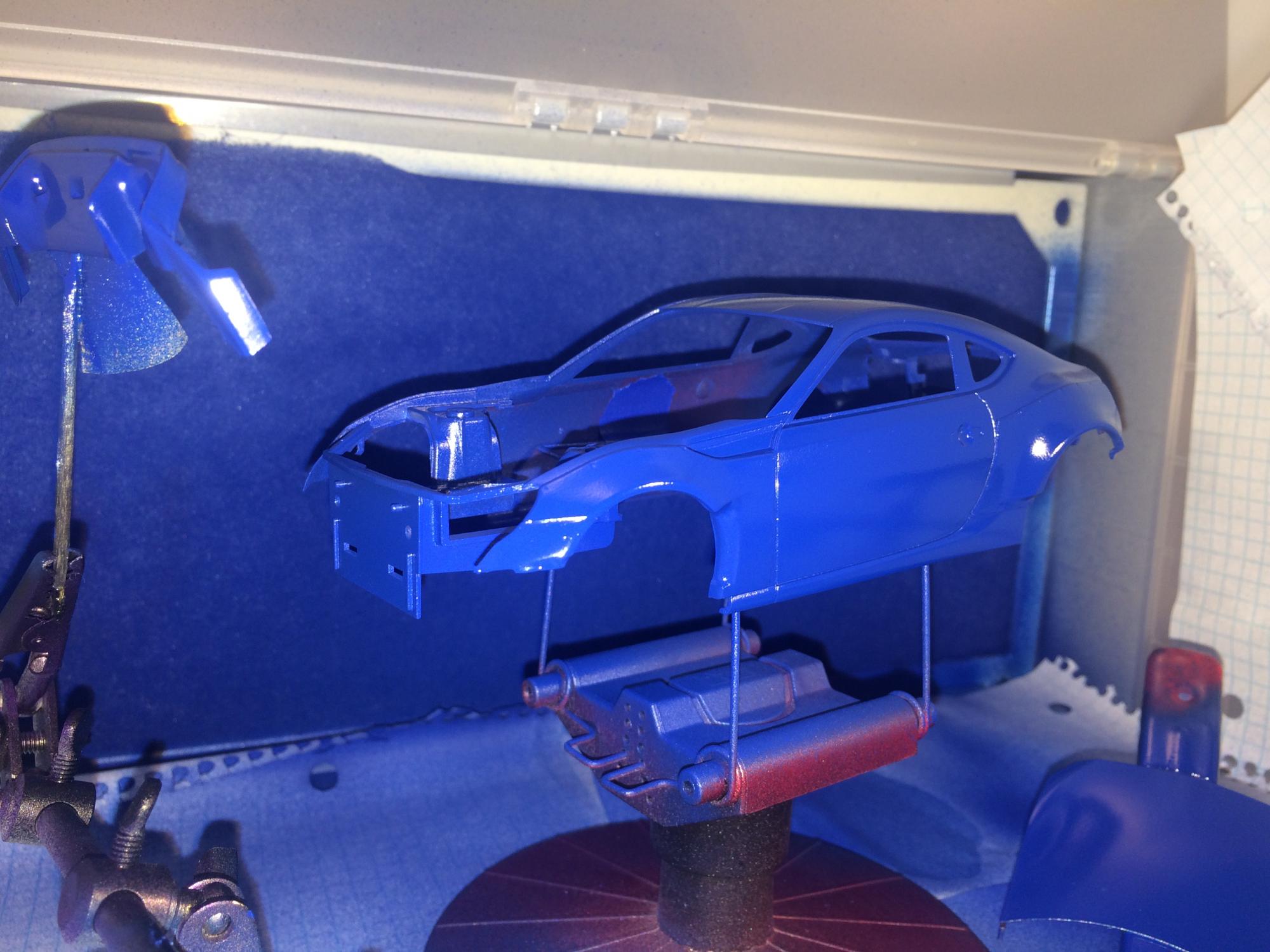

image.thumb.jpeg.1a7647dc23ff4b4f7218394Gave the testors enamel and laquer thinner a try today (ratio 1:1) and After stripping the car twice I can settle for where it's at. Being new to airbrushing I'm still trying to dial in settings, but I can see how people get great results with this. What clear coat do most of you use with good results?  There are a couple dust particles that made there way on to the body. Just to make sure, I would have to spray the clear and then sand them out correct?
Thank you for all your help!
If this were my car, and since this is a solid color, it really needs no clear coat. There's enough hardener in the paint that it should rub out and polish without needing it. Metallics on the other hand, you should always clear as rubbing them out disturbs the metal flakes and lends itself to a swirly, mottled appearance.
The dust particles should come out as you're rubbing out and polishing the body.
Hope this helps!

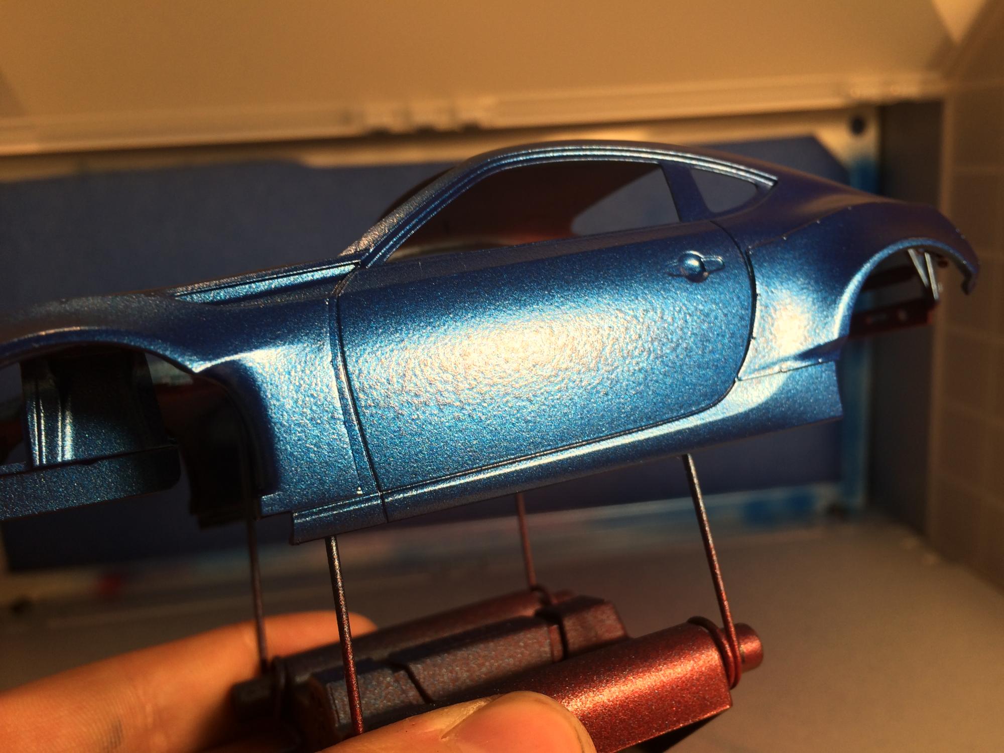

So I gave the Aztek series a try again. I did not prime the body. I started spraying on the plastic with a .3mm tip on my Paasche H at about 20psi. Once again the finish was not smooth. I was not spraying to far away but for some reason I can not get a smooth gloss finish for the life of me and it's taking all the enjoyment out of modeling. Any help or advice is greatly appreciated!

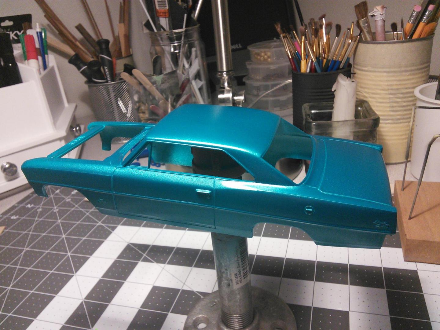

If you want slick pain't you may want to try my method. It's simple, cheap and doesn't stink the place up. I use acrylic craft paints from hobby lobby and Walmart. You can get these for less than two dollars a bottle and one bottle will paint at least ten bodies. These now come in pearl and metal flake colors as well.
My spray formula is any single or dual action airbrush with #3 or #5 needle will work as long as the airbrush is clean and operating properly. I use a Paasche talon dual action.
Air pressure needs to be adjusted to each batch of paint. I spray anywhere from 20 to 30 pounds depending on my paint and what I'm spraying.
Thinning paint. I always mix my paint half paint and half Pledge floor finish so you end up with a fifty fifty mix.
Turn your airbrush down until you get the flow you want and spray light coats making several passes around the body. You can practice spraying on  plastic spoons to get use to it and tell how its going to look. No need for clear because the clear has already been added to the paint. If you want s super high gloss finish you can spray straight Pledge floor finish over the body after paint has cured.
The draw back to using acrylics. They dry very fast so you will need to wipe the dried paint from the end of the needle from time to time if you notice your spray pattern changing or if there is a lack of spray.
Here's one I sprayed a few weeks ago and it has no clear on it. I sprayed straight onto plastic with no primer.
