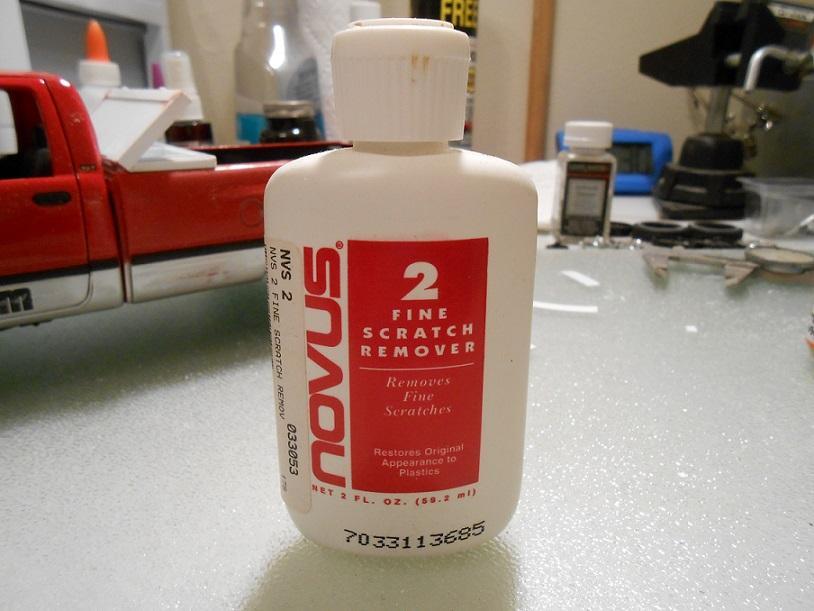

Exotics_Builder Posted April 28, 2016 Posted April 28, 2016 Polishing cloths only go so far. Then it is on to either Novus or Wright's silver cream. Then Future only if required.

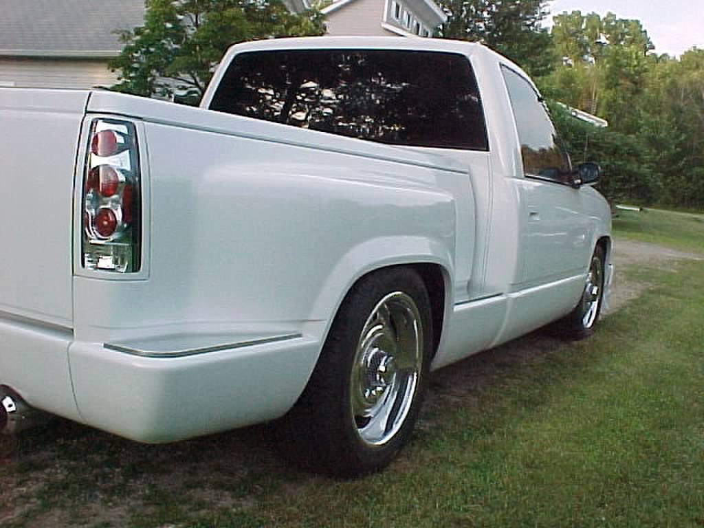

astroracer Posted April 28, 2016 Posted April 28, 2016 Get it to a point, 800 or 1000 grit and you can clear coat the "glass" to bring the translucency back. i do this with full size head and tail lights. Sand out to 800 and then clear. The tail lights on my truck were done exactly this way when I whited out the edges to match the truck. Mark

Yenkocamaro Posted April 29, 2016 Posted April 29, 2016 Nick, this is my favorite product. It has saved a couple of windshields for me, even one with super glue on it. I agree with the need for sanding in certain situations, but it sounds like you don't need that at this point. Cheers, Lance
StevenGuthmiller Posted April 29, 2016 Posted April 29, 2016 Nick, this is my favorite product. It has saved a couple of windshields for me, even one with super glue on it. I agree with the need for sanding in certain situations, but it sounds like you don't need that at this point. Cheers, Lance Ditto. I use it on every paint job. Along with the "Clean & Shine". Steve

peteski Posted May 2, 2016 Posted May 2, 2016 The Novus system (all 3 types) are specifically designed for polishing plastic, so they are the way to go. Toothpaste is an alternative but it has to be white (not the clear gels). The white stuff is abrasive in the toothpaste.
