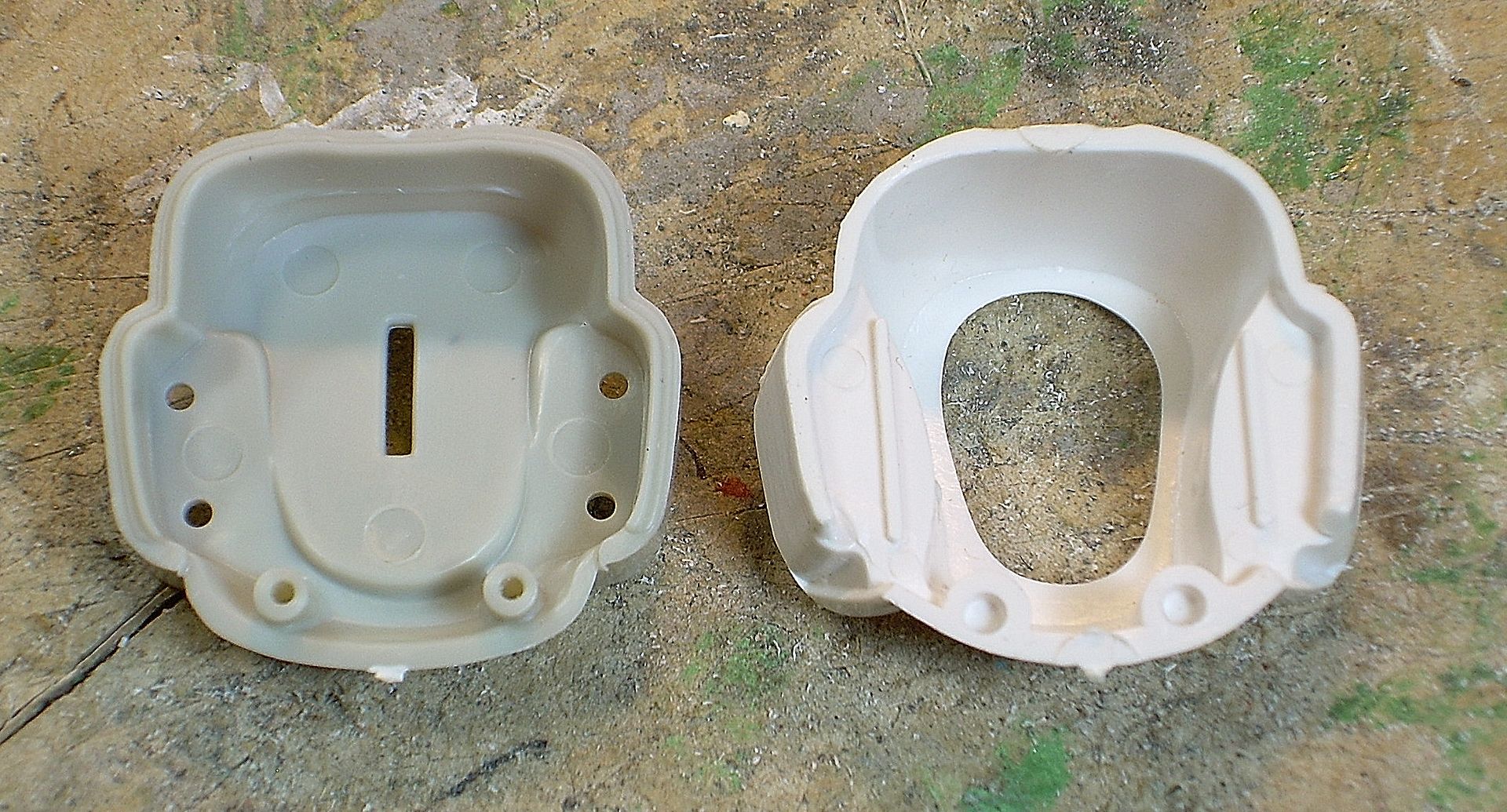

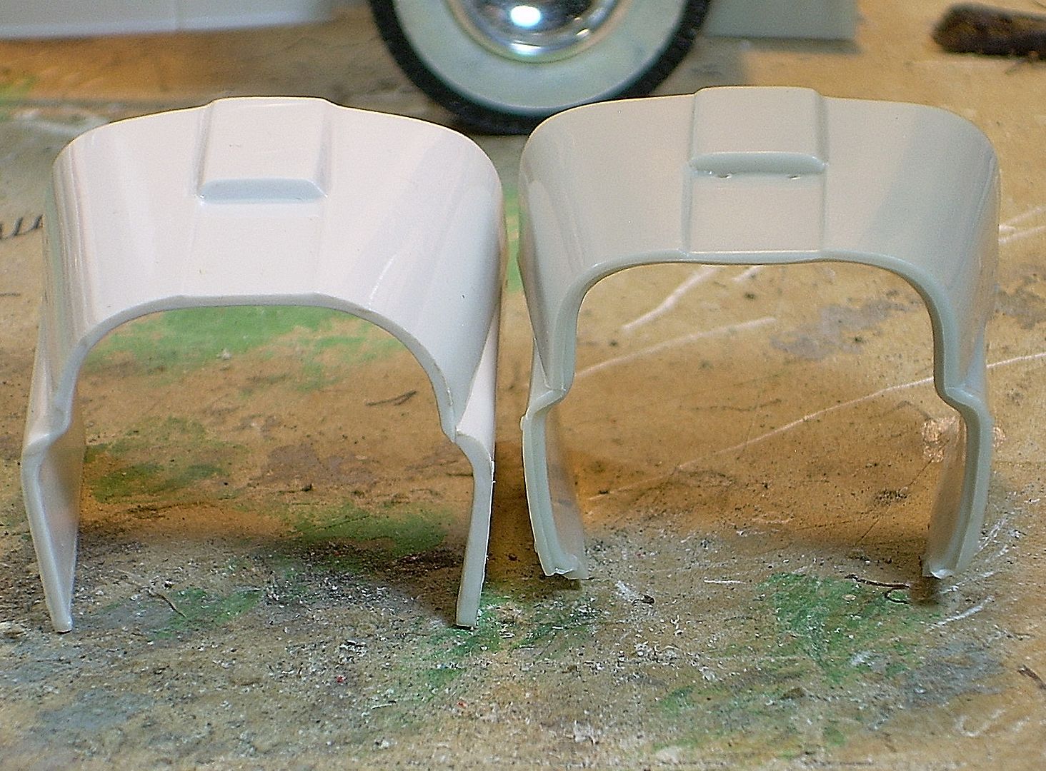

Ace-Garageguy Posted August 30, 2016 Share Posted August 30, 2016 (edited) Some people aren't big fans of this car, but to me, it's one of the most important customs ever built. Designed By George Barris when he was really in his prime, and two-time winner of the prestigious AMBR award, it burned at one point and went through several changes of ownership. The car was restored to 100-point as-built condition in 2008. With the reintroduction of the AMT "Mod Rod" double kit, there's renewed interest in building replicas of the Ala Kart that the original issue of the kit included parts for, some of which are lacking in the most recent Mod Rod release. There are enough original-issue gluebombs out there to make it fairly easy to come up with the missing parts, however. Both the AMT Ala Kart kits available (the "new tool" kit released in about 2002, and the "old tool" kit, released in 1961...TOTALLY DIFFERENT KITS) have scaling and proportion issues, but both of them also have their strengths as well. I'm sure you all know that Ala Kart is a play on "a la carte", which refers to ordering individual items off a menu rather than going with a complete meal. What we're going to be doing is trying to pick-and-choose components from BOTH kits, a la carte, to come up with a more accurate rendition of this iconic car than you can build from either kit on its own. It's going to take a while, and there will be much head-scratching, measuring, cutting (in all probability) and unforeseen delays. Typical for me. NOTE: Harold Perry built a gorgeous model doing much the same thing a few years back. For photos of his model, click here and scroll about a quarter of the way down... These are the kits we'll be using... "old tool" original issue on top (anywhere from $25 if you're lucky to $75 or so for a perfect one), and the "new-tool" kit below (can be had for as little as $15, shipped. (The newly-released Mod Rod kit shown to the right is derived from the original version of the Ala Kart / '29 Ford double kit shown here). There are a LOT of differences between the two. Again, I always find it kind of amazing that adult "professionals" can measure the exact same thing and come up with different results. "Old tool" parts are white, "new tool" parts are gray. First off, we'll compare the fender units. The main differences, besides the slightly shorter length of the "new" (2002 tooling) one, are the rolled lips on the fenders of the old kit (1960s tooling) that are almost totally lacking on the new one, and the louver detail on the aprons. The rolled lips are easily identifiable on pix of the REAL car, both finished as-was and during its recent restoration. The much lighter engraving of the louvers on the new parts will tend to fade out and disappear as the part is painted, particularly important as the correct color is pearl white, with a clear topcoat. Lotsa paint. Next up is the body shell or bucket. The real car uses a '29 model A Ford front section wedded to a '27 Ford model T rear. The "new" tool part is fatter and rounder at the sides, longer, and is considerably different in the rear. Again, white is the 1960s tooling and gray is the 2002 tooling. Later on, we'll be comparing these to photos of the real car to see exactly what's what. The main differences in the pickup bed are length, rather a large difference, and the size of the license plate recess. The old-tool kit has it too small. Edited November 26, 2018 by Ace-Garageguy Quote Link to comment Share on other sites More sharing options...

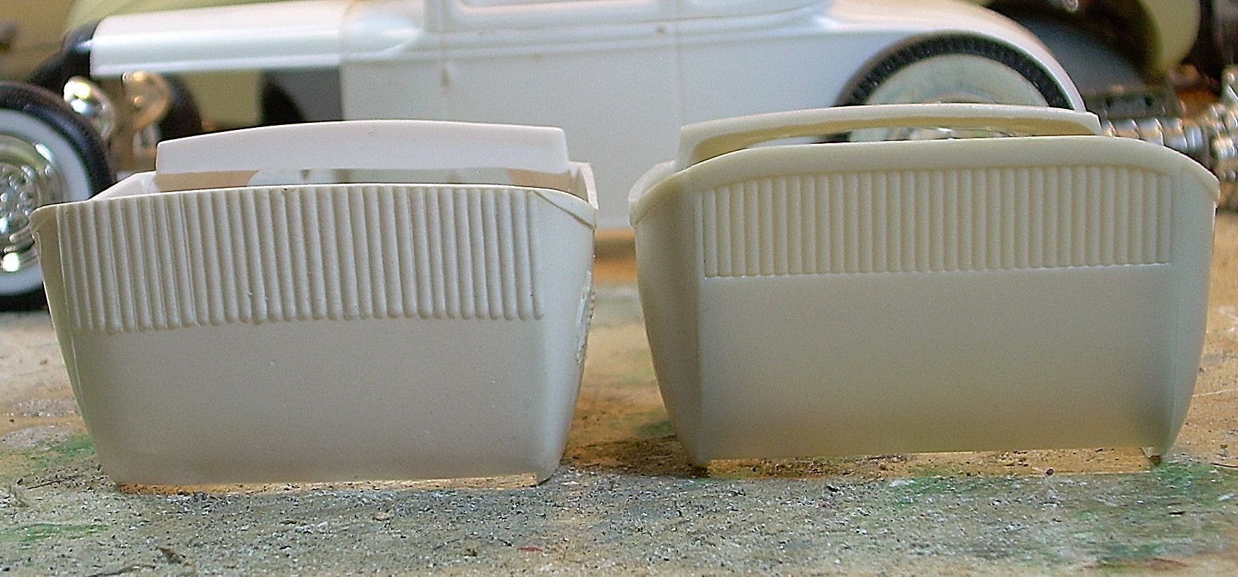

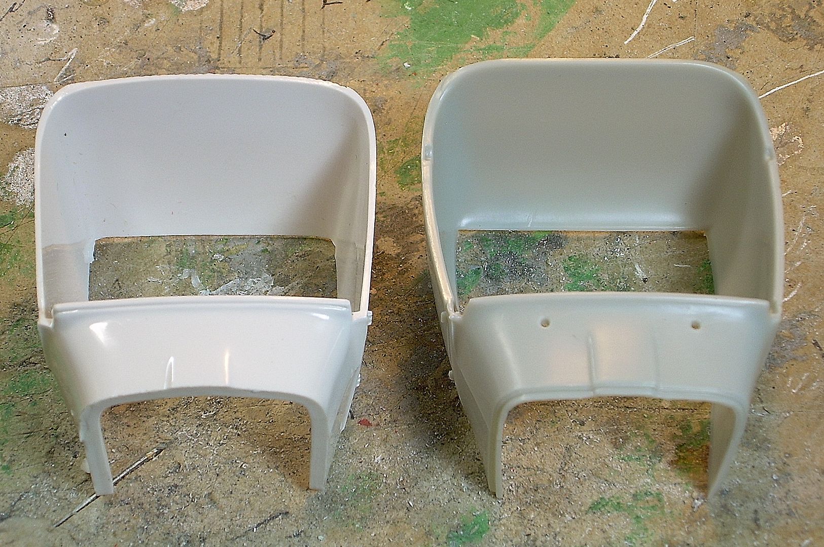

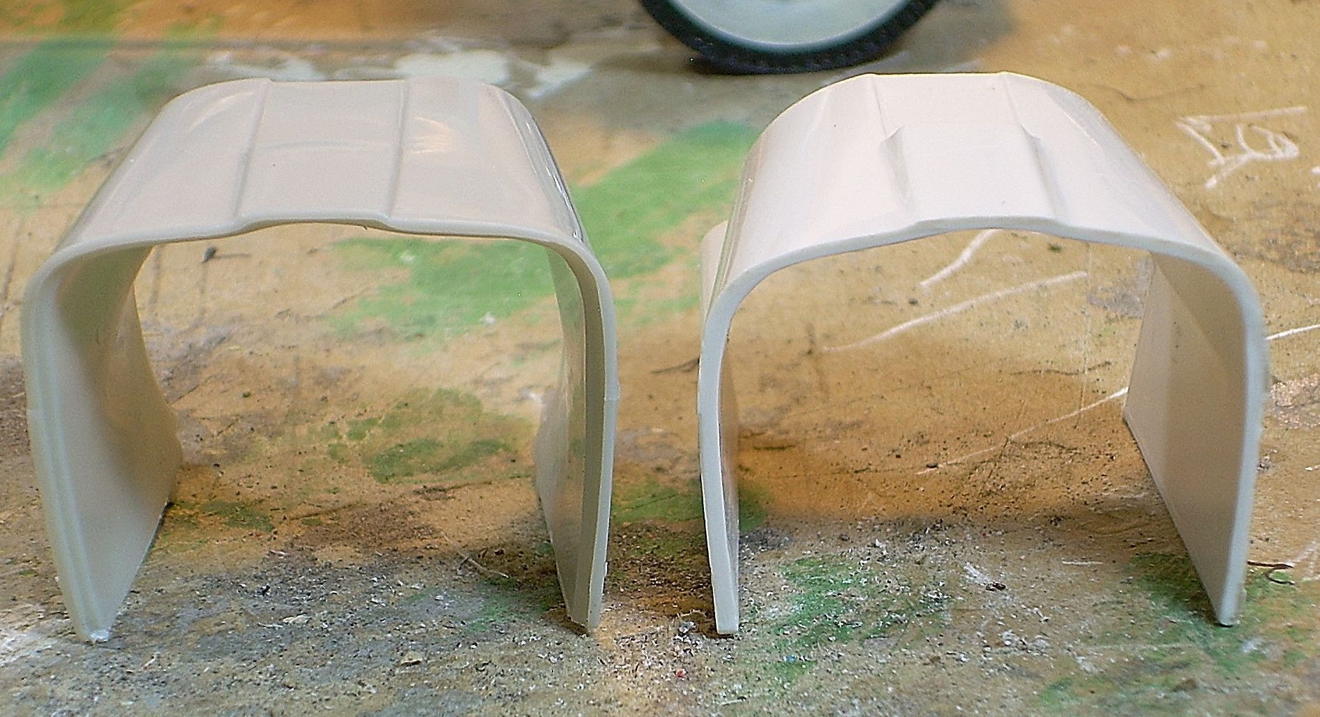

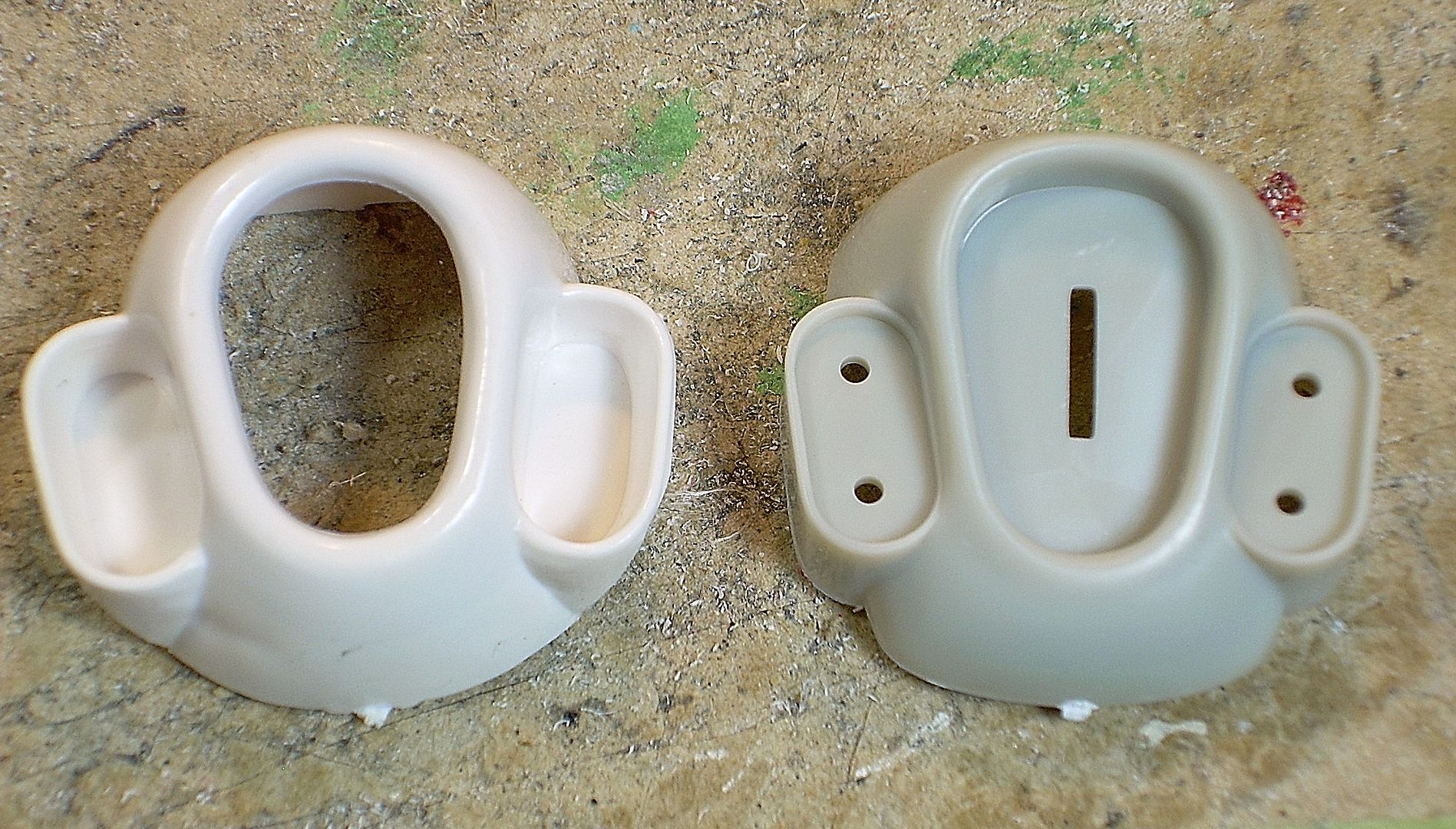

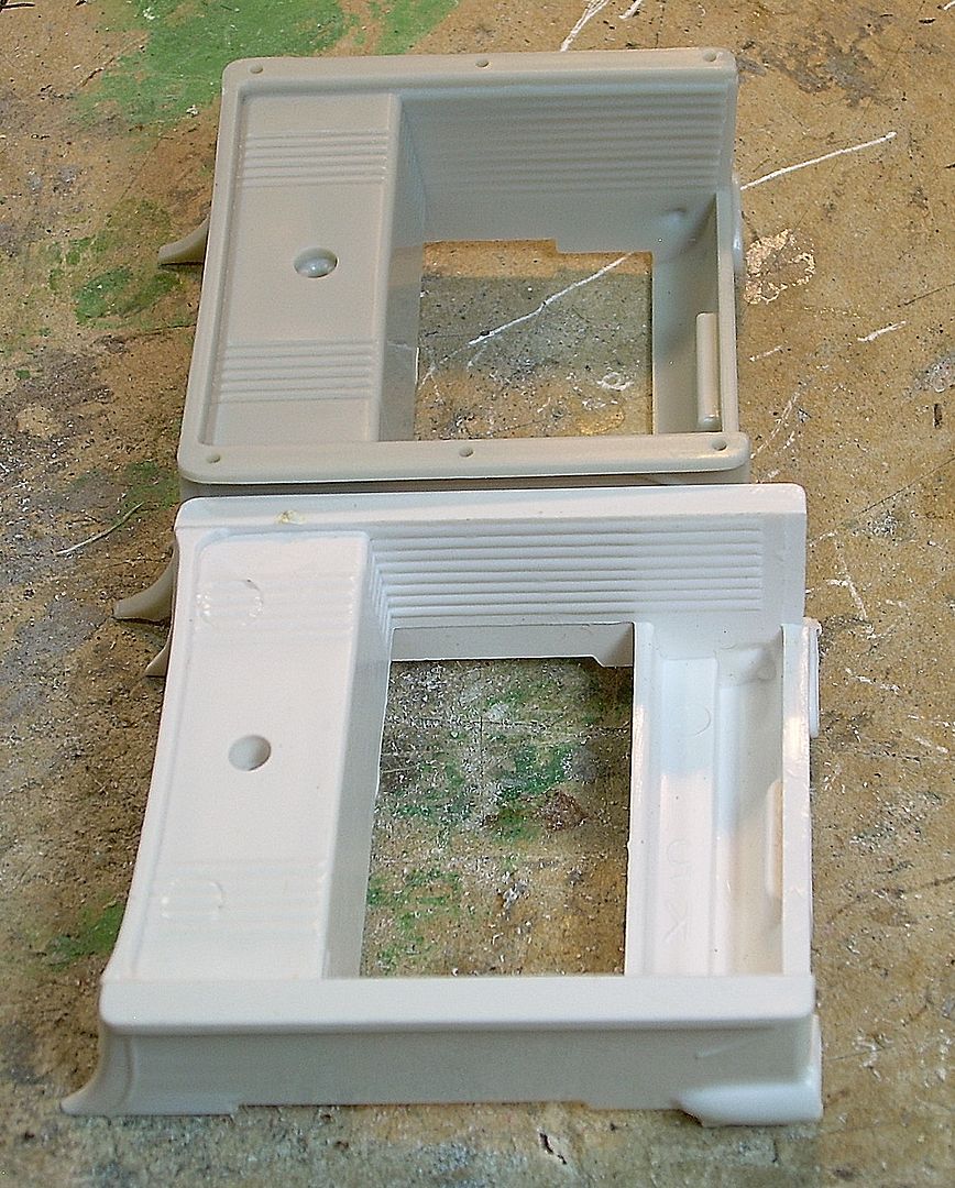

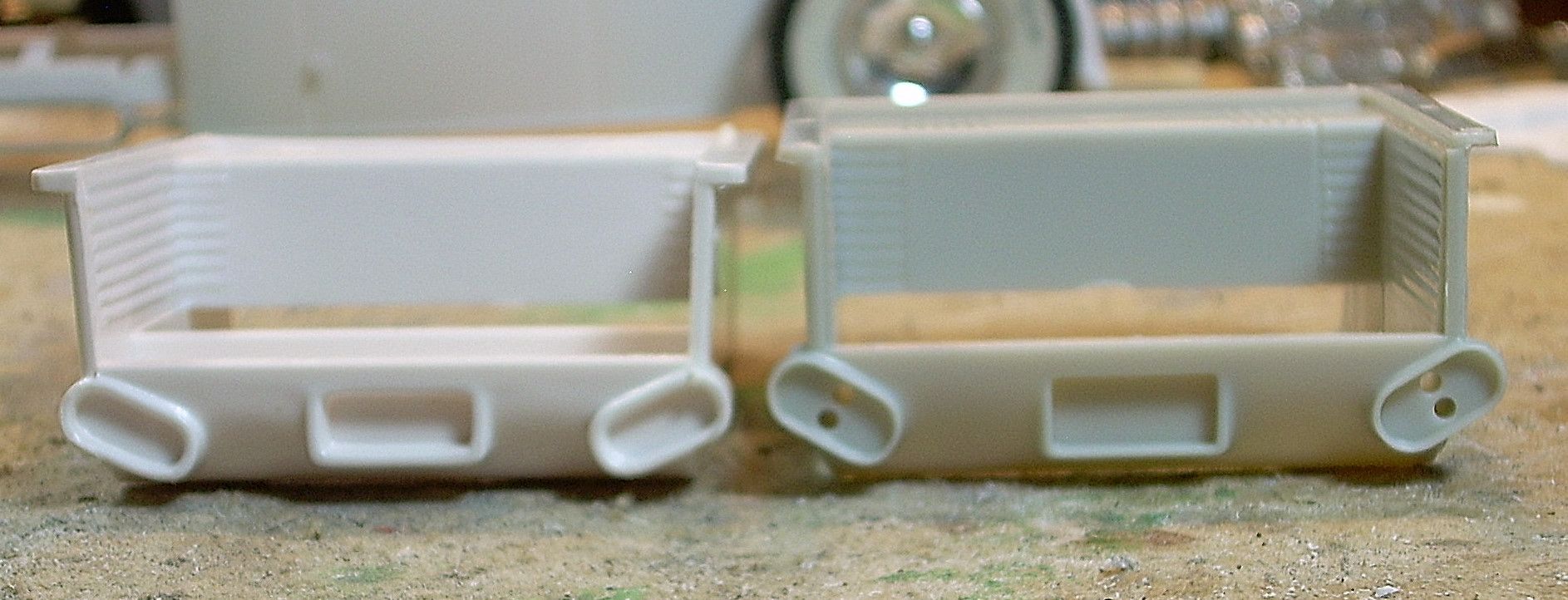

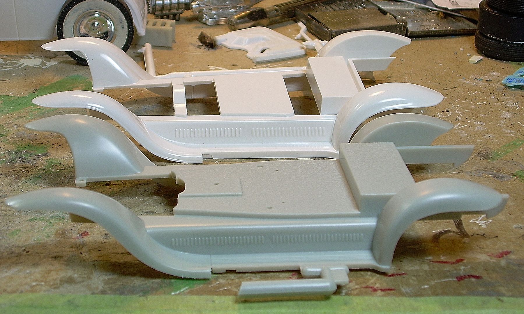

Ace-Garageguy Posted August 30, 2016 Author Share Posted August 30, 2016 One of the things that really sets the two kits apart and drives careful builders and reviewers crazy is the disparity in the shapes of the grille shell and cowl, which are the most important styling elements of this vehicle. The hoods are also remarkably different in length, and carry the shape differences almost all the way back to the cowl...where they get kinda close. Quote Link to comment Share on other sites More sharing options...

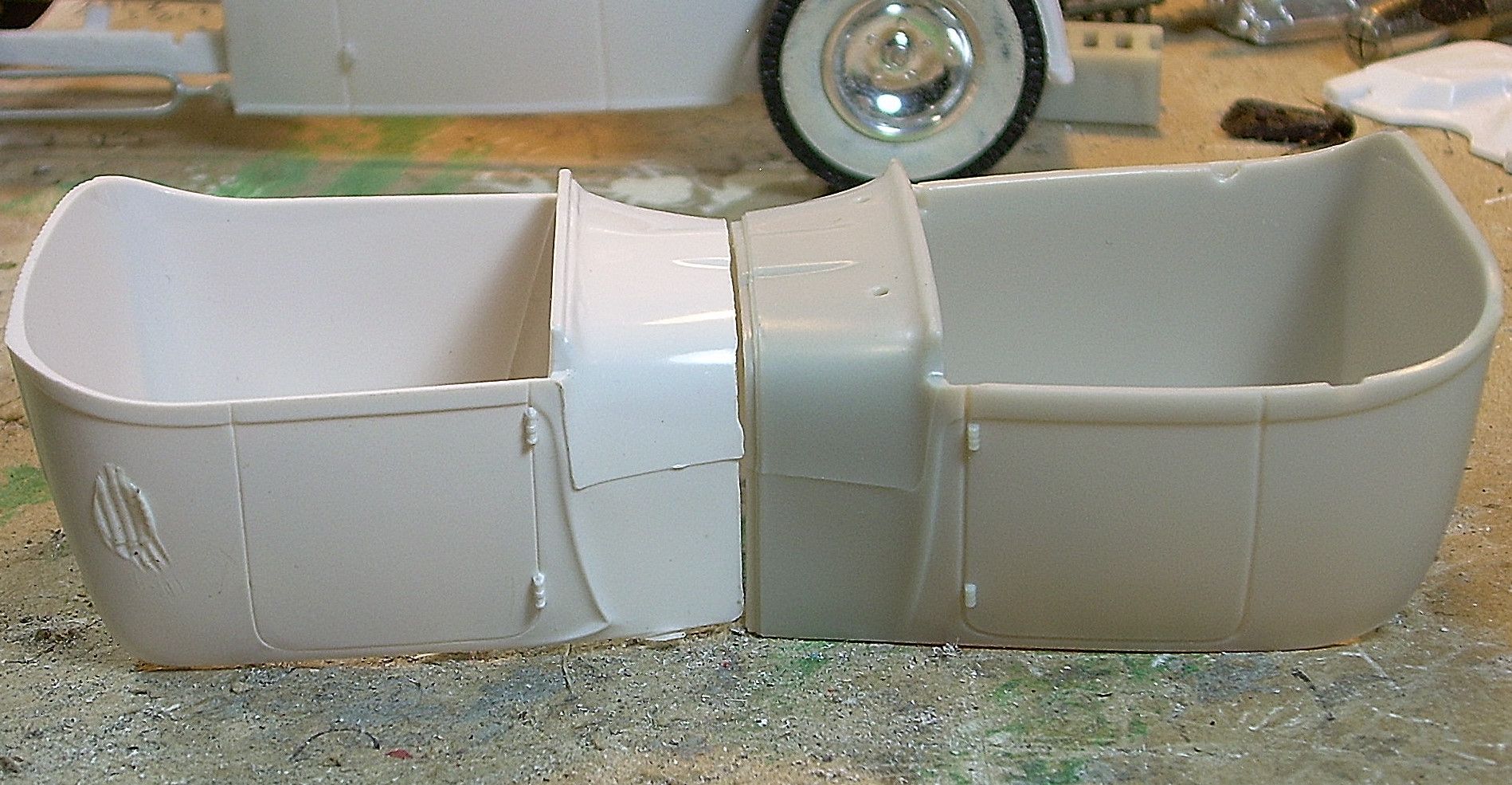

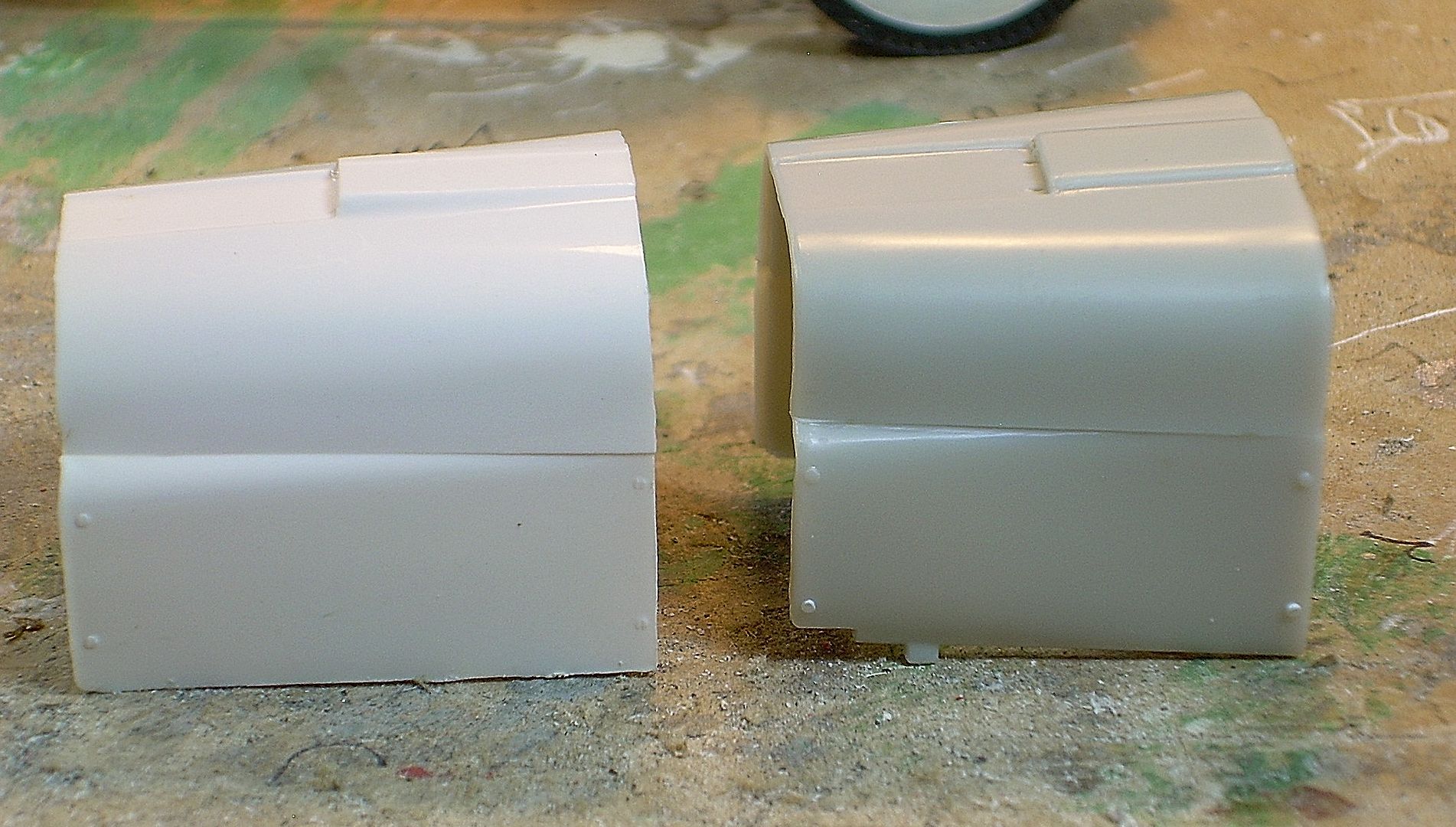

slusher Posted August 30, 2016 Share Posted August 30, 2016 Thanks, Bill i just learned something. I never knew how much difference between them. Is that a tire mark on the side of the cab on the old tool??? Quote Link to comment Share on other sites More sharing options...
Ace-Garageguy Posted August 30, 2016 Author Share Posted August 30, 2016 Thanks, Bill i just learned something. I never knew how much difference between them. Is that a tire mark on the side of the cab on the old tool??? Yes sir. Tire burn on the 55 year-old part. Hard to believe that particular kit survived with no other damage and almost all the parts still on the trees. But then again, there were around one million original-issue Ala Kart kits sold. Quote Link to comment Share on other sites More sharing options...
