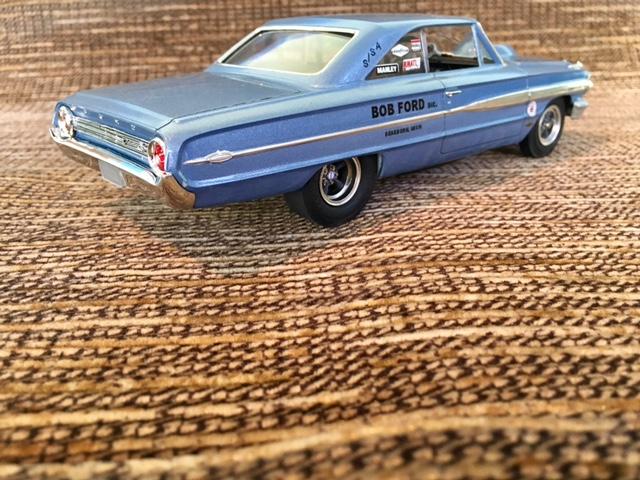

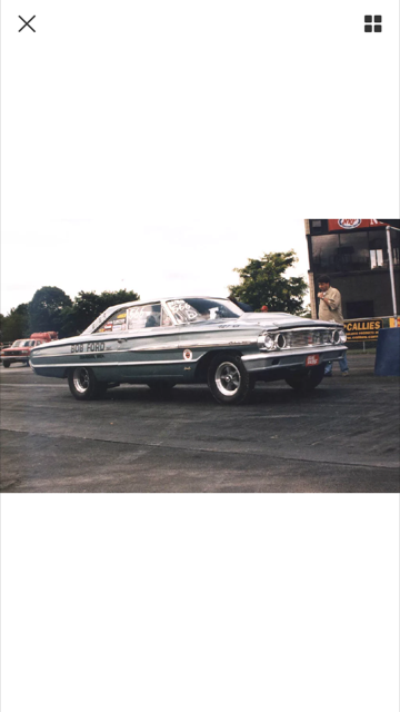

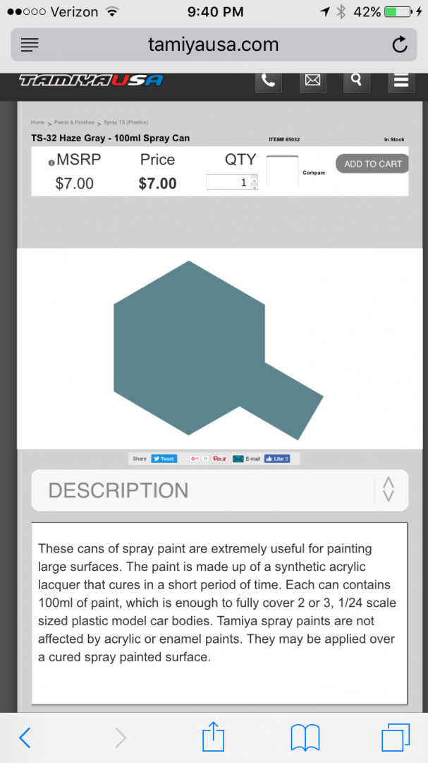

Brutalform Posted November 1, 2016 Posted November 1, 2016 Decided to build a Big Ford. I wanted to build a drag car, that represents this one in the pic. Since there are decals for it, I decided to do it. I cant find any other pics of it besides the one here. I have to head down to the hobby shop, and decide if its going to be Tamiya TS32 Haze Gray, AS10 Aircraft Ocean Gray, or AS26 Light Ghost Gray. Of the available colors for the 1964 Ford Galaxie seem to be either ford Silver Smoke Gray, or Ford Silver Blue. Was the car repainted by the dealer another color? That I don't know. Or what the interior color was for that matter. If I cant find out, it will most likely be close to the exterior, or black. I'm using the AMT Pro Shop body, with the hood removed, and using the AMT 60 Starliner, for the floor, frame and suspension. Any input from anyone on the color would be greatly appreciated. Maybe someone has seen the car at a drag strip? Quote

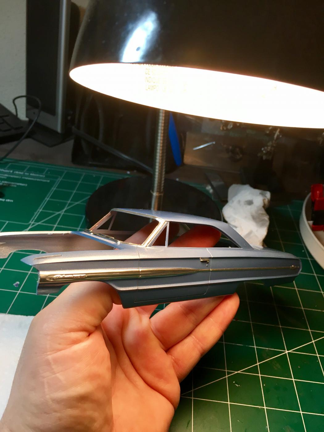

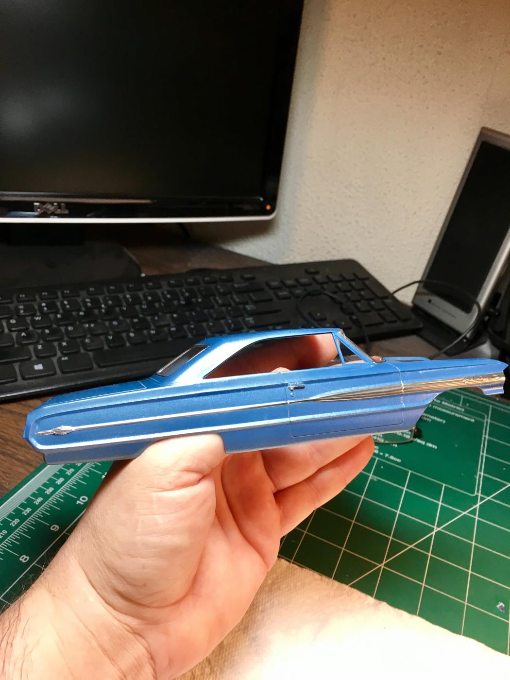

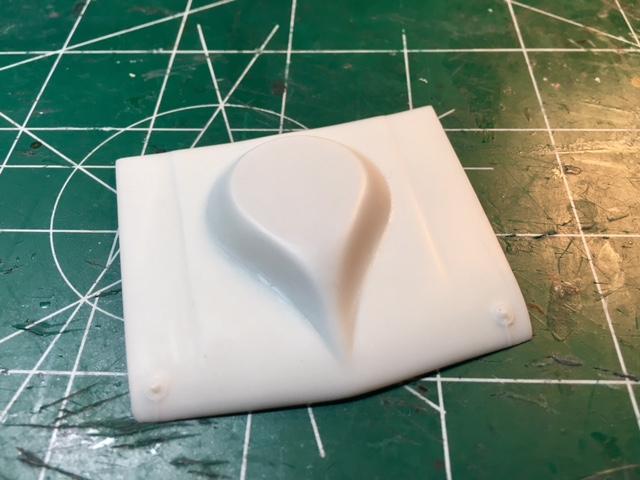

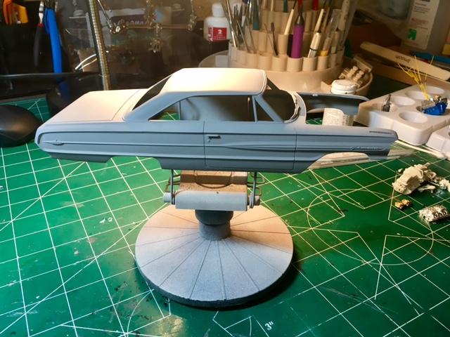

Brutalform Posted November 1, 2016 Author Posted November 1, 2016 I already got a jump on the body work, by removing the hood. Plan on using a resin "teardrop" in place of it. Had to remove mold lines near both roof sail panels, and the two low spots on the trunk. Also deepened the panel lines as well. Quote

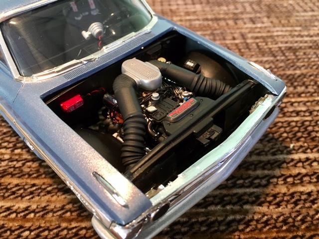

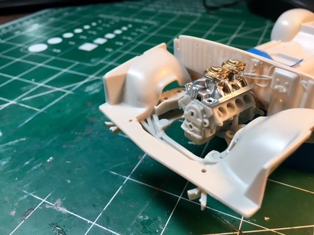

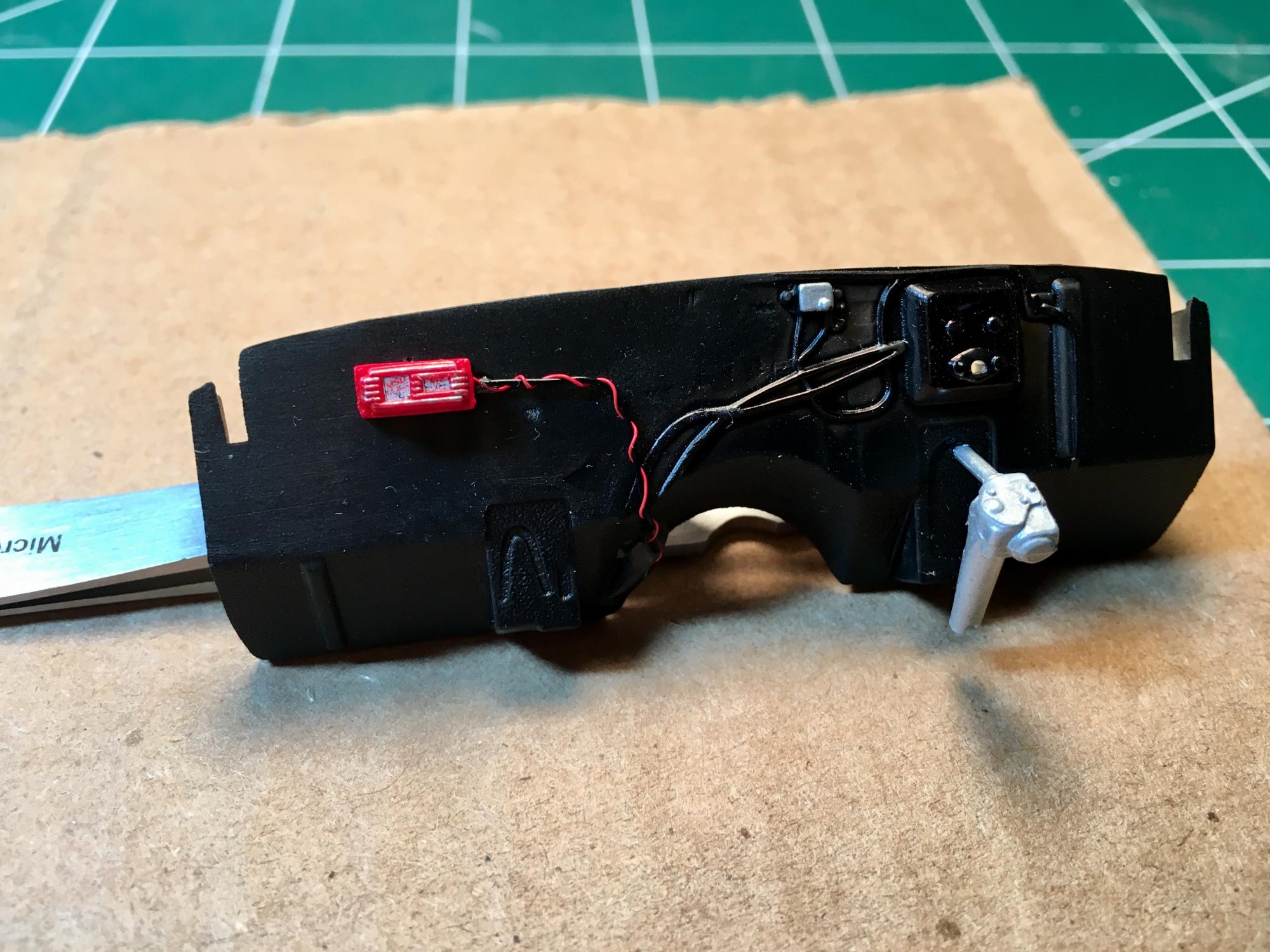

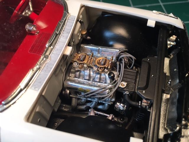

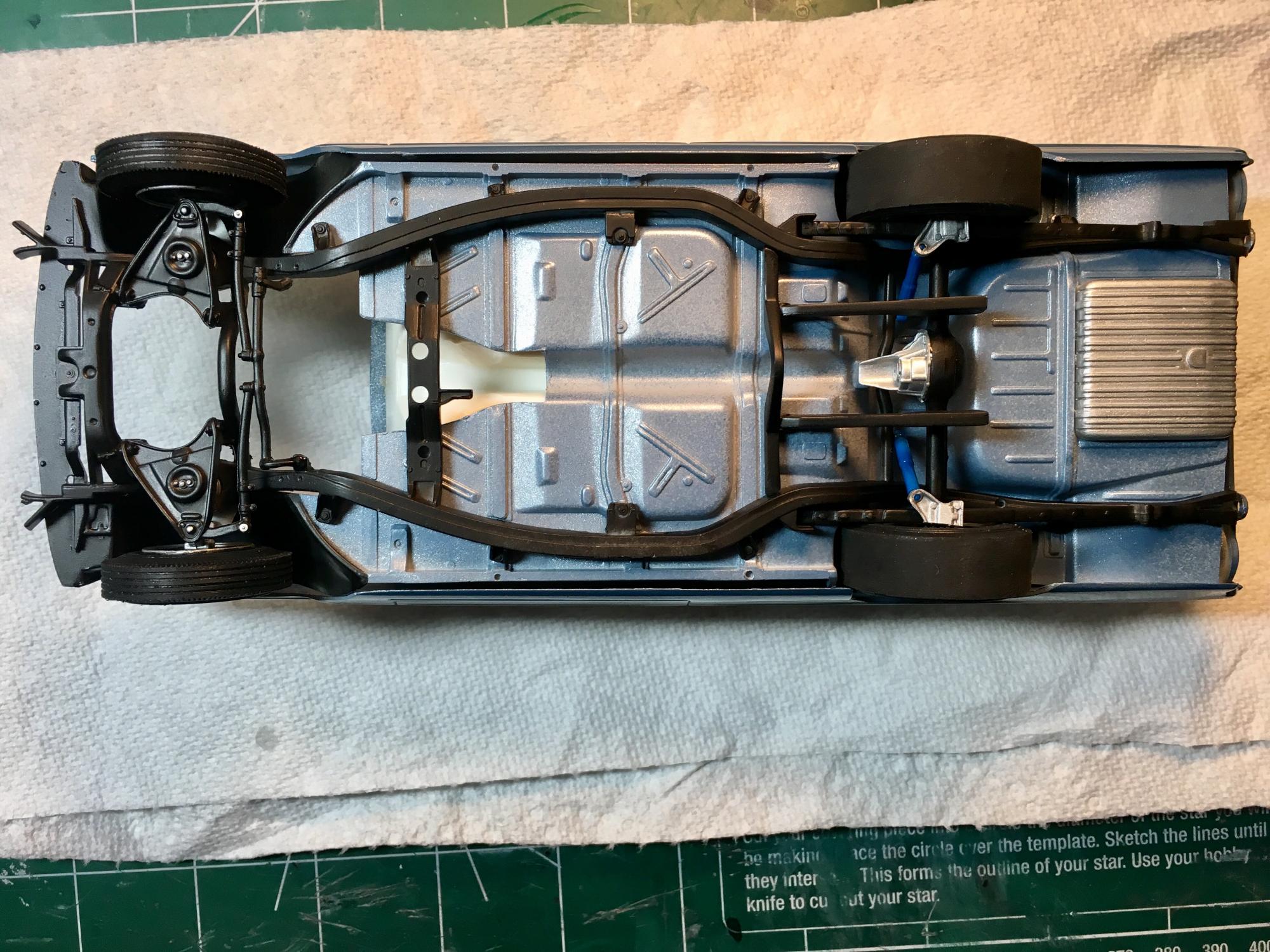

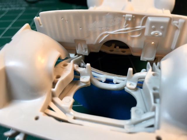

Brutalform Posted November 1, 2016 Author Posted November 1, 2016 Started to smooth the unnecessary items from the firewall, that are not needed on a drag car. Also used the Starliner short block and trans, to be built up to resemble the 427. Quote

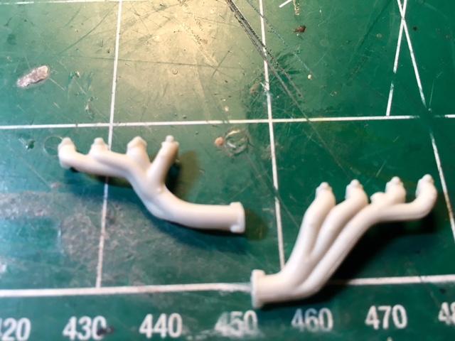

Brutalform Posted November 1, 2016 Author Posted November 1, 2016 I took the cast iron headers out of another AMT Starliner "CUSTOM" kit I have. I always spent a lot of time making headers for the 64 Galaxies I built fit decent.. So this time, I am going to give it a try to build "solder" headers using these as a template, so it will fit the chassis correctly like these will. The solder headers will have a longer tube collector though. Quote

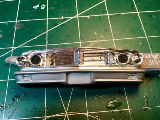

Brutalform Posted November 1, 2016 Author Posted November 1, 2016 I drilled the inner headlights out of the grill, and fitted some T Bolt screens in their place. Also replicated an aluminum bumper. Just need to apply a wash and detail it a bit. Quote

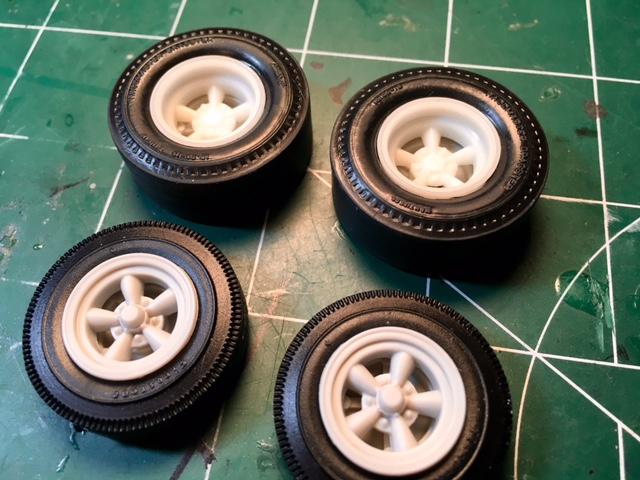

Brutalform Posted November 1, 2016 Author Posted November 1, 2016 The wheels and hood that will be used. Quote
gtx6970 Posted November 1, 2016 Posted November 1, 2016 The car you have pictured I am almost positive was a silver blue color BUT, there was also a white car Quote
fairlane1320 Posted November 1, 2016 Posted November 1, 2016 The gray car is a tribute car, the white one is the real deal. Quote
gtx6970 Posted November 2, 2016 Posted November 2, 2016 Yep, Silver blue car is a tribute. the one and only original was white Quote
Brutalform Posted November 2, 2016 Author Posted November 2, 2016 Thanks for the info everyone. Especially the picture. I've built the Osborn Trucking car, and a couple of lightweights. Always painting them either Racing White, or Wimbledon White, and White, it be nice to do one another color. The decals will allow me to do two cars. I can also do the Jim Heather INC. Ford Galaxie. Quote
Brutalform Posted November 3, 2016 Author Posted November 3, 2016 Thank you..... This Tamiya color looks pretty close to the Blue Silver. If I had an air brush, getting the correct colors would be much easier. Quote
Brutalform Posted November 4, 2016 Author Posted November 4, 2016 After spraying the Haze Gray on a spoon with and without gray primer, looks only a tad brighter than the primer itself. Going to head to the auto parts store tomorrow, and see if I can find a color that actually looks like Silver Blue. Quote

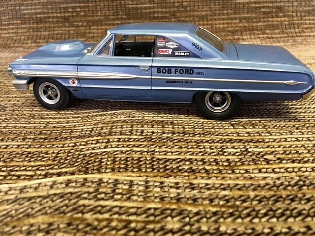

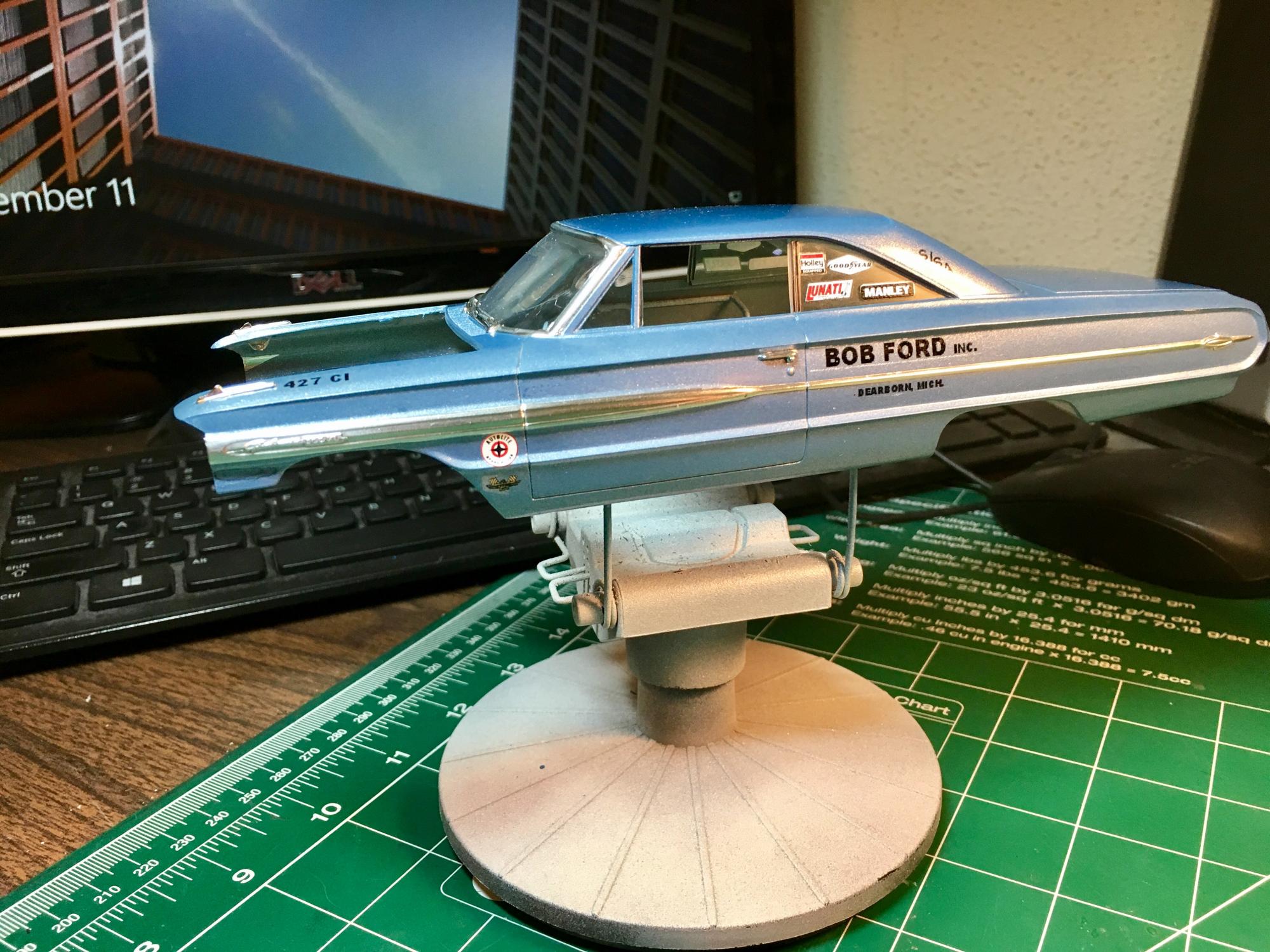

Brutalform Posted November 9, 2016 Author Posted November 9, 2016 Worked on the big Ford, along with the TBolt. I really got to get an airbrush. Kind of at the mercy of available spray cans. Painted a Duplicolor GM color . It was the closest color I could find. Too much metallic IMO. The clear laid really smooth on the sides of the car, but I had to micro mesh the roof and trunk as it had a slight orange peel. Polished it with Novus 3 step. Just a little mock up. The front will sit lower on final assembly. Maybe I'll do the foiling tomorrow. Quote

Brutalform Posted November 10, 2016 Author Posted November 10, 2016 Thanks Niko. I appreciate it. Did some foiling on the Galaxie today. Quote

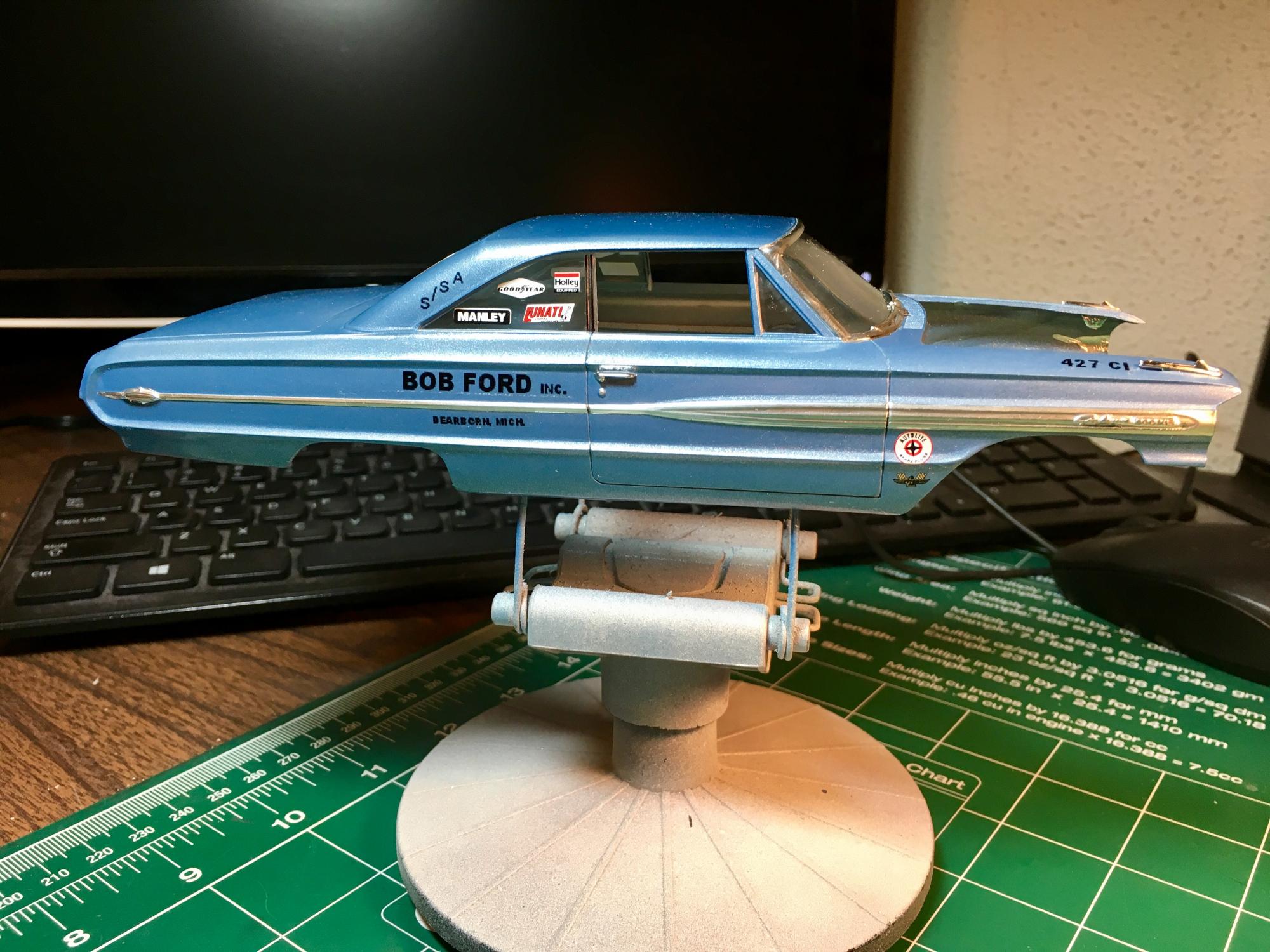

Brutalform Posted November 11, 2016 Author Posted November 11, 2016 The decals are done. Even though the side windows are not a match, I had to make do with the decals I had. Quote

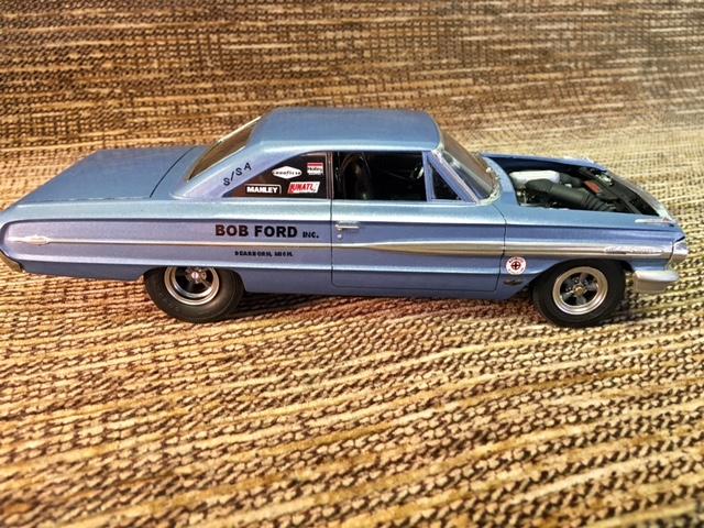

Brutalform Posted November 12, 2016 Author Posted November 12, 2016 Thank you Mike. I worked on a few details this morning on the Galaxie. Quote

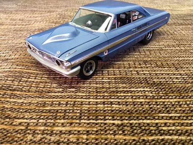

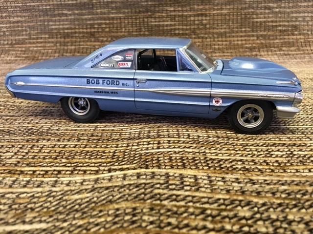

Brutalform Posted November 16, 2016 Author Posted November 16, 2016 Finished the Galaxie last night. Usually I have to play around with the front end, when using the Starliner chassis. This one really became difficult. I lost two front fender top decals in the process, But its finally finished. Quote
