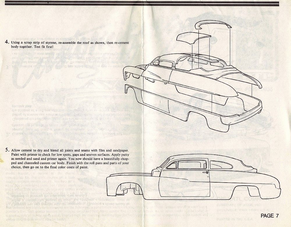

Casey Posted December 13, 2016 Posted December 13, 2016 The AMT '49 Mercury Customizing Series kit includes directions to do exactly what you're asking about:

Ace-Garageguy Posted December 13, 2016 Posted December 13, 2016 (edited) Another few words of caution: cutting the roof of these cars into multiple sections as shown on the post above is NOT recommended (by me), as it creates a vast amount of additional work, introduces HUGE potential to get things all wonky and out-of-square, is rarely done on a real car, and is simply unnecessary.You MAY find you want to lengthen the roof both forward and behind the door-cut-line on the B-pillar, but generally, just leaning the A-pillar back does the trick in front (and makes the car look slipperier).Widening the roof like this before you drop it can also lead to a car that has a too-fat-at-the-top appearance.It's done to get the pillars to line up (and on a real car, to avoid the necessity of modifying the window tracks to accommodate a different angle of inward-tilt) but that is MUCH better achieved on a model by pie-cutting the pillars, or simply bending them to where they need to be.Just remember that pleasing proportions are the single most important goal in chopping a car. Edited December 13, 2016 by Ace-Garageguy
Bernard Kron Posted December 13, 2016 Posted December 13, 2016 (edited) Another few words of caution: cutting the roof of these cars into four sections as shown on the post above is NOT recommended (by me), as it creates a vast amount of additional work, is rarely done on a real car, and is simply unnecessary. Widening the roof like this before you drop it can also lead to a car that has a too-fat-at-the-top and a too-long-roof appearance. It's done to get the pillars to line up, but that is MUCH better achieved by pie-cutting the pillars, or simply bending them to where they need to be Tim Boutte's elegantly simple approach I linked above (to repeat: http://www.customcarchronicle.com/forums/topic/1949-mercury-in-scale/ ) leaves the roof intact and relies virtually exclusively on surprisingly small amounts of additional styrene strip for detail filling. Plus it looks great! Edited December 13, 2016 by Bernard Kron

Mark Posted December 14, 2016 Posted December 14, 2016 Another few words of caution: cutting the roof of these cars into multiple sections as shown on the post above is NOT recommended (by me), as it creates a vast amount of additional work, introduces HUGE potential to get things all wonky and out-of-square, is rarely done on a real car, and is simply unnecessary.I've got one of the George Barris photo books from maybe twenty years ago, and in it there's a couple of pages devoted to a '54 Mercury hardtop that someone rolled into their shop. The guy cut the roof into four pieces just like that. The thing was a mess. They wound up getting another roof from a wreck and starting over with the chop.The early issues of the AMT '57 Chevy include a chopped top option. Same deal: cut the roof into four sections, lay them over a clear piece that includes the windshield and rear glass, and putty the seams. You're supposed to mask the glass before priming and painting. I've got one of those chops roughed in; it looks absolutely hideous. The "four-piece roof" method is definitely NOT the way to go.
