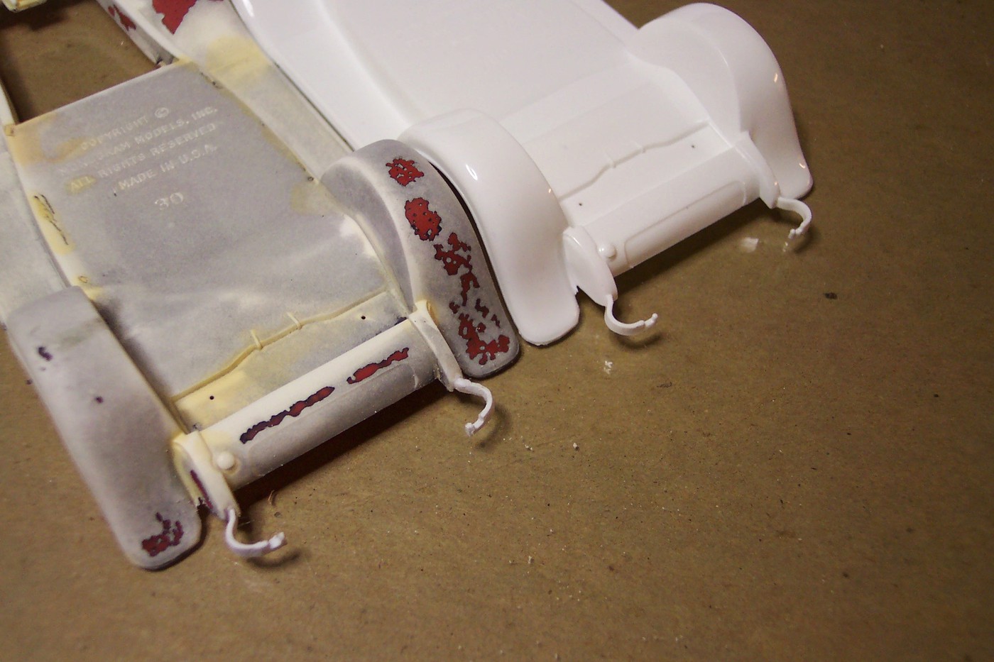

TooOld Posted December 18, 2016 Share Posted December 18, 2016 (edited) After being absent for more than a year I finally have one on my bench ! I picked up this Little Deuce last November with plans to restore it back to original form . Disassembly was about as expected with the only casualties being one exhaust manifold and the front axle . It took two days and a couple of trips to the purple pond to get the parts to this point . Some of the paint is being really stubborn . First order of business is to replace the broken bumper mounts . I used a part from a reissue as a pattern and traced the shape onto some plastic . After some grinding with a Dremel I used a small file to fine tune the shape of the mounts . Also some notches were filed in the ends of the frame . Here's the new bumper mounts glued in place . To be continued . . . Edited February 8, 2020 by TooOld Quote Link to comment Share on other sites More sharing options...

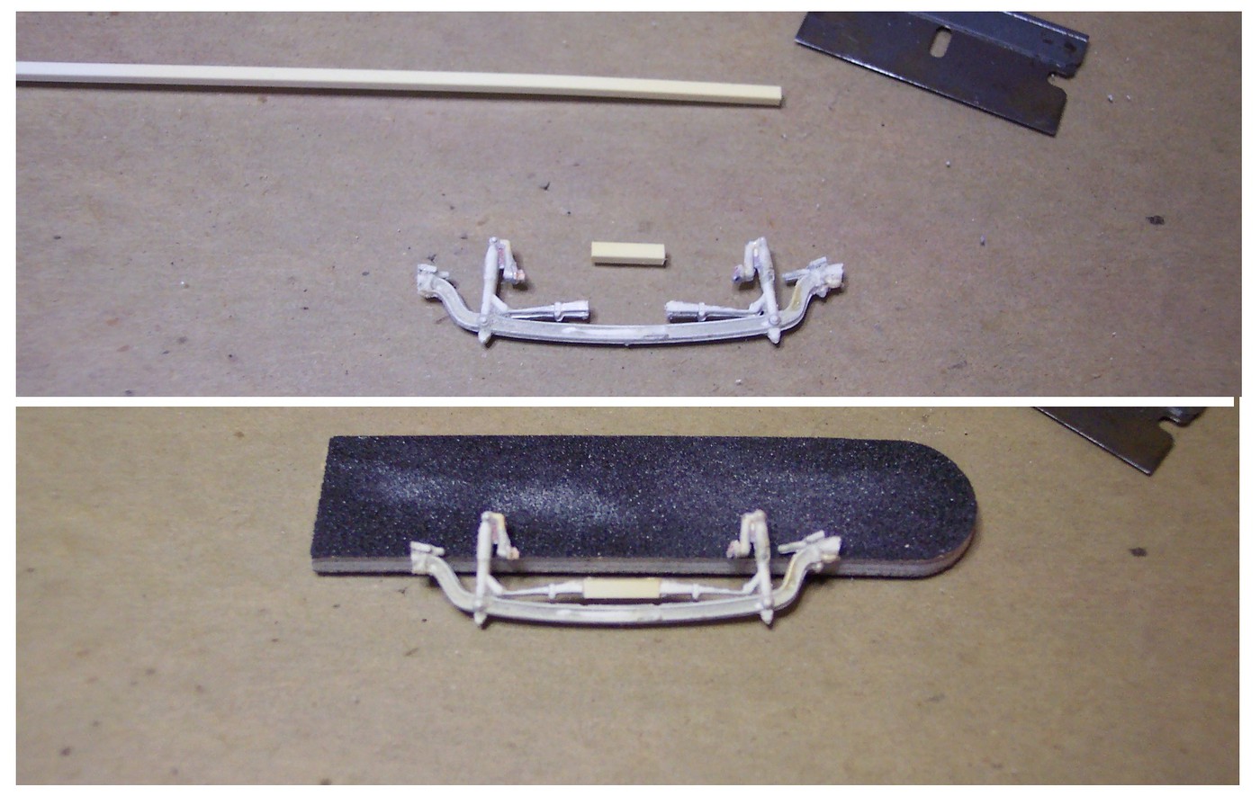

TooOld Posted December 19, 2016 Author Share Posted December 19, 2016 (edited) Next up is to repair the front axle . Both stubs are broken off and the spring is missing where it glues to the chassis . I'm using the spare axle for reference to get the width right . The center of the spring is replaced with a small block of plastic . Nothing fancy , it's just adds a little support and it won't be seen after the axle is installed. Adding poseable steering is a snap on these kits , just reshape the ends of the axle and drill them to accept a straight pin . Then I like to use a solid block of plastic to cut the knuckle from , but they could be made with 3 separate pieces glued together . After the final shape is achieved it gets drilled and a stub axle made from .062" rod is glued in place . The result should be an axle with the same track as the stock axle . Unforunately this one ended up a bit too wide so I need to redrill the axle and make new knuckles . . . and the one on the left could better . More to come . . . Edited February 8, 2020 by TooOld Quote Link to comment Share on other sites More sharing options...
