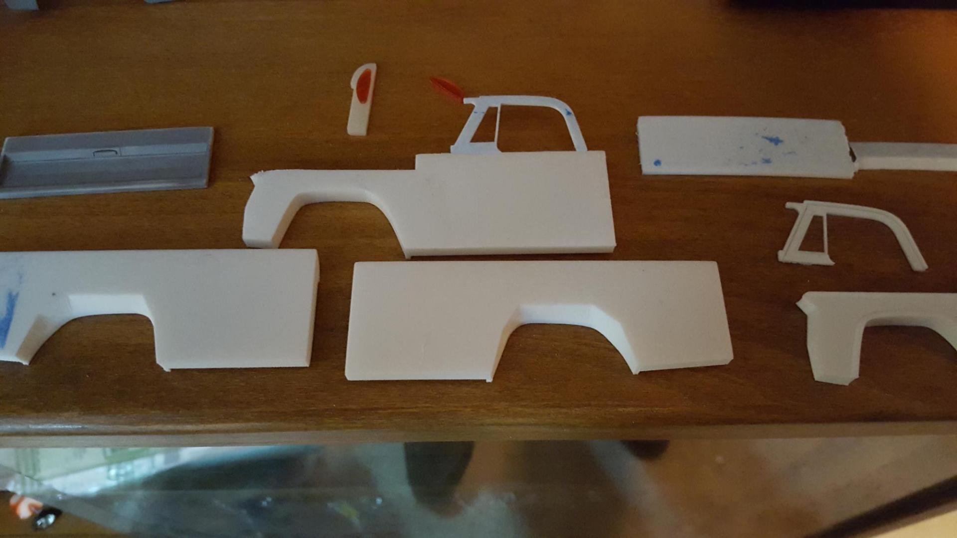

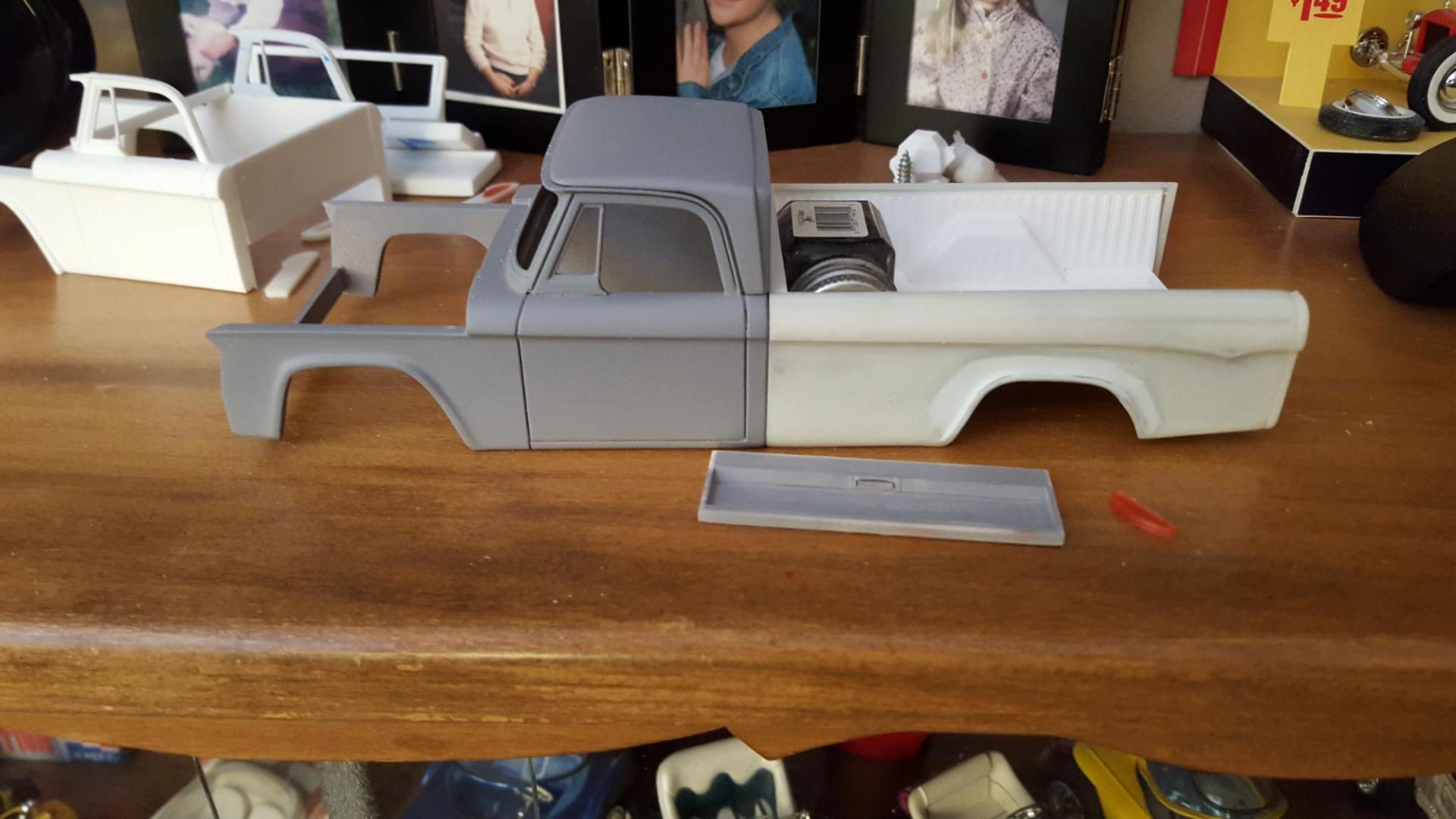

mike s Posted January 8, 2017 Posted January 8, 2017 This is my 3d printed 1/25 truck, did it at home on a ultimaker 2+ and Sketchup. will post more pic soon

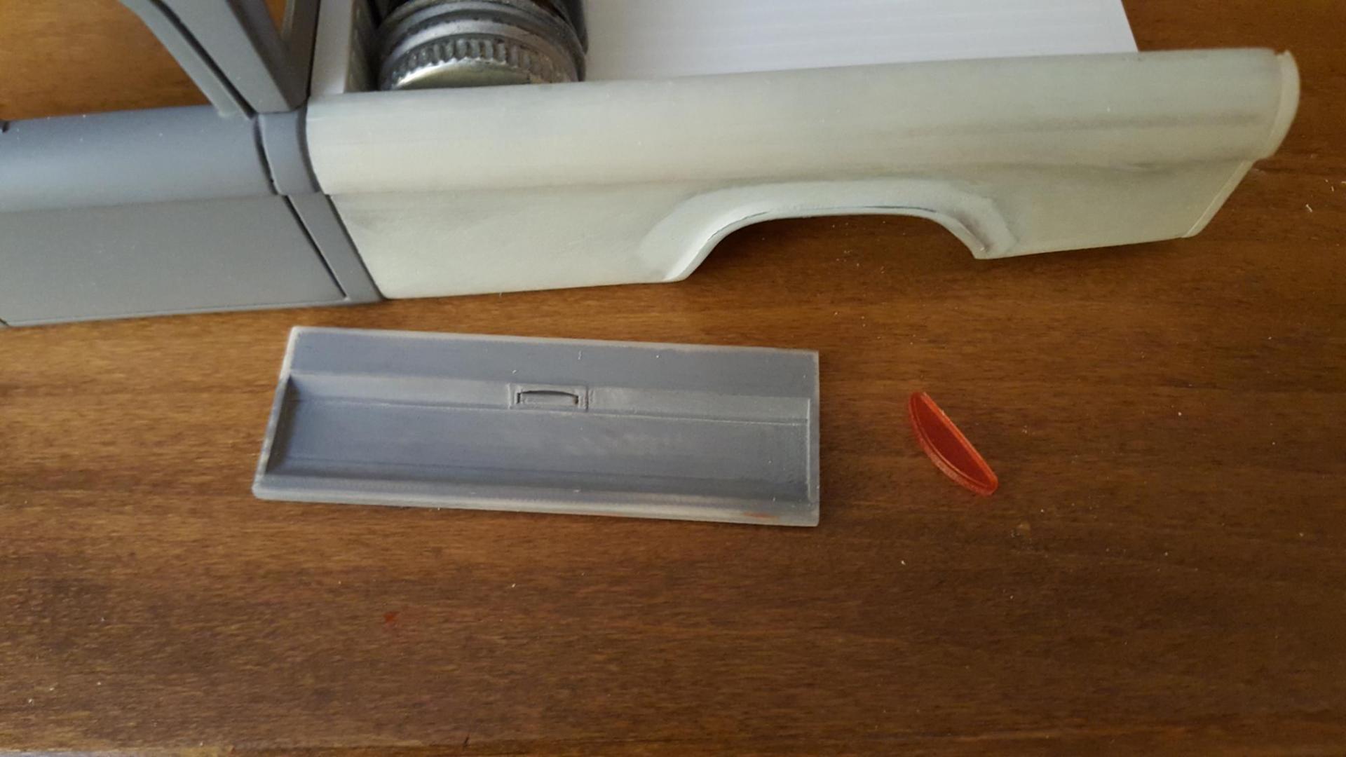

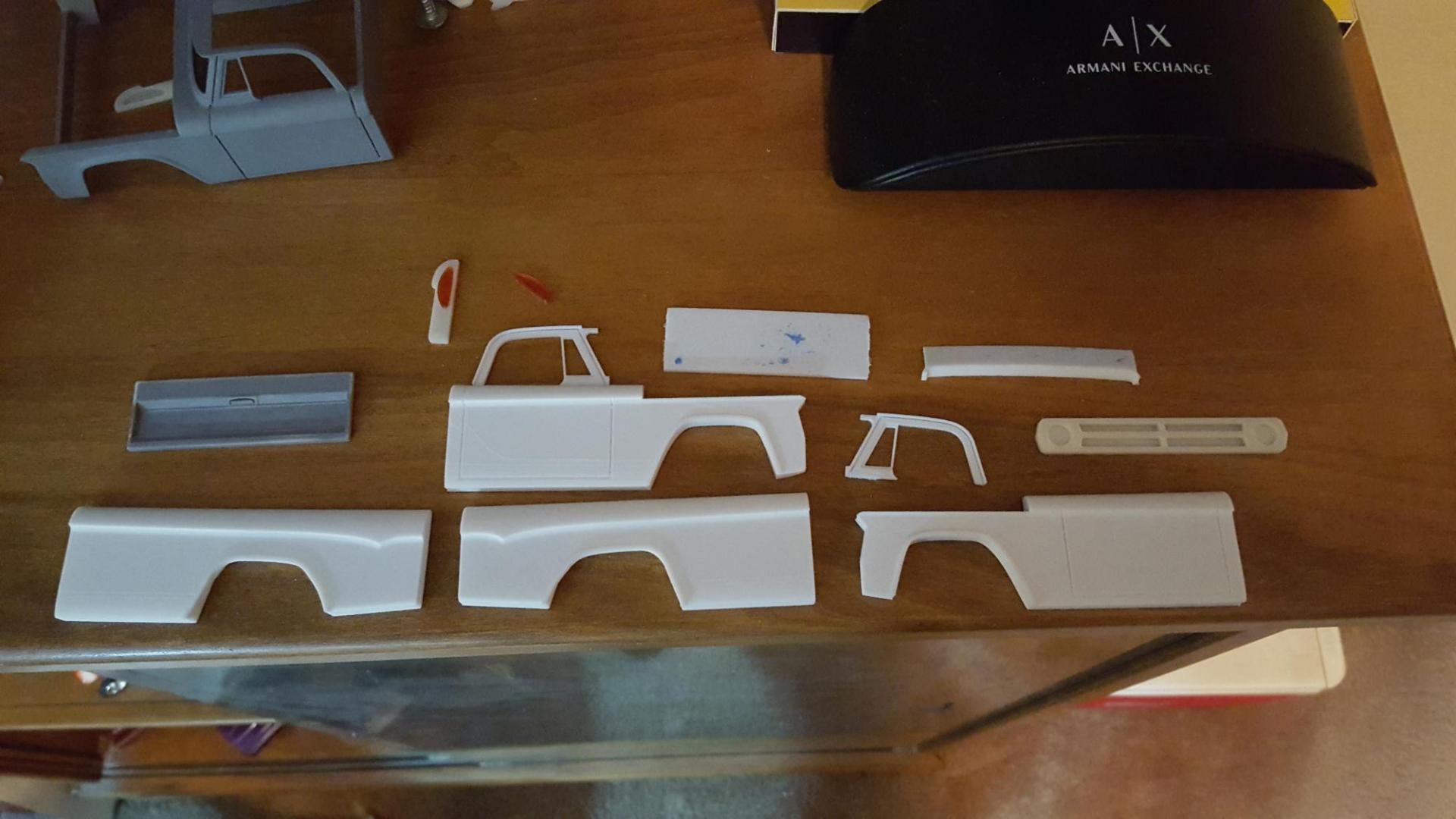

mike s Posted January 8, 2017 Author Posted January 8, 2017 Are you printing the cab and the bed both ? How thick is it compared to the original kit ? How about the frame ? No not printing both cab and bed together. Using a 74 truck kit for parts.You need think of it as a old revell kit, print it flat. If you print in pla it will sand like a rock. Print in abs that is model plastic. I print in pla for test shots and abs for the final result the sides are printed with a .6mm tip at speed 50. comes out like 220 to 100 grit. I only use the outer shell not the back, set printer to a thicker shell. 6mm Tip x2 = .047 inch outer shell. Small parts printed at .25 tip at 15 to 25 speed sand out with 400.I can print down to a .013 line. Printing it will give a good start both sids will be the same right or wrong
