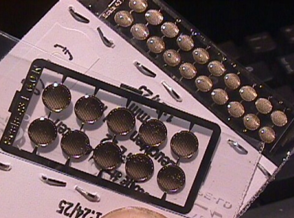

Mike Chernecki Posted February 7, 2017 Share Posted February 7, 2017 Scale Production has a couple different sizes of headlight lenses, very nice.http://www.scaleproduction.de/product_info.php?info=p1294_headlights-7mm.html Quote Link to comment Share on other sites More sharing options...

landman Posted February 7, 2017 Author Share Posted February 7, 2017 Scale Production has a couple different sizes of headlight lenses, very nice.http://www.scaleproduction.de/product_info.php?info=p1294_headlights-7mm.html Thanks Mike, those are the ones I'd seen but forgot where. Quote Link to comment Share on other sites More sharing options...

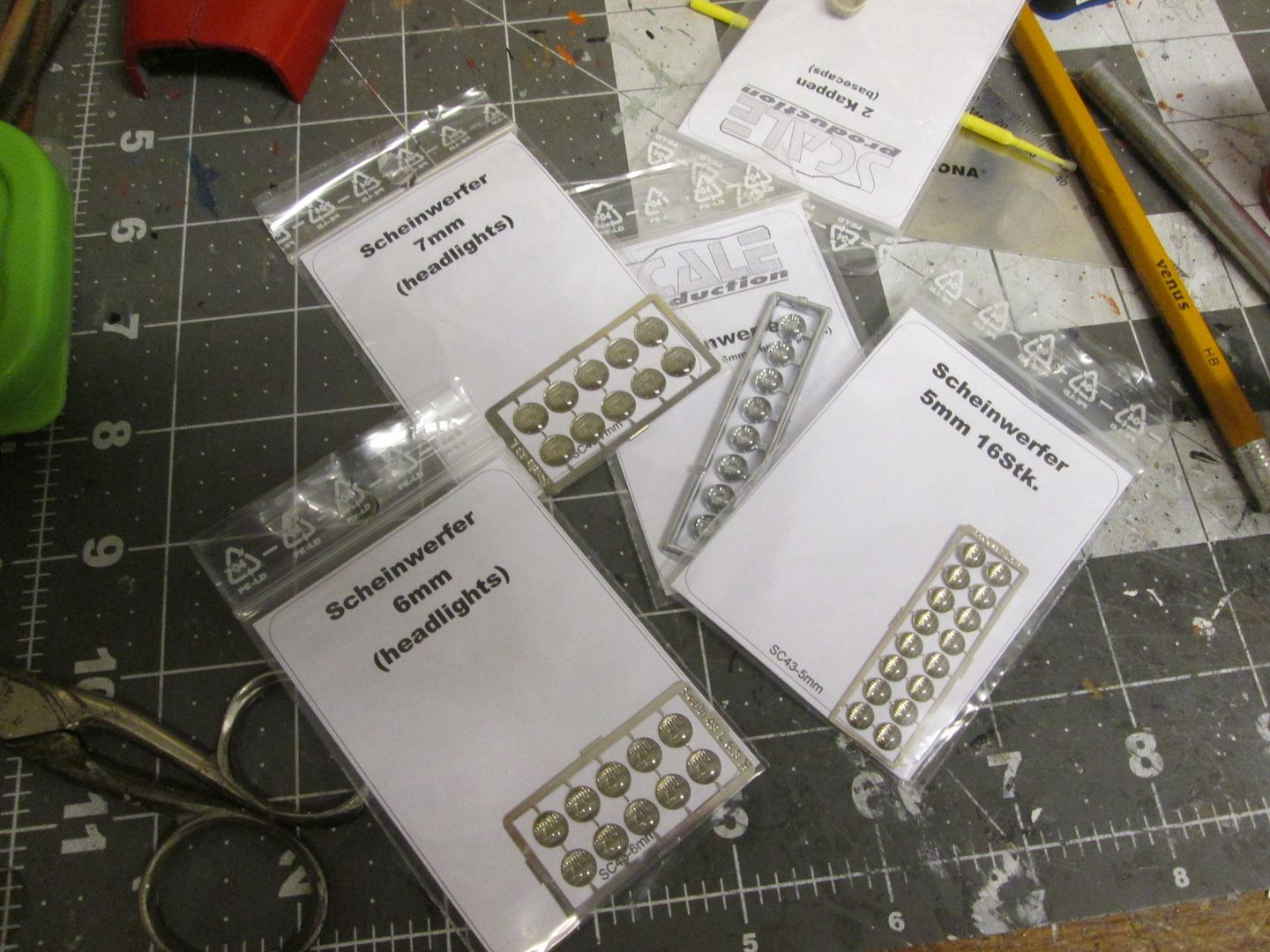

landman Posted February 14, 2017 Author Share Posted February 14, 2017 Got these today. they are gorgeous. And... it is cheaper to ship stuff here from Germany than it is from the US. Go figure. Quote Link to comment Share on other sites More sharing options...

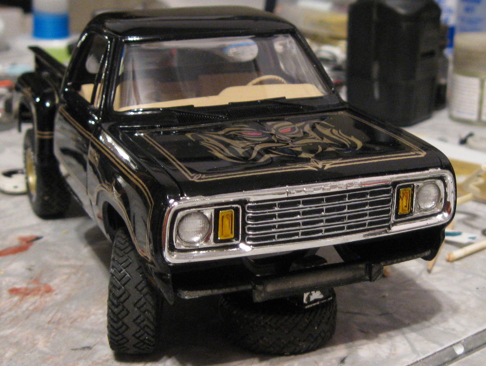

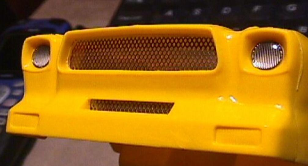

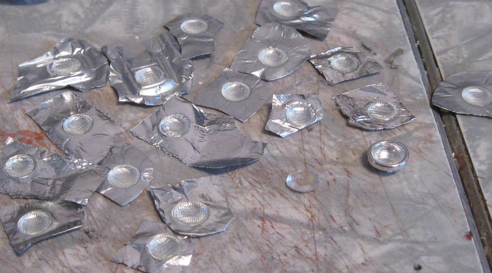

mk11 Posted February 15, 2017 Share Posted February 15, 2017 Here's what another guy (can-con) was doing for lights on his dodge trucks, using a clear resin called 'easy cast'. I've seen it at michaels. Quote Link to comment Share on other sites More sharing options...
peteski Posted February 15, 2017 Share Posted February 15, 2017 Those photoetched lamps with clear resin dome seem to be getting quite popular (they have been used for a while by resin model manufacturers like NEO). They are nice but to me they look a bit dull and 2-dimensional. Real headlamps are very reflective (after all they have a mirror-like reflector inside). I much prefer lenses like mk11 shows. they look 100% more realistic. Quote Link to comment Share on other sites More sharing options...

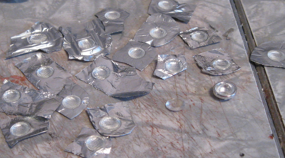

landman Posted February 15, 2017 Author Share Posted February 15, 2017 Those photoetched lamps with clear resin dome seem to be getting quite popular (they have been used for a while by resin model manufacturers like NEO). They are nice but to me they look a bit dull and 2-dimensional. Real headlamps are very reflective (after all they have a mirror-like reflector inside). I much prefer lenses like mk11 shows. they look 100% more realistic.I'm trying to figure this out. looks like he makes mold out of foil then pours the clear resin in there. Is the mold made by wrapping the foil on a kit lens? Quote Link to comment Share on other sites More sharing options...
mk11 Posted February 15, 2017 Share Posted February 15, 2017 That's what it looks like. Find one nice lens and you're set. mike Quote Link to comment Share on other sites More sharing options...

Can-Con Posted February 16, 2017 Share Posted February 16, 2017 That's what it looks like. Find one nice lens and you're set. mike Exactly. And the foil mold doubles as the reflector if you want. I use a soft pencil eraser to press the foil down on and around the kit lens to get as much detail from it as possible. I made about 3 dozen in about a 1/2 hour one afternoon. Quote Link to comment Share on other sites More sharing options...
