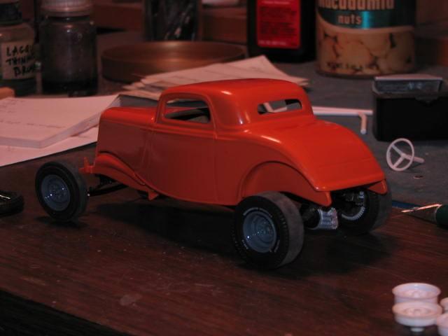

Straightliner59 Posted February 13, 2017 Posted February 13, 2017 In mid-March, I will be leaving Minnesota after almost 14 years, and returning home to Colorado. As my time here dwindles, I picked up Revell's '34 coupe snapper, determined to finish something...anything, before I go. Just a few of the modifications I've made include a scratchbuilt rear spring, a front axle from Revell's old Model A Pickup kit, aluminum door panels, firewall, dash and seat made from .005" aluminum flashing (GREAT stuff! Especially after its been sanded free of its plastic coating, and annealed.). The spindles are scratched from Evergreen channel, strip and rod. Front wheels are from a Revell Thunderbolt kit, rears from an old AMT Deuce. Shocks are aluminum tubing with mounts (and tie rod ends) made of HO scale handrail stanchions. Orange paint is Krylon, directly from the can. It's not my best work, but, I am really burning it at both ends, trying to finish it before I am packed and on the road! Comments welcome. Oh, yeah--this complies with NHRA rules for a modified coupe in either 1959 or 1960.

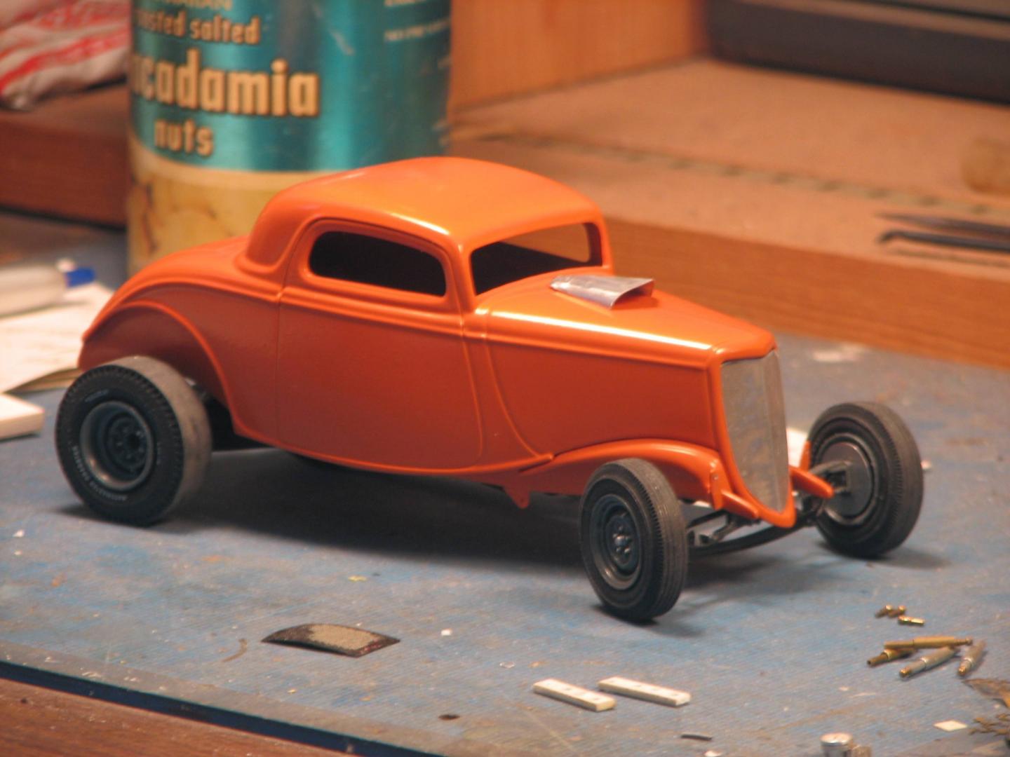

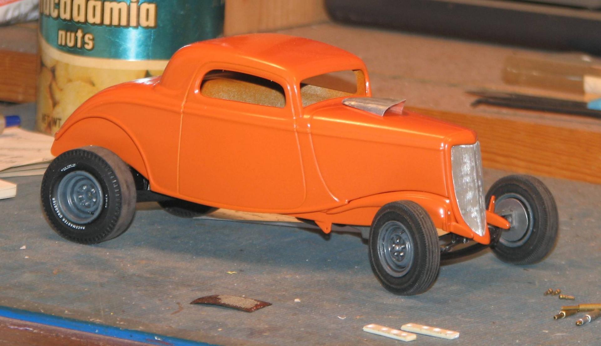

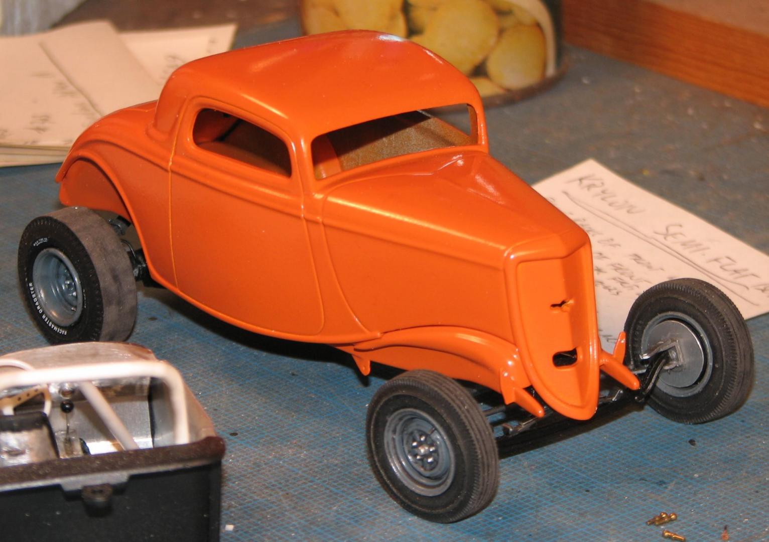

Straightliner59 Posted February 14, 2017 Author Posted February 14, 2017 Thanks, Mike. I love doing that stuff. For this application, I prefer to use contact cement to bond the aluminum to plastic, and to itself, because you don't have to create a huge surface area to achieve excellent adhesion--just a small flange. I've got it up on the wheels since my last post. I moved the front axle forward about three scale inches.

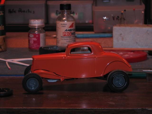

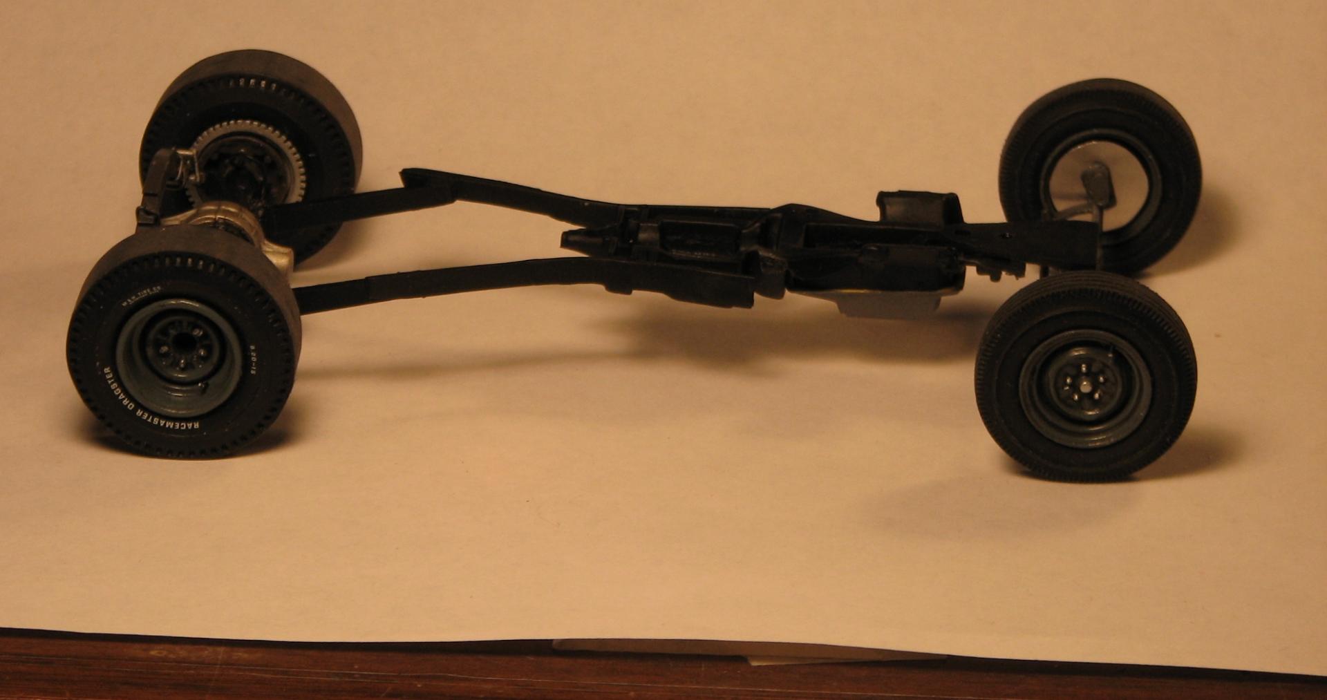

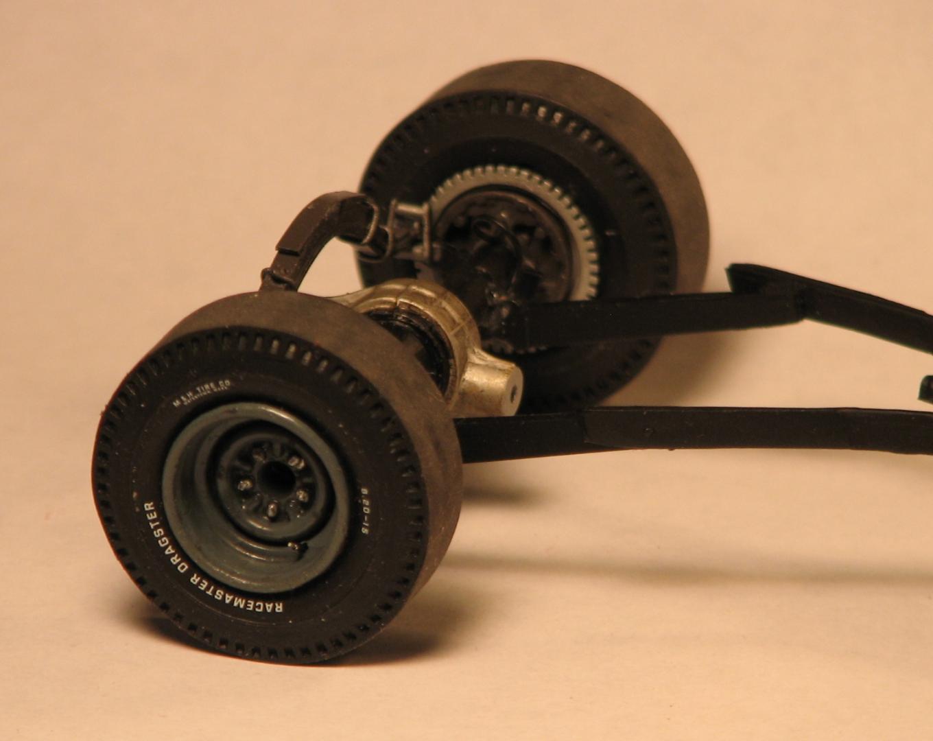

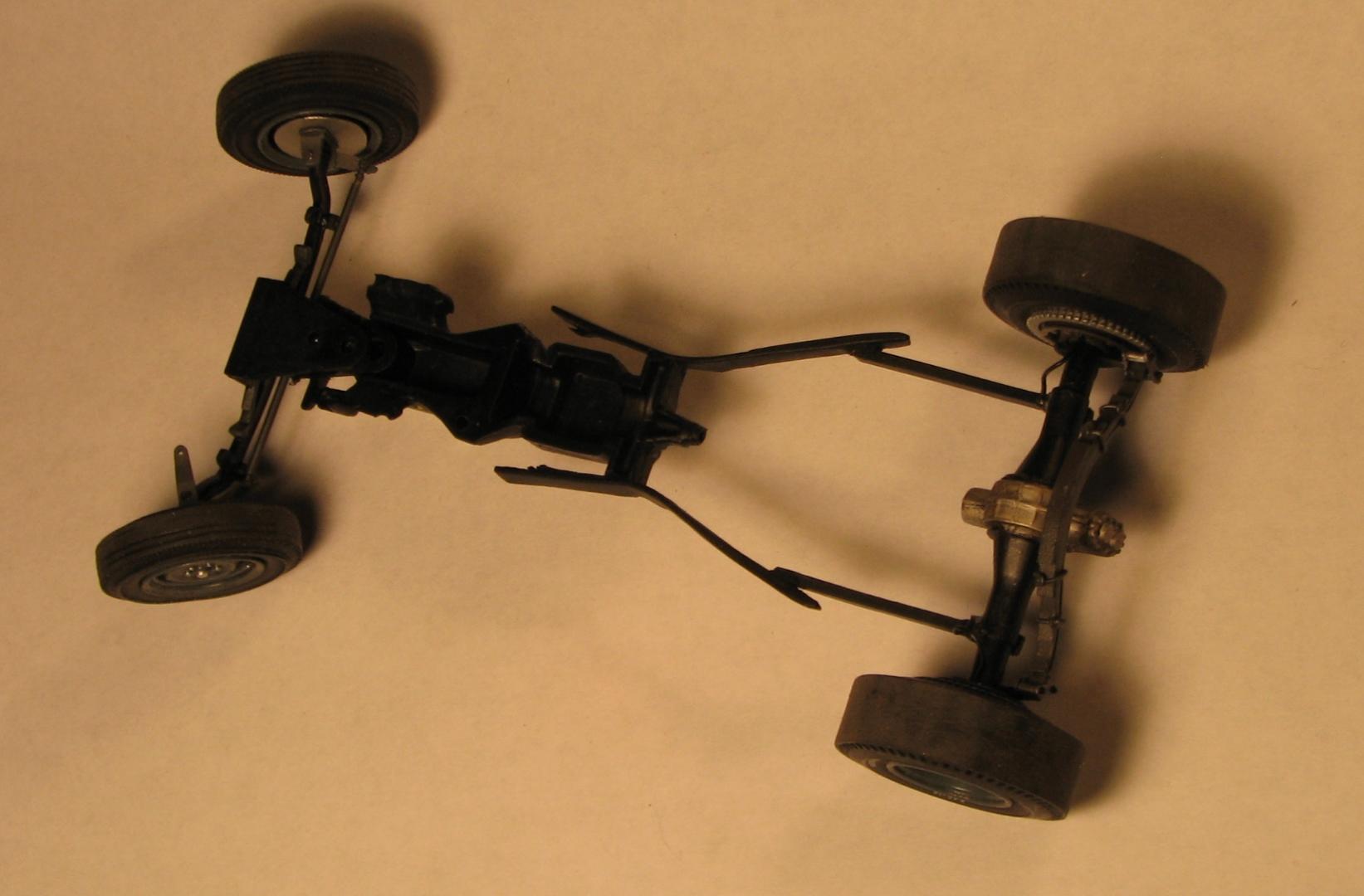

Straightliner59 Posted February 14, 2017 Author Posted February 14, 2017 The finished wheels and tires are now permanently mounted to the "chassis" Just a few minor details left, on this, then, I can finish the interior.
Bernard Kron Posted February 14, 2017 Posted February 14, 2017 (edited) OK! The posable steering will look great on the finished product. And you gotta dig the "chassis". cum lower engine detail thing happening. The crisp and accurate period detailing on the suspension parts and brakes already hint on what a fine model this is shaping up to be. I love the utilitarian colors.I was trying to remember how I handled the stance problem so I went back to look at my build and, while I didn't go whole-hog and cut out the chassis details like you did, I did land up ditching the kit rear end and substituting a separate Revell 1/25th Deuce piece while keeping the Snaptite radius arms and springs, lowering the whole thing a couple of scale inches. At the front, like you, I relocated the kit front suspension mounting tab, in my case lowering 4 scale inches. Edited February 15, 2017 by Bernard Kron
Straightliner59 Posted February 15, 2017 Author Posted February 15, 2017 "Chassis" is the only way to describe this assembly, even though the majority of the chassis is molded to the floor section.grin I've always loved things that are utilitarian. That's probably why I gravitate so much toward dragsters--especially earlier ones. I much prefer paint to chrome. Given a choice between the "California Charger", and, "The Bug"...well, I built a replica of the latter!I actually raised this one, a couple of inches.

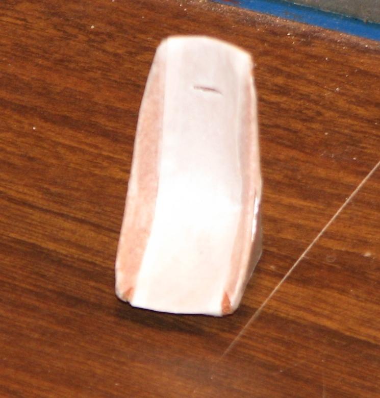

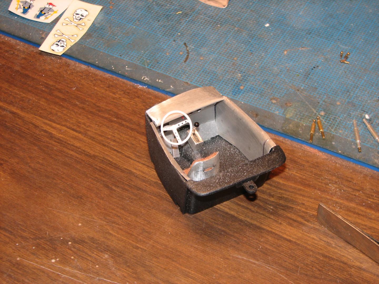

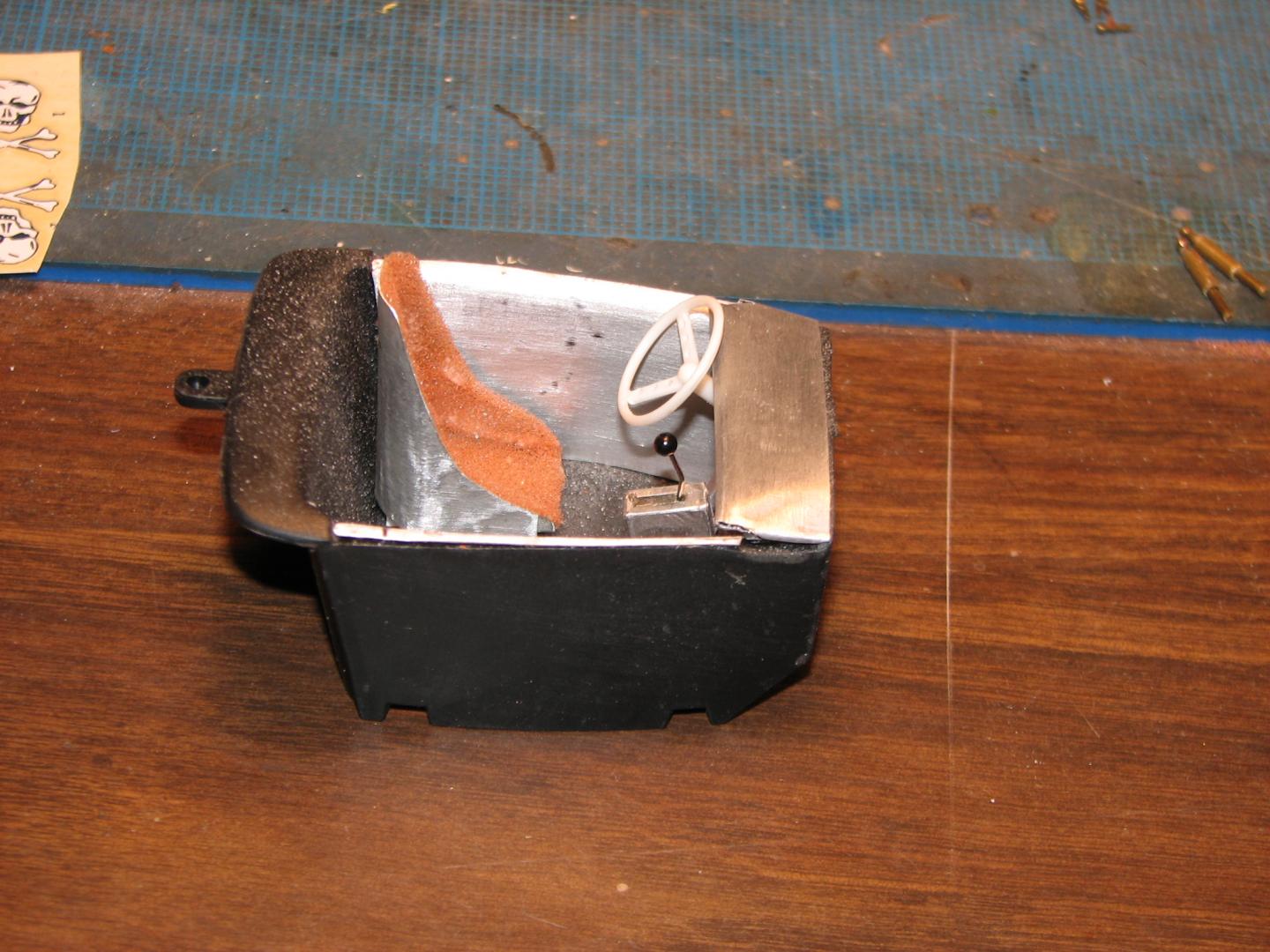

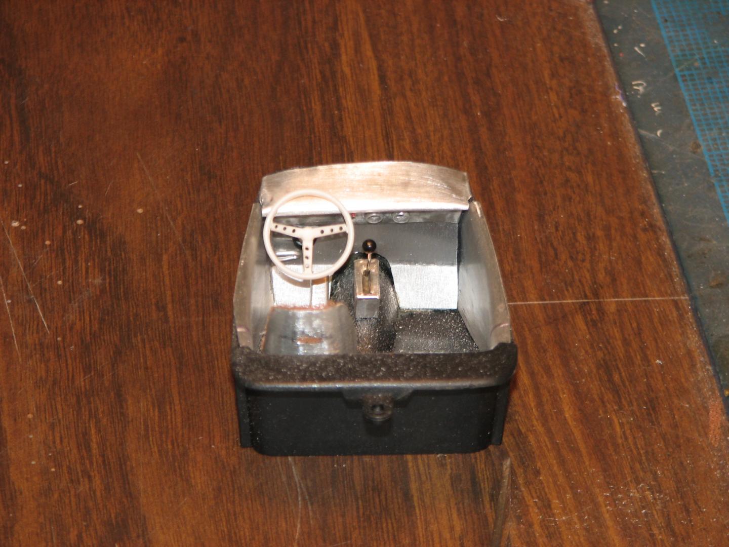

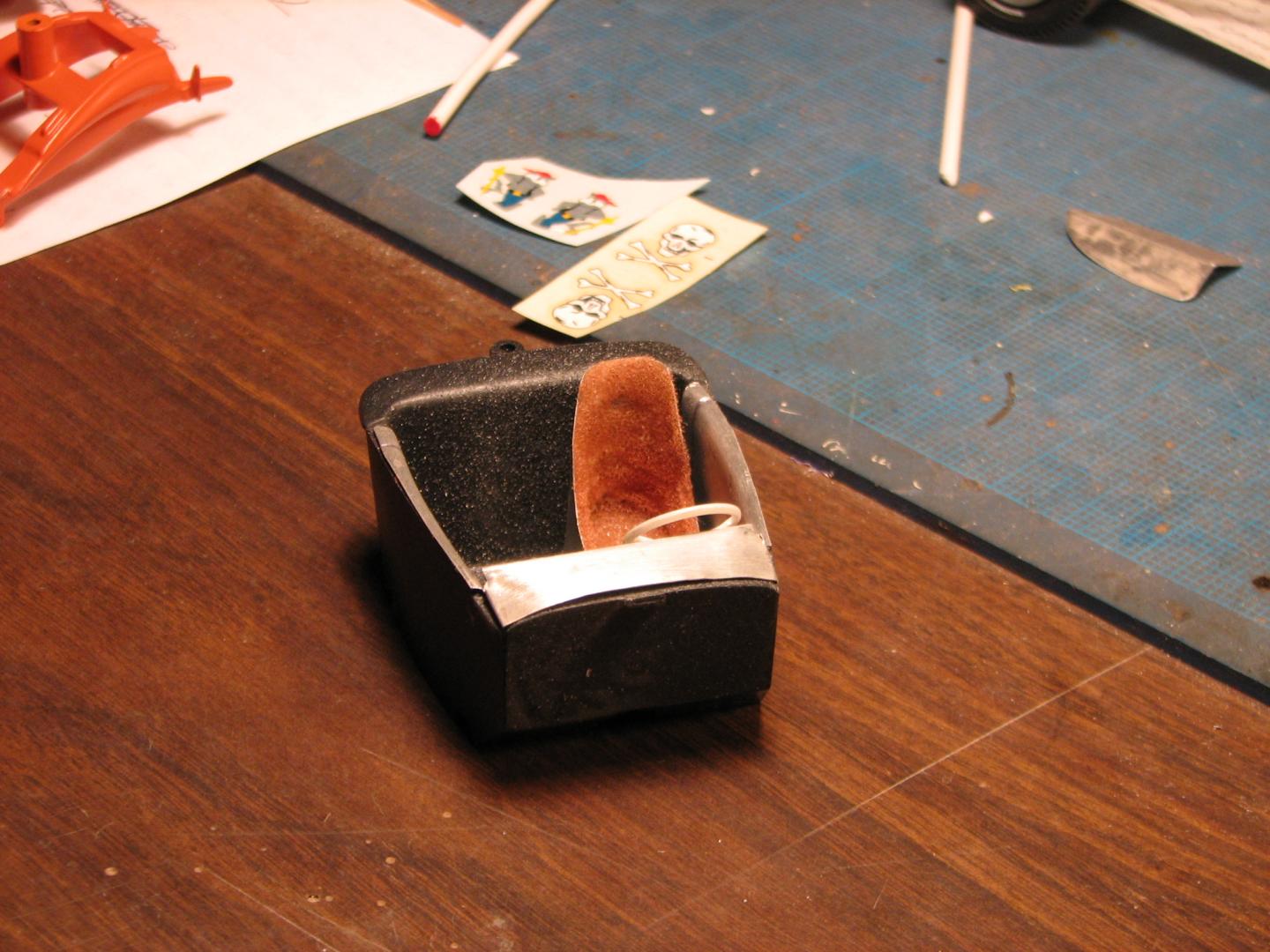

Straightliner59 Posted February 17, 2017 Author Posted February 17, 2017 Here are a few shots of the interior, as it progresses. The seat has been padded with the last I had of those old, foam dryer sheets. Guess I;ll have to find something else to use, going forward! Also visible is the HydroStick shifter unit, and the holes drilled in the spokes of the steering wheel. Next, I'll cover the seat with kitchen parchment dipped in diluted white glue...

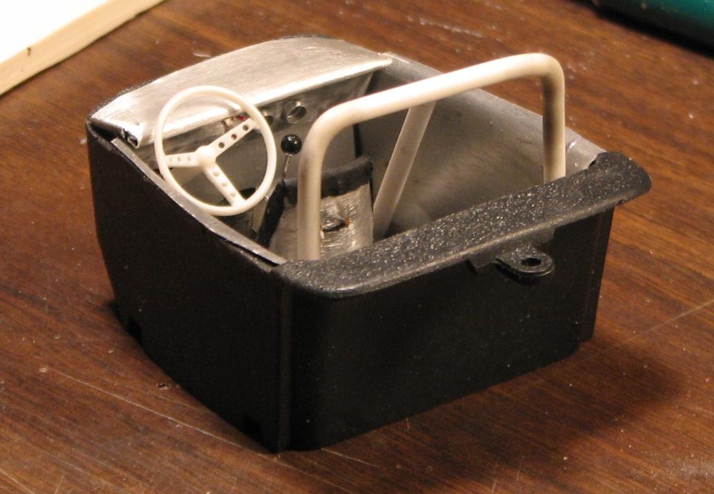

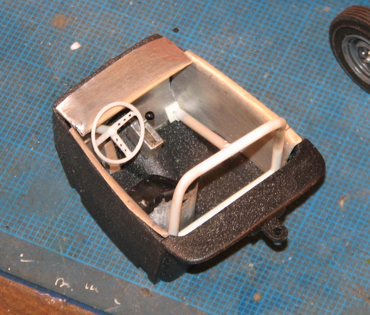

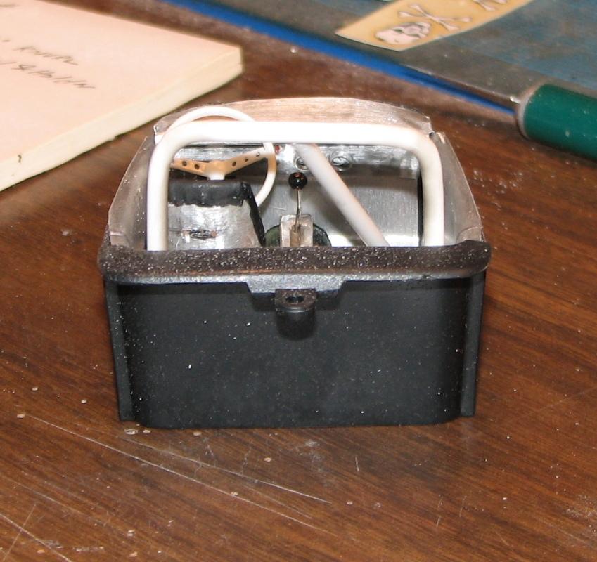

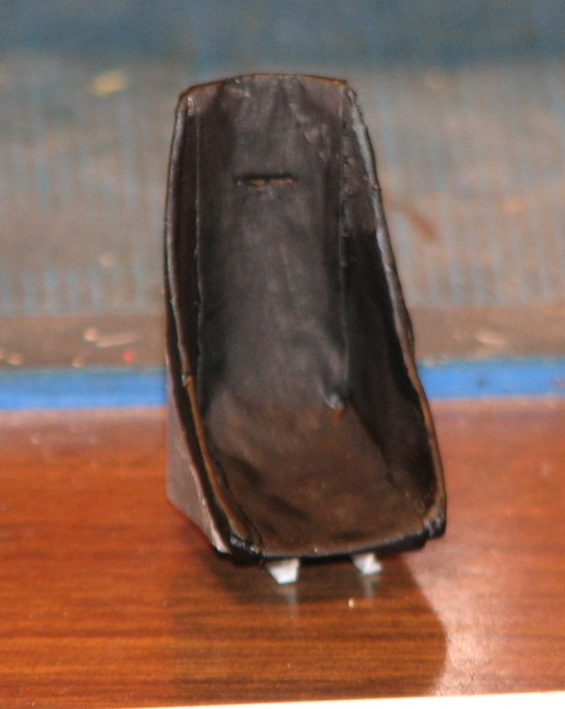

Straightliner59 Posted February 20, 2017 Author Posted February 20, 2017 Time for an update on the '34. The seat is covered and painted. The rollbar is assembled--it needs a bit of cleanup, then is ready for paint. Once the interior is buttoned up, I can paint the ceiling and install acetate windows, before closing up the body/floor pan unit. After that, I can finish making, and install the shocks, pittman arm and drag link and the radius rods, which will put this project very close to finished.

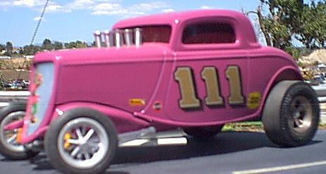

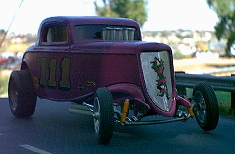

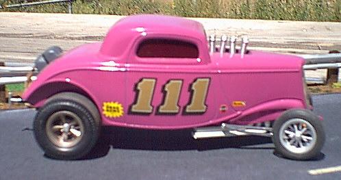

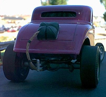

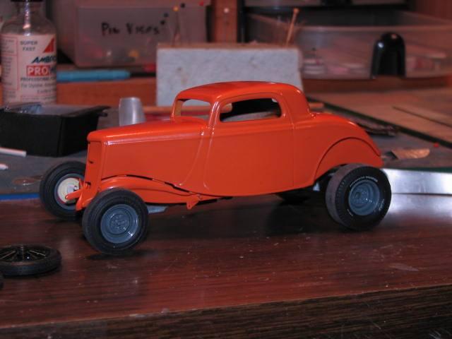

Straightliner59 Posted February 20, 2017 Author Posted February 20, 2017 Thanks, Glenn! I like the stance of yours, as well. LOVE the tire/wheel combo! Here's one I built years, when I had a crappy camera! It would be fun to see how many ways this little gem of a kit could be interpreted!

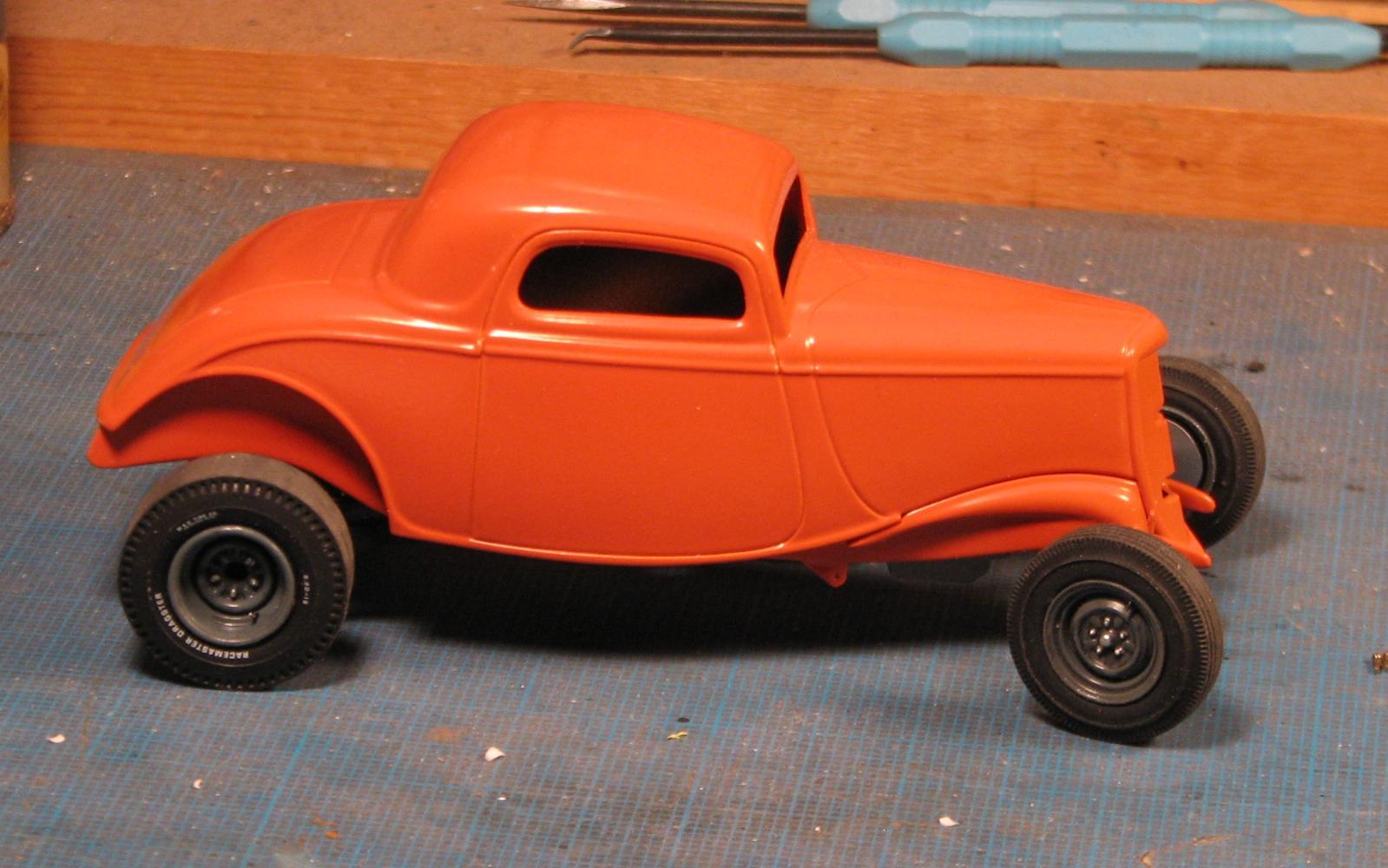

Bernard Kron Posted February 20, 2017 Posted February 20, 2017 (edited) Thanks, Glenn! I like the stance of yours, as well. LOVE the tire/wheel combo! Here's one I built years, when I had a crappy camera! It would be fun to see how many ways this little gem of a kit could be interpreted! Coolness!! The crappy camera and the color you chose combine to give it a distinctly "little pages" vibe. Glenn and I built ours at about the same time over on the TRaK board, so as long as we're in hijack mode here was mine: The details are coming along great. Can't wait to see it with everything dialed in and in full battle dress. Edited August 1, 2017 by Bernard Kron
Straightliner59 Posted February 20, 2017 Author Posted February 20, 2017 Excellent, Bernard! Love the rolling stock! The headlight location is great, too!

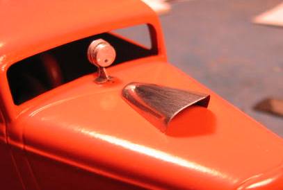

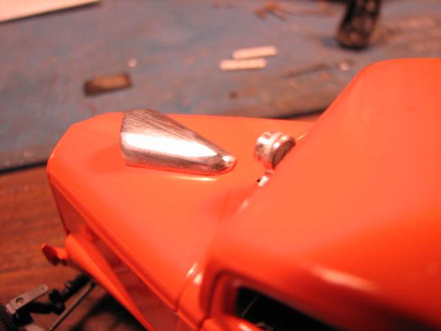

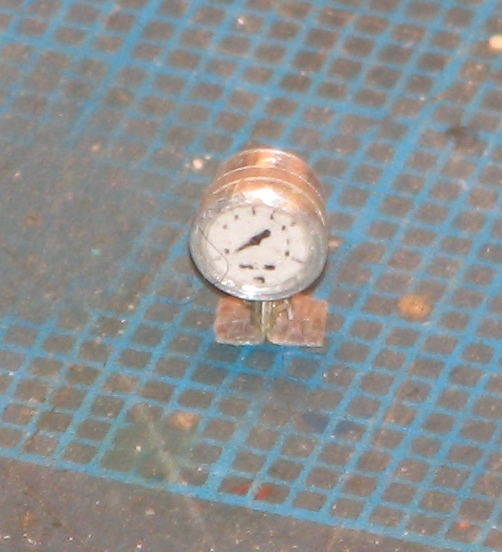

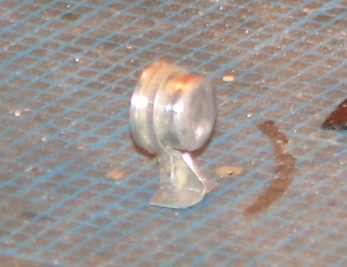

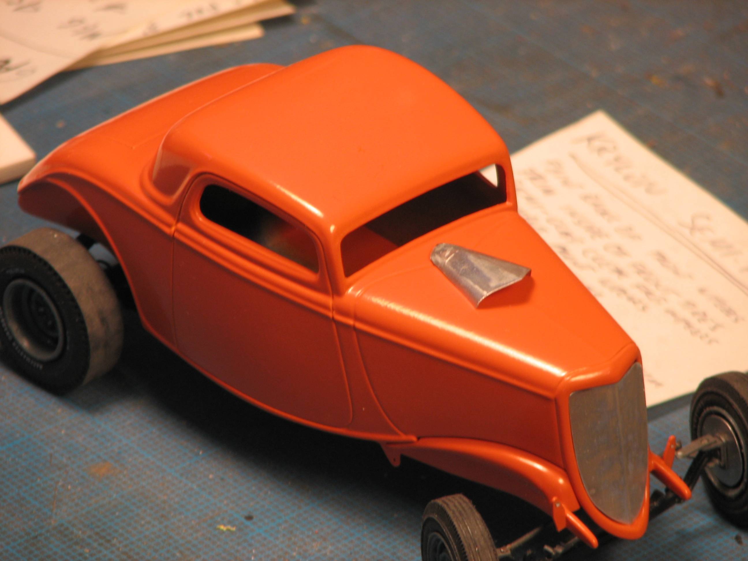

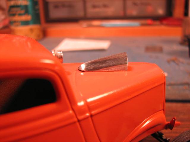

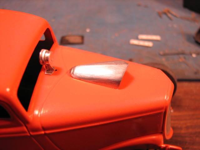

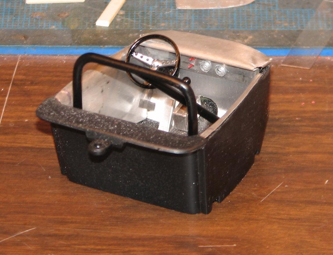

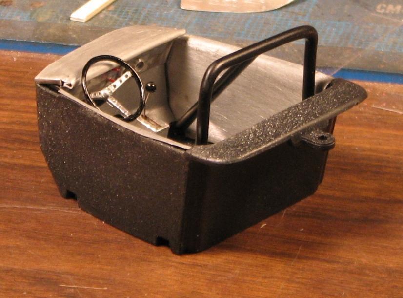

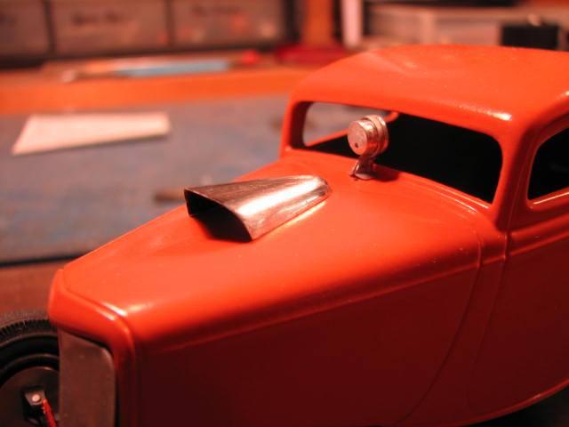

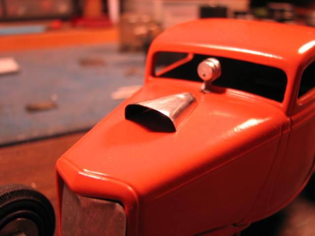

Straightliner59 Posted February 26, 2017 Author Posted February 26, 2017 A small update...I made a scoop from .005" aluminum flashing it still needs a bit of tweaking, to achieve a perfect fit. The interior is slowly coming along, but nearing completion. I also turned a tach on the lathe, and discovered that there isn't enough room to install it on the dash, so I won't be using it. I'll find a place for it, some day!

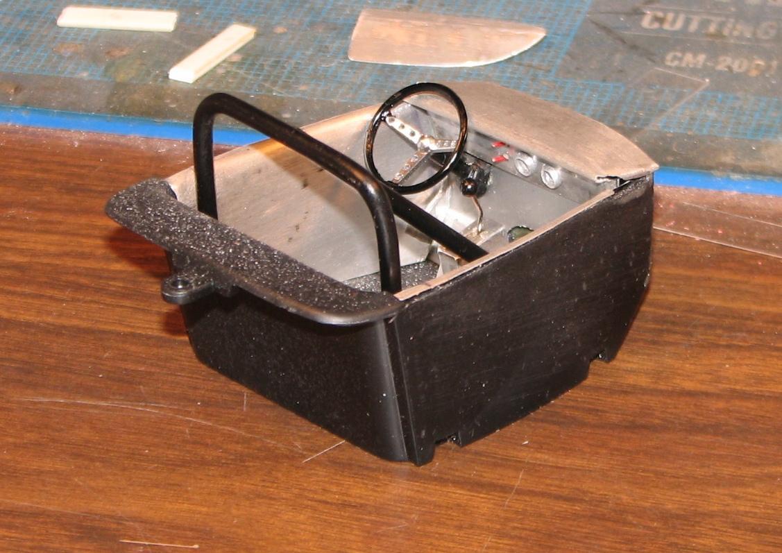

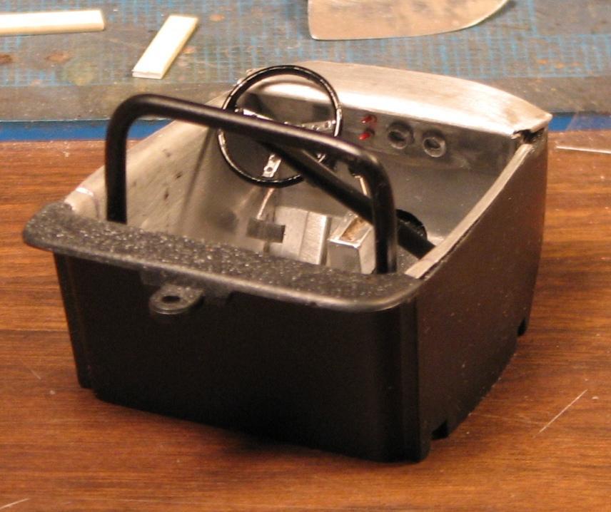

Straightliner59 Posted February 26, 2017 Author Posted February 26, 2017 The interior with rollbar installed.
Straightliner59 Posted February 26, 2017 Author Posted February 26, 2017 A couple more shots of the tach. I need to remember how to make the "Macro" setting work on this camera, again!
Straightliner59 Posted March 1, 2017 Author Posted March 1, 2017 It may not look like much, but, this scoop is the culmination of years of study and practice, and hours of cutting, annealing, forming over a hand carved wood buck, re-annealing, forming, hammering, filing the tong on my miniature anvil to a custom shape to form the end of the scoop, and filing, sanding and polishing, until I achieved this little gem! It's just about an inch long, and I am damned proud of it!grin

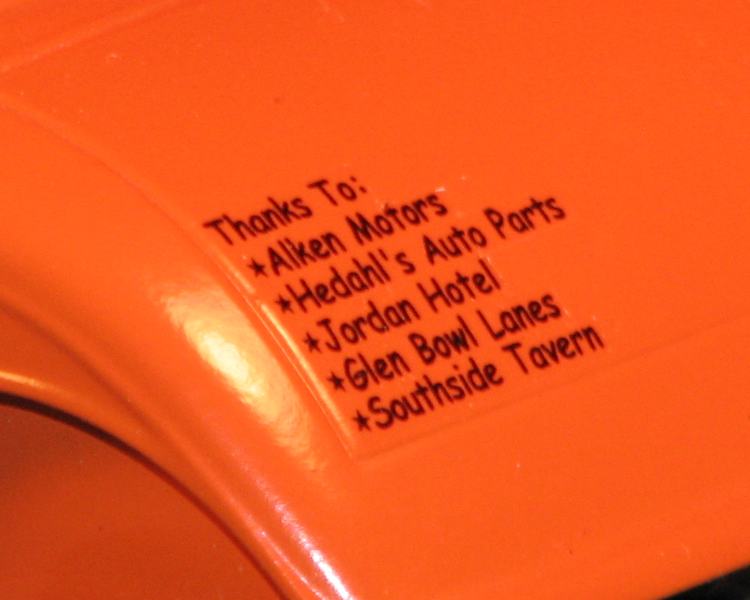

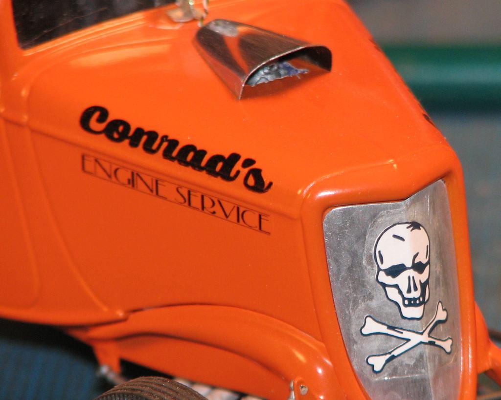

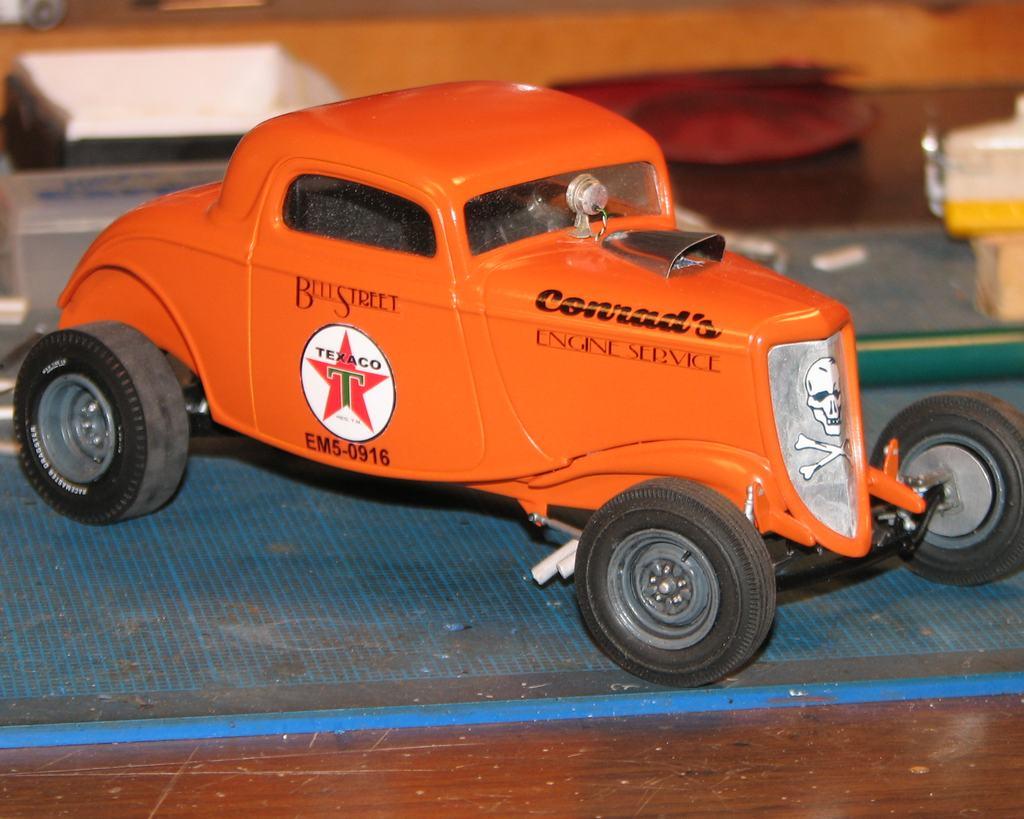

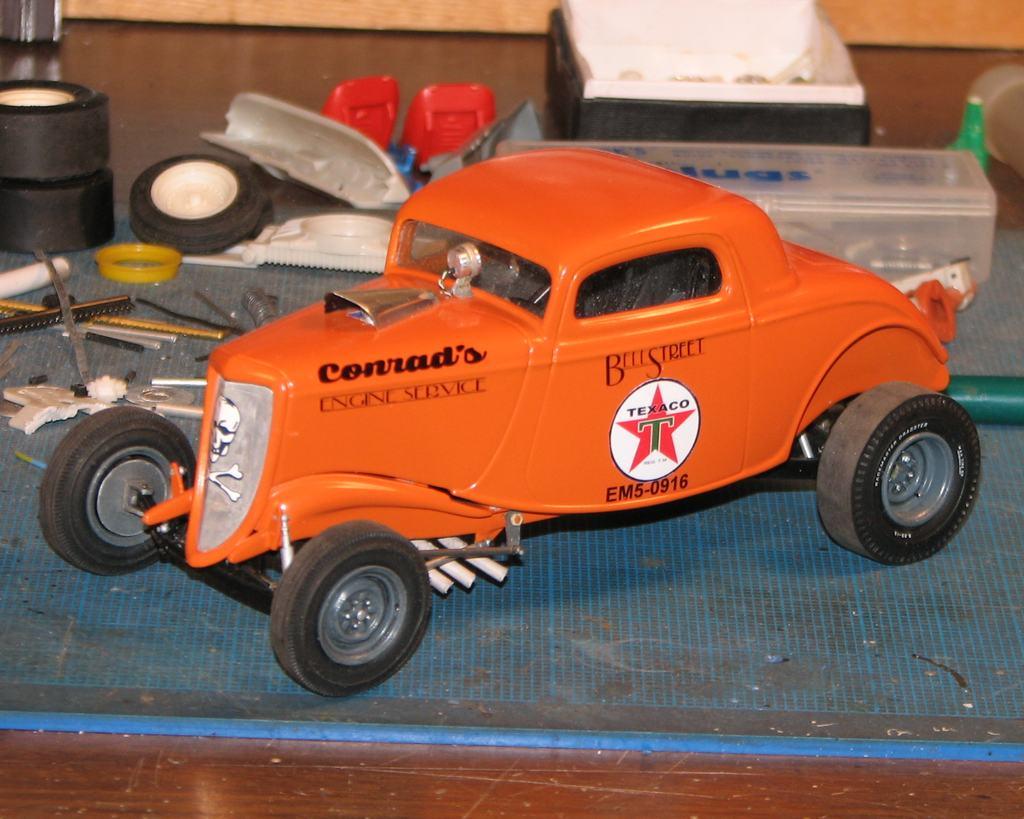

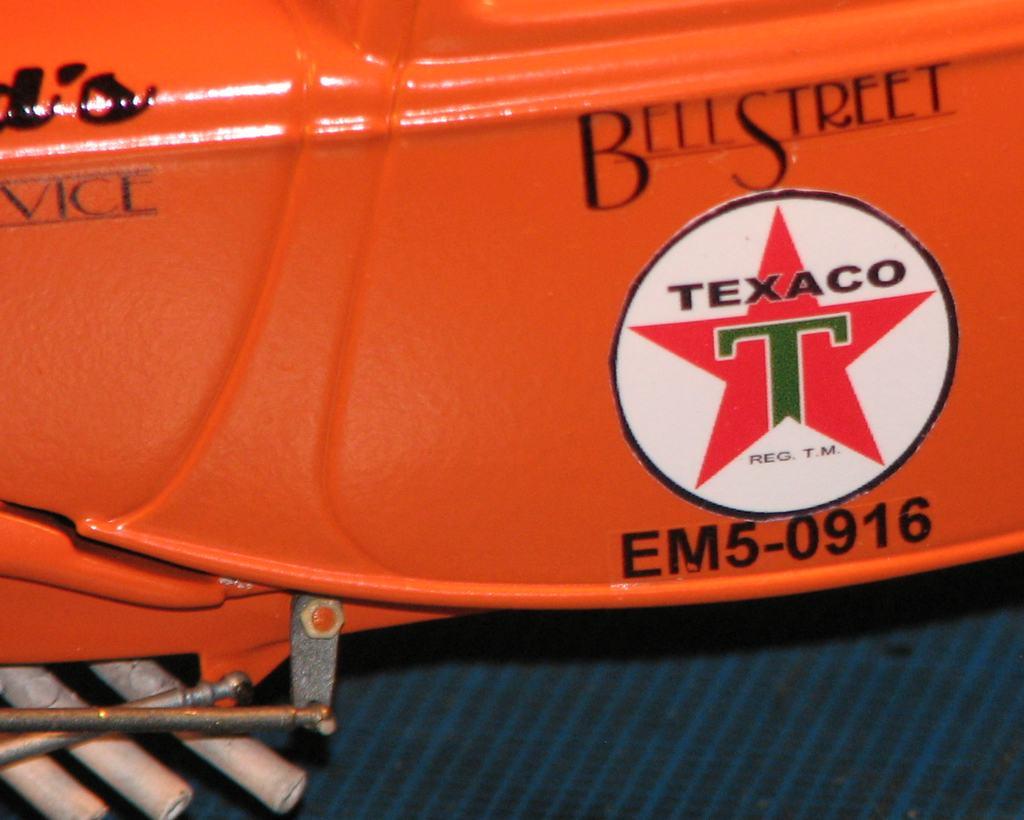

Straightliner59 Posted August 1, 2017 Author Posted August 1, 2017 This project is nearing completion, as all I have left to add are a handful of small pieces, a couple of product logo decals (I'd call them contingency stickers, but, what would they have really been worth in 1960?), and some touch-up. She has her warts, but I like the way it sits. I made all these decals, except for the skull, which came from an aircraft sheet. I don't know if anybody else has used the inkjet sheets from Blinggasm, but I am very happy with the results. I got both clear and white, through Amazon. The clear is very thin, and went down without a problem. I "built" the Texaco logo from scratch, using PhotoImpact Pro, and printed it on white. I manipulated various fonts and added the lines with PI Pro, as well. Those were printed on clear.
Bernard Kron Posted August 1, 2017 Posted August 1, 2017 Very nice. A nice assortment of trade decals to balance out some of the still-available space and she should be ready to go. As I suspected, the posable steering and the crisp tin work details really add to the impact. Love the tach!
