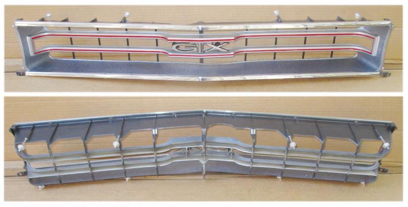

gtx6970 Posted March 10, 2017 Posted March 10, 2017 (edited) For those who want to know. Here is an actual grille for a 1969 GTX ( sport satellite is the exact same grille btw ) Edited December 4, 2017 by gtx6970

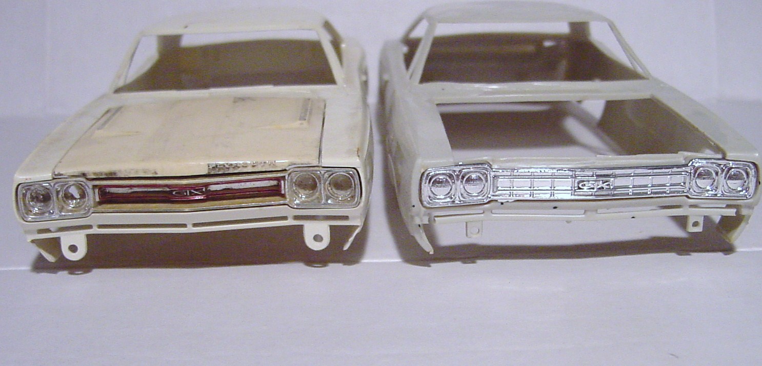

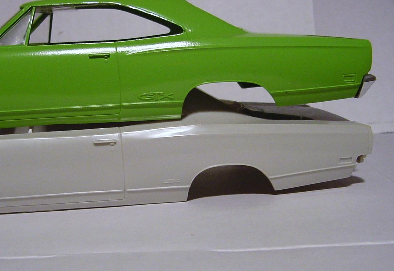

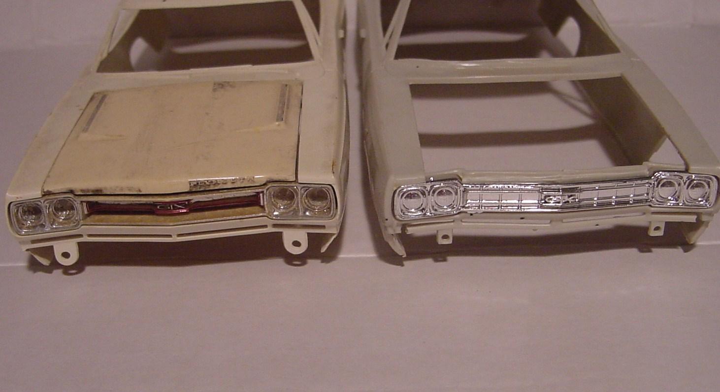

gtx6970 Posted March 10, 2017 Posted March 10, 2017 And now the AMT grille compared to the extremely accurate Johan piece. as well as a side shot to show the minuscule GTX emblems. To me these are the most blatant errors on this particular kit. The dropping rear quarter panels can be elevated to some degree by sanding off some of the exaggerated bow to the top of the rear quarters right about where the C pillars enter the quarter panel
Snake45 Posted March 10, 2017 Author Posted March 10, 2017 Great pics, thanks!Did Modelhaus ever offer the JoHan '69 grille? I didn't order any but need to know whether to kick myself or not.

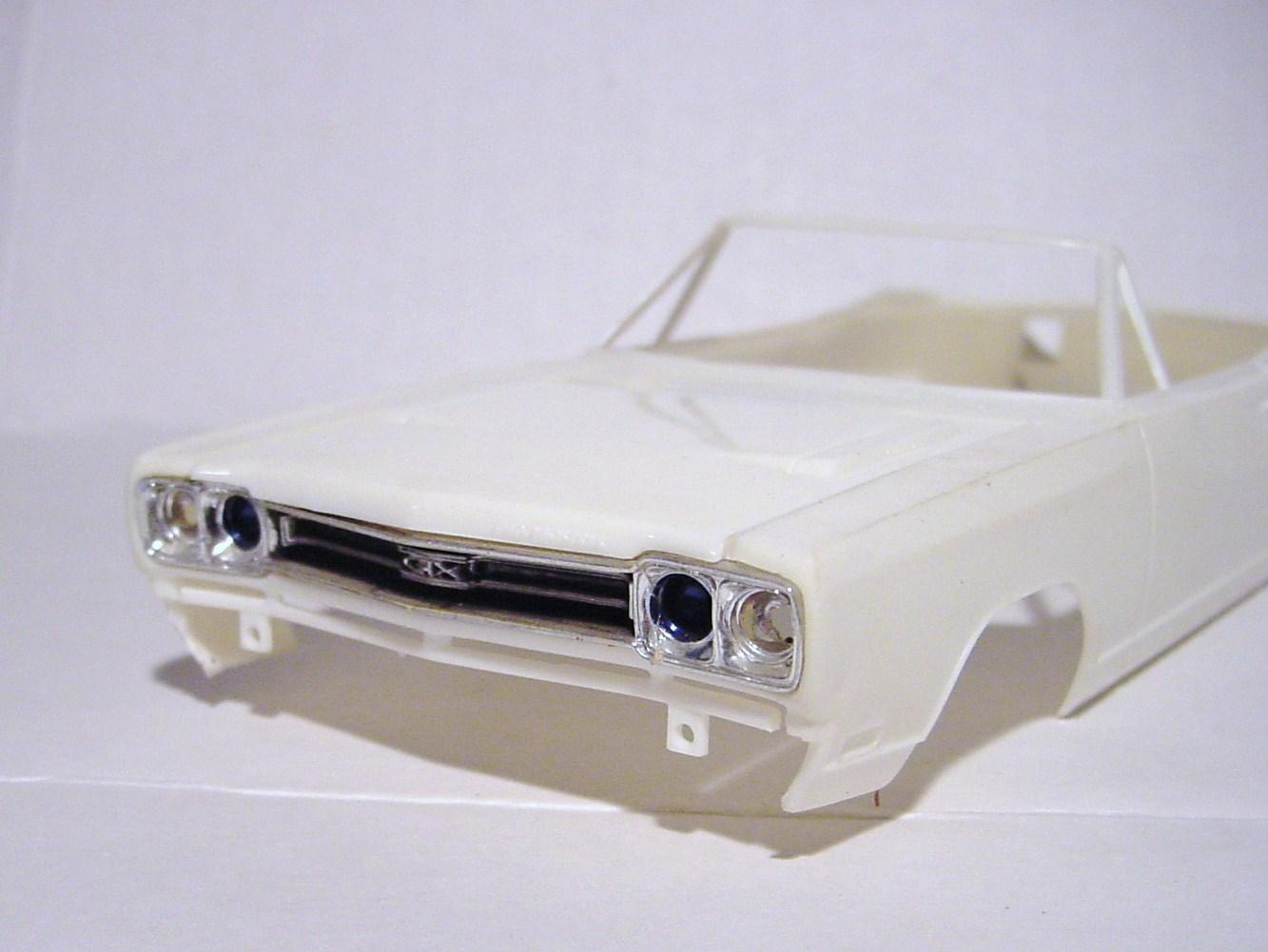

gtx6970 Posted March 10, 2017 Posted March 10, 2017 (edited) This is the AMT body with the Johan grill. And maybe 5 minutes with a dremel to remove the molded in panel behind the grill,, ( thats not supposed to be there anyway ) it needs a little sanding on the insides of the fenders to make it fit better there . But its a major improvement ,,,IMO Edited December 9, 2017 by gtx6970

om617 Posted April 25, 2017 Posted April 25, 2017 This is the AMT body with the Johan grill. And maybe 5 minutes with a dremel to remove the molded in panel behind the grill,, ( thats not supposed to be there anyway ) it needs a little sanding on the insides of the fenders to make it fit better there . But its a major improvement ,,,IMO This looks really good.
