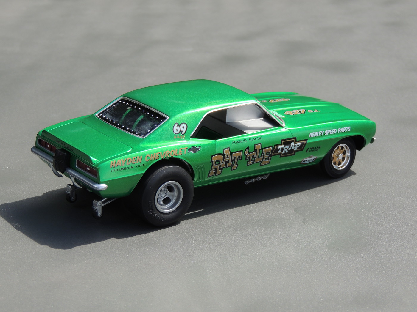

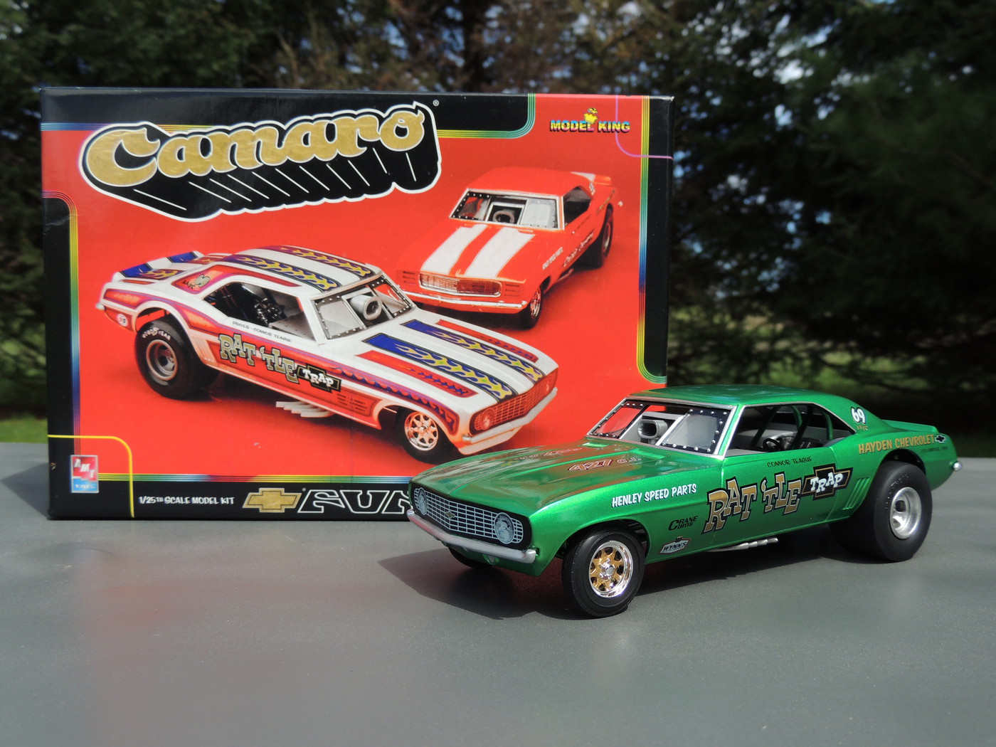

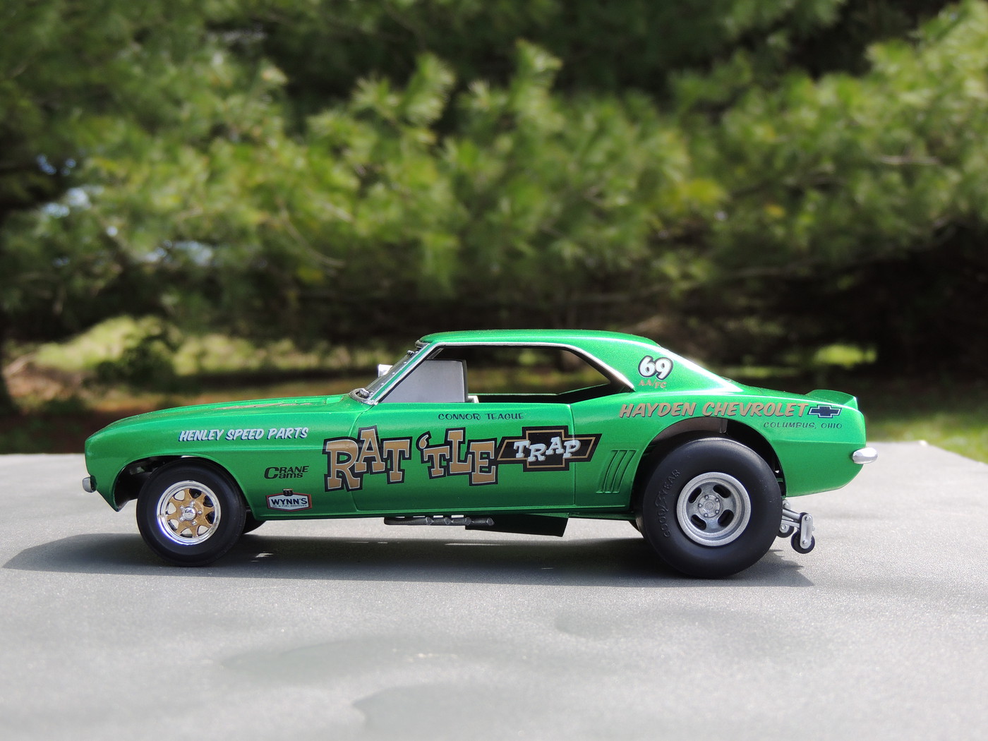

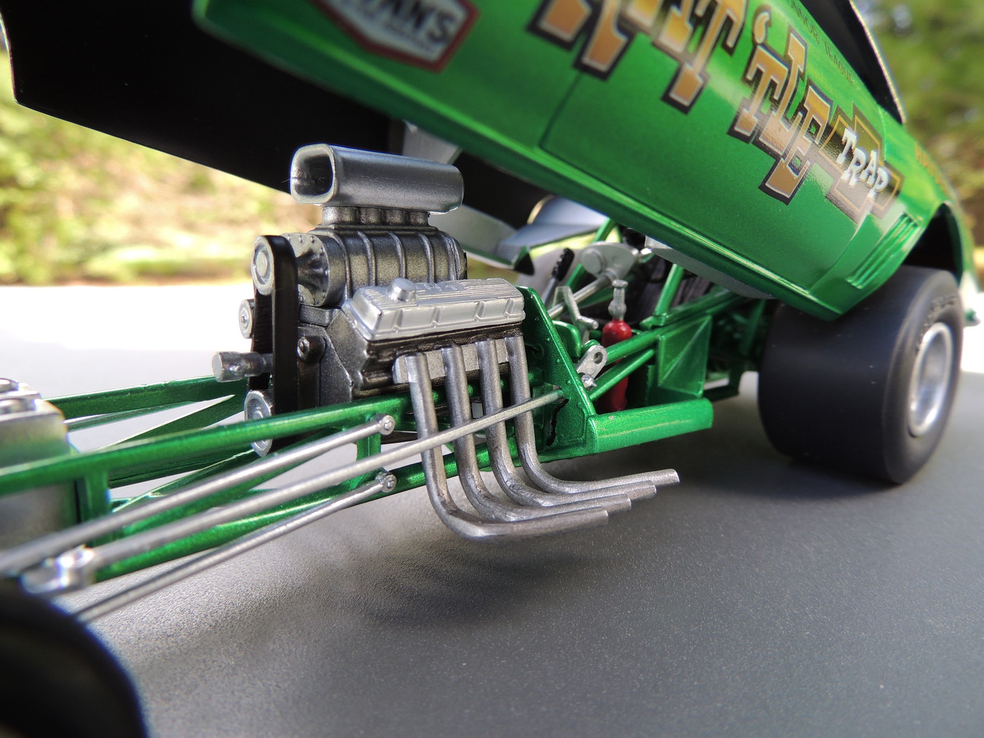

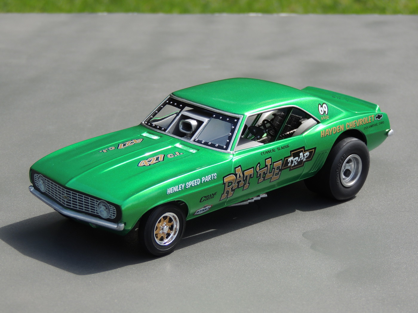

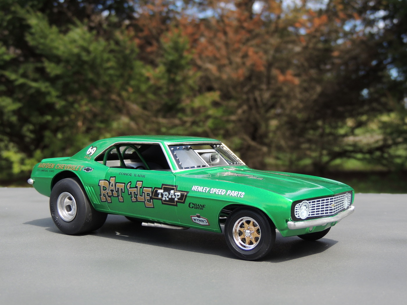

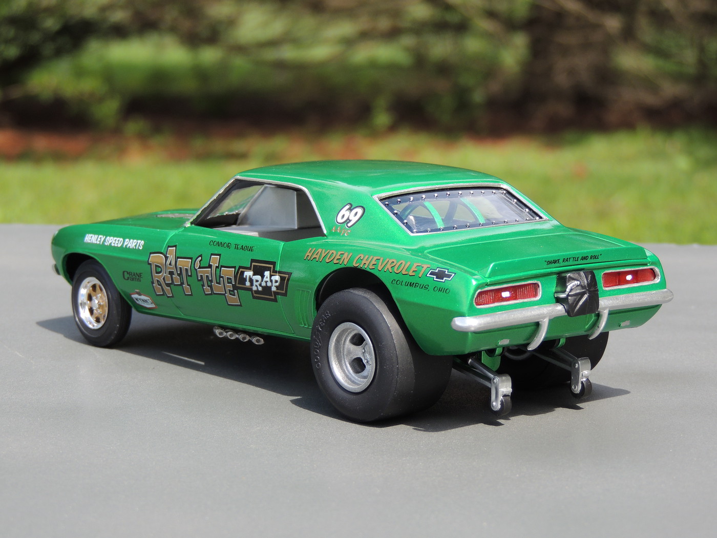

bogger44 Posted April 29, 2017 Posted April 29, 2017 Glad to finally have this one off the bench. I battled most of the way through the build with parts fitment, compounded by a relatively vague instruction sheet. The tin work also had to be sliced and diced some for a better fitment (wheel arches were visible in those hogged out wheelwells, and it also protruded up past the top of the door sills). I did persevere, and though not close to my best work, it came out better than I thought it would. The front still sits a little high but I'll live with it. Everything is oob except the blower scoop which was sourced from the parts box. I did drill out the header ends, but other than that no additional detailing other than paint. I was just chalking this one up as experience Lol. The body was shot with Testors One Coat Lacquer Mystic Emerald. On to the next, and hopefully better, build Lol! 1
Metaldrumm Posted April 29, 2017 Posted April 29, 2017 I really like this ,basic build, but very well done thats what its all about.
berr13 Posted April 29, 2017 Posted April 29, 2017 That's really nice work! Looks mean and ready to run! Sits right, too...great model!!
Hmann68 Posted April 29, 2017 Posted April 29, 2017 I think it looks great! Very cleanly done! Very nice paint work also.
6bblbird Posted April 30, 2017 Posted April 30, 2017 Very clean build! Green paint looks great. I started to build one of those, got about 80 percent done and threw it back in the box. It frustrated the heck out of me!WF
Dragline Posted April 30, 2017 Posted April 30, 2017 That looks great! Tough one as we all know. Pulled off with casual aplomb.

AC Norton Posted May 2, 2017 Posted May 2, 2017 Thanks for the comments guys. There were moments I was tempted to toss it back in the box and never open it again too Lol. .........Both the build and color look just great,,, beautiful example of this kit expertly finished. The green and gold lettering combo are perfect together as well.......tell me, why were you going to toss it back in the box,,,, does this kit have building problem's....I ask as I have considered buying one.....thanks, and great work, the Ace....

bogger44 Posted May 5, 2017 Author Posted May 5, 2017 (edited) Thanks for those comments Ace and Dave. .........Both the build and color look just great,,, beautiful example of this kit expertly finished. The green and gold lettering combo are perfect together as well.......tell me, why were you going to toss it back in the box,,,, does this kit have building problem's....I ask as I have considered buying one.....thanks, and great work, the Ace.... Thanks Ace, sorry it's taken me a few days for a reply. You know I was originally tempted to paint it white and build it like the box art, but when I was rummaging through my paint cabinet that Mystic Emerald Green really caught my eye and, as they say, the rest is history. Yeah this kit has issues, but with some work they can be overcome. The biggest hiccup I came across, along with the tin work I mentioned in the opening post, was the roll bar assy. It was warped/misshapen? and really didn't want to fit well at all. The rear roll bar braces seemed to be the culprit. I did a little tuning and got an ok fitment and called it good......till I did a mock up with the body and found it to be too tall as well as it was contacting the rear window. So I trimmed it down some accordingly, thought it was good, and when final assy came along I found it still contacting the rear window a bit. So instead of poping it off the frame again I just filed down the top backside of the bars until it wasn't a problem anymore. The main steering shaft needed some trimming to fit decent, and the headers interfere with the steering rod that leads down to the tie rod. Most of the suspension parts have pretty vague mounting points. Oh yeah, the body pivot mounts are pretty weak and leave a lot to be desired as well. Those were the main culprits I encountered, maybe it is this kit or maybe just my dumb luck Lol. If you're up for a bit of a challenge I say go for it and pick one up. Probably not the worst kit out there, but it's not all that great either. Edited May 5, 2017 by bogger44

bogger44 Posted May 5, 2017 Author Posted May 5, 2017 .....that's great info about this, and regardless of the shortcoming's of the kit you mention, that one looks terrific. Might grab one to have one, but I'll probably just look at yours and bypass the build problem's...lol....lol........thanks for getting back to me...best Tony, the Ace.... Lol thanks again Ace. I think i'ts safe to say that this build contributed a little to my receeding hairline and the gray that starting to filter in Lol! Glad to share the info regarding this kit. Wouldn't you know it, I had the car sitting in front of me while I was typing all that to help me with all the references, and proceeded to break the said weak body mounts off the frame. Got it fixed now.......probably till I decide to open it up again Hahaha!

bogger44 Posted May 6, 2017 Author Posted May 6, 2017 Thanks again for your comments fellas. Oh yes, Ace, those carpet gremlins always seem to be hungry Lol I was thinking about the roll bar height situation, and some of that was probably my doing when I shorten the height of the rear deck of the tinwork to get those wheelwells tucked into the body as I'm sure that allowed the body to sit down onto the chassis a little lower. Either way, I still think the bars would have been a bit too high.
W-409 Posted May 10, 2017 Posted May 10, 2017 Wow, this looks great! I've had that kit on my hands a couple of times but never bought it. Now after seeing this one I'd like to build one as well. Excellent job getting that kit together, and I really like that color combo too. Green and Gold fit perfectly together in my opinion. Very nice and clean build overall.
