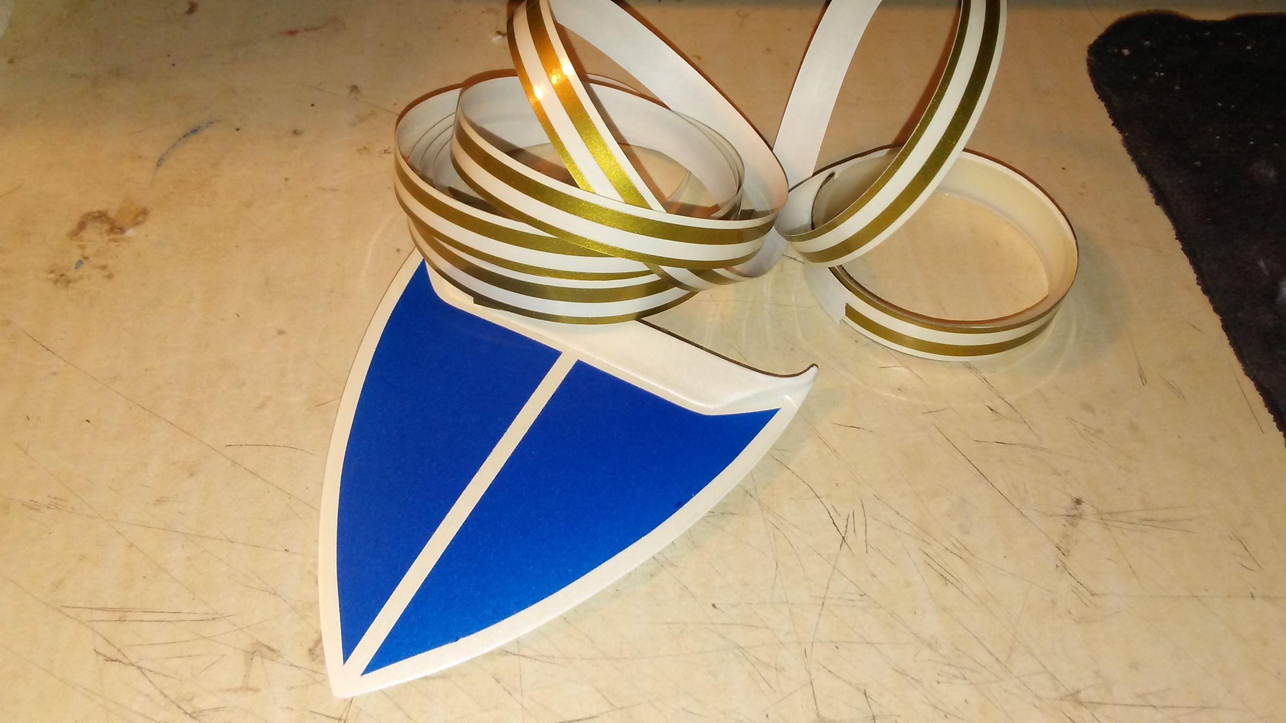

Jon Haigwood Posted August 15, 2017 Posted August 15, 2017 (edited) I have been fighting with the paint on this Hemi Hydro boat for awhile. Trying to get some good edges on the blue sections. After several drownings in the "Pond". I ended up with using some old pinstripe tape that I have had laying around for some years. I start with Autoair Pearl White and then a coat of intercoat clear (Autoair 4030) , lay down the pinstripe tape and then another light coat of 4030. Then sprayed the Blue Pearl (also Autoair) and another light coat of 4030. Now after it dries (and I touch up where some blue slipped thru) it will be cleared then polished. The pinstripe tape leaves nice clean edges and no residue. Edited August 15, 2017 by Jon Haigwood

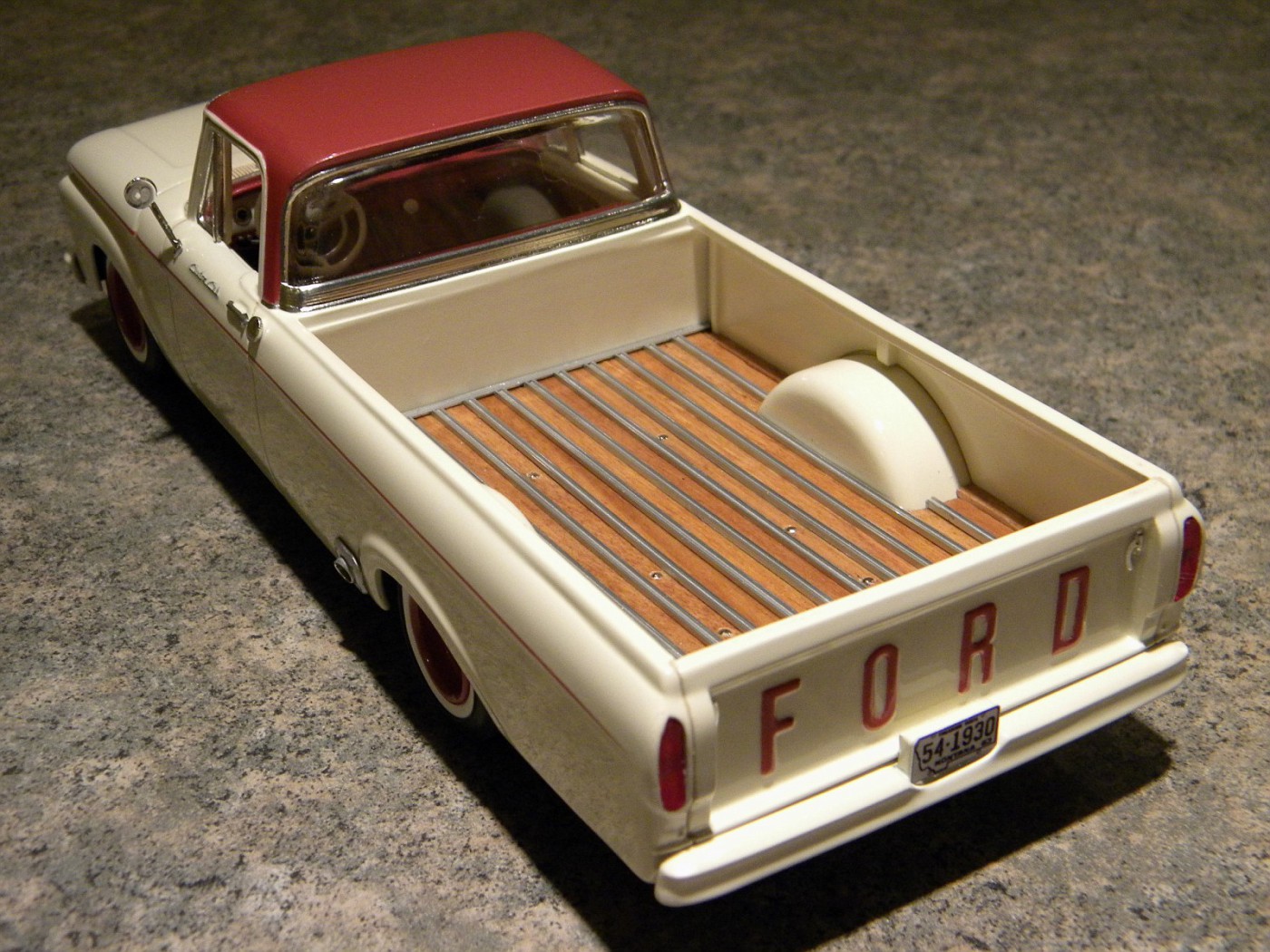

StevenGuthmiller Posted August 15, 2017 Posted August 15, 2017 (edited) I'll bet you're using enamel paint. Enamel dries much slower giving it a lot more time to seep into all kinds of nooks and crannies, especially if it's sprayed on heavy. If you're going to use enamel, spray the first coat or 2 lightly. That way it won't seep under the tape as easily & it will seal up the tape edges before the final wet coat. I never have any bleed under issues with lacquer paints & Tamiya tape. I painted the fine pinstripes & FORD lettering on the tailgate of my '63 Ford with zero issues using lacquer & Tamiya tape & foil for masking. Steve Edited August 15, 2017 by StevenGuthmiller
