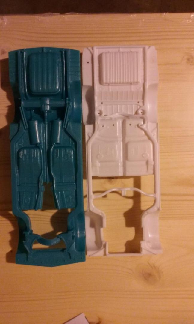

mk11 Posted September 8, 2017 Posted September 8, 2017 (edited) This thread gives a lot of great info, Bill ... especially for those interested in doing a canadian pontiac the chevs were 199119", the grand prix and catalina were 121" and the bonnys were 124" wheelbase. mike '65 GP vs '65 chev (pic by R Barron) Edited September 11, 2017 by mk11
Snake45 Posted September 9, 2017 Posted September 9, 2017 This thread gives a lot of great info, Bill ... the chevs were 199", the grand prix and catalina were 121" and the bonnys were 124" wheelbase. mike I think you mean 119".
mk11 Posted September 9, 2017 Posted September 9, 2017 (edited) just makin' sure you're awake mike Edited September 10, 2017 by mk11
