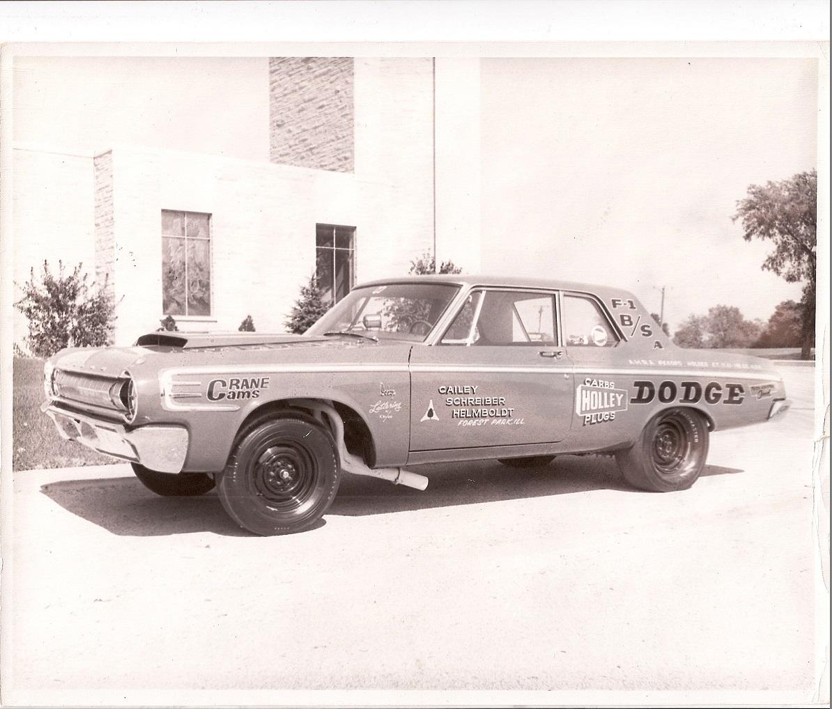

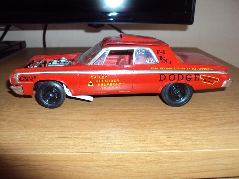

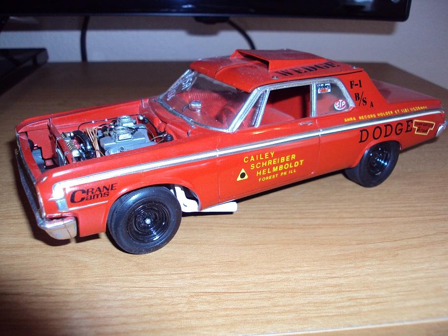

Crizila Posted September 10, 2017 Posted September 10, 2017 This is the car I raced in 1968/69 in AHRA Midwest division. Car ran Formula 1 B stock automatic and held the record in that class at 11.61 115.38. Speed was later uped to 117mph.

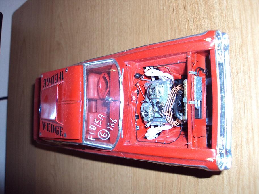

Crizila Posted September 10, 2017 Author Posted September 10, 2017 (edited) Wow that's a fine build! Looks like nice detailing under the hood! Must've been fun having your foot to the floor in that car. I was born in 69, so I envy you for living thru that era. Grew up a couple miles from the Oswego strip and went a lot but was young and the older fellas around here still talk about those days. That car went down the Oswego track many times. I cut my teeth on that track in 63 with a 1963 Plymouth Sport Fury max wedge convertible 3 speed car. Flag man start back then. Car ran high 12's with a 4.56 gear and Atlas Bucron cheater slicks. Ran a best of 12.41 @ 116.88 at Rockford drag way - racing 4 wide. Used a resin body for the model build. Most of the lettering was done with dry transfers. Holley sponsorship took place at a later date. Edited September 10, 2017 by Crizila
Hmann68 Posted September 10, 2017 Posted September 10, 2017 You nailed the look of the 1/1 for sure! Awesome work. I will think of your car when I pass by the strip later today to go grocery shopping! It's a tree nursery now, but it makes a great place to race snowmobiles wink-wink
Alan Posted September 10, 2017 Posted September 10, 2017 John, KILLER build, you nailed this, love those headers you made, great work!!!Alan
10thumbs Posted September 10, 2017 Posted September 10, 2017 Great model John!I'm impressed, and since you really did pilot a Mopar that all of us fans love, let me ask a couple of questions, OK?First of all, the Bucron cheater slicks shown on the real car just above, were they not too wide? Did you have to cut the inner lip of the fender to make them fit? My brother-in-law bought a new 64 Sport Fury with a 426, but a 4 speed. The car would never hook, we all laughed every time he attempted a launch....lol. Bucron cheater slicks and a 4 speed...didn't work with him.Also, that's a tall front tire, and it's difficult to get that front tire/fender deal to look right on the Lindberg '64 Dodge models. The real car, did it have 15" wheels?Further....sorry, just thrilled that we have an expert to talk to, your model shows the battery missing up front. I've never found exact pics of the way Mopar ran the cables from the trunk to under the hood. I can only assume, the battery cables ran through the back panel at the rear seat and then under the door tunnel, driver side. Or where the cables actually just under the carpets?I do think the cables reached the motor under the steering gear through the firewall. Any insight?Again, the way your car sits in the real pic, is the look that killed me and many others from back in the day! Luckily, I watched lots of these cars, they sounded good too!Thanks John.Michael

shoopdog Posted September 11, 2017 Posted September 11, 2017 Looks great, fantastic detail down to the handwritten class numbers on the windshield.
smhardesty Posted September 11, 2017 Posted September 11, 2017 Looks great, fantastic detail down to the handwritten class numbers on the windshield.That really caught my eye too. I remember that from 'back in the day'. Saw an awful lot of those numbers on the glass. Brings back loads of memories.

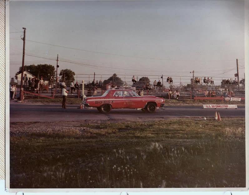

Crizila Posted September 11, 2017 Author Posted September 11, 2017 Clutch explosion in my 63 Plymouth. - I was racing at US30 dragstrip in Indiana. I was side by side with another Max wedge car when I missed the 2-3 shift. Of course no scatter shield. Clutch and flywheel both let go. Disintegrated the bell housing. Cut the brake line ( single master in 63 so - no brakes ). Cut down the right front tire. MANY parts came out from underneath the car. Damaged the car I was racing. I coasted through the traps at 79mph with no brakes, a flat right front tire and the oil pan laying on the steering center link. I was pooping bricks!! Luckily this track had a long shut down area with tall grass on both side of the track. I got it off in to the grass and actually had the ambulance pull along side of me as the car came to a stop. I had clutch springs laying on top of my cross ram manifold and the firewall was pushed in, put nothing came in to the driver compartment. I was very lucky. I couldn't even look at the car for about 6 months. I finally decided to put it back together with an automatic, which is how I raced it for another year before I went in to the service. 64 Dodge: The car was originally purchased from Grand Spalding Dodge ( My Norm was actually the sales man ) and we bought our parts from them at a modest discount. The Holley rep for the Chicago area lived down the block from us, so we got free carbs, carb parts, and spark plugs - hence the Holley logo on the side of the car.
10thumbs Posted September 11, 2017 Posted September 11, 2017 (edited) Excellent! Thanks John.The new pics shows the stance that I remember and loved about these cars. Really, what's better than a post door Mopar with a nasty motor? With today's torque converter tech, and the motor from back then....well let's add spark and carb performance upgrades, let the motor be the same....what kind of performance would you think achievable?Granted, the Mopar of old can still be built, and still is built, newer heads, Max Wedge knock offs, and old cam grinds. Still, they run strong.What would a 3400 car with the same motor, but newer tech about the hit, reach?By the way, I always thought the Dodges looked better in race trim than the Plyms. Edited September 11, 2017 by 10thumbs
