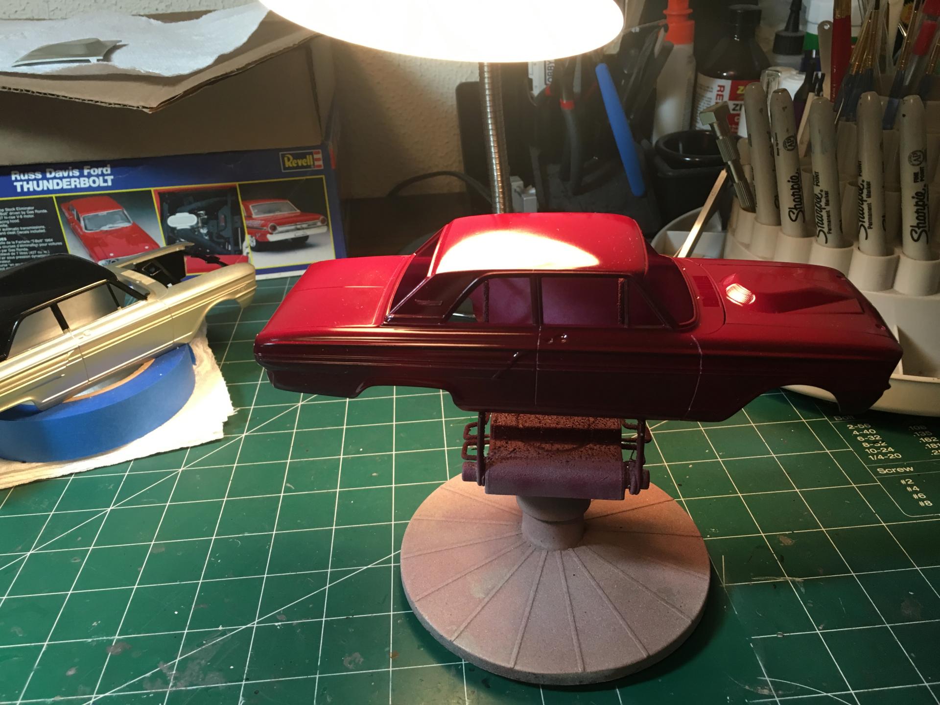

Brutalform Posted November 18, 2017 Posted November 18, 2017 I’ve ran out of my Model Master clear, and Testors one coat lacquer clear. I’ve used these with no problems whatsoever over Tamiya lacquer sprays. I have several cans of Tamiya clear I’d like to use up, but I’ve heard that if you don’t clear immediately after you lay down the Tamiya color, you should wait a few weeks due to the curing and gassing out at different rates. On this particular body, I used Tamiya gray primer, then a few coats of Tamiya maroon. Can anyone provide any info on this? This body was sprayed with color two days ago. Thanks.

espo Posted November 18, 2017 Posted November 18, 2017 I have always had the best luck with the Tamiya Clear and have never had any problems with time lines. Great looking Thunder Bolt.
