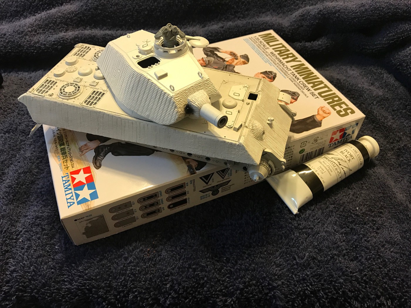

LDO Posted December 12, 2017 Share Posted December 12, 2017 This is Dragon's kit #6312. The Zimmerit anti-magnetic coating was done with Milliput Superfine White epoxy putty. The pattern was made by rolling a lid from a Tamiya paint jar onto the putty. I didn't want it to be stark white. The weathering would be representative of the snow first starting to melt. Most of these techniques are new to me. The last time I built a model tank was about 20 years ago. Here are a few pics from start to where I am now. Quote Link to comment Share on other sites More sharing options...
shoopdog Posted December 12, 2017 Share Posted December 12, 2017 That's some excellent work Lee. What scale is that and how did you get the numbers and the cross on the zimmerit? Hand painted? Quote Link to comment Share on other sites More sharing options...
LDO Posted December 12, 2017 Author Share Posted December 12, 2017 It's 1/35. The numbers and Balkan cross are hand painted. One pic has a test piece for Zimmerit and painting on the markings. I cheated a little bit. I used wide Tamiya tape to make a rectangle mask the had lines representing the borders for the numbers. I continued the lines onto the Zimmerit with a sharp pencil, then filled in the lines...mostly. The 3 and the diagonal line in the 4 were freehand, but having the vertical lines done plus limits marked out really helped. The faded 3-color camo under the numbers was done with dry brushing oil paint. I'm really liking the oils. That's new to me. The idea came from a book by Tony Greenland. That dude is a tank model guru. The carbon stain around the coax machinegun muzzle is also dry brushed oil. It's a cool technique. It looks like airbrushing. Thanks. Lee Quote Link to comment Share on other sites More sharing options...
