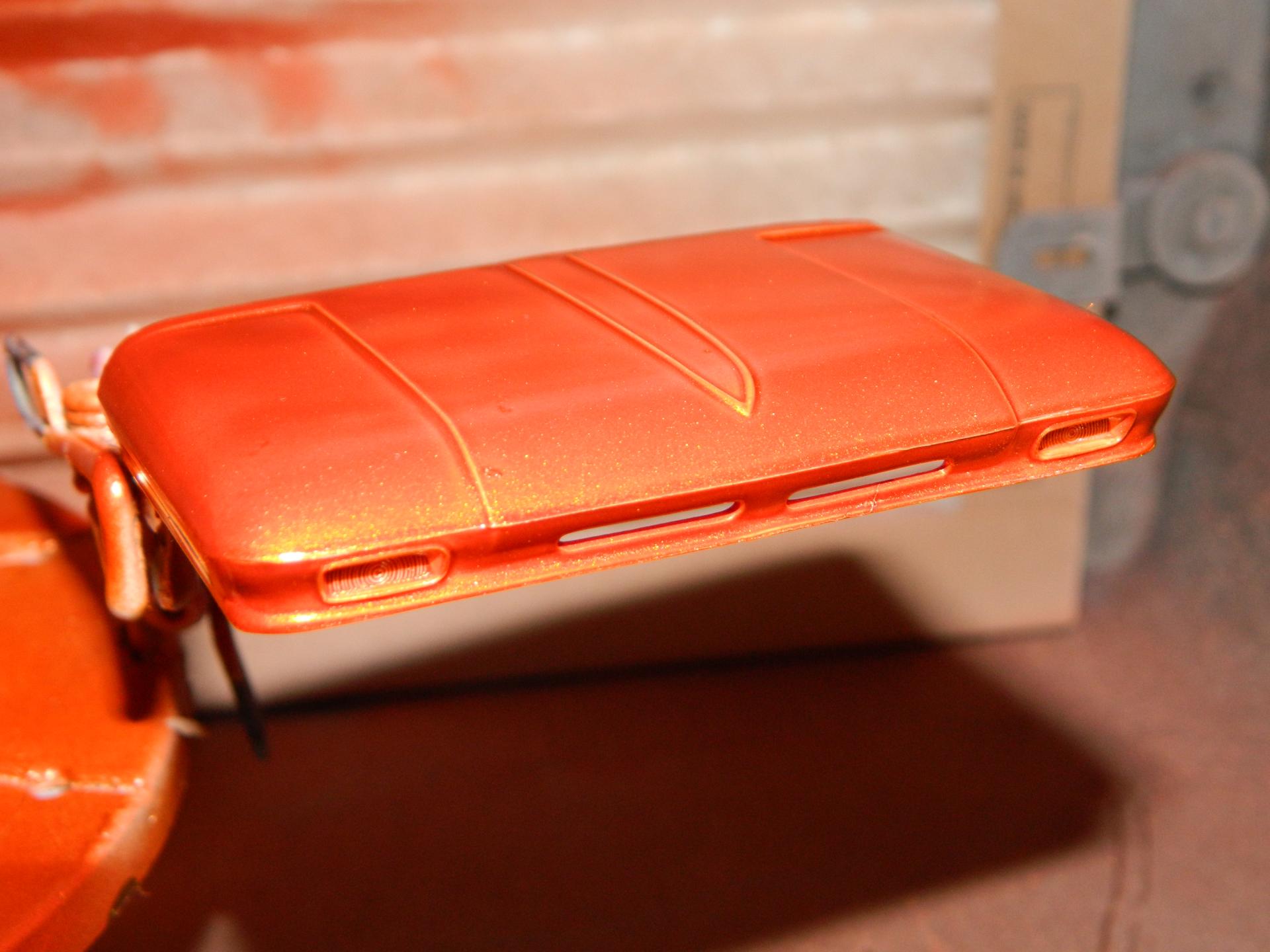

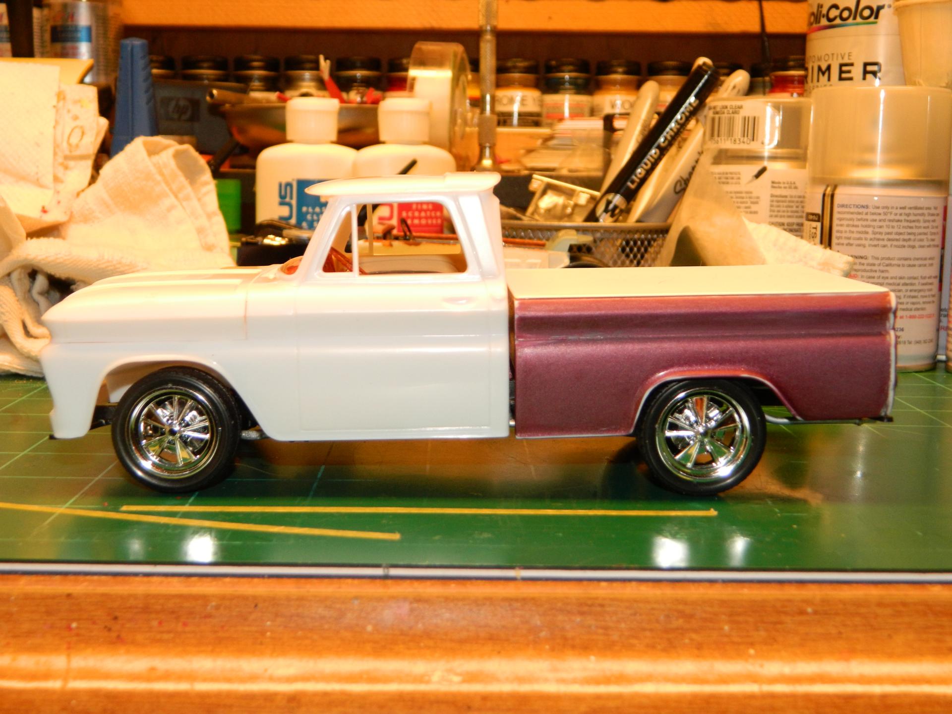

youpey Posted April 8, 2018 Posted April 8, 2018 (edited) i am hoping you dont mind the tips below. did you happen to primer the body before painting it? also, i had paint cracks one time and found that by lightly sanding the body with 1200 then 1500 sand paper going opposite directions, then washing very thoroughly with dish soap before the primer and i never had any issues again. Also, make sure the primer is the same type of paint as the paint itself. like acrylic primer with acrylic paint (i typically try to use the same brands if possible). I spend more time prepping the plastic vs actually painting also, i found that if you do multiple thin coats instead of thicker coats will give you a paint job that will not run. The thinner the paint, the quicker it will dry/less likely for dust and other stuff to get into the paint. * the more coats you do does give more opportunity for dust or other stuff to land in the paint. your interior and custom work is tremendous. Edited April 8, 2018 by youpey
mrmike Posted April 8, 2018 Author Posted April 8, 2018 As I said before, painting is a "hit or miss" with me. Yes, the cab and hood were primered after they were washed. The problem lies with the fact that I had run out of paint with my old can and I went out and purchased a new can of the same brand and type of paint. I had hoped that adding additional light coats of paint, I would be able to cover up were the old can left off, but that didn't happen. I am not totally unhappy with this "disaster", but like everything else in life, it's part of the learning curve that life throws at us. I'll fix it and move on. Thank you for the tips!

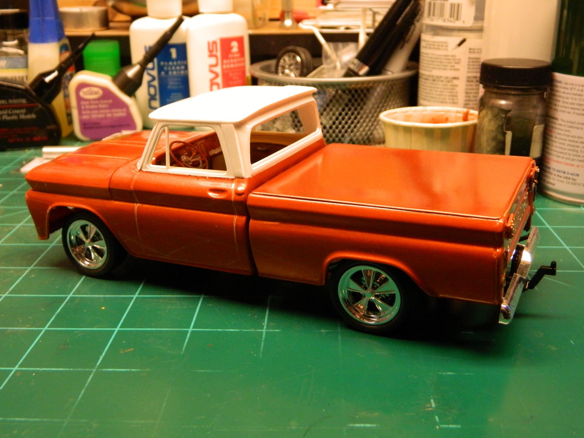

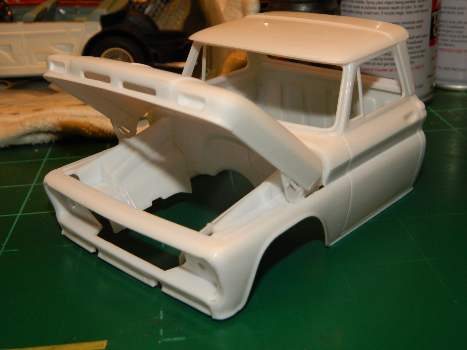

mrmike Posted April 14, 2018 Author Posted April 14, 2018 The Story Since Lt. Det. Macklin is in charge of this operation, Lt. Det. Troy and McNally will wait until they are given the OK to enter the body shop. A group of officers from Auto Theft, Homicide, and off-duty patrol officers will make up the force entering the body shop with a smaller group of officers arresting the chopper and thieves. Lt. Troy in the meantime will continue to question Davey about the murder of Peter Mathieus. The search of Davey's room found the murder weapon, a large folding knife, hidden in an heating duct still covered with traces of Peter's blood and Davey's fingerprints. A doorbell video shows a hooded figure with a partial view of the murderer's face committing the gruesome crime. The Build I painted the Chevy this morning and it looks pretty good. A wetsanding, clear coat, and polishing and then I can assemble the truck. McNally will return...

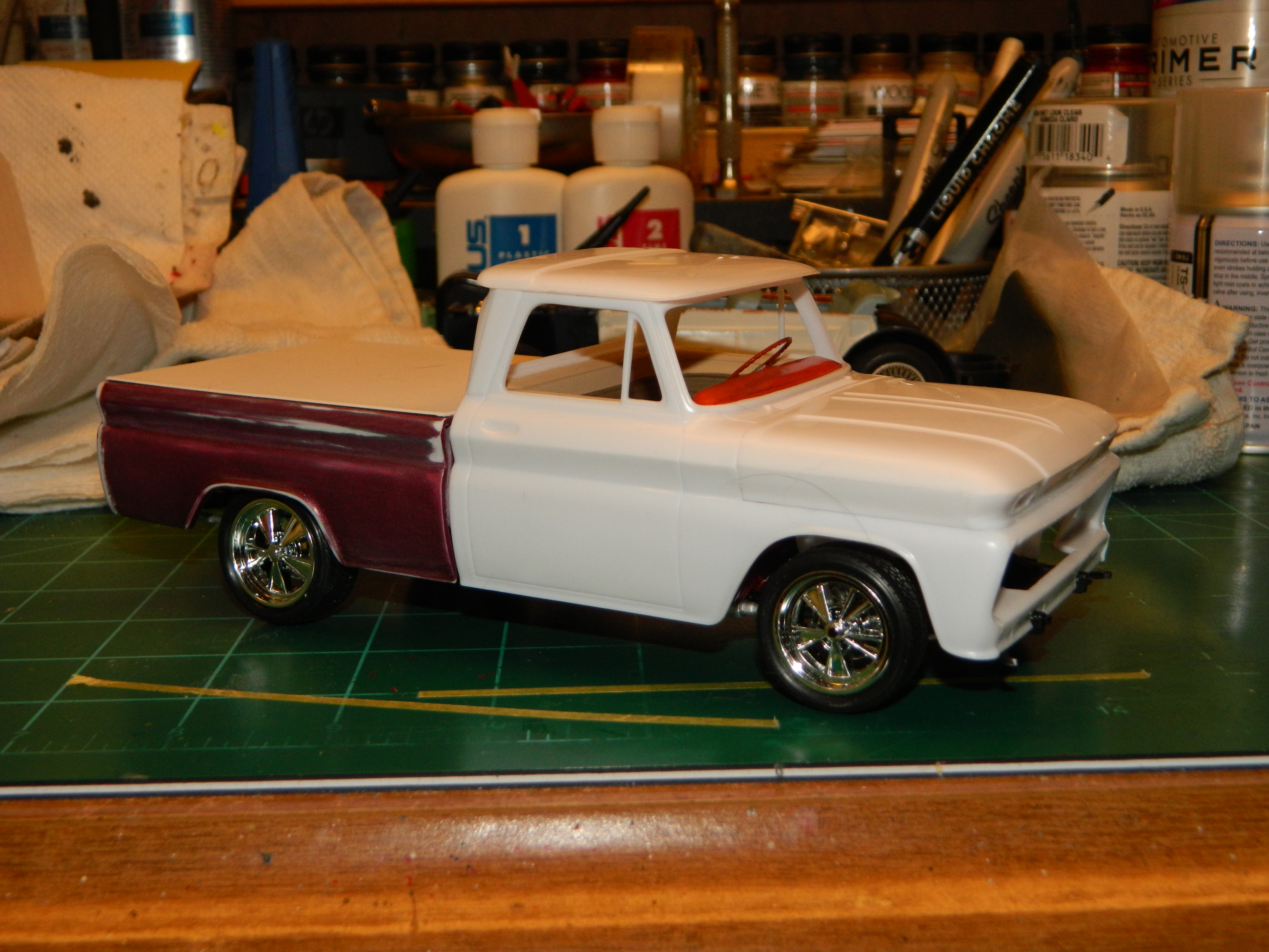

slusher Posted April 15, 2018 Posted April 15, 2018 Looking really nice Mike. Love the wheels. Did they come in the kit?
mrmike Posted April 15, 2018 Author Posted April 15, 2018 Thanks Carl! The wheels did not come in the kit. They are the optional wheels from the Revell '62 Corvette kit.

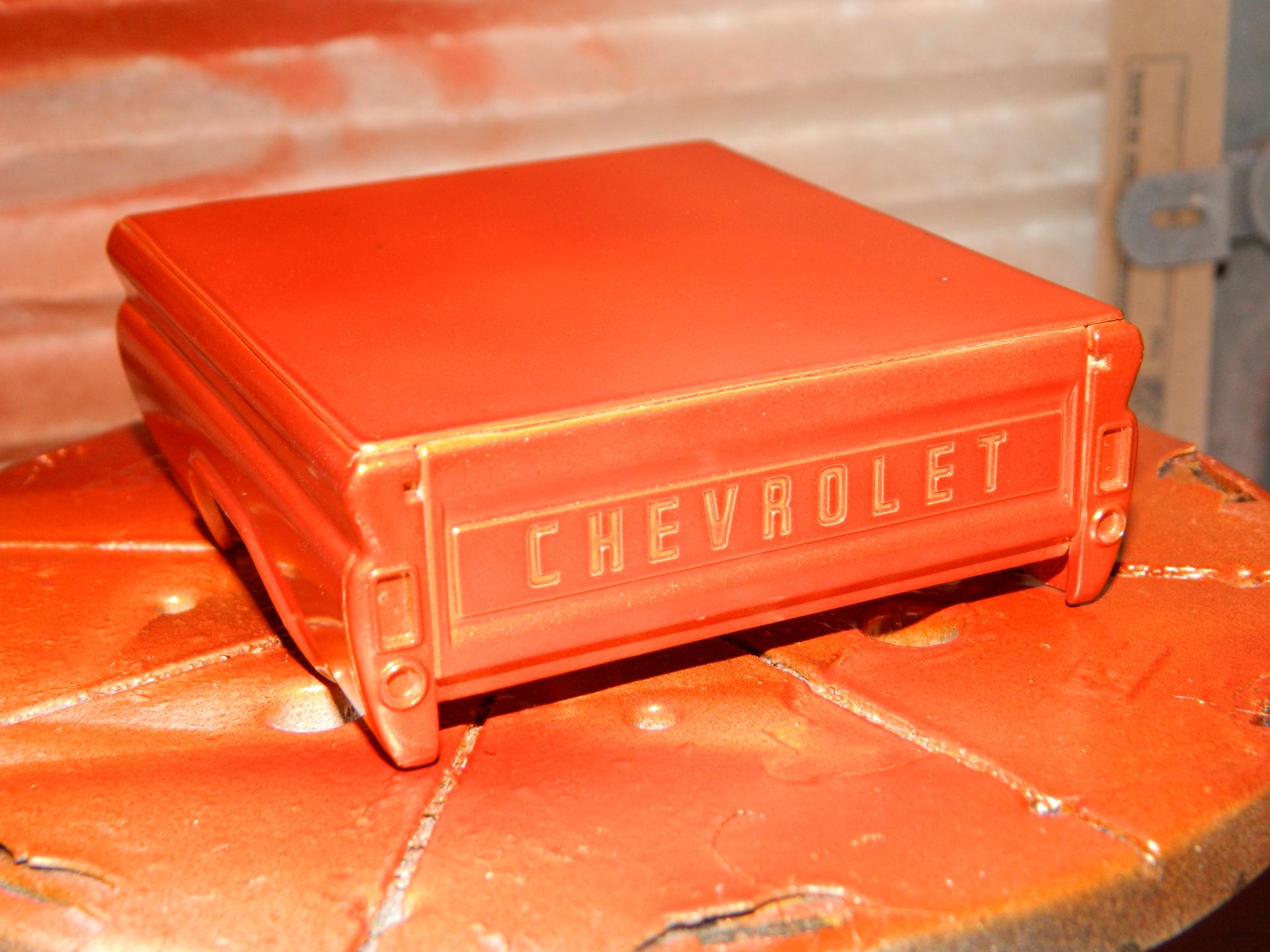

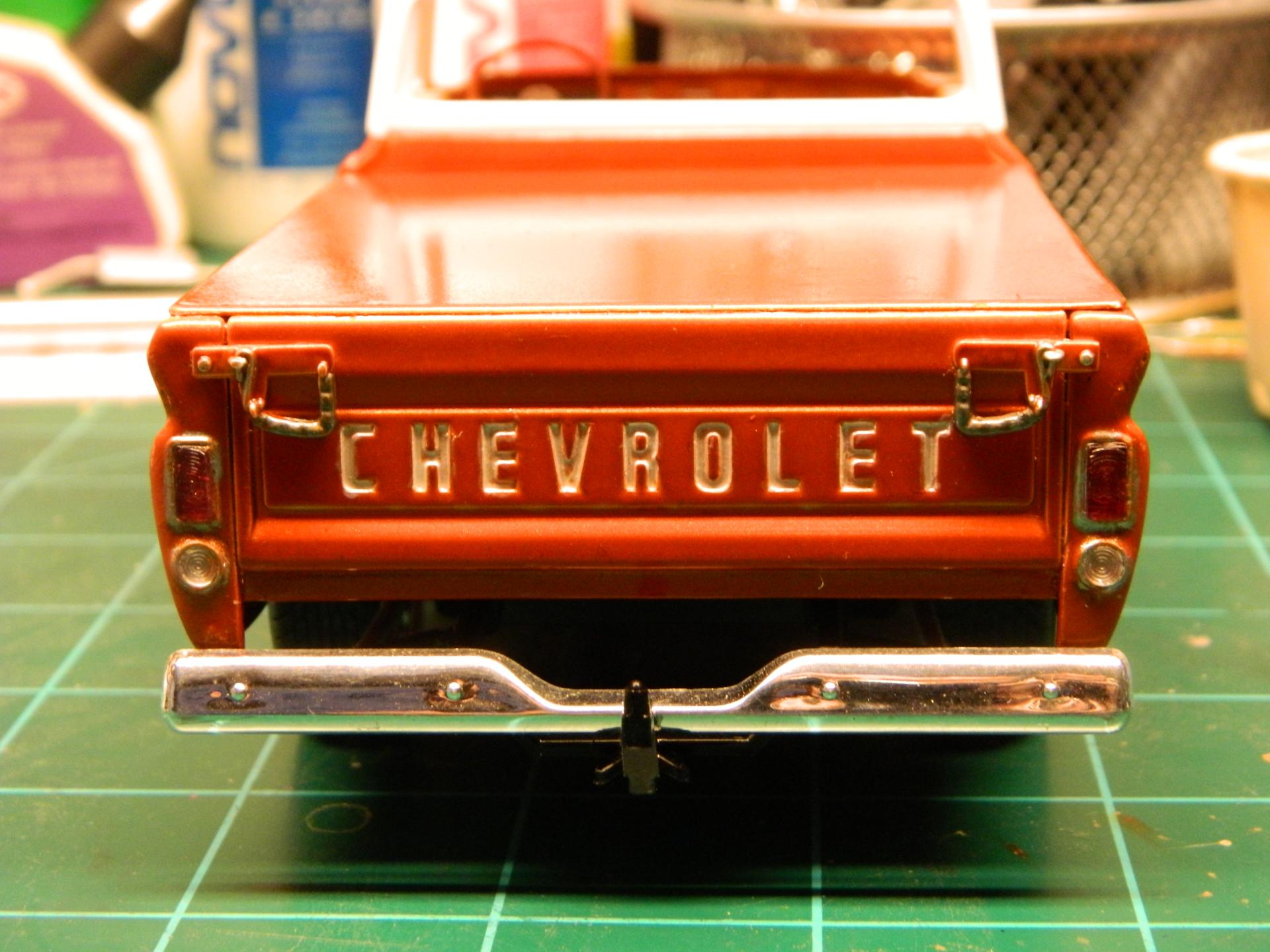

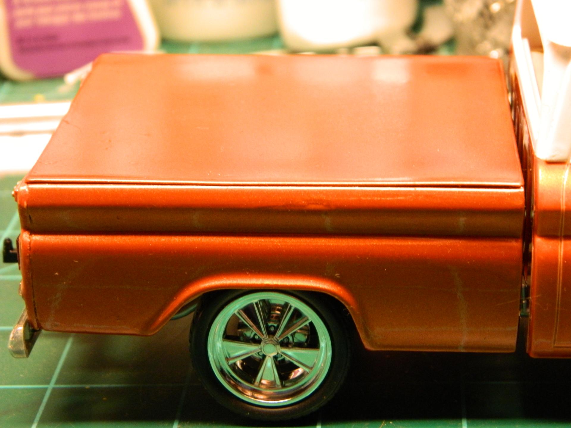

mrmike Posted April 26, 2018 Author Posted April 26, 2018 The Story Lt. Det. Macklin organizes the raid on Ollie's Body Shop while Lt. Det. Troy tries to question Davey on the murder of Peter Mathius. Davey is uncooperative and his public defender tells him to not answer any questions. Lt. Troy decides to return to the body shop with McNally to help with the raid with Lt. Det. Macklin and the Auto Theft Squad. It is now after well midnight and the Police officers quietly surround the building. With all exits covered, Lt. Macklin gives the command to go and the Police enter the shop with their weapons drawn and the occupants are caught off guard. The Build I had to repaint the bed of the truck when I noticed several marks on the passenger side when it was found resting on it's side A careful masking and repaint was in order but the color is a shade darker so I'll have to mask off the body and add another coat of paint and several coats of clear to it. I wasn't sure if I would be able to do this, but armed with a with a cup of Tamiya TS-45 Pearl White, a 000 brush, and my magnifier, I painted the lettering on the tailgate. McNally will return...
