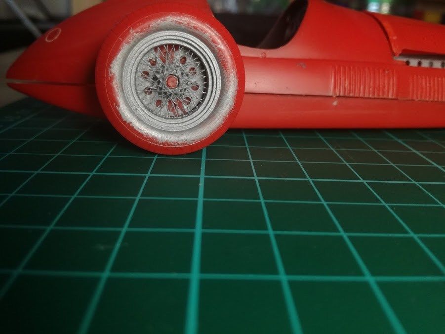

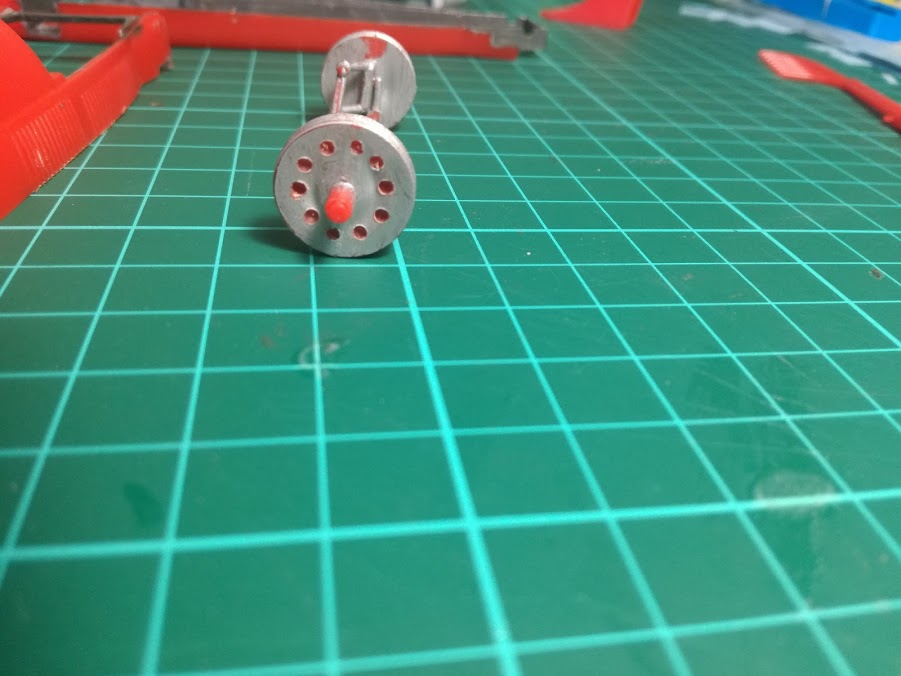

shaunmza Posted February 27, 2018 Posted February 27, 2018 Here is a kit I started on not too long ago. It's not really something I would normally get excited about, but it was cheap (for Portugal) and I had seen a video on doing up wire wheels that I wanted to try out. The kit manufacturer is MisterCraft, I bought 2 airplanes and helicopters that they do in the same order, those were VERY cheap and I see now why. The quality on this model far exceeds the other kits of theirs that I have. The model has a long way to go yet, I focussed mainly on the wheels. Here is the original wheel and one I have redone. View of the back of the wheel. The holes in the original are vent holes for the brake drums I think. I will be drilling corresponding holes into the drums on the axles. They may not turn with the wheels, but I think it will be ok... I 3d printed my own inner hub, this is the remains of my first attempt. I had glued the wheel slightly skew, so ripped it apart and did it again. This was the first wheel I did, I was so excited to see what it looked like with paint on I grabbed some silver paint from a rattle can and doused it. The paint reacted with the plastic and left this rough pattern you see. I saw later how skew I had glued the wheel together and redid it, no paint applied yet. Do you like the colours? The wires are from a cheap headphones, I stripped the outer layer off, the colours are for the ground, left and right wires. My terrible jig. Scrap wood, a printout and some small nails. Crude but it works. Did I say MisterCraft? Yes I did! It seems they use the same tooling as the Smer kit, but this one is a tad cheaper. I am hoping to do a video and photo series of the last wheel in case anyone has an interest in how I did it. When I have time of course...

Ace-Garageguy Posted February 28, 2018 Posted February 28, 2018 Your wire wheel work looks very good, and makes an otherwise unremarkable kit into something special. I hope to see your video too, when you get around to it. And yes, the Talbot-Lago was also done by Merit / SMER.

Bilingham Posted February 28, 2018 Posted February 28, 2018 Really nice work. The wheels are excellent.

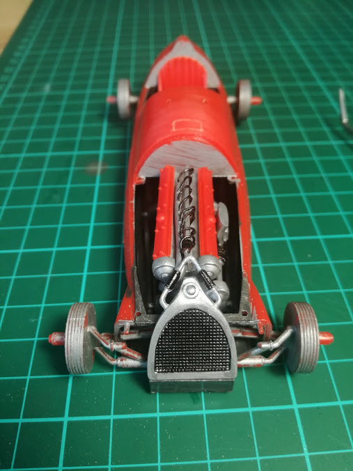

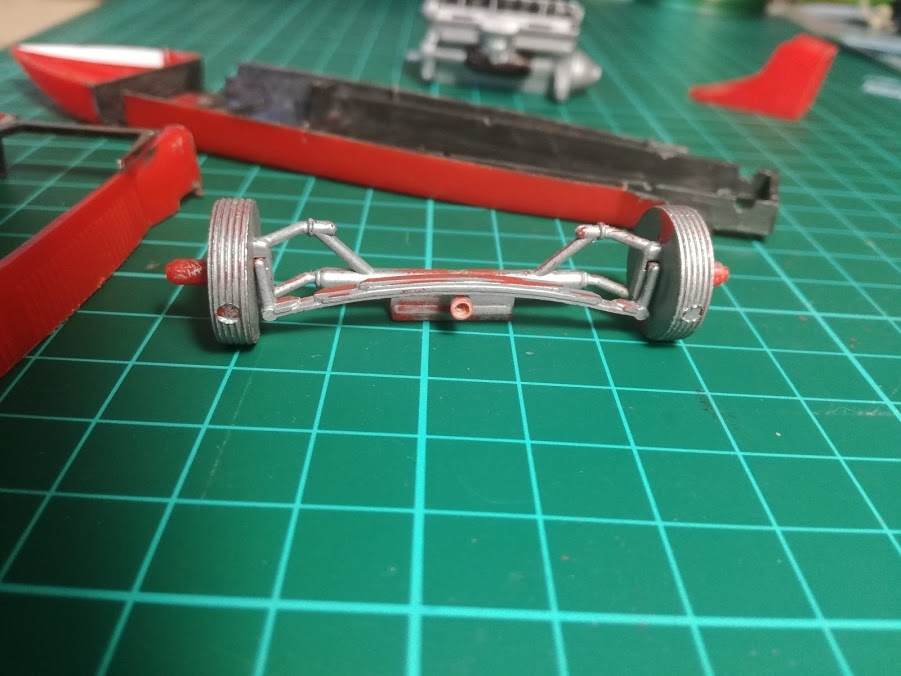

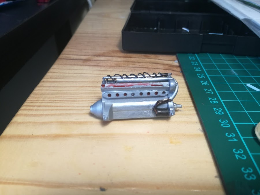

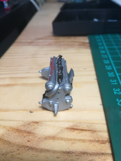

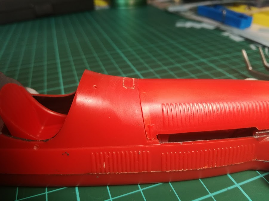

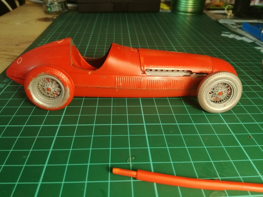

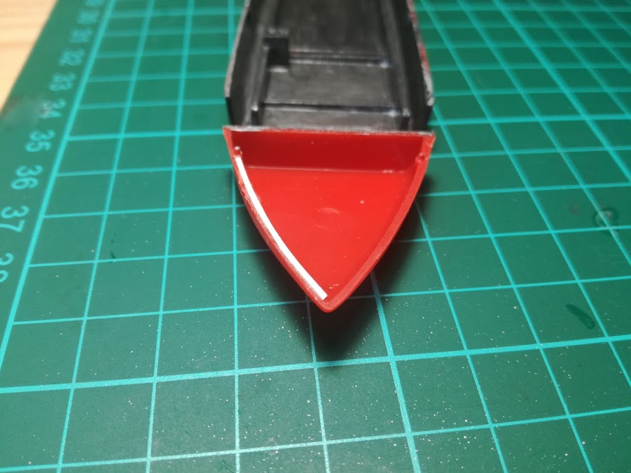

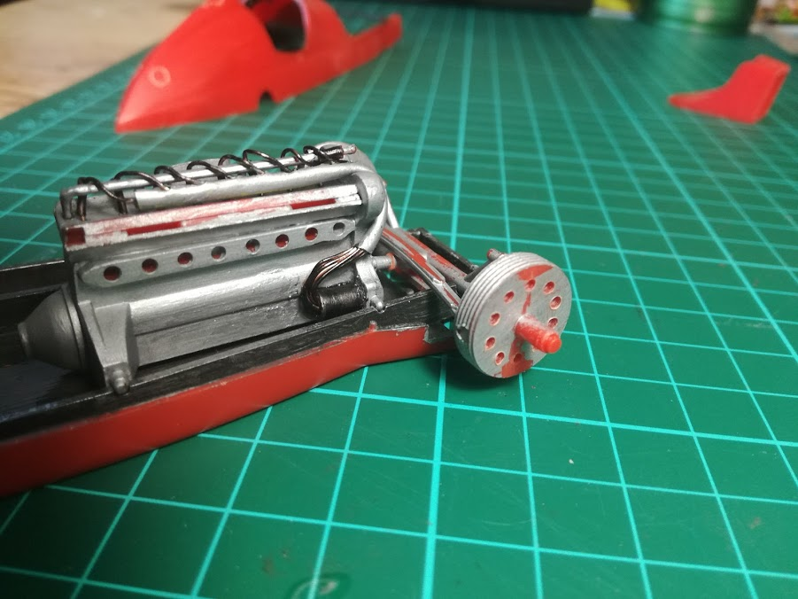

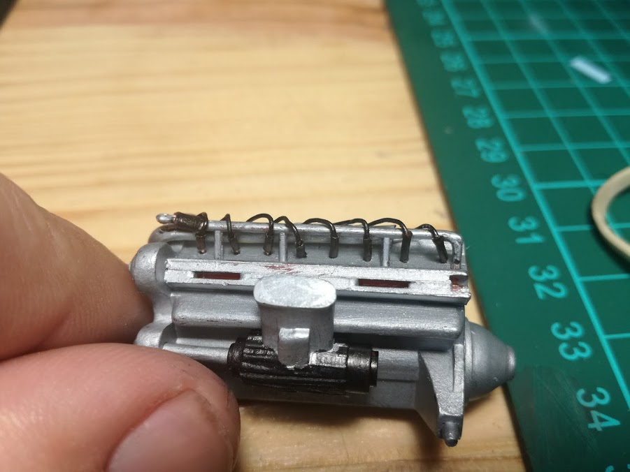

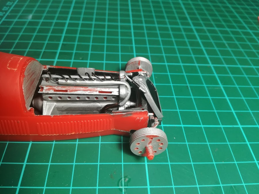

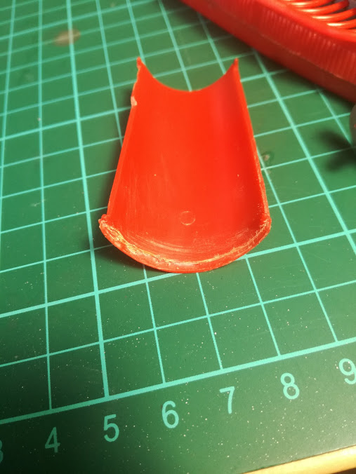

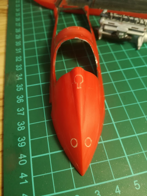

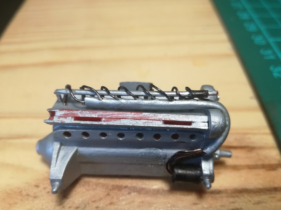

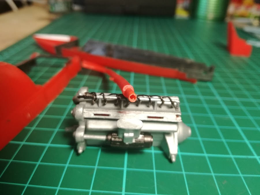

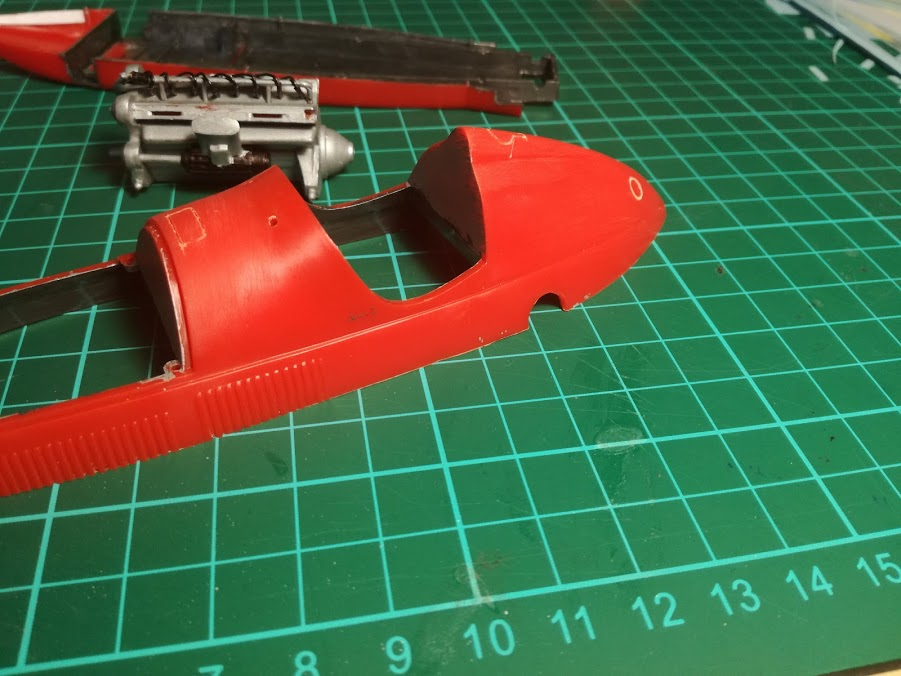

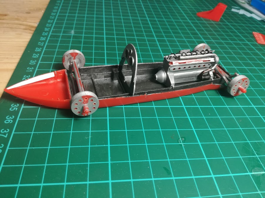

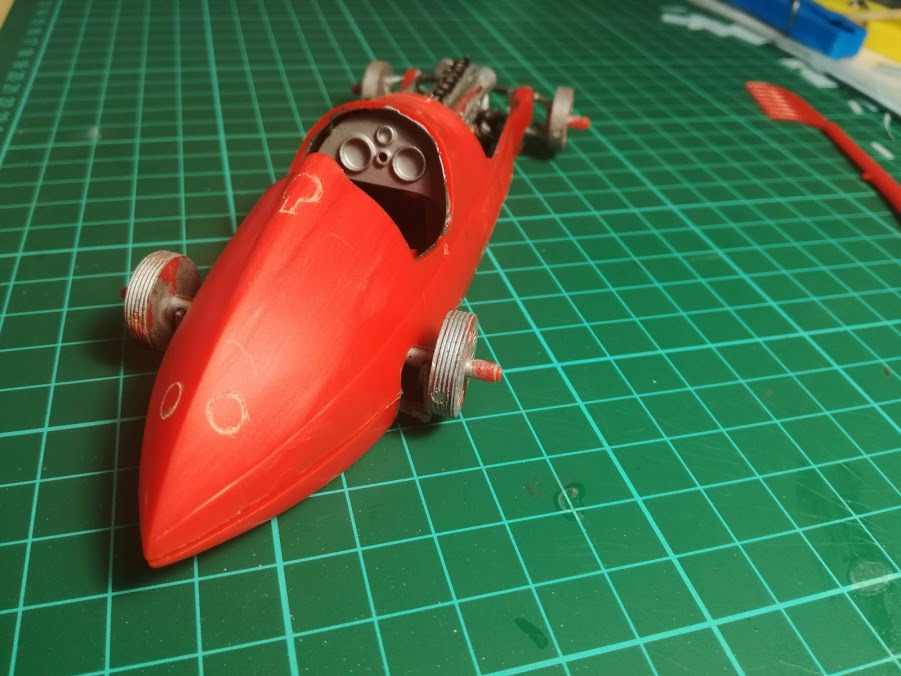

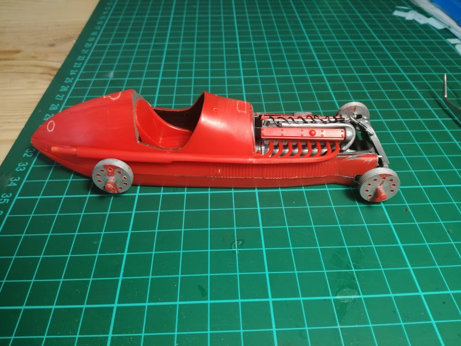

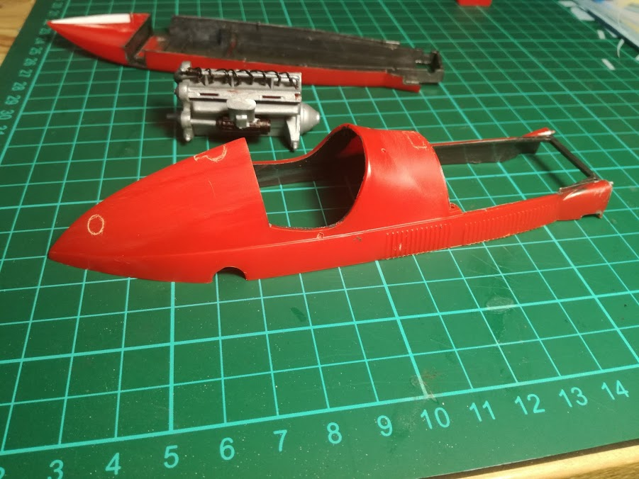

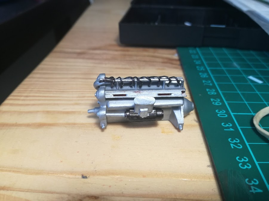

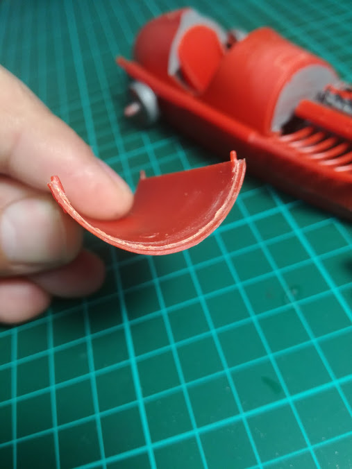

shaunmza Posted April 12, 2018 Author Posted April 12, 2018 With my mini shelved until the weather warms up enough for me to try and patch it up, I have returned to the Alfa. As usual I do bits here and there and never take photos, so here are a few to catch up. I added spark plug wires to the engine and tried to route them as best as I could to match the original motor. Unfortunately the rail that connects to the radiator is in the wrong position on the motor and I was really not keen to redril the holes and fill the old ones. With the supercharger attached. This engine has very little detail and differs quite a bit from the photos I have seen of both 158's and 159's I found a photo of an earlier version of this motor, where the distributor was down at the bottom of the motor. The correct place is right infront of the engine, by the left cam shaft, but I am lazy and do not see chance to make a decent looking distributor to match any of the photos I have seen. As you can see, my spark plugs are not exactly perpendicular to the cylinder head. I am in dire need of practice on this fine detailing stuff! The left side at the rear of the body is very thin and bends quite easily, so I gled in a small strip of styrene and trimmed it down. Much stiffer now. With the rainy weather I won't be able to paint soon, so am keeping busy trying random little things. There are a few details that are meant to have panel lines, but they are raised. These would be lost with pain (especially my painting) so I decided to try and scribe them instead. It's rough, but I am getting there. Hopefully the paint will hide the worst of it I also bought a micro drill set not to long back. I drilled out the exhaust, probably wont be noticable when don, but I love using those tiny tiny drill bits! I did the same on the shaft that I think represents the shaft used to manually turn and start the engine, a later photo shows why. Because I cut the hubs off of the original wheels to lace them up with wires, I decided to dill the vent holes into the drums. The original wheels would have had the holes turn with the wheels, as they would on the real car. I doubt anyone would notice if these do not turn though. The shaft from the motor was fouling on the front suspension, with a section drilled out, it now fits into it and looks a bit more complete. The leaf spring hides it though, so I may as well have cut either short. But it was fun to do. Partially assembled. Ignore the bad paint, it won't be airbrushed, but will get another coat. Top og the body on. Valve covers on, I still need to paint them. With the exhaust in place. I had to trim down the trailing edge of the hood as it would not lie flat. Another angle, showing the material removed. Now it fits flush with no force needed. What it looks like with badly painted wire wheels. The holes need some black paint, but I think the effect will be quite nice. In case you have not noticed, the quality of my builds is nowhere near the other builds I have seen on the site. I am posting it anyway as a way to record what I am doing. Once I have made my way through the kits I have, I will by more (cheap) kits and get more experience on them. One day, I will have an airbrush, paint booth and will not have to paint latge surfaces using brushes and enamel paints, but until then, I find the process of building to be relaxing, so eeven though the quality is not there, I am going to push on and finish as much as I can. Thanks for looking!
Anglia105E Posted April 12, 2018 Posted April 12, 2018 What you are doing here Shaun is truly wonderful..... and posting these fascinating photos is the best way to record your progress during the build. All this experience with how to overcome problems and get things right is going to be so valuable to you when you tackle each build in the future. This Alfa is a wonder in itself, and I keep coming back to look again at your work in progress. As you say, this building of scale model cars is so relaxing, and so rewarding too. David
Brizio Posted April 12, 2018 Posted April 12, 2018 Great job! Redo the wheels is a great improvement!
