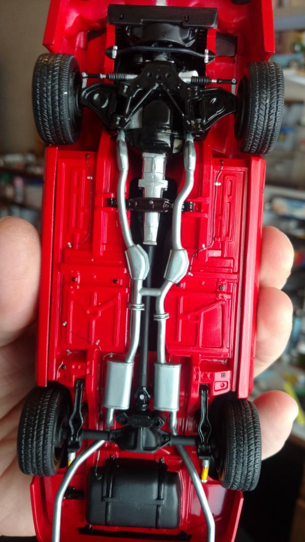

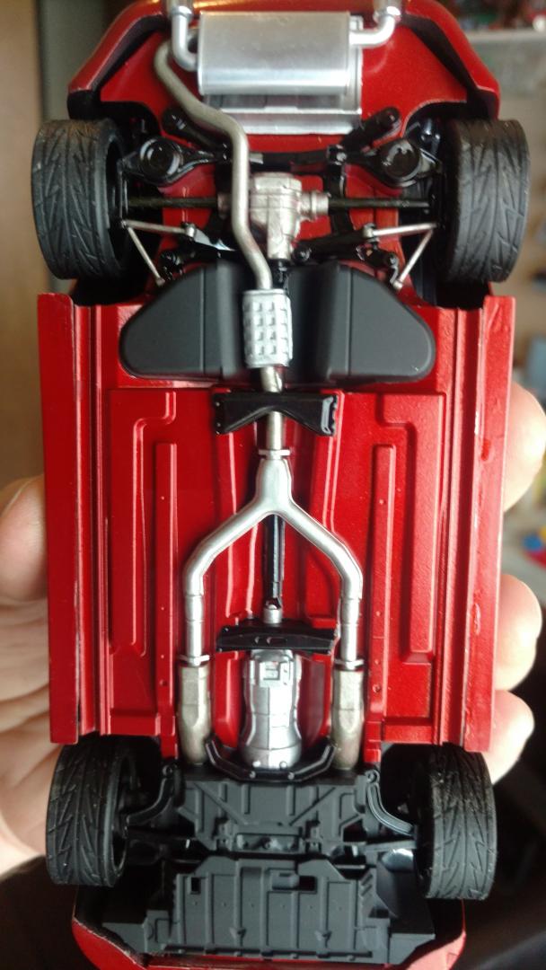

As for your build, be sure to use several shades and texture of black inder the car.  Even some olive drab for the hard fuel and brake lines where they aren't covered with heat or abrasion shielding.  Use a pale brass color for the connections.  Flat or semi-gloss for the rubber boots on CV joints and steering rack boots, aluminum or gloss black for the rack itself, pale gold or pale brass for the bolt heads on the subframes, etc.
Here's a picture of my Tamiya 370Z that is one solid chunk of plastic with just detail paint.15245191623512113343923.thumb.jpg.1b22541707d47fa6378ea853887ef28a.jpg
And one of my Revellogram 93 Cobra
Both were straight out of the box and were awarded first places in box stock due to the detail painting and attention to details of fit and finish.
