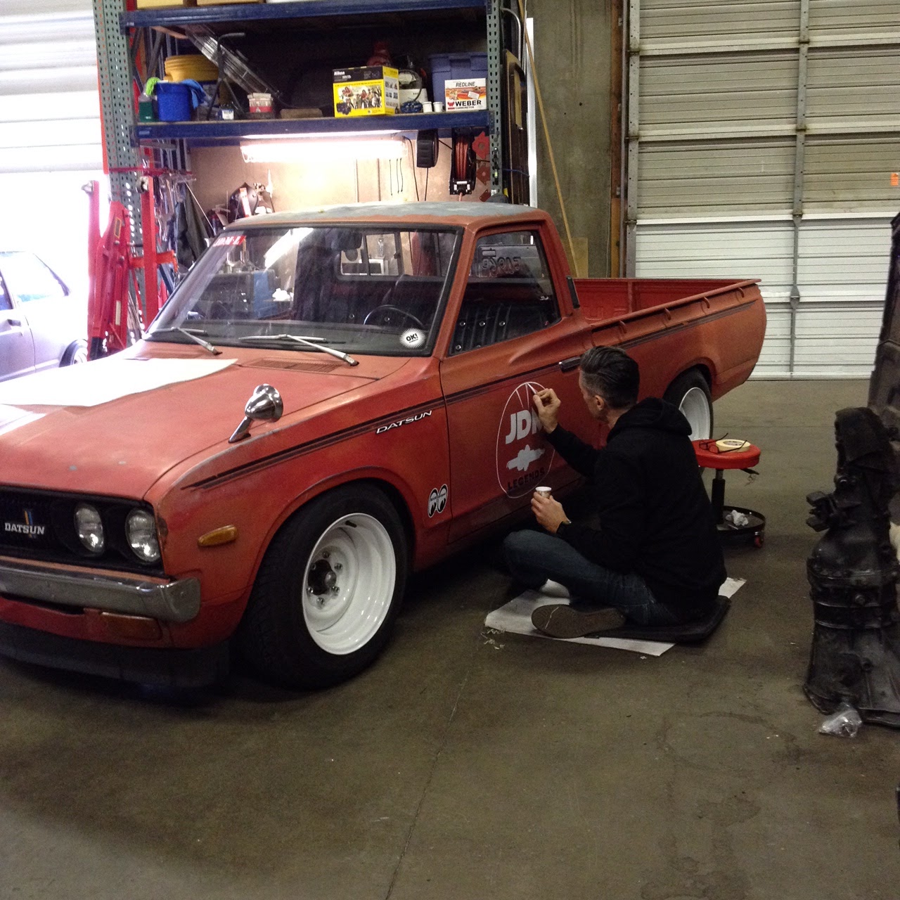

afx Posted May 13, 2018 Share Posted May 13, 2018 (edited) Won this yesterday in a raffle at NNL Mid-Atlantic. The plan is a JDM Legend shop truck inspired build. The head end of the truck bed is cast integral with the truck cab. I cut it loose and attached to bed as the 1:1 would be. Edited May 14, 2018 by afx Quote Link to comment Share on other sites More sharing options...
Snake45 Posted May 13, 2018 Share Posted May 13, 2018 The sit/stance of the real one you posted is very similar to what I hope to achieve with mine. Giving serious thought to putting a SBC in it. I was just gonna graft in a whole Camaro subframe but discovered that the truck is SO much narrower than a Camaro that THAT wasn't at all practicable. Quote Link to comment Share on other sites More sharing options...
cobraman Posted May 13, 2018 Share Posted May 13, 2018 Bought one new in 77. Nice little truck. Seemed at the time everybody had a mini truck with a ATC in the bed. Quote Link to comment Share on other sites More sharing options...
espo Posted May 13, 2018 Share Posted May 13, 2018 Great build idea for this kit. I have seen this little truck on the weekly program and really like the look. If this has been built like their customer's car it should be a fun little hauler. I would double check what all they had done to the engine since I think it has been changed from stock. Try and replicate that engine and the wheels are a big part of its appearance also. Quote Link to comment Share on other sites More sharing options...
Snake45 Posted May 13, 2018 Share Posted May 13, 2018 19 minutes ago, espo said: Try and replicate that engine and the wheels are a big part of its appearance also. He said he was gonna build it "inspired by" the shop truck, so I'm not sure he's concerned about 100% replication accuracy of every detail. Quote Link to comment Share on other sites More sharing options...

Impalow Posted May 14, 2018 Share Posted May 14, 2018 Yeah the 6 lug thing is kinda a bummer (even on the 1:1).... although in this other photo I found, the wheels look like 6 lug smoothies painted white. You can probably source centers and make a lip? That is if you want to make more of a replica... either way consider me subscribed to this one, I love these trucks! Quote Link to comment Share on other sites More sharing options...
