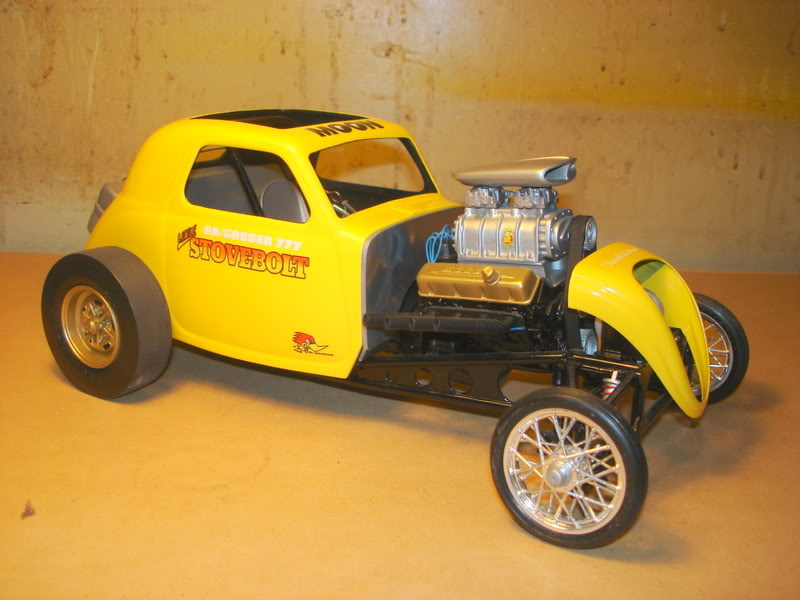

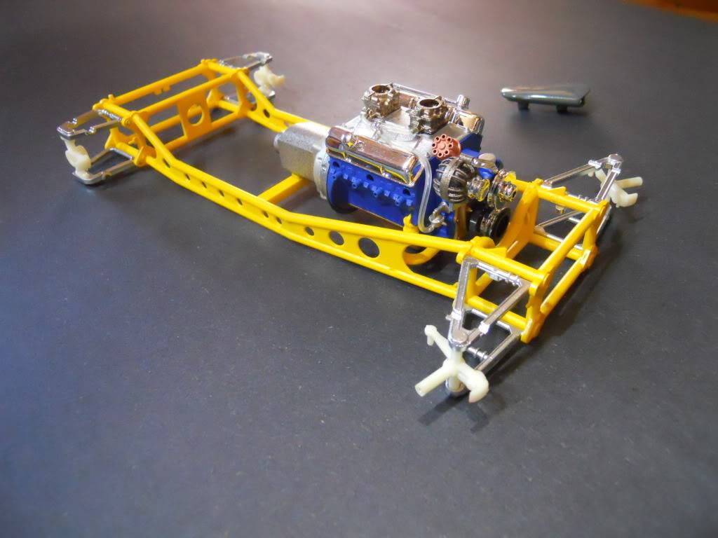

While the chassis could be reworked into something less toylike, possibly appropriate to a '50s sports car, as mentioned above, it is absolutely wrong for an "altered" class drag car.
A perusal of the google image results for "Fiat Altered" will demonstrate this quite conclusively.
Furthermore, the kit does NOT come with the blower or the wire wheels shown in the photo of the built one.
Note the front suspension on all of these: a simple, straight tube axle, chosen for being light. IFS (independent front suspension) is absolutely NOT required on this type of car. Neither is independent rear suspension. Too fragile, and moves around too much for the application.
image.jpeg.daec35d4b0999bc6b9788c9c46e7eb9f.jpeg   image.jpeg.dc5b6012664bfa5e5ee485a3c04b0c4d.jpeg   image.jpeg.32a67b32936009c30855964bd78ce4b0.jpeg
An equally simple parallel tube frame would be appropriate for an altered class car, not the unnecessarily complex thing in the kit.
Image result for fiat altered      Image result for fiat altered
The engine in the kit is also not representative of anything real. It's a mashup of smallblock Chevy and Y-block Ford, with some other stuff thrown in.
