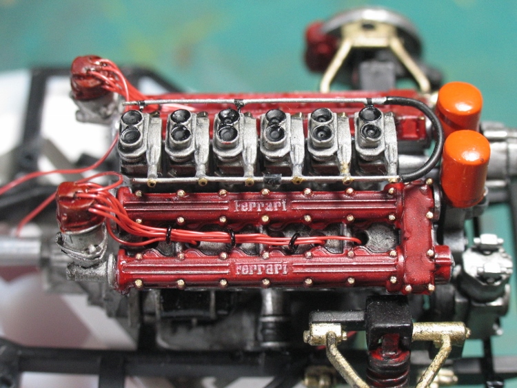

Belugawrx Posted August 17, 2018 Posted August 17, 2018 (edited) This is single strand, coated, 34 AWG I like it,..I think after I touch up about 100 spots on the intakes and make some boots, I'll brush the leads with some Dullcoat,...done. Thanks a ton for the link to www.micronmeters.com Kit Basher. And Thanks to RandyD for setting me up with those beautiful distributors from Historic Racing Miniatures Cheers Edited August 18, 2018 by Belugawrx forgot sumthin
Kit Basher Posted August 18, 2018 Posted August 18, 2018 3 hours ago, Belugawrx said: Thanks a ton for the link to www.micronmeters.com Kit Basher. You're welcome. That Ferrari engine looks fantastic in every way.
