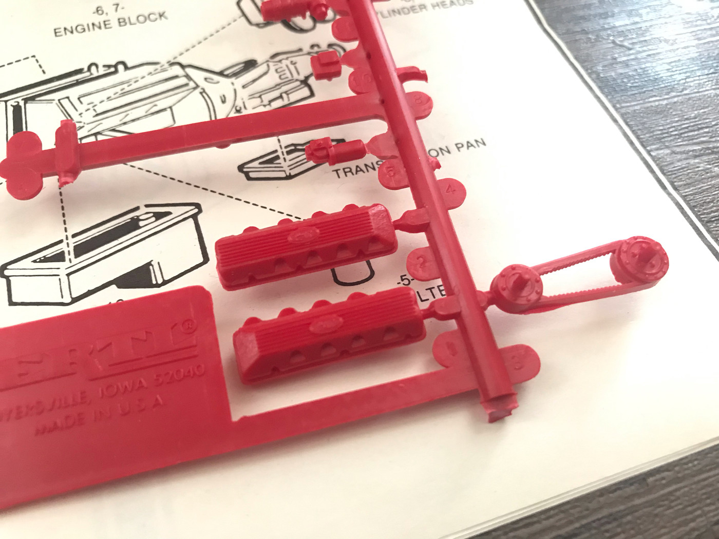

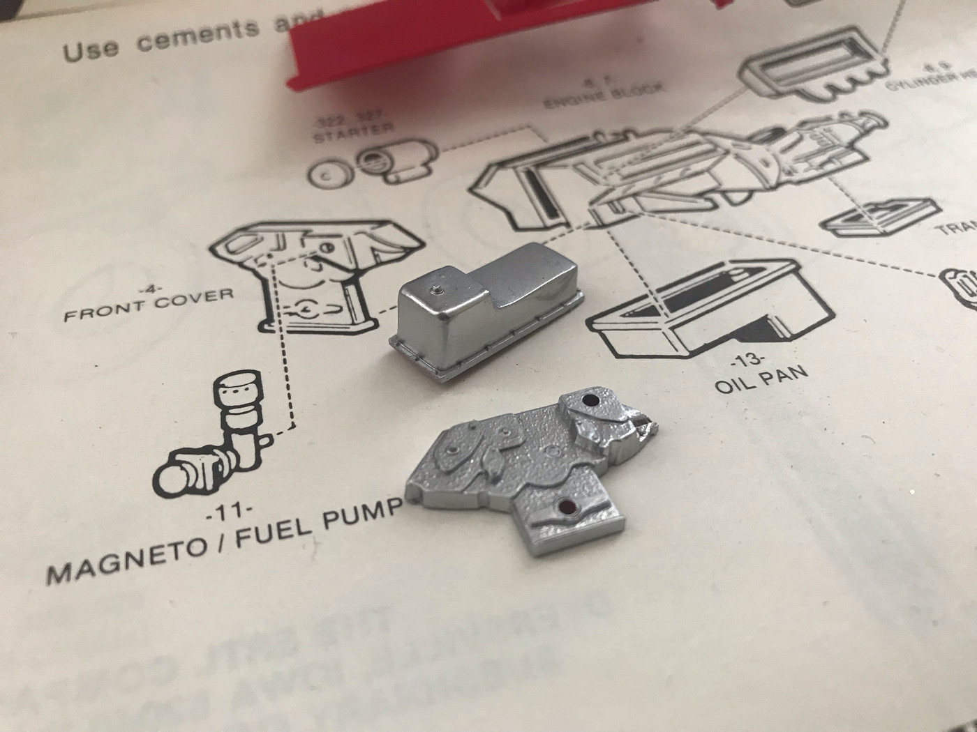

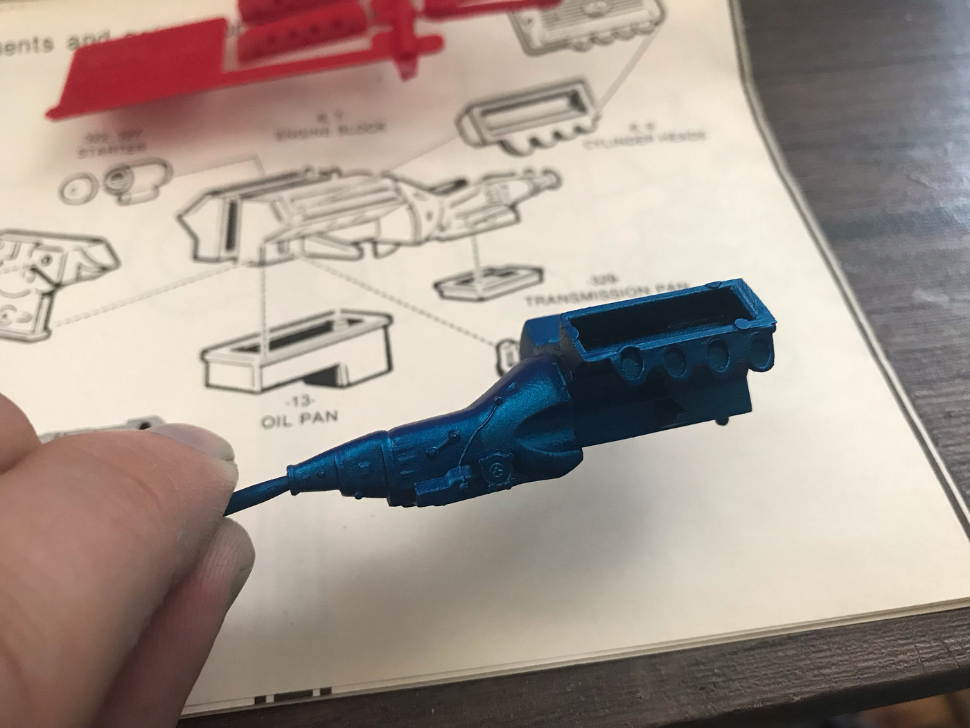

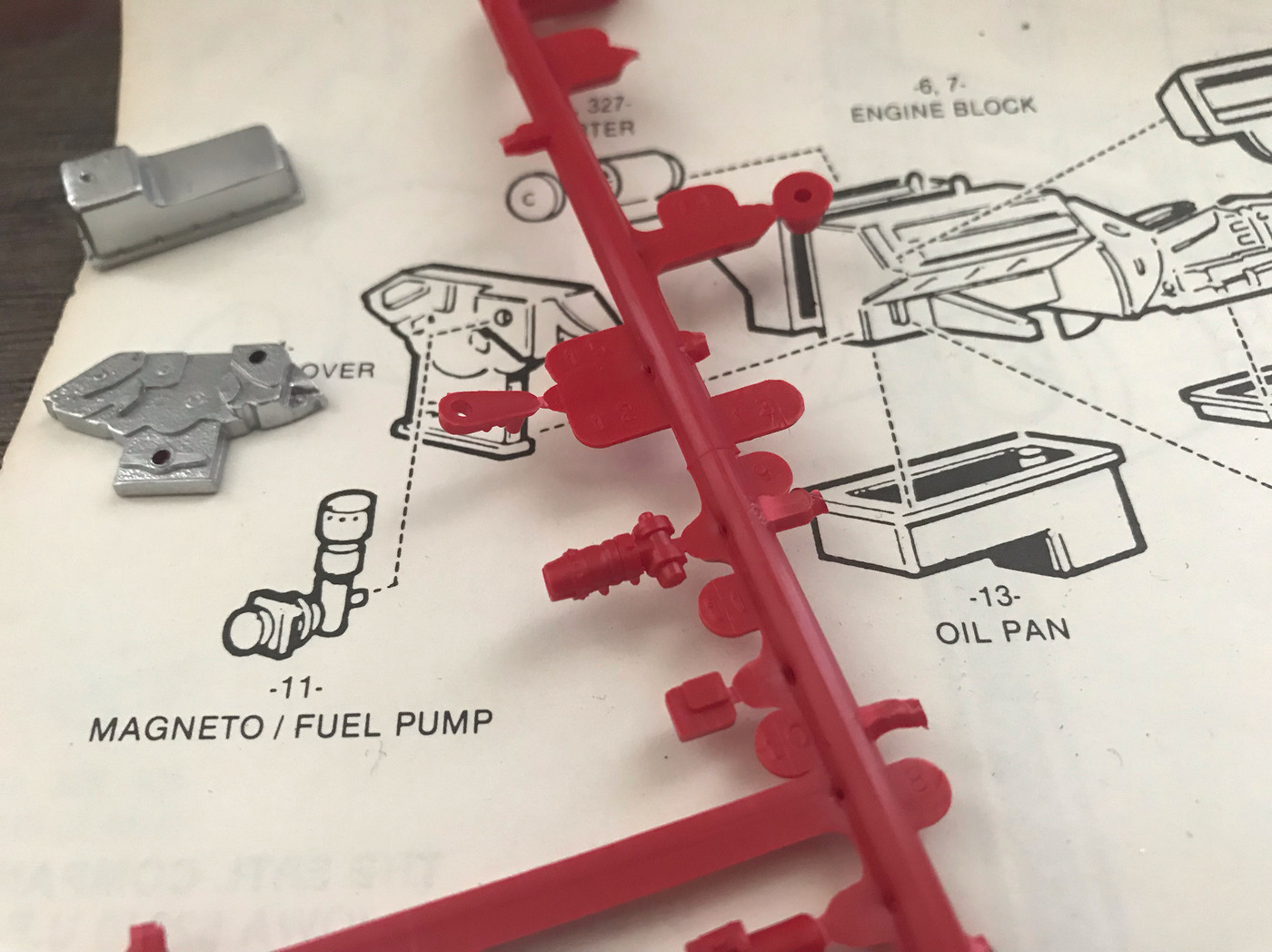

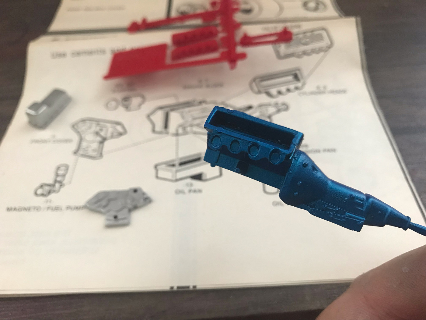

CabDriver Posted July 4, 2019 Posted July 4, 2019 The T'rantula isn't the only showrod kit with a SOHC...I just started building AMT's Li'l Gasser fuel truck and it has one too. Whether it's a GOOD one or not is up to interpretation - I don't have the same knowledge that a lot of you do but this thread has been very informative and interesting! Pics of my in-progress AMT Li'l Gasser motor below... 1
CabDriver Posted July 13, 2019 Posted July 13, 2019 (edited) A follow up to my post above, for all you SOHC experts...is that combined magneto/fuel pump in the bottom picture in any way accurate for this engine? I couldn't find anything like it in my search of 1:1 parts...and whilst this is for a showrod build and doesn't NEED to be technically accurate, I'd like it to be anyway ? Ps: sorry for the thread hijack - but this post was the first place I looked for my research! Edited July 13, 2019 by CabDriver
Ace-Garageguy Posted July 13, 2019 Author Posted July 13, 2019 (edited) 1 hour ago, CabDriver said: ...is that combined magneto/fuel pump in the bottom picture in any way accurate for this engine? I couldn't find anything like it in my search of 1:1 parts...and whilst this is for a showrod build and doesn't NEED to be technically accurate, I'd like it to be anyway... It's perfectly plausible. Ford's engineers, in their wisdom, provided multiple points on the timing chain cover for various accessory takeoff drives. Combo mag/fuel pump drives are common where space is at a premium. The 1:1 rig in the photo below is essentially what's represented in your particular kit, and could definitely be mounted at the location shown with a few readily machined parts. Here's a similar combo right-angle mag drive/fuel pump drive with an old-school Vertex-style mag, mounted more conventionally on a pushrod-engine timing cover. In this case, it would be driven off the end of the cam...but it could definitely be mounted as your kit shows it on the Ford cammer as well Edited July 13, 2019 by Ace-Garageguy 1
CabDriver Posted July 13, 2019 Posted July 13, 2019 Thank you so much Bill! I was almost certain that you’d know! Appreciate the informative response - I learned a thing!

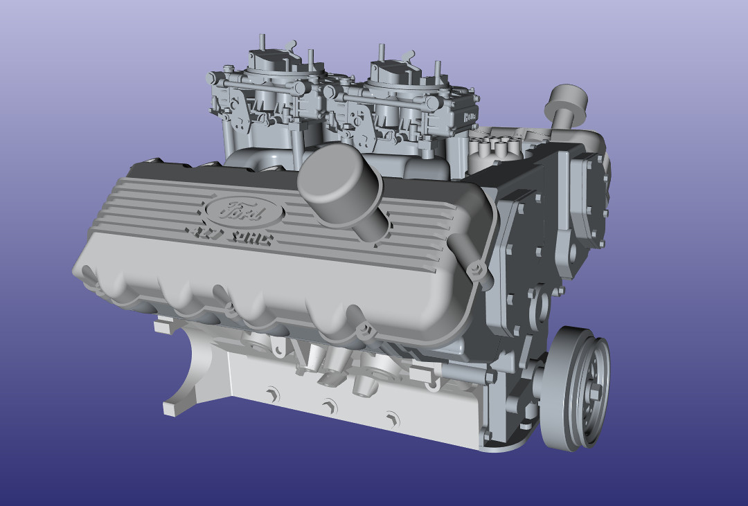

Mr. Metallic Posted February 6, 2023 Posted February 6, 2023 @Ace-Garageguy have you gotten one of these yet? I have some of their other products and they're pretty great. But since you've done the workup on dimensions and everything I'm looking forward to your thoughts on if this is now the definitive best 427 Cammer available? https://tx3dcustoms.com/products/ford-427-sohc-hilborn-injected 2
