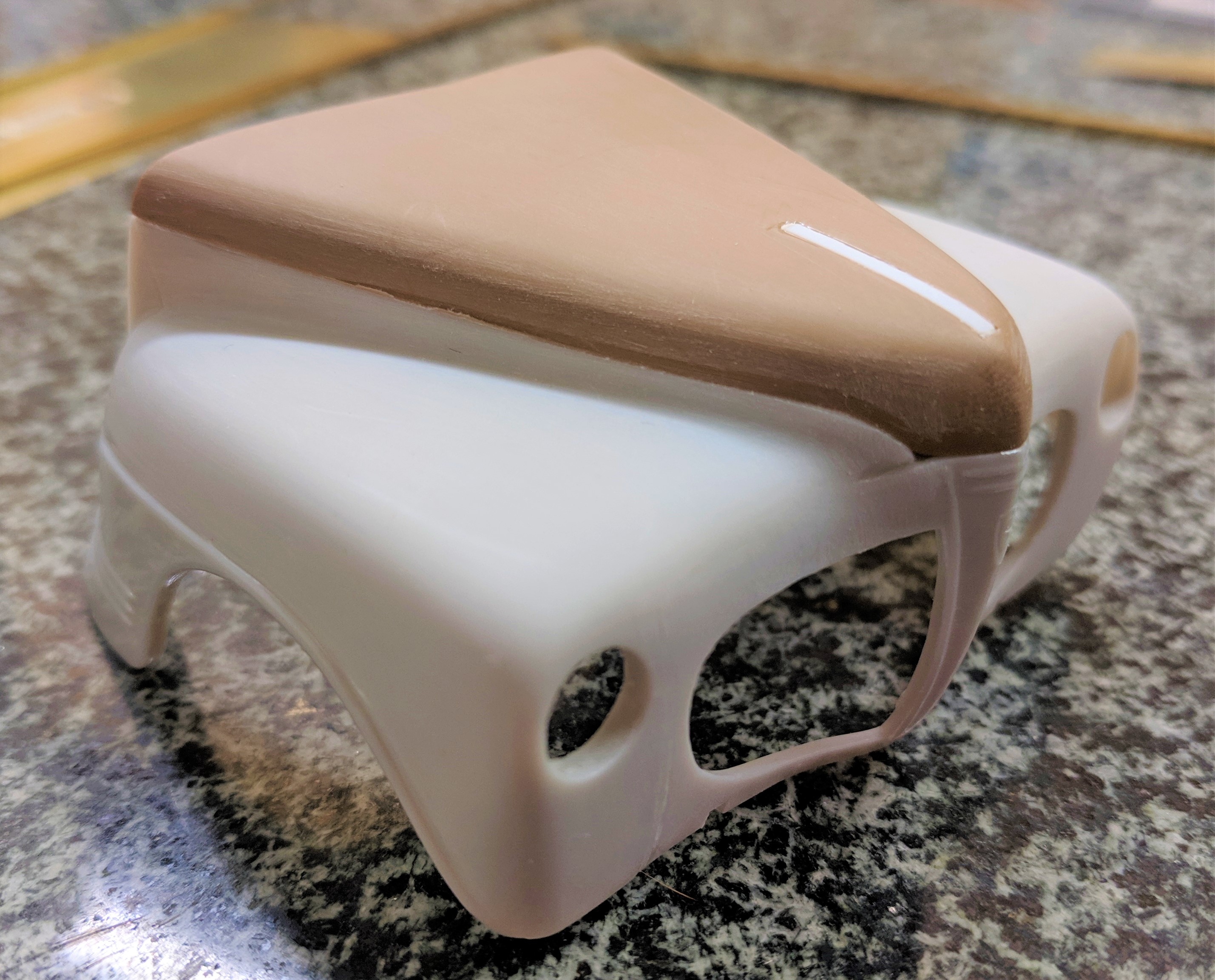

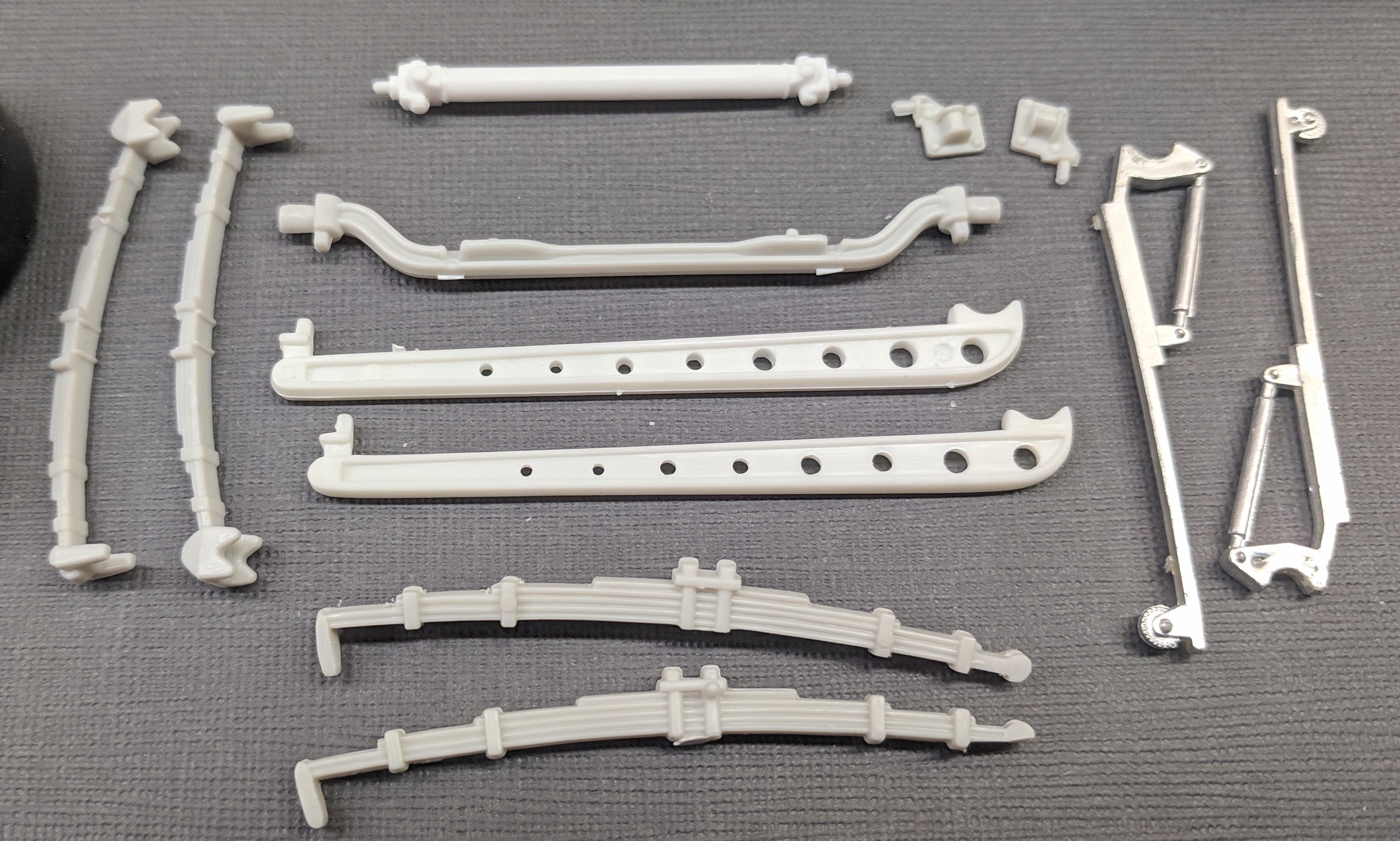

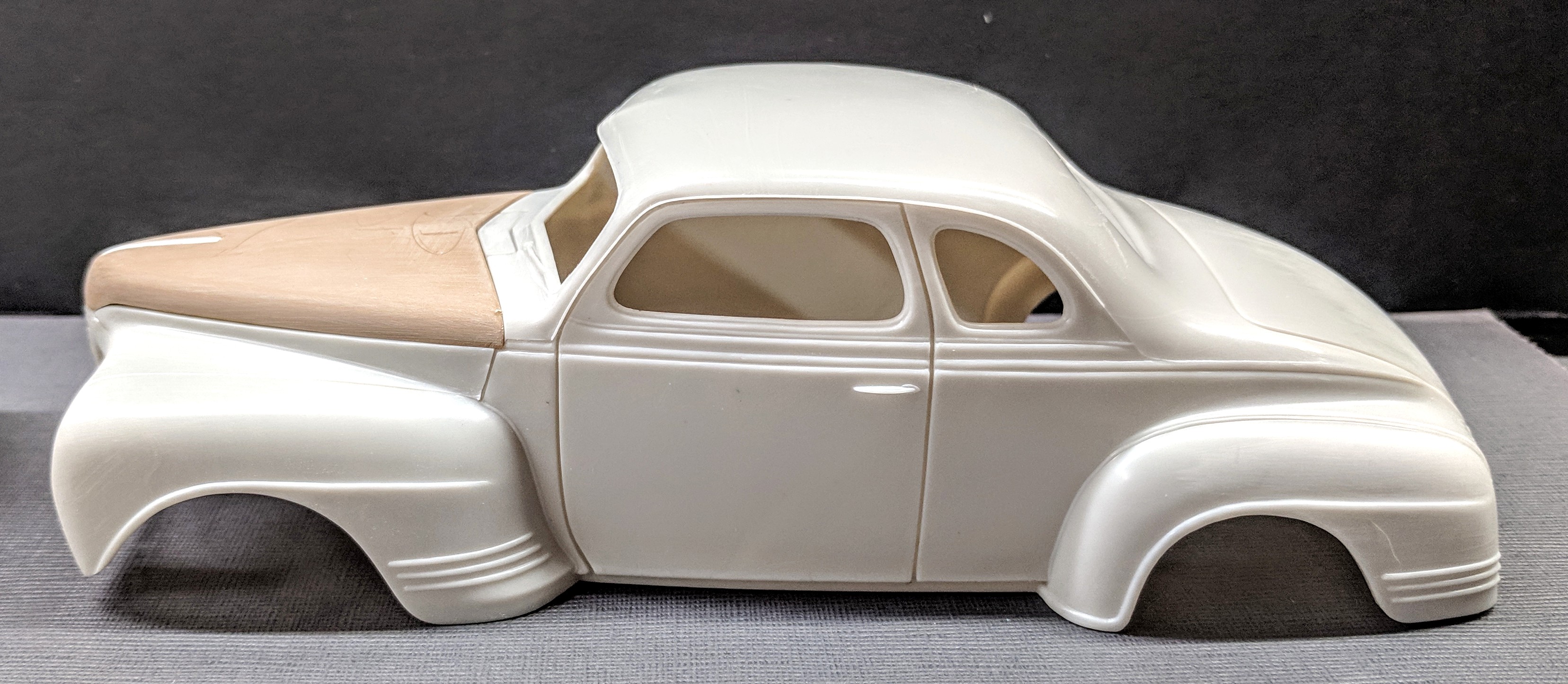

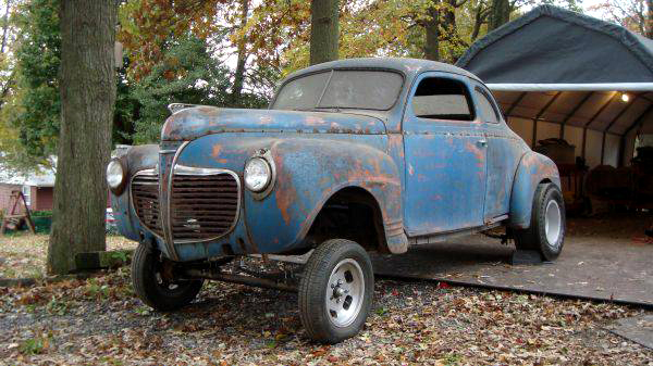

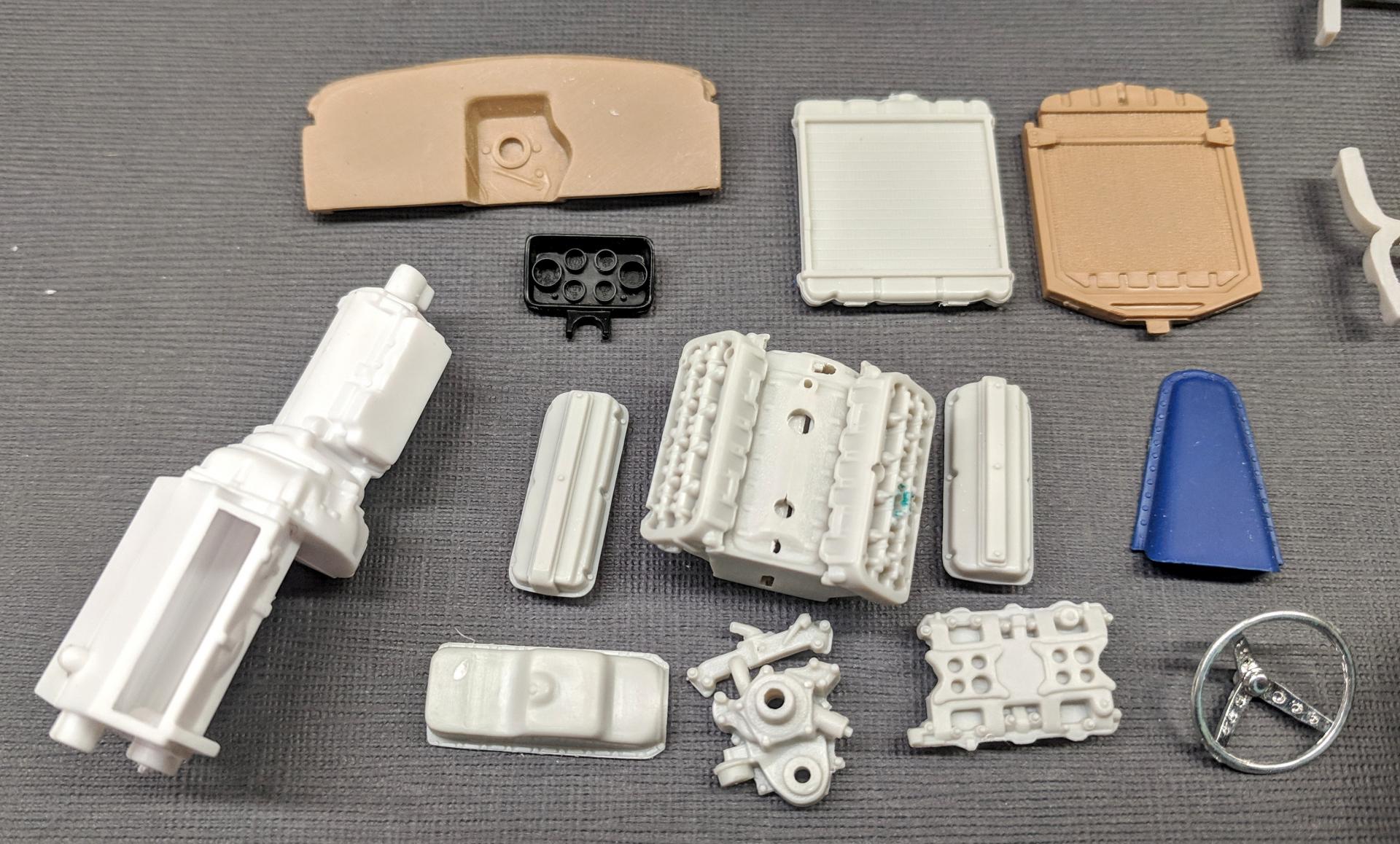

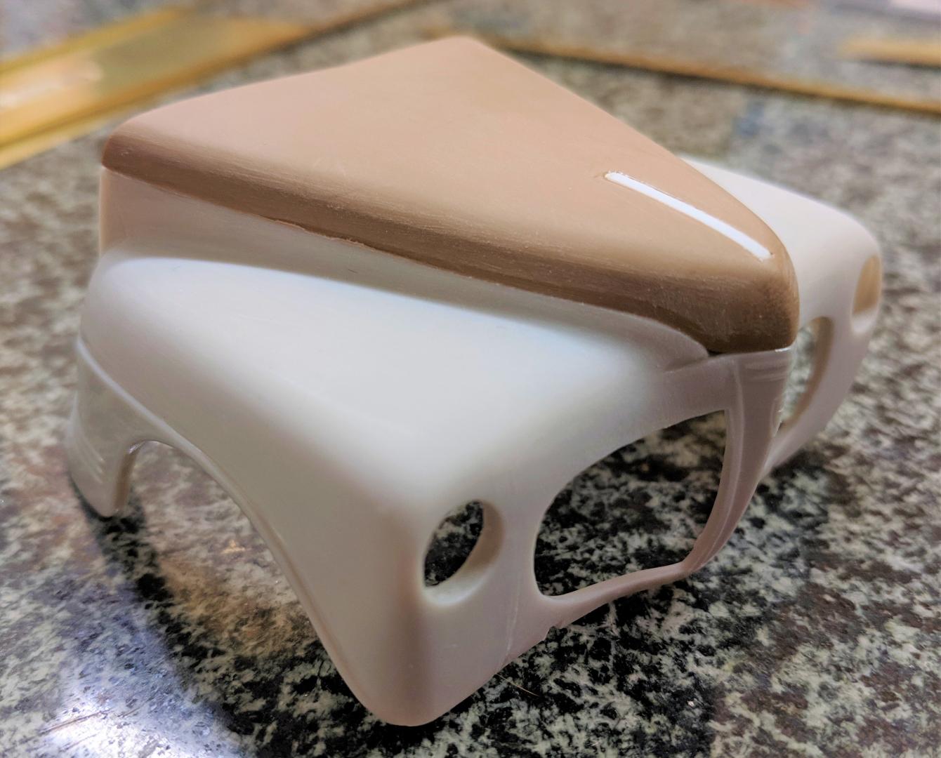

Casey Posted November 21, 2018 Share Posted November 21, 2018 (edited) Technically speaking, this project got under way last year, but I began working on it again this week, and made some progress worth documenting, so we go. My inspiration is this forlorn blue '41 Plymouth Coupe found on the web years ago. I am planning to lean more toward the 'nose high' look with this project, but not quite this high: Body work so far includes scribing the door gaps deeper, removing one molded on windshield wiper arm and blade, filling in the hood ornament recess, removing the vent window guide channels and cleaning up both doors' window openings. The windshield opening is a mess, so I may end up making a new windshield and/or gasket to improve things. Changing the nose to a tilt front end is an option I'm considering, as it will conveniently allow me to remove all of the panel joints and the welting between them, and make the nose a one-piece part. As for the engine, I'm using the early Chrysler Hemi from the AMT '57 Chrysler 300C kit, which is nicely done. The block halves and cylinder heads have been assembled, and the stock transmission was removed in preparation for the aftermarket trans adapter and B&M HyroStick trans. I was planning to use the trans from the Revell Orange Crate, but lucked into a Revell modern '41 Willys kit trans, so that'll be used instead. I'll probably keep the stock valve covers, but the intake choice is still undecided. Below are pictured the engine parts, gauge cluster from the AMT '37 Chevy Coupe, steering wheel from the AMT '58 Impala, unknown blue hood scoop, and the stock Plymouth firewall and radiator, as well as a radiator from the same Revell Willys kit as the trans?: Suspension bits are form the AMT '50 Chevy Pickup (front and rear leaf springs and front axle), shock mount plates from the '57 300C, "Traction Masters" from an AMT early Funny Car kit, and a driveshaft and wheelie bars from the parts box. Still need to decide on a rearend, too: Tires are some vintage AMT Firestone skinnies and Revell M&H Racemaster pie crust slicks for the rear. Front wheels will be the pictured five-slots for now, rear wheels TBD: Edited November 28, 2018 by Casey Quote Link to comment Share on other sites More sharing options...

Ace-Garageguy Posted November 21, 2018 Share Posted November 21, 2018 All the right parts and a sound plan. I've had something similar going off-and-on for years, so I'll be following. Doing a flip-nose isn't too difficult if you make up a tubular front crossmember to carry the hinges. Then it's just a matter of getting the up-and-over geometry of the hinge arms dialed in. Quote Link to comment Share on other sites More sharing options...

stavanzer Posted November 21, 2018 Share Posted November 21, 2018 The scoop is from this kit. Quote Link to comment Share on other sites More sharing options...

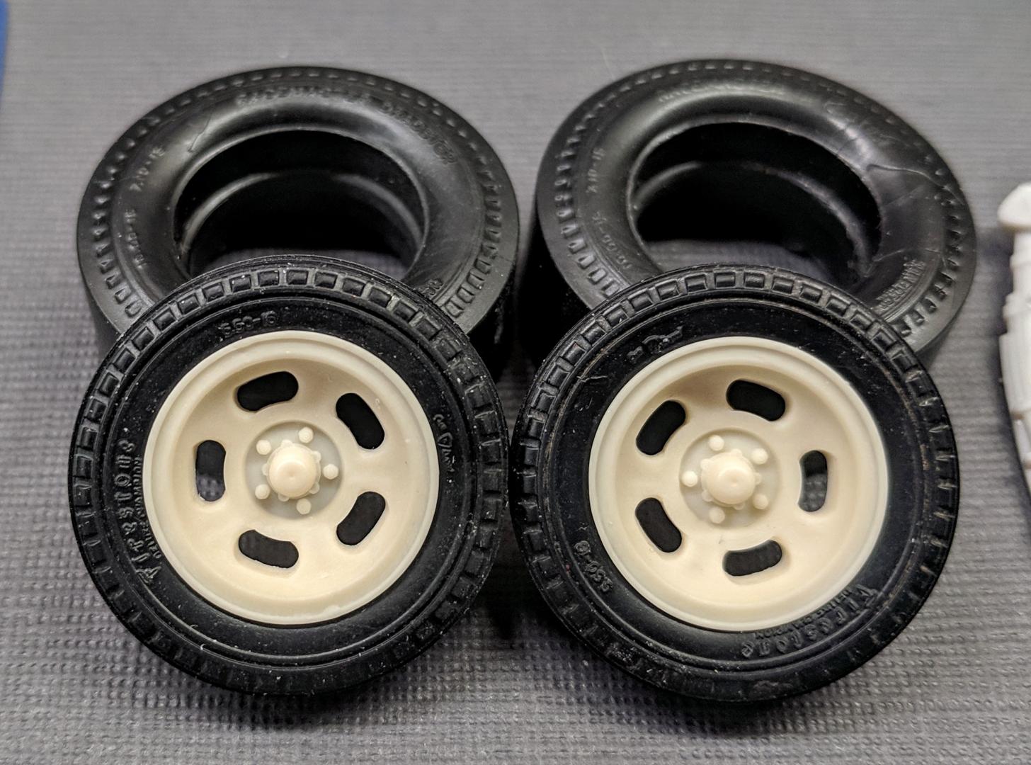

Alan Posted November 27, 2018 Share Posted November 27, 2018 Who cast the resin front wheels ? I would not use that era of wheelie bar though .............. Quote Link to comment Share on other sites More sharing options...
Casey Posted November 28, 2018 Author Share Posted November 28, 2018 (edited) On 11/26/2018 at 11:19 PM, Alan said: Who cast the resin front wheels? I cast them. On 11/26/2018 at 11:19 PM, Alan said: I would not use that era of wheelie bar though Already back in the parts bin with a few other things. On 11/21/2018 at 8:30 AM, Ace-Garageguy said: Doing a flip-nose isn't too difficult if you make up a tubular front crossmember to carry the hinges. Then it's just a matter of getting the up-and-over geometry of the hinge arms dialed in. Yes, cutting the 'nose' off is the easy part. Still looking for a nice mechanical fuel injection manifold for the early Hemi, too, if anyone has any suggestions. Edited November 28, 2018 by Casey Quote Link to comment Share on other sites More sharing options...
Ace-Garageguy Posted November 28, 2018 Share Posted November 28, 2018 (edited) The early Chrysler FirePower Hemi uses a separate valley cover, with discrete manifold castings usually. The eight-carb manifold for the Chrysler engine in the AMT double-dragster kit would adapt nicely as this setup ^^^ with Parts by Parks short velocity stacks. Competition Resins has one for the later 426 which could also possibly be adapted... Far as the flip-nose hinge goes, I just bumped a tutorial I did some time back that has some general tips that work on just about anything. It might be of some use to you. Edited November 28, 2018 by Ace-Garageguy Quote Link to comment Share on other sites More sharing options...

Casey Posted November 29, 2018 Author Share Posted November 29, 2018 22 hours ago, Ace-Garageguy said: The eight-carb manifold for the Chrysler engine in the AMT double-dragster kit would adapt nicely as this setup I do have the eight carb manifold from the AMT '53 Ford pickup, so that might work with some re-shaping. I don't mind if all four injector bases are joined together by a common baseplate, but the more detail present or the closer to the rounded shape of the rear injector bases, the better. I did check out the tilt-nose tutorial, too, Bill, thanks. I may need to use a long/short arm on each side or incorporate a fore-aft slide to allow the fenders' rear tips to clear the body. Quote Link to comment Share on other sites More sharing options...
Alan Posted November 29, 2018 Share Posted November 29, 2018 On 27/11/2018 at 7:11 PM, Casey said: I cast them. Already back in the parts bin with a few other things. Yes, cutting the 'nose' off is the easy part. Still looking for a nice mechanical fuel injection manifold for the early Hemi, too, if anyone has any suggestions. Re the front wheels where did you source them ? I like where this is going ..... Alan Quote Link to comment Share on other sites More sharing options...
