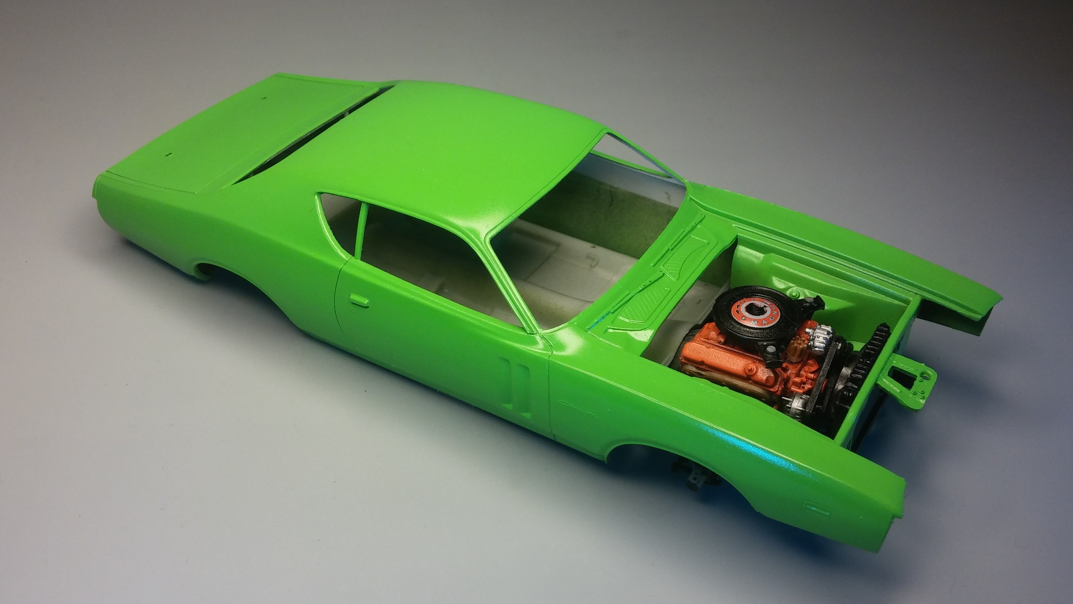

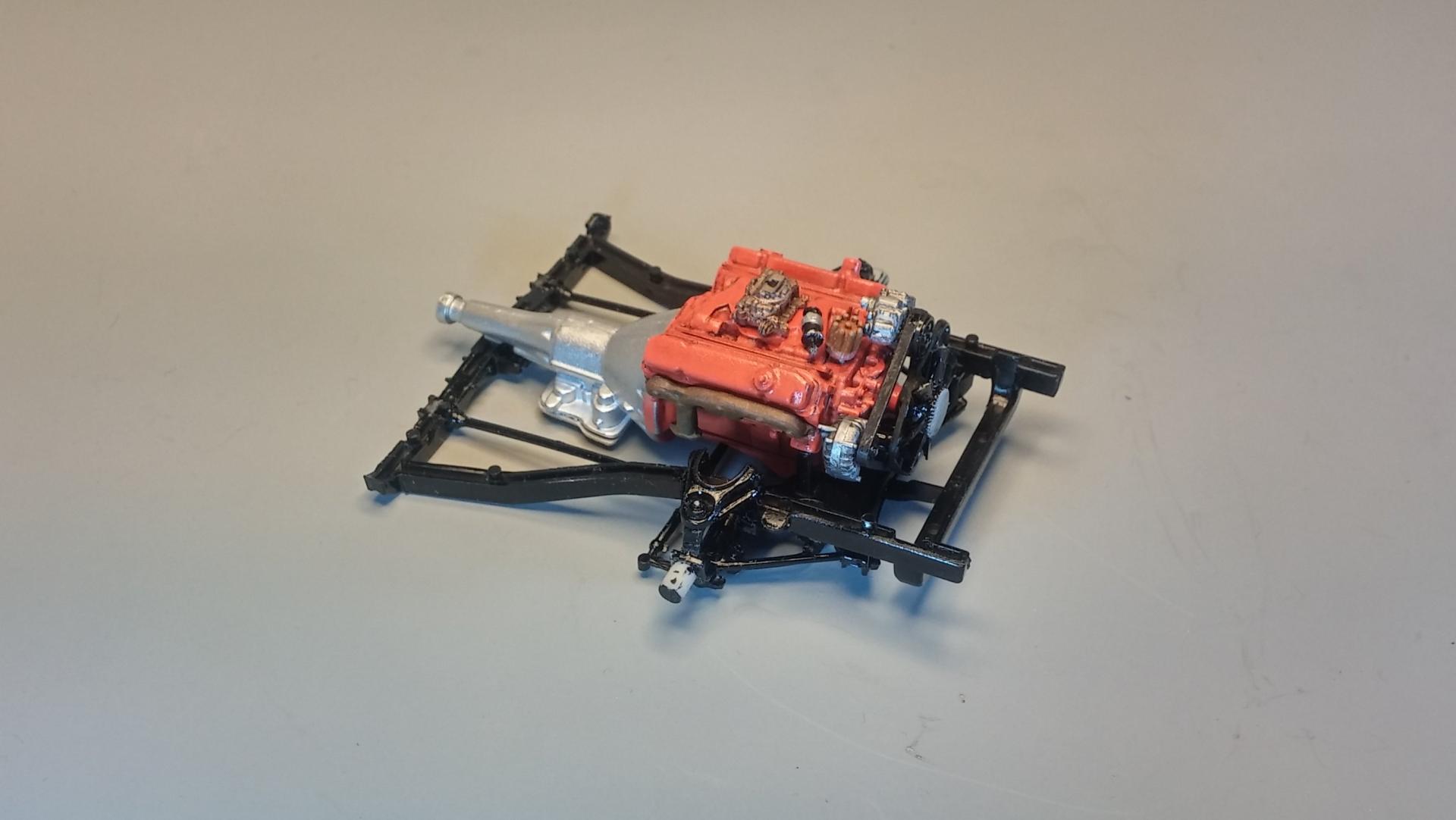

David G. Posted February 3, 2019 Share Posted February 3, 2019 (edited) I need a break from my 1934 Duesenberg Steampunk Roadster. I've hit a point where I just don't know what to do with it right now. So while I await inspiration, I've decided to work on AMT's 1971 Dodge Charger. My plan is to build it as a companion to the replica I built of my 2013 Dodge Charger I built back in 2016. This is the kit, I won it in a raffle at one of the Desert Scale Classic model car shows, 2012 if I remember correctly. The engine and sub-frame are nicely detailed and went together with no difficulty. This is my first attempt at creating chassis over-spray. Detail painting is one of my favorite tasks. As always, thanks for taking the time to look and feel free to comment. David G. Edited February 3, 2019 by David G. Typo Quote Link to comment Share on other sites More sharing options...
geetee66 Posted February 3, 2019 Share Posted February 3, 2019 You're off to a great start! That engine looks fabulous. detail painting is one of my favourite parts of a build, too. And weathering. Quote Link to comment Share on other sites More sharing options...
tbill Posted February 3, 2019 Share Posted February 3, 2019 Agreed, you’re off to a great start, engine looks fabulous. Quote Link to comment Share on other sites More sharing options...
espo Posted February 3, 2019 Share Posted February 3, 2019 I like how the engine looks natural and slightly used. Quote Link to comment Share on other sites More sharing options...
David G. Posted February 3, 2019 Author Share Posted February 3, 2019 9 hours ago, geetee66 said: You're off to a great start! That engine looks fabulous. detail painting is one of my favourite parts of a build, too. And weathering. Thank you Guy, I too enjoy weathering. I believe that almost everything should get at least some light weathering as nothing maintains its "showroom fresh" qualities for more than a few days or even hours after leaving the dealer's lot. 7 hours ago, tbill said: Agreed, you’re off to a great start, engine looks fabulous. Thanks Tom. 3 hours ago, espo said: I like how the engine looks natural and slightly used. Thanks David, I do like things clean and shiny, but not too much. David G. Quote Link to comment Share on other sites More sharing options...

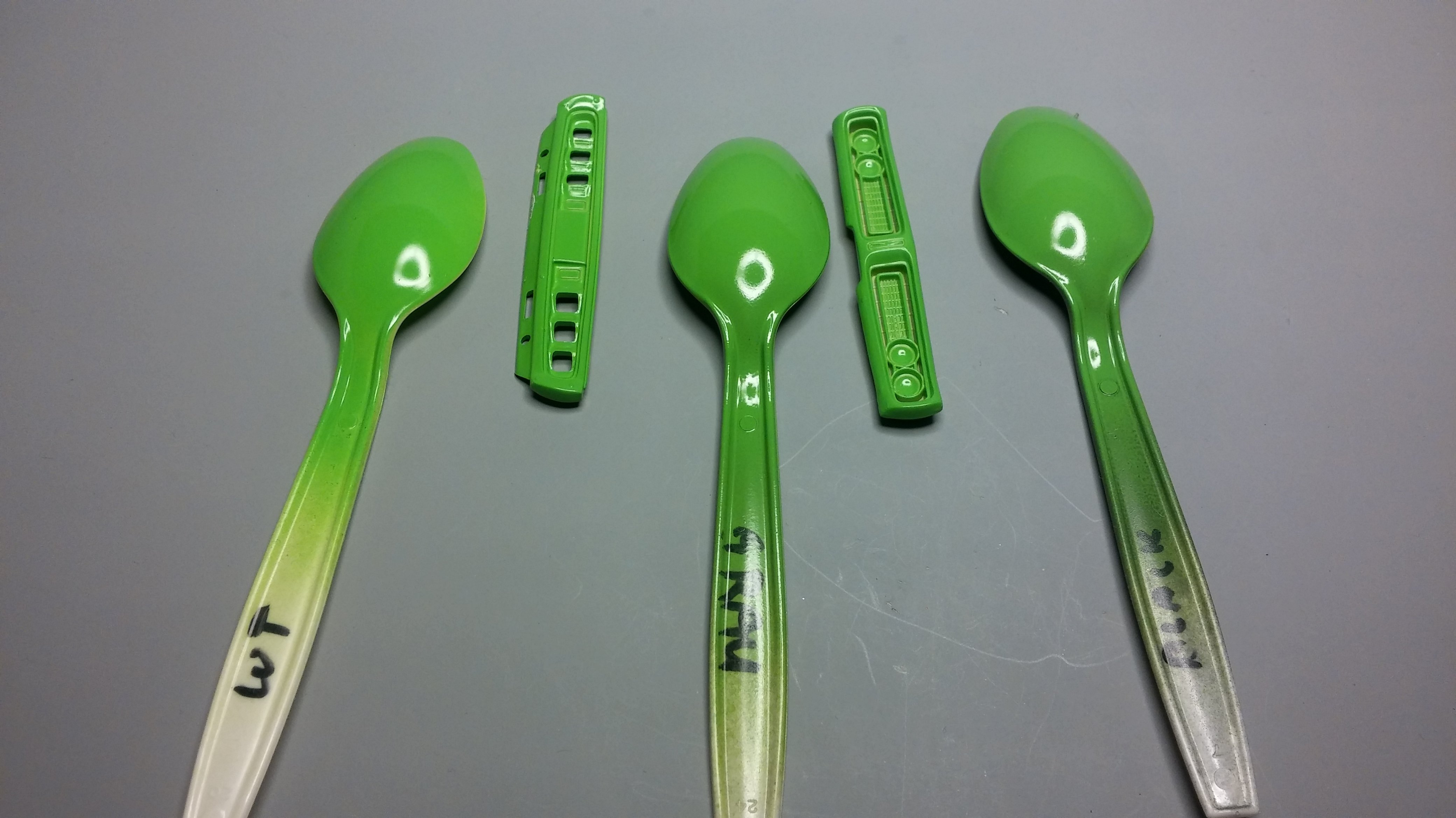

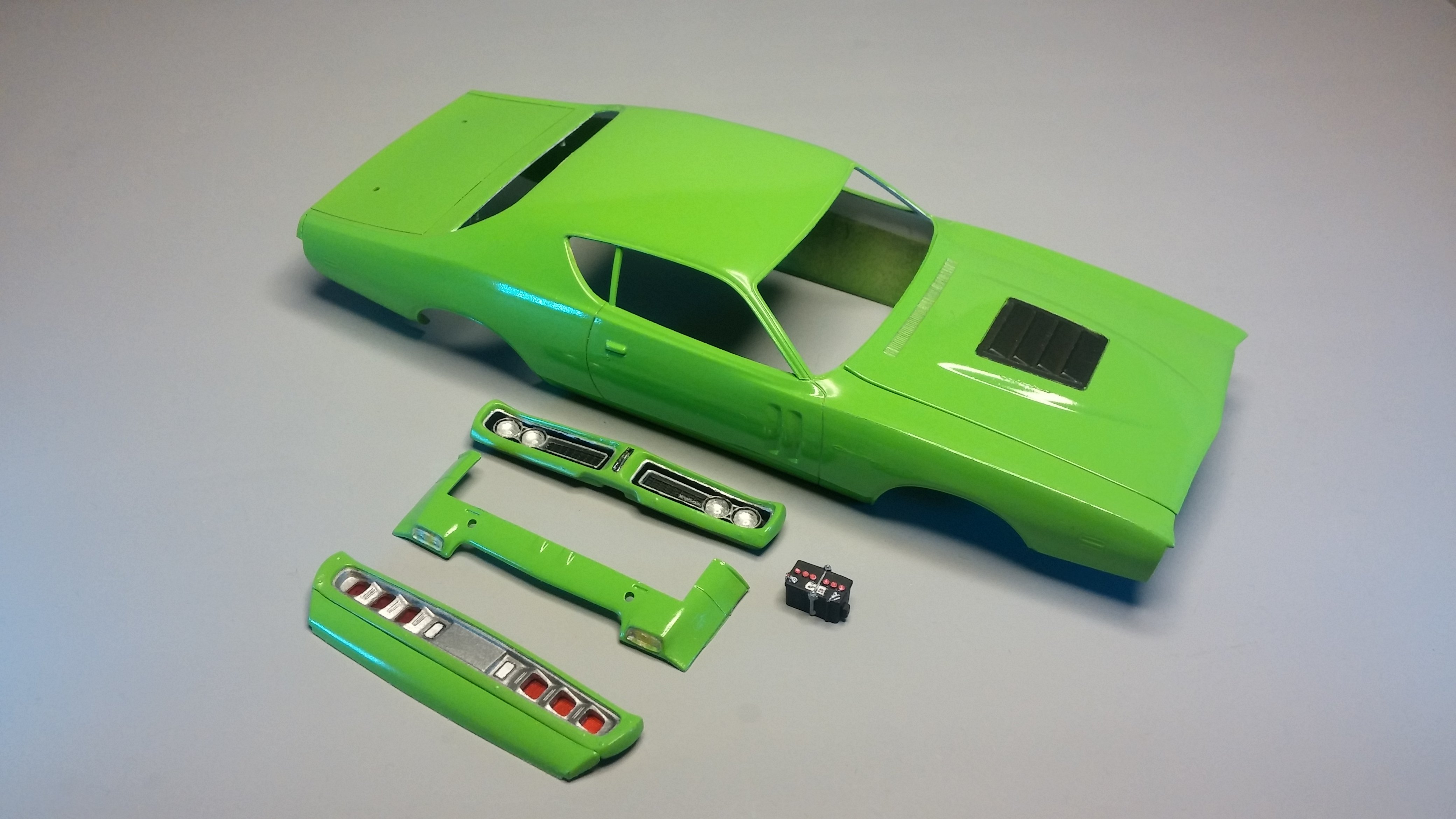

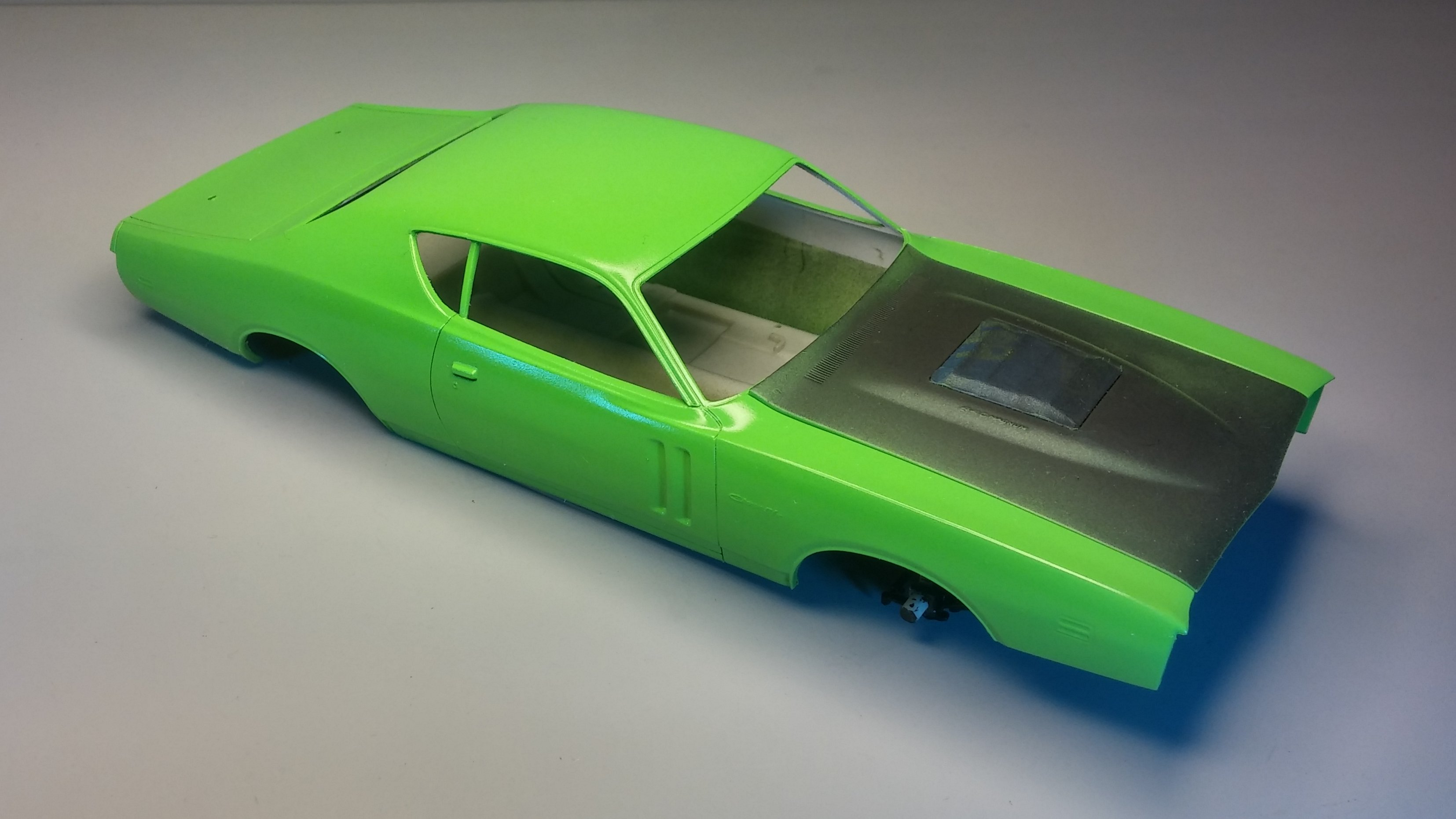

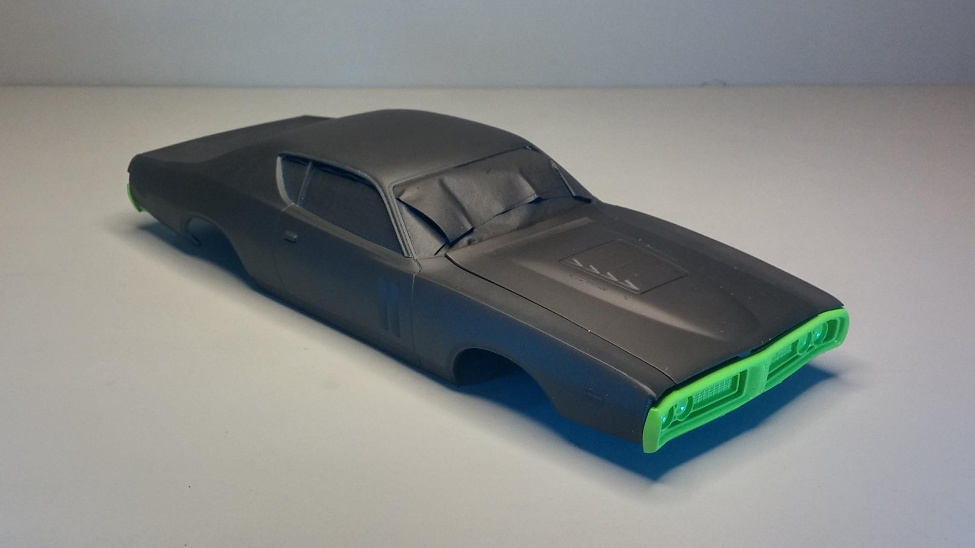

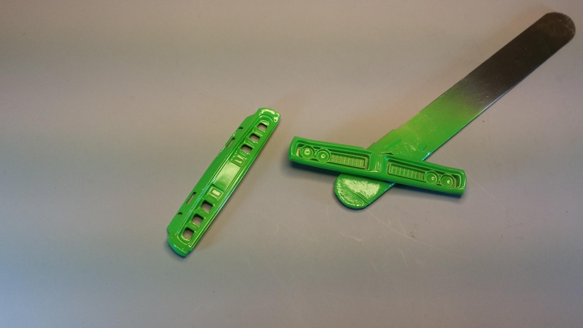

David G. Posted February 6, 2019 Author Share Posted February 6, 2019 I decided that I wanted to go a little wild with the color on this one. I'm trying to approximate Dodge's "Green Go" color from 1971. I used Tamiya's TS-22 Light Green which over white primer, turned out a little too pale and toy-like for my tastes. I shot some test spoons using gray and black primer under the green. I decided to use black primer, it gave the green a bit more depth. Well, the car does look good in black but I'm still going with green. Though it's hard to tell in the photo, spraying the green over black primer added some depth and richness to the color. The vent in the center of the hood has been masked and will remain black. Thanks for taking the time to look, comments are welcome. David G. Quote Link to comment Share on other sites More sharing options...
1972coronet Posted February 6, 2019 Share Posted February 6, 2019 That colour looks convincing , if not just a hair brighter than the actual colour . Did Testors drop their Sassy Grass (Plymouth name) / Green Go (Dodge name) from their line ? Keep up the great work ! Quote Link to comment Share on other sites More sharing options...
David G. Posted February 7, 2019 Author Share Posted February 7, 2019 On 2/6/2019 at 6:09 AM, 1972coronet said: That colour looks convincing , if not just a hair brighter than the actual colour . Did Testors drop their Sassy Grass (Plymouth name) / Green Go (Dodge name) from their line ? Keep up the great work ! Thanks John. I'm not sure about the Testors colors, they tend to be enamel based and I prefer lacquers which is why I tend to use Tamiya. During my research I noticed that there was a bit of variation of shade in the "official" Dodge Green Go color. Tamiya's TS-22 matched closely enough for my tastes. Again, thanks for your comment. Regards, David G. Quote Link to comment Share on other sites More sharing options...

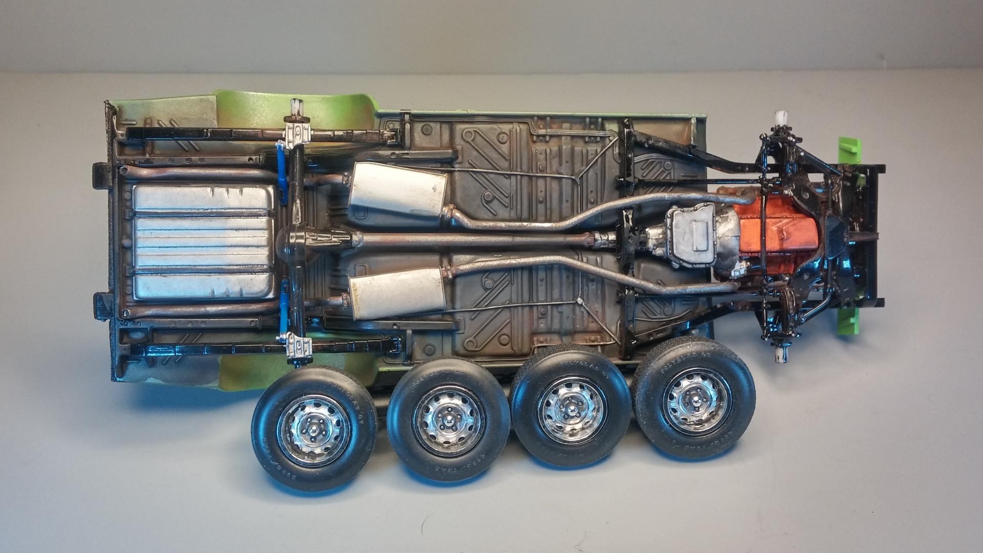

David G. Posted February 10, 2019 Author Share Posted February 10, 2019 Here's a quick update. Chassis and wheels are done. On to the interior! Yes, I actually made little labels for the shock absorbers. ...yeah, I know. Thanks for taking the time to look and as always, your feedback is valued and appreciated. David G. Quote Link to comment Share on other sites More sharing options...

David G. Posted February 11, 2019 Author Share Posted February 11, 2019 18 hours ago, Deuces said: That chassis looks too real!!!!..... ☺️ Thanks Guido. 15 hours ago, John Jacobs said: The weathered look adds so much realism. Would love to see some tutorials on that. Nice job. Thanks John, Two things I enjoy about building models are detail painting and weathering- three if you count completing them. Many of the basic weathering techniques I know I learned years ago from a book: How to Build Realistic Model Railroad Scenery The rest comes from a couple decades of practice. Mostly I use detail painting, washes and powdered pastels. For tutorials, I would recommend doing a Google search on weathering model cars and or military models. The two styles are a bit different but there are significant overlaps. Thanks again for your comment. David G. Quote Link to comment Share on other sites More sharing options...

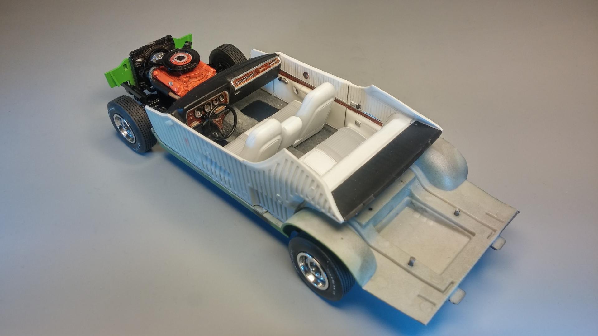

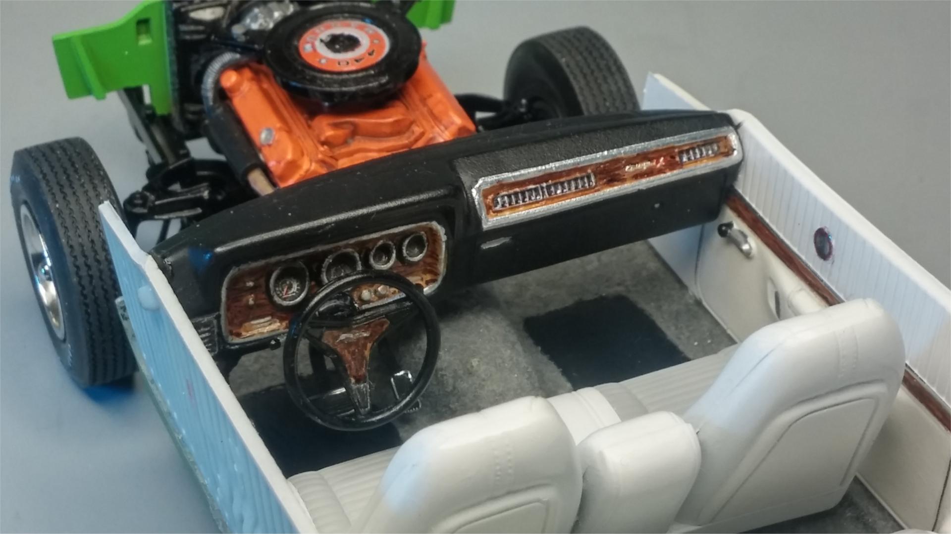

David G. Posted February 17, 2019 Author Share Posted February 17, 2019 As promised, here are some snaps of the completed interior. ...and a close-up of some of the dash detail. Thanks everybody! David G. Quote Link to comment Share on other sites More sharing options...

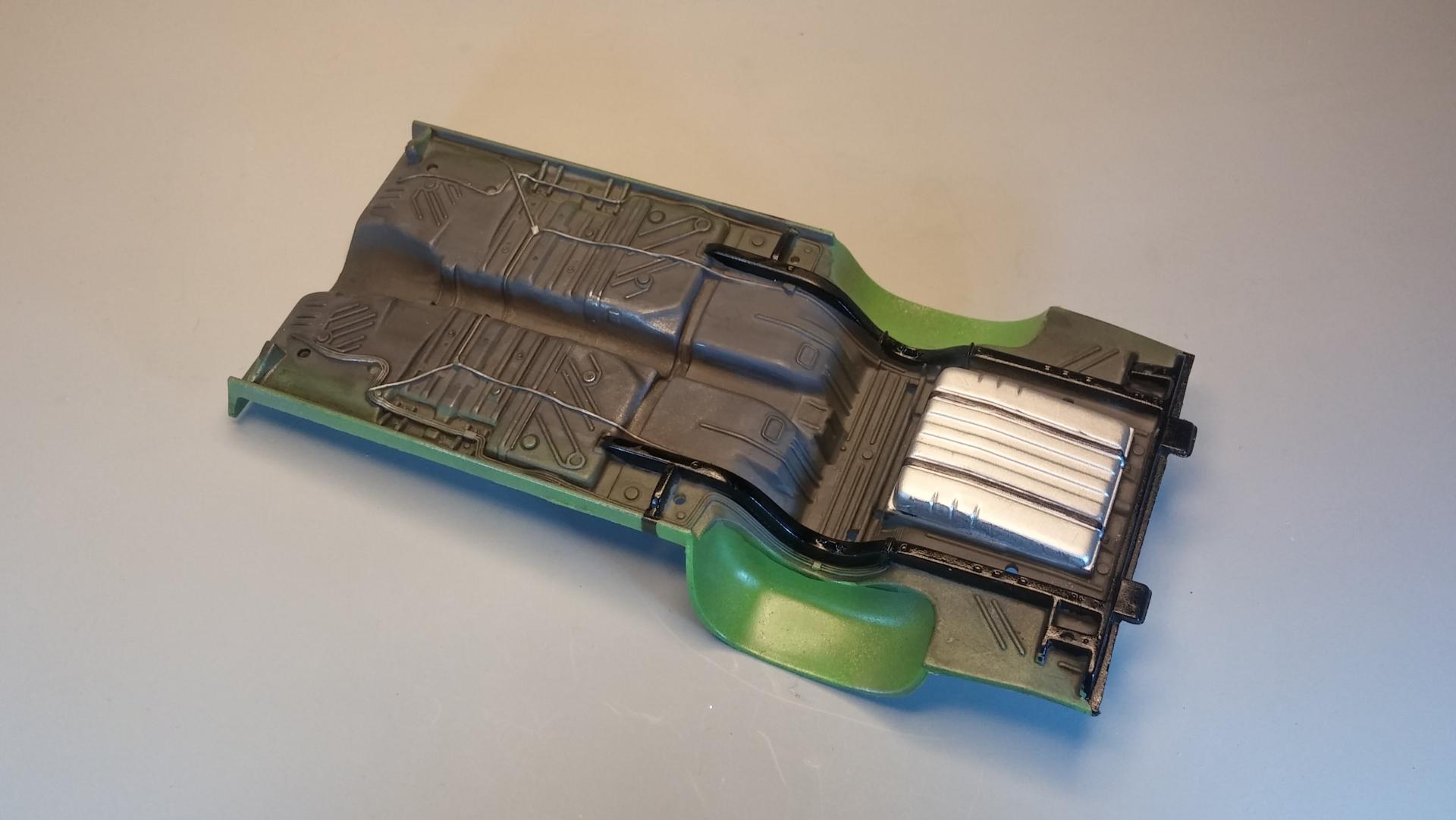

David G. Posted February 23, 2019 Author Share Posted February 23, 2019 Paintwork is finally finished. Now on to a final polish, foil work, decals and assembly. As always, thanks for taking the time to look and please feel free to share any thoughts. David G. Quote Link to comment Share on other sites More sharing options...
