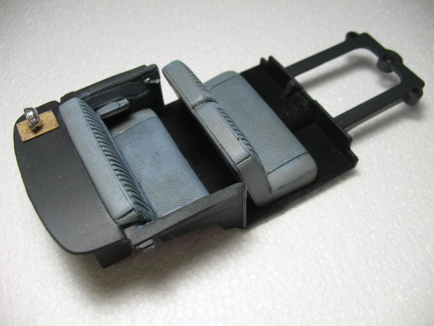

I did this one by sprinkling the embossing powder over thinned flat-black paint. It's a Maisto '55 Buick CHP car interior.  A working car, so that's why the interior is a little grungy.
