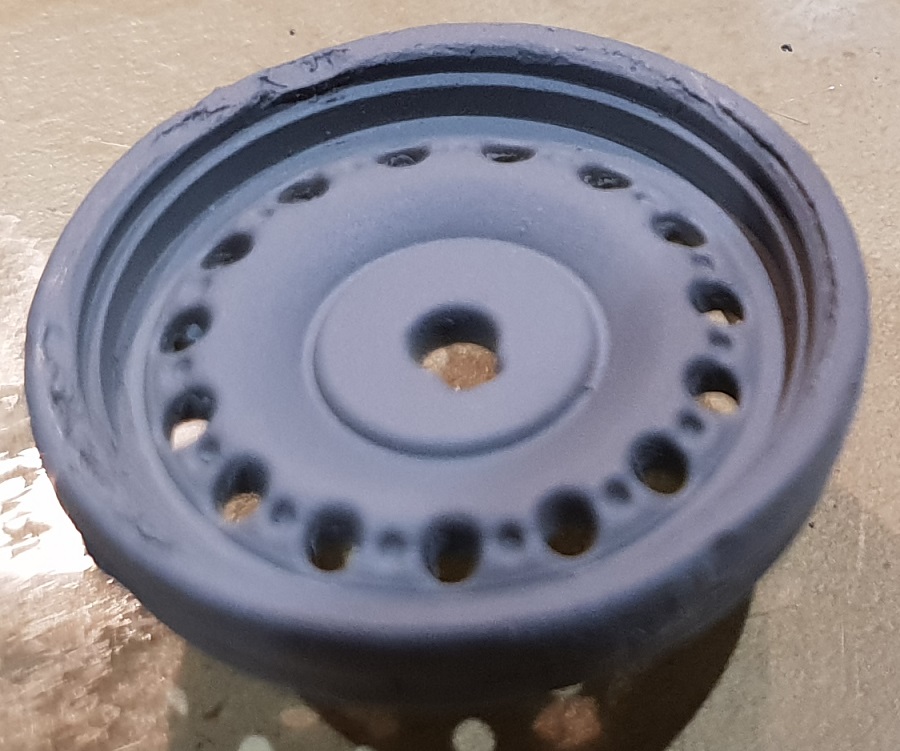

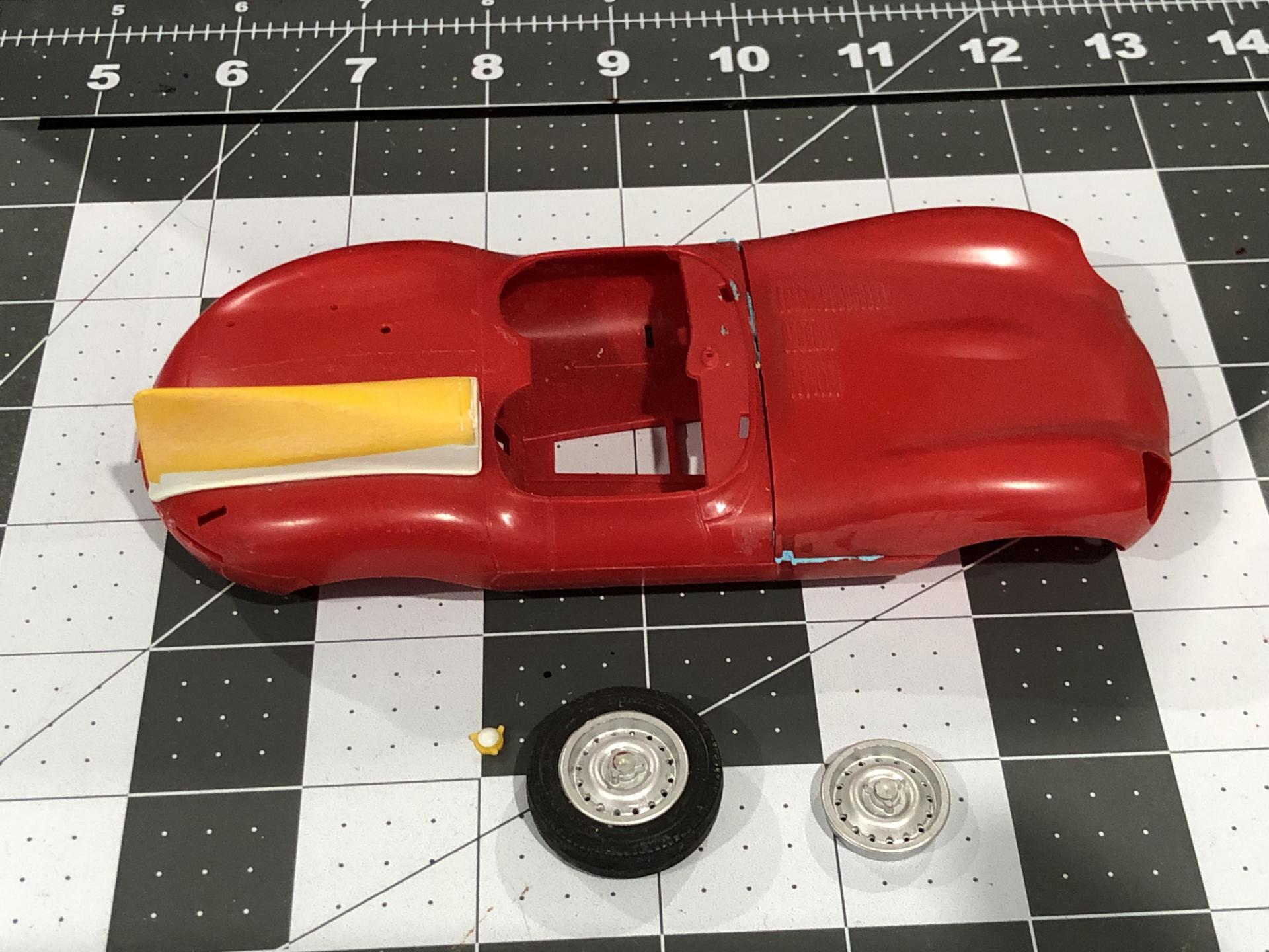

Funkychiken Posted March 9, 2019 Posted March 9, 2019 So this kit has been in my built kit cabinet for a few years, and then I noticed this goo pouring out of the wheels. it looks like the rubber is attacking the plastic, and the plastic pours out. I didn't pay it any attention, but it just gets worst and worse. So I took the wheel off & stripped them with brake fluid
Funkychiken Posted March 9, 2019 Author Posted March 9, 2019 The pictures don't show how bad the issue really is. I've managed to break the pins and one lug of the spinners.

Funkychiken Posted March 11, 2019 Author Posted March 11, 2019 On 3/10/2019 at 12:13 AM, 935k3 said: Try covering the area of the wheel making contact with the tire with bare metal foil. I might just try that Dale! This is what they look like stripped and primed. I'm going to sand off the melted part and just rebuild like this!
Modlbldr Posted March 13, 2019 Posted March 13, 2019 It may take some work but you could completely sand or cut away the outermost ring that is damaged and replace it with the same sized ring removed from another parts box wheel. Almost like re-sleeving it. I think the idea of using BMF to protect the wheel from the tire is an idea worth trying. Later-
Dann Tier Posted March 15, 2019 Posted March 15, 2019 That really sucks, bud!, I had a Tokyo Muari Pantera that did that, and I very recently had to totally replace the wheels on Tina's Chevelle because of this. I seem to remember that I tried to repaint with automotive paint, but it didn't work. Then I tried Chrome foil, and that didn't work either. If it were me, I would either repair these, and resin cast them yourself, get new ones, and immediately cover them in foil, or buy a resin set....I think Historic Racing Miniatures makes a set, AFX would know for sure.

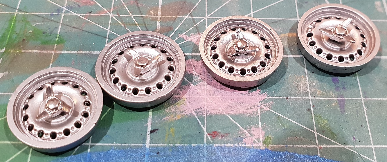

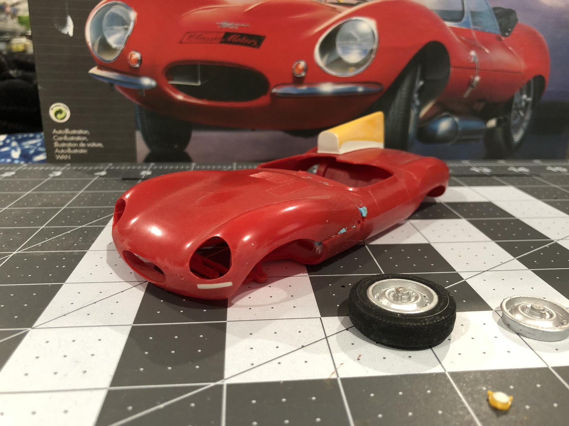

Funkychiken Posted March 18, 2019 Author Posted March 18, 2019 On 3/13/2019 at 10:49 AM, Modlbldr said: It may take some work but you could completely sand or cut away the outermost ring that is damaged and replace it with the same sized ring removed from another parts box wheel. Almost like re-sleeving it. I think the idea of using BMF to protect the wheel from the tire is an idea worth trying. Later- On 3/15/2019 at 6:47 PM, Dann Tier said: That really sucks, bud!, I had a Tokyo Muari Pantera that did that, and I very recently had to totally replace the wheels on Tina's Chevelle because of this. I seem to remember that I tried to repaint with automotive paint, but it didn't work. Then I tried Chrome foil, and that didn't work either. If it were me, I would either repair these, and resin cast them yourself, get new ones, and immediately cover them in foil, or buy a resin set....I think Historic Racing Miniatures makes a set, AFX would know for sure. Thanks for the tips guys, I fixed them up as much as I could. I was intentinf on replacinf the outer rim with a small cut out of tube, but decided to just sand them flat, and have another go. So here they are. Alclad Aluminium for teh wheels & Alclad Chrome for the locking nuts

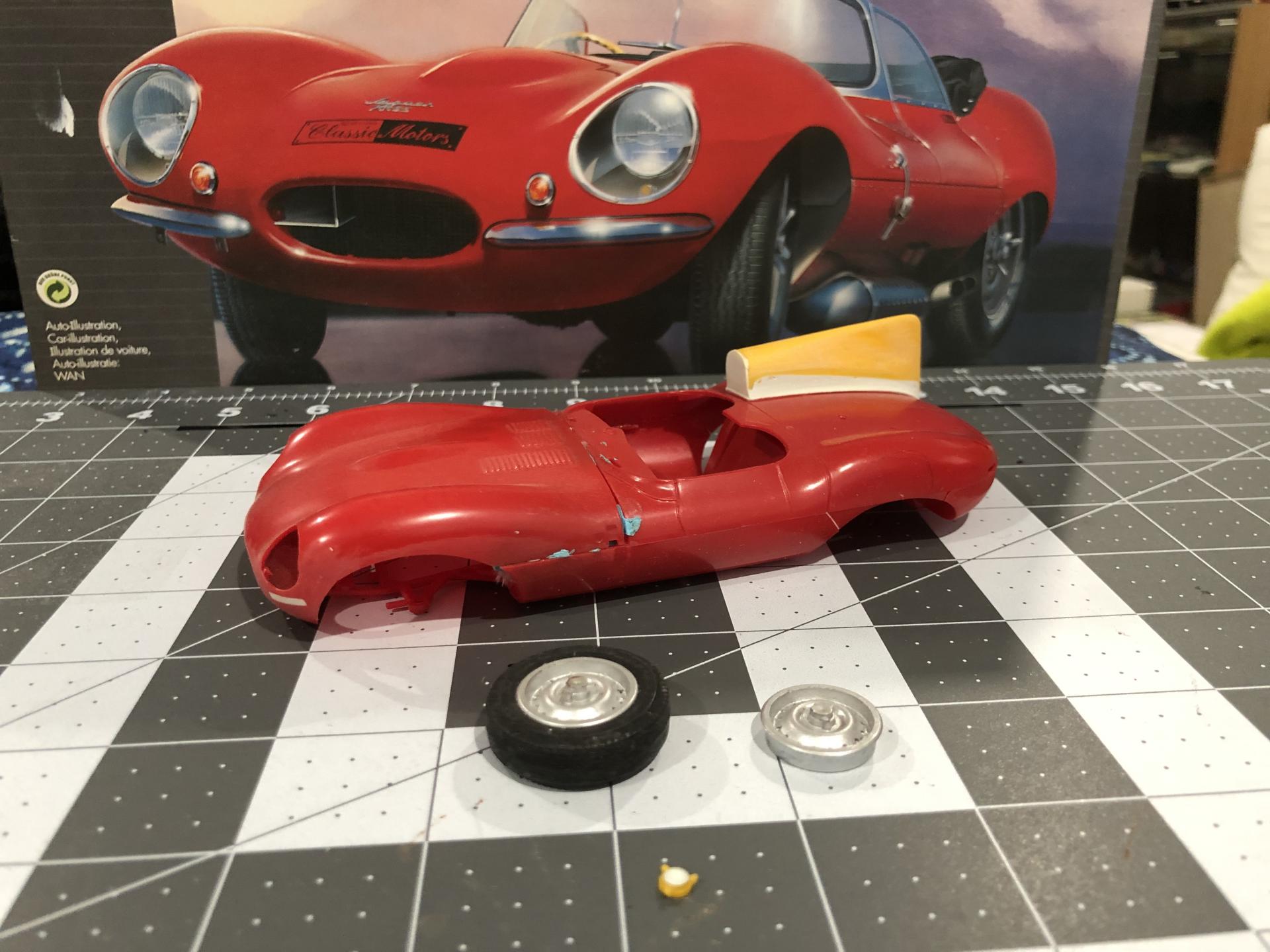

Superbird McMonte Posted March 19, 2019 Posted March 19, 2019 Your project has inspired me to dig this one out. I started converting this one to race form a number of years ago. A friend of mine pointed out that the slotcar model of this car is terribly incorrect. I found this for sale at either the NNL East or the LIARS Challenge. Even the slotcar model’s wheels are incorrect.
Dann Tier Posted March 20, 2019 Posted March 20, 2019 On 3/18/2019 at 6:28 PM, Funkychiken said: Thanks for the tips guys, I fixed them up as much as I could. I was intentinf on replacinf the outer rim with a small cut out of tube, but decided to just sand them flat, and have another go. So here they are. Alclad Aluminium for teh wheels & Alclad Chrome for the locking nuts Fantastic save, bud!!!!...are you gonna add black to the tiny holes inbetween, or drill them out?

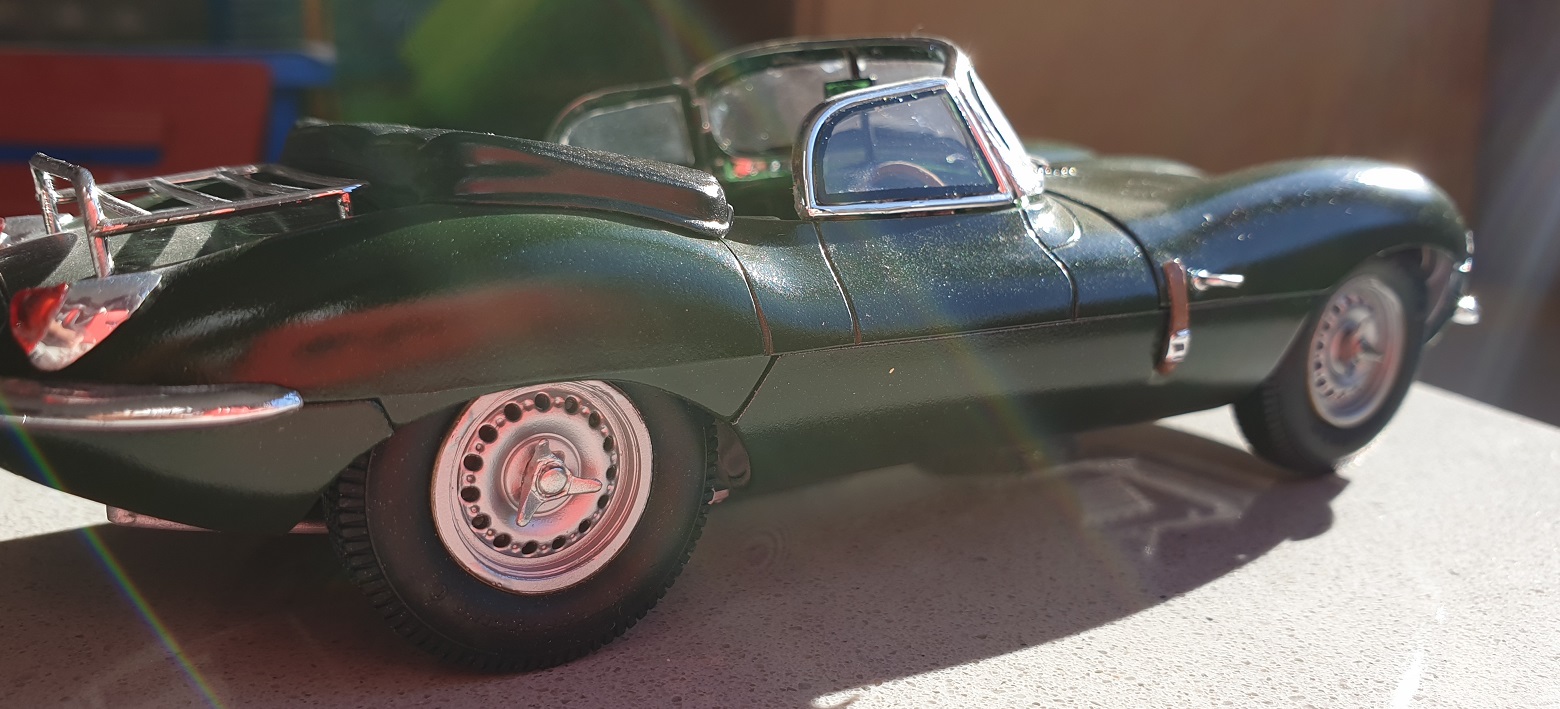

Funkychiken Posted June 29, 2019 Author Posted June 29, 2019 (edited) Unfortunately the plastic pins broke during disassembly so I have to just glue them back as best I could, it no longer rolls, but that's not an issue, it does only sit on 3 wheels now, but it looks a lot better. This took loads of time, but it's great to save an old build! Edited June 29, 2019 by Funkychiken

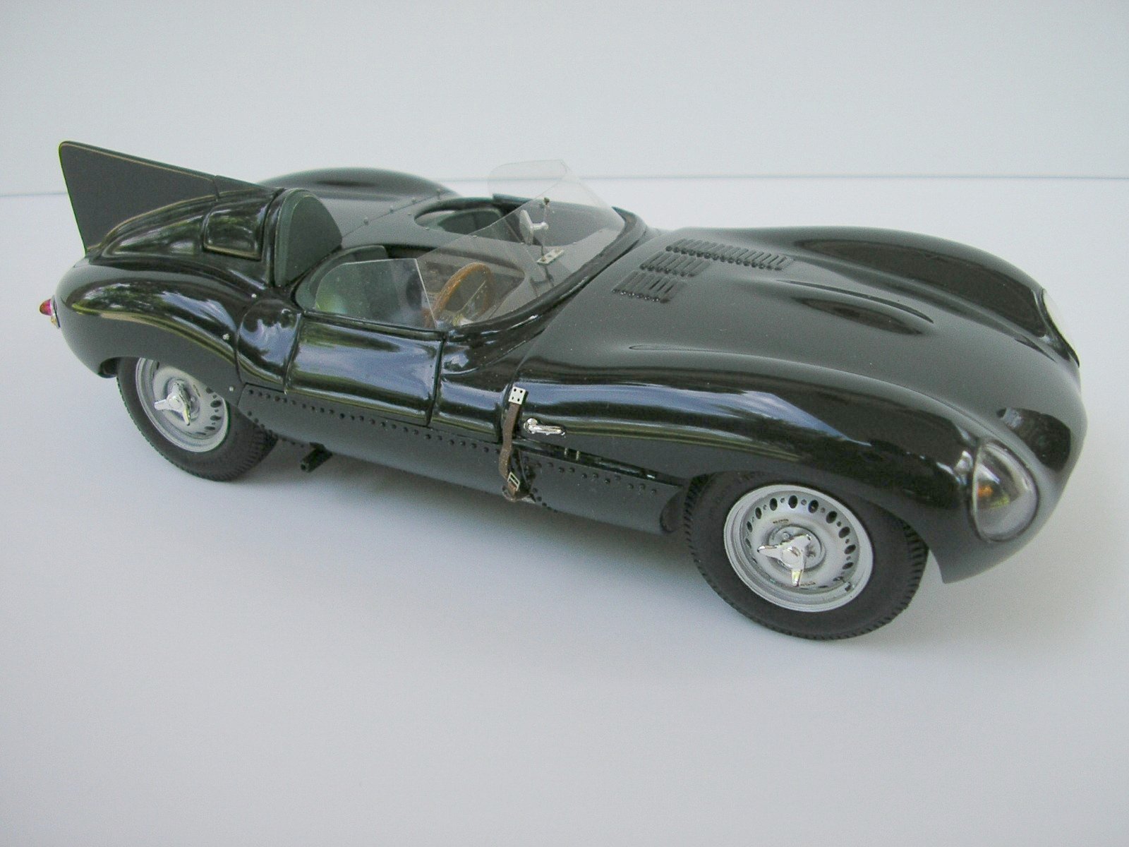

MrObsessive Posted June 29, 2019 Posted June 29, 2019 Ooooh! Great start Dominick and great minds think alike! The wheels I think I might have got from Norm Veber along with the tires which I wanted a spare for the rear compartment. I also got the wood steering wheel from him............memory's a little hazy as I built this nearly 20 years ago.
Rider Posted June 29, 2019 Posted June 29, 2019 Nice save, the rims look great. Scary thought knowing this can happen to parts in the box. Doesn't his mostly happen to kits from the 70's, or is it a concern for kits from the 80's as well?
MrObsessive Posted June 29, 2019 Posted June 29, 2019 Atin, I meant to comment on this earlier, but your Jag turned out really GREAT! Despite the wheel troubles at first, you pulled off what's not necessarily an easy kit to build. Those rims turned out really great! I see you got your hood to fit well............that's an area that one needs to pay CONSTANT attention to as it can run into troubles as you get near the end building it. I've got a couple other of these kits besides the D Type I did. I'd probably build yet another green one as that color really suits this car.
Funkychiken Posted July 1, 2019 Author Posted July 1, 2019 On 6/29/2019 at 8:52 PM, Rider said: Nice save, the rims look great. Scary thought knowing this can happen to parts in the box. Doesn't his mostly happen to kits from the 70's, or is it a concern for kits from the 80's as well? Mr Rider, it looks that way! The rubber on this kit is very corrosive! On 6/29/2019 at 9:27 PM, MrObsessive said: Atin, I meant to comment on this earlier, but your Jag turned out really GREAT! Despite the wheel troubles at first, you pulled off what's not necessarily an easy kit to build. Those rims turned out really great! I see you got your hood to fit well............that's an area that one needs to pay CONSTANT attention to as it can run into troubles as you get near the end building it. I've got a couple other of these kits besides the D Type I did. I'd probably build yet another green one as that color really suits this car. Agree, the food was fiddly, thanks for the comments!
