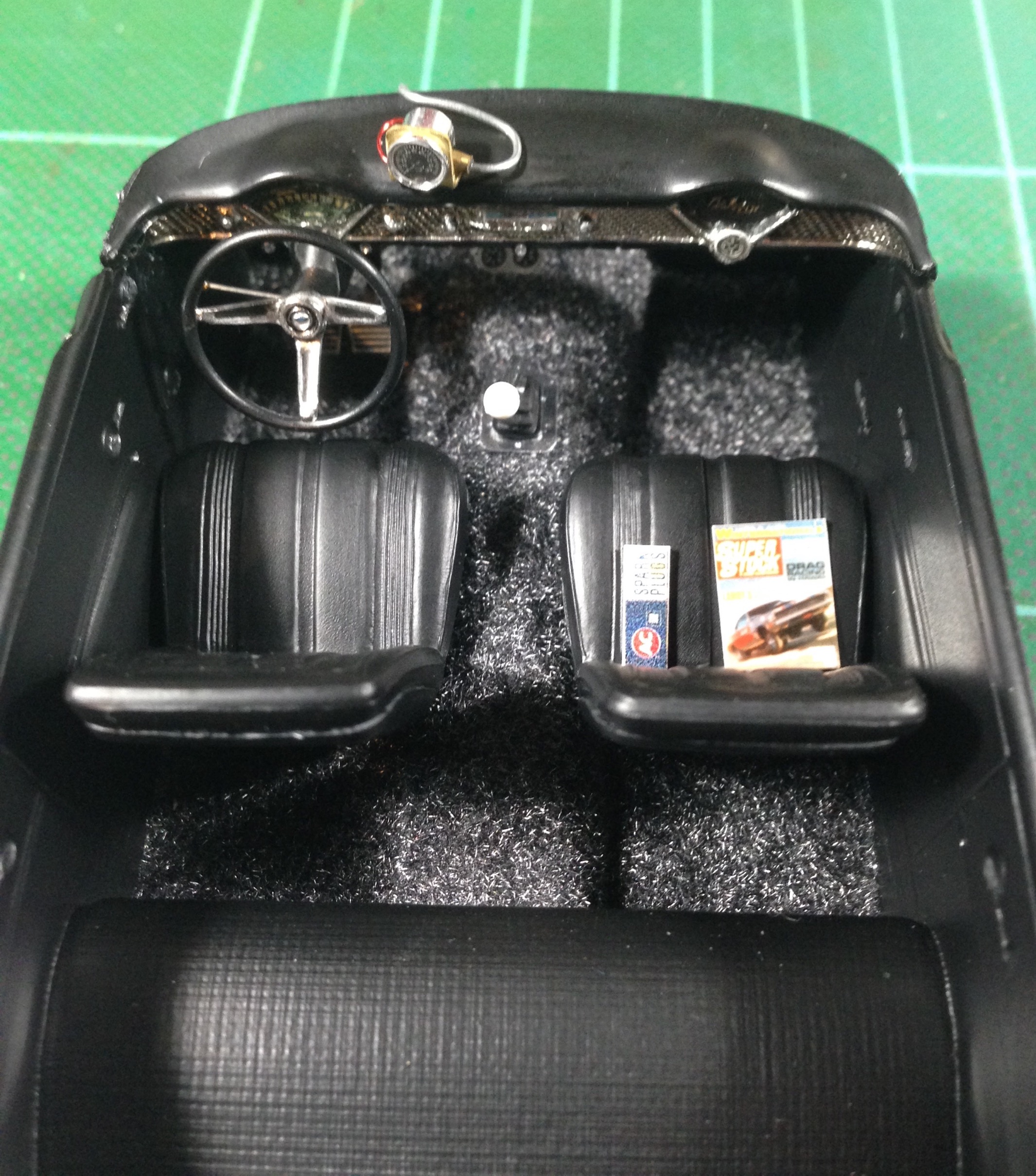

StevenGuthmiller Posted April 13, 2019 Posted April 13, 2019 (edited) All of the above! There is no answer to this question. Everything is fair game. I've used pretty much everything from automotive lacquer, to acrylic craft paint. It's not so much the material you use, but what you do with it. Case in point, this single interior was painted with Testors acrylic, Testors lacquer, Duplicolor touch up paint and MCW paint. Steve Edited April 13, 2019 by StevenGuthmiller

Speedfreak Posted April 15, 2019 Posted April 15, 2019 On 4/13/2019 at 2:07 PM, StevenGuthmiller said: All of the above! There is no answer to this question. Everything is fair game. I've used pretty much everything from automotive lacquer, to acrylic craft paint. It's not so much the material you use, but what you do with it. Case in point, this single interior was painted with Testors acrylic, Testors lacquer, Duplicolor touch up paint and MCW paint. Steve BTW Steve, that interior looks awesome! Those buckets look like 1:1 seats.
StevenGuthmiller Posted April 15, 2019 Posted April 15, 2019 1 hour ago, Speedfreak said: BTW Steve, that interior looks awesome! Those buckets look like 1:1 seats. Thanks Gene. Interiors have become one of my downfalls! I find myself spending more and more time trying to perfect some of them. The '65 Plymouth Fury that I'm working on now has gone even a step further with removing those darned convertible top wells!! But it went better than I had expected. Steve
