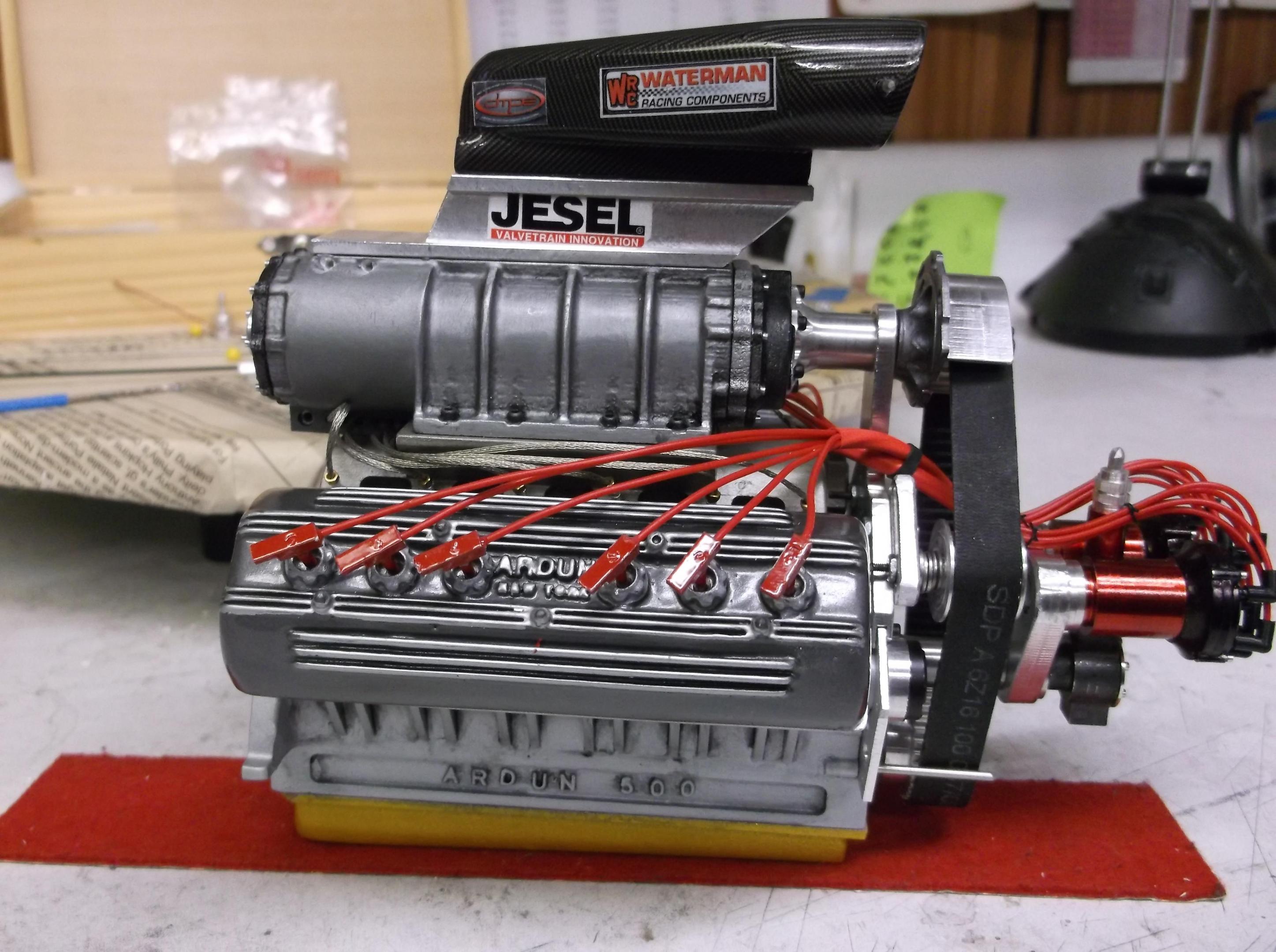

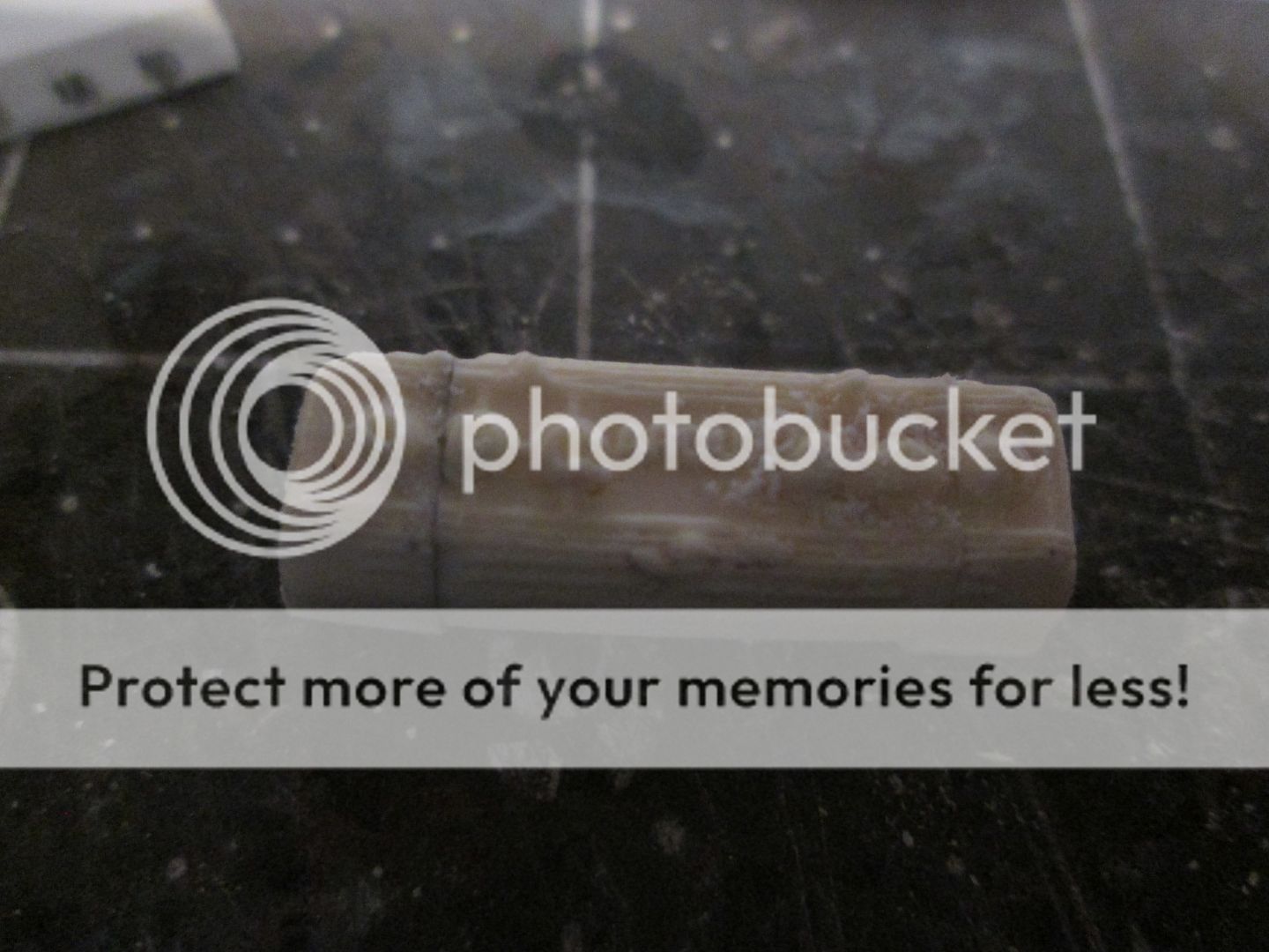

I thought I'd try my hand at this beauty.
Here are two more versions as food for thought.

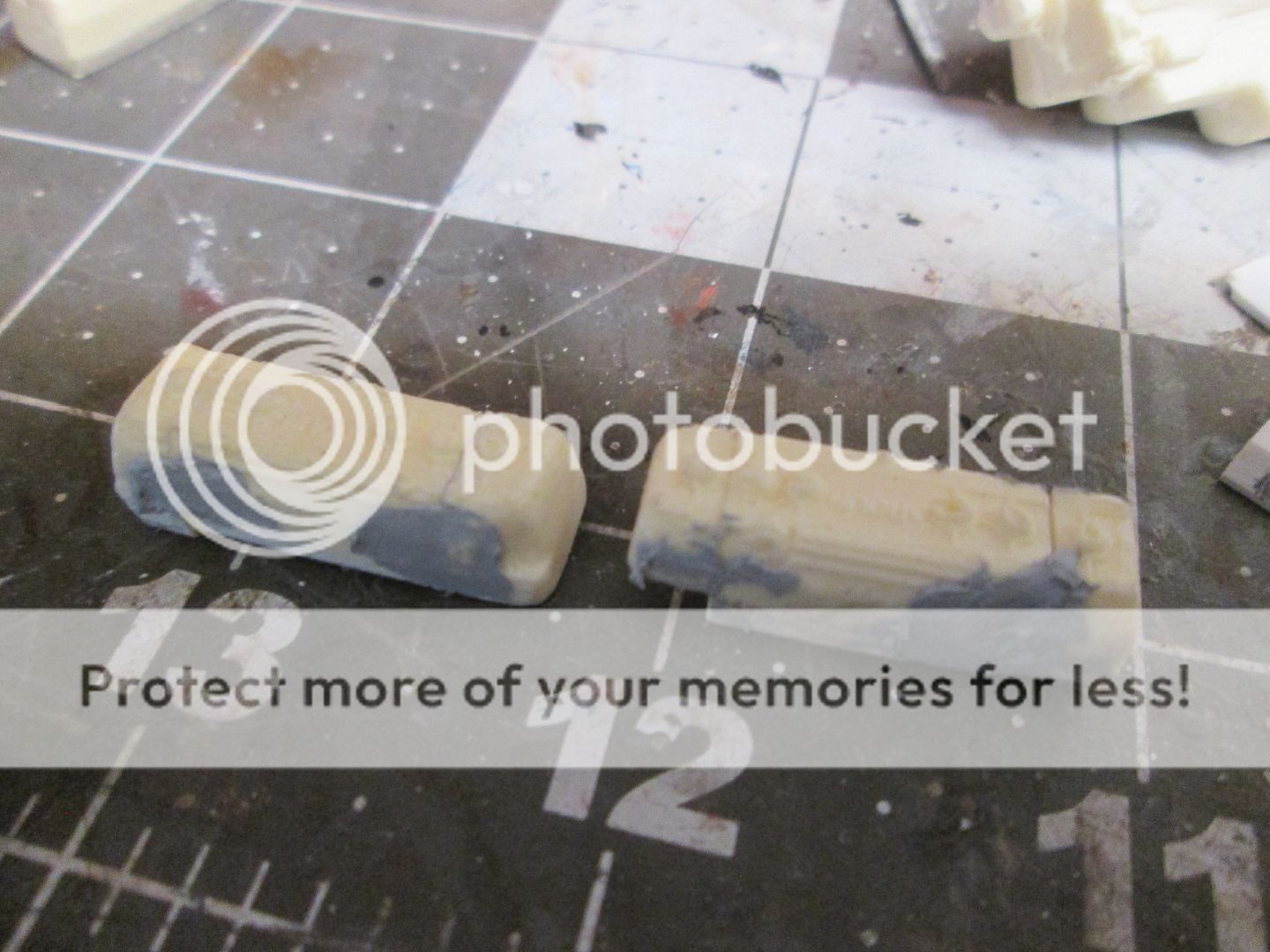

So I cast some heads and some engines.
Removed the exhaust manifolds and glued the halves together.
IMG_8867.JPG.47165218a07fbbc7ea029827575adfb6.JPGIMG_8866.JPG.dcda2494bf4fb4bd1bbfb24b27020146.JPGIMG_8865.JPG.3d313db4bc13fc25d008530dd356f8a9.JPGIMG_8837.JPG.83a706542def1eb6d6fa1bd3c4beea04.JPGIMG_8830.JPG.ac5261488f70ea366fde12c9aa80151e.JPG
Edited by landman
  • Like 1
22 minutes ago, Ballroad said:
Wow, that's really, really, cool, what are you using for the casting medium,??
The resin is Smooth-On and the molds are just modeling clay.
Fabicated heads, valley cover, a new top for the distributor as the casting was crooked.
Cut & pasted the cam covers. They likely will be the roughest ARDUN cam covers in existence.
Edited by landman
One of my dream engines ! Not only in modeling but 1:1, right up there with the 427 SOHC for coolness and WOW factor ! Great job keep up the good work!!

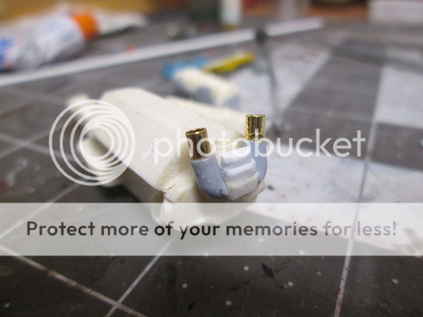

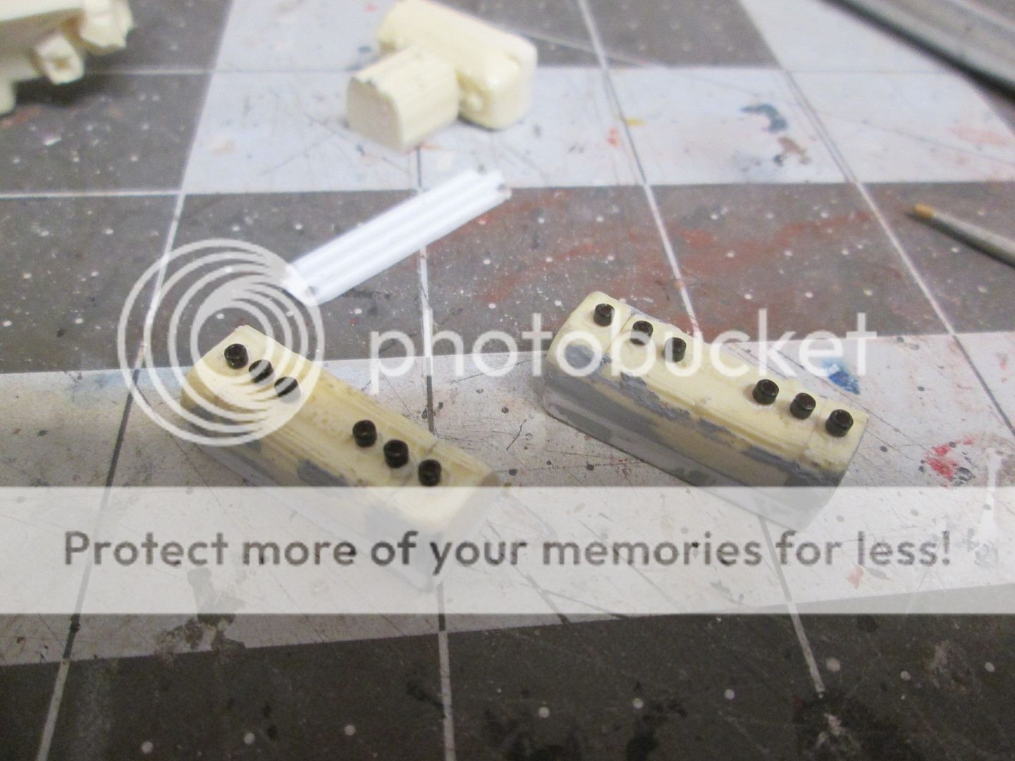

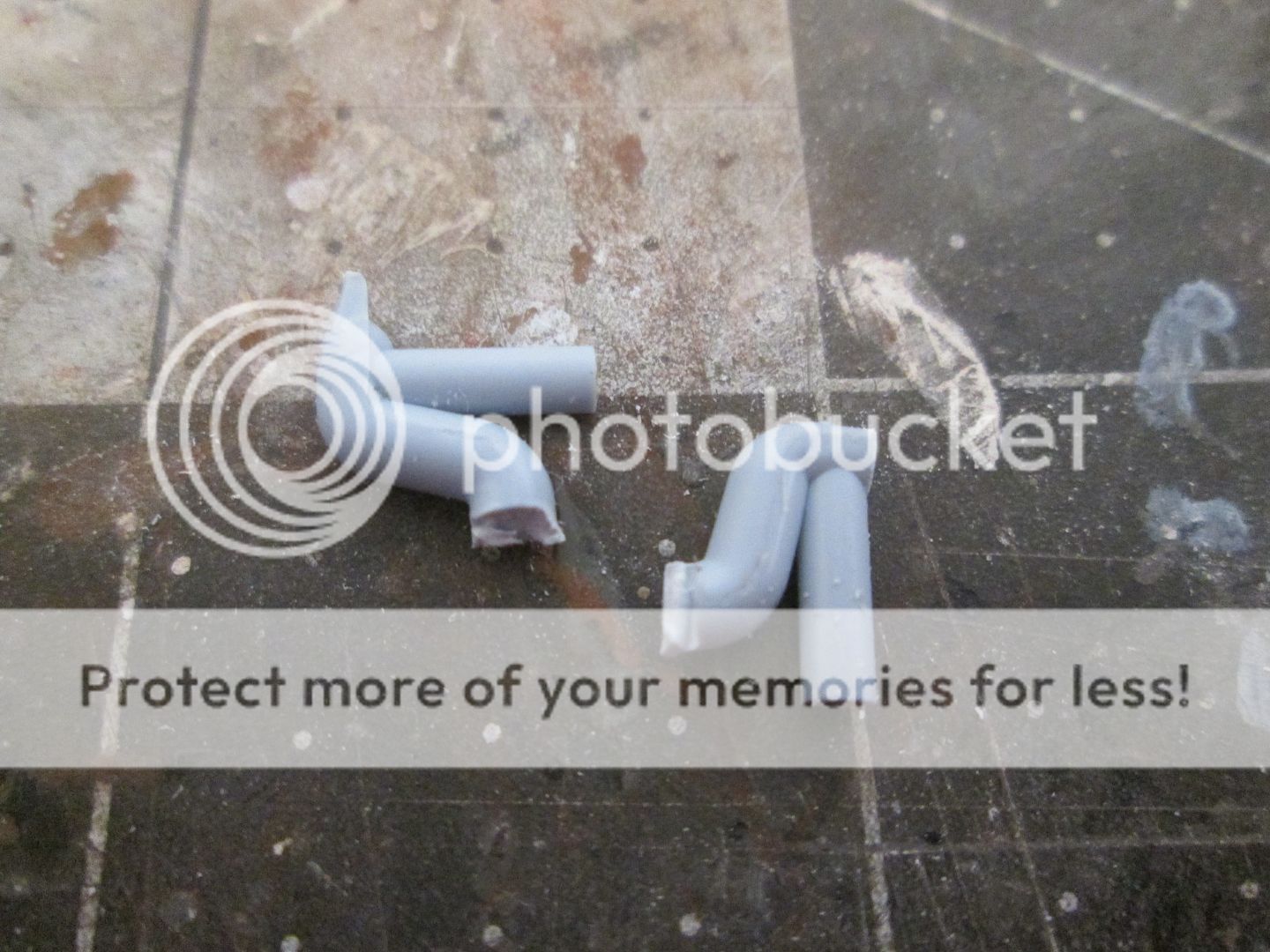

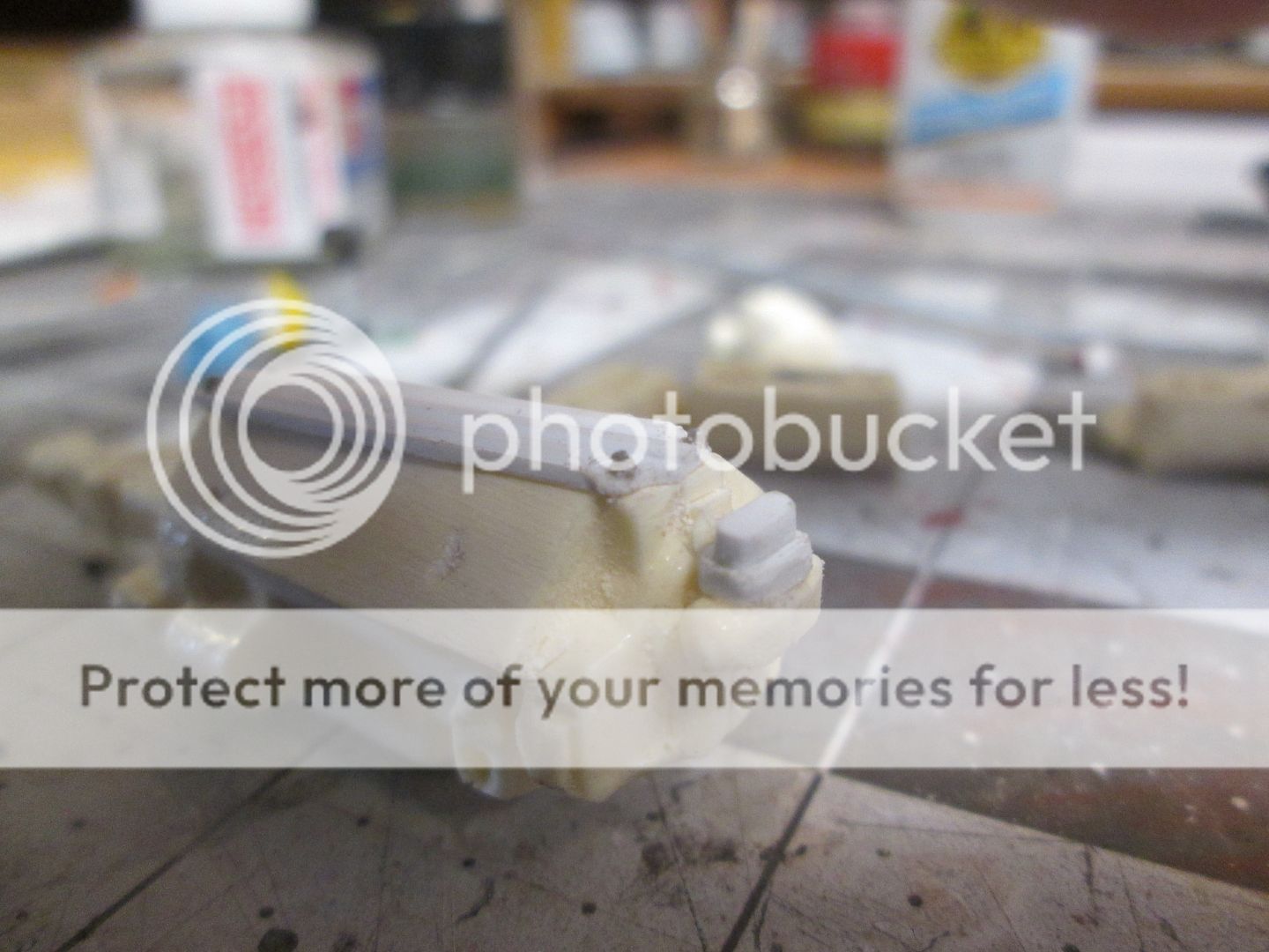

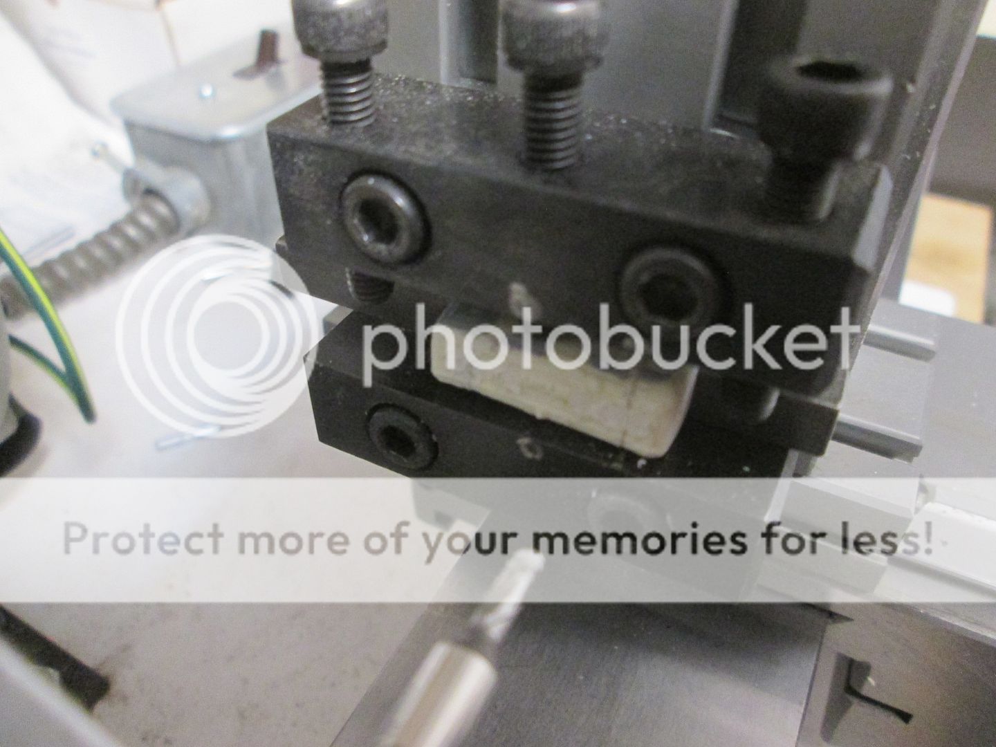

These sprue bits will make the distributor ends of the spark plug wire conduits.

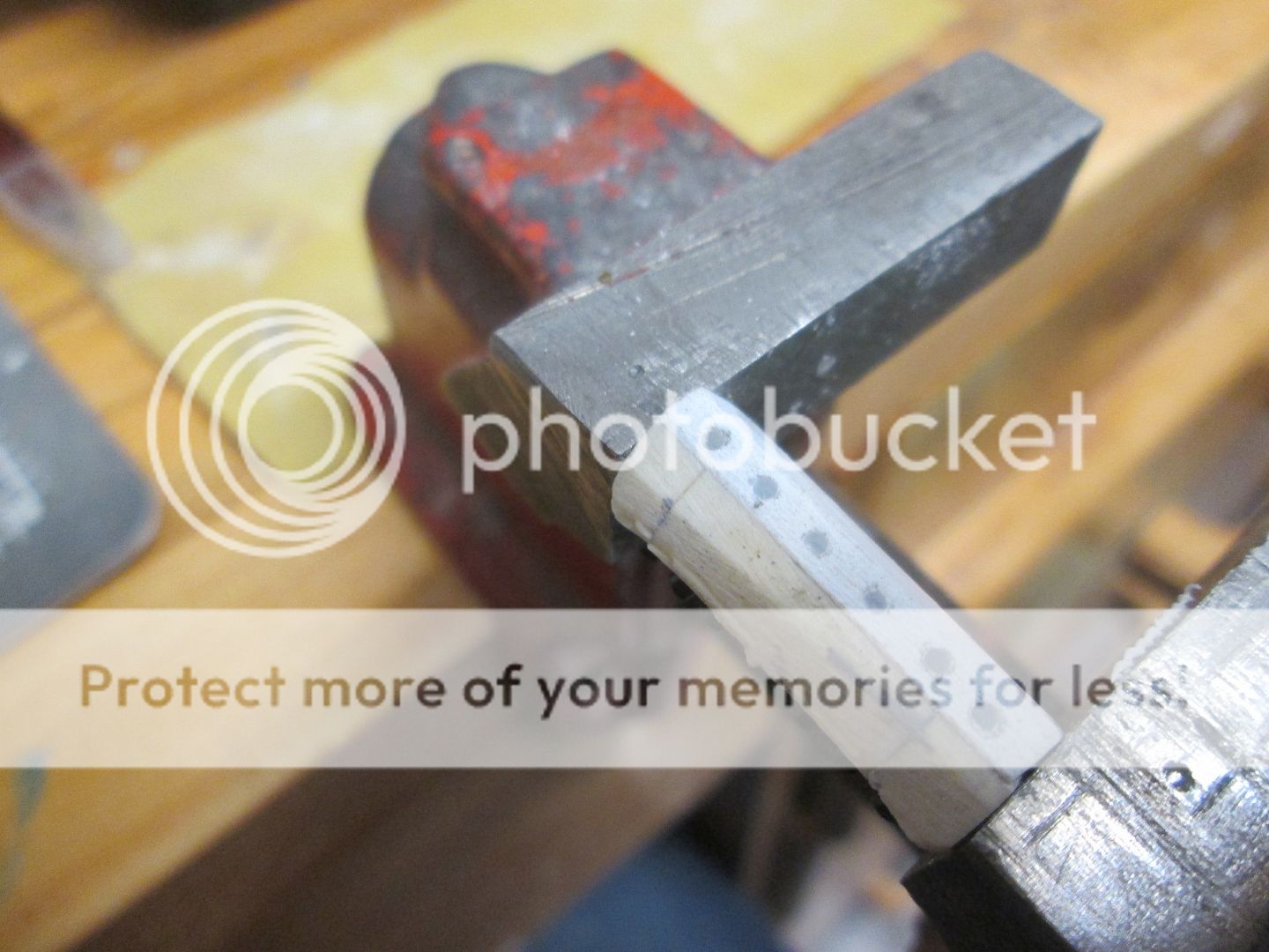

Machined the uneven spark plug nibs and added beads.
Drilled the exhaust locator holes.
Edited by landman

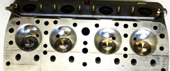

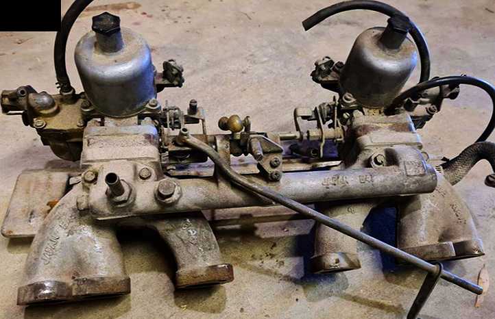

You realise it would never work?
There was a reason for the spacing of the spark plugs on the V8, simply following the same lines with the V12 would mean that you have two plugs in one hole. Or something.
Look at the way four cylinder engines get converted to sixes, the L16 Nissan being a good example. When it was changed to a six for the bigger sedans and the 240Z the spacing of ports was altered accordingly. Things like this affect spacing of spark plugs, so you have to look to the design to see what that spacing will be.
A couple of designs, first the Nissan:
Note that what they've done is put in porting the same as cylinders 2 and 3 of the four to become cylinders 3 and 4 or the six.

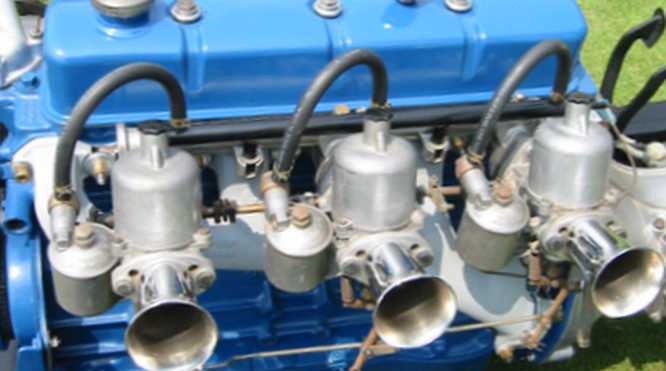

On the other hand, the 'Blue Streak' 6-cylinder version of the BMC B-series is more 'normal', with the newly included cylinders being the same as 1 and 2 and 3 and 4.

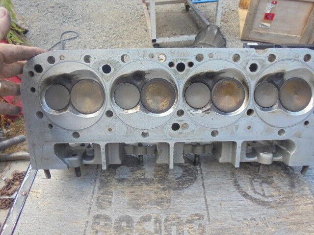

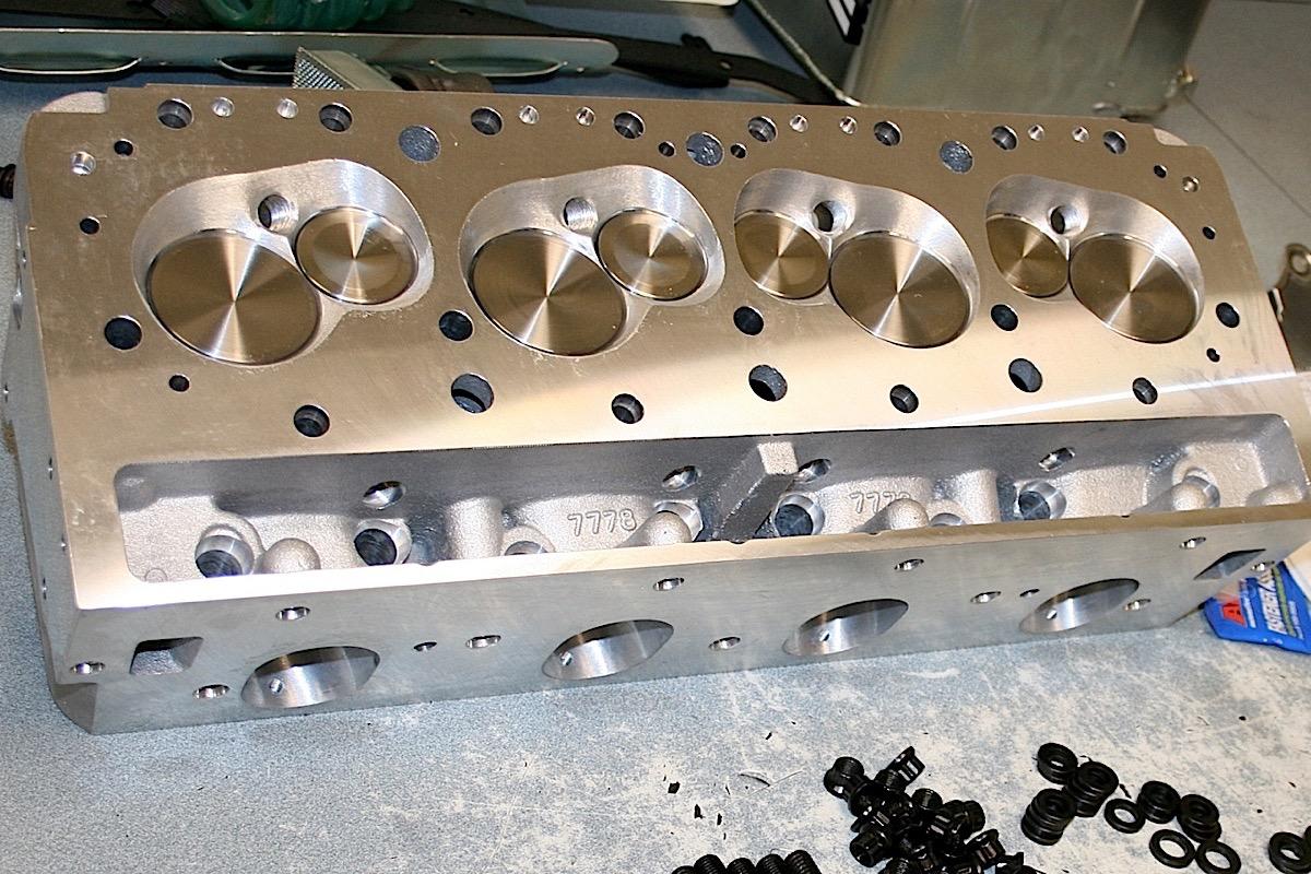

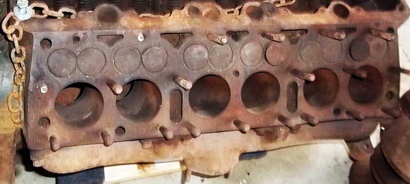

Now to look at the Lincoln:
Note that the valve order is such that it is essentially three 2-cylinder blocks in a row, each with the inlet ports in the middle flanked by the exhausts. The order is dictated by the need to get the exhaust to the outside of the block utilising the bigger gaps between the cylinders over the main bearing area of the lower block.

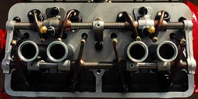

The Ardun heads used the same valve order on the Ford V8s::
And spark plug location is dictated by the consequent placement of the rockers:
Here's a picture of a Zephyr engine which clearly shows that layout for the exhausts, one in front, one in rear and two siamesed pairs in between:
So, if you follow this, you will see that your inner pair of spark plugs will come down into the head somewhere near the edge of cylinders two and five on each bank. To do it right there would be a pair of plugs in the middle.

Thanks Ray. That is now a defunct project on account of having found one ready made.

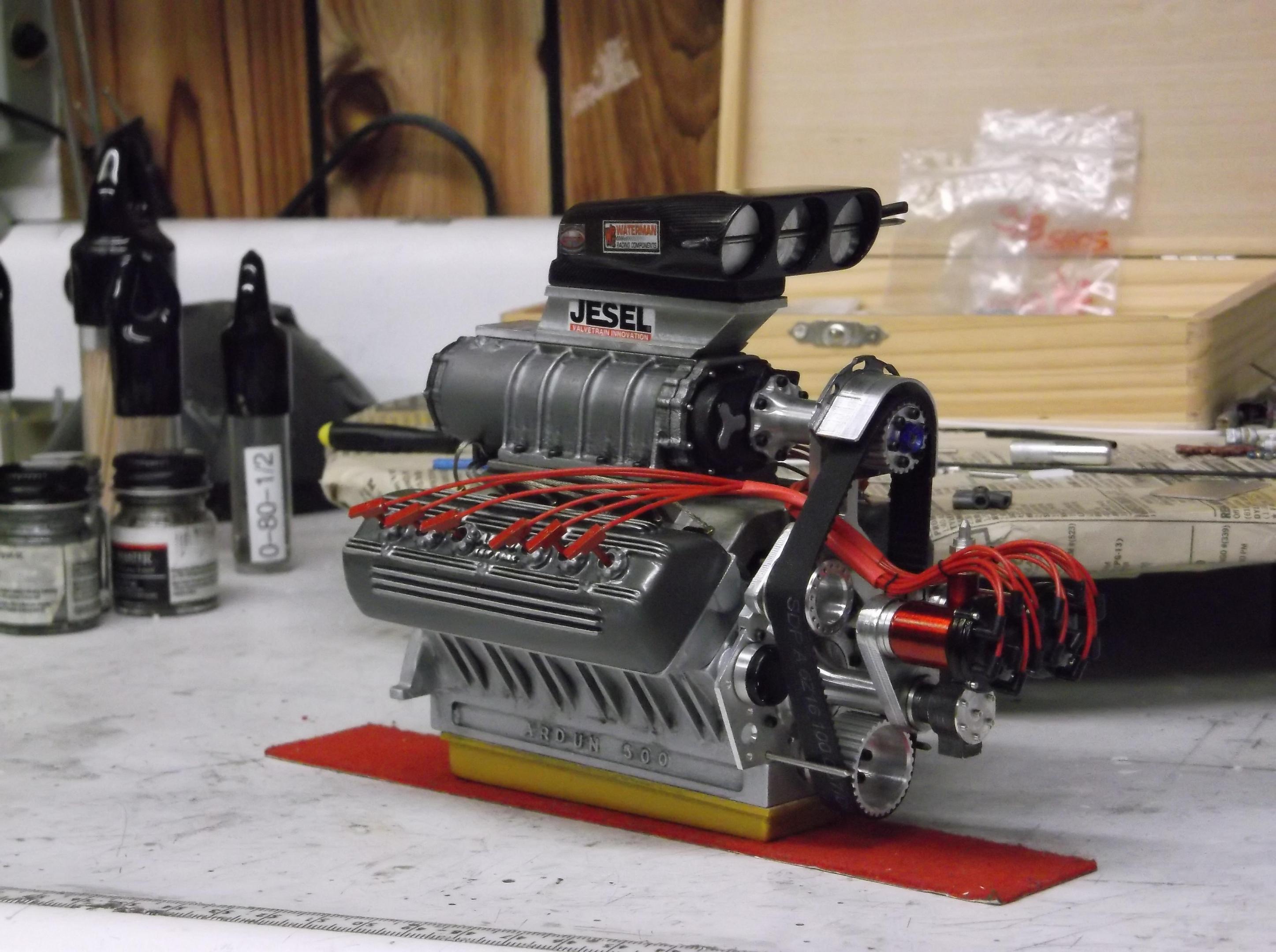

16 minutes ago, Paul Payne said:
Really like the front mounted blower version. Did something like that with an Ardun V8 in my 29 track nose. Keep us posted!
I have a Potvin blower. I might make that version too.

I see what you mean now Ray. I was copying a model not a real engine.  The 3D one I will be building has the same issue. So let's call it a non-functional showpiece, that is until the designer redoes it with even spacing. He likely copied the same model too. They likely made it like that to keep room for the Ardun lettering.

Thanks Tim. That is a superlative project. I am always in awe of all that brasswork. My V12 Ardun is also from Ron Olsen. It will likely end up in my next Hot Rod Lincoln. Here is my humble take on a similar theme.

the plug spacing could certainly be done the way it is in the model if so desired. simply grind the cam to the correct opening sequence, use the correct rockers and move the plugs to the same side of the valve layout.
here are 5 small block chevy heads.
1.std. sbc wedge
2. sbc buick symmetrical port wedge
3. sbc symmetrical port splayed valve
4. sb2  mirror image
5. sbc hemi head
all these heads bolt to a sbc block. all use different intake and exhaust locations, valve angle and position (wegde, splayed ,hemi) layouts, rocker arm layouts, pushrods, cam shafts and spark plug locations.
everything your saying that doesn't work on your version of the v-12 could be changed to work for this design if so desired.

Here is a pic of a Lincoln block.  As you can see, the cylinders are arranged on groups of two.image.jpeg.d21c5660ca2a95121c9b94f71924ed4b.jpeg
just eyeballin' it. i think you could get pretty close.  give me some real  dimensions and i'll make an accurate representation.
