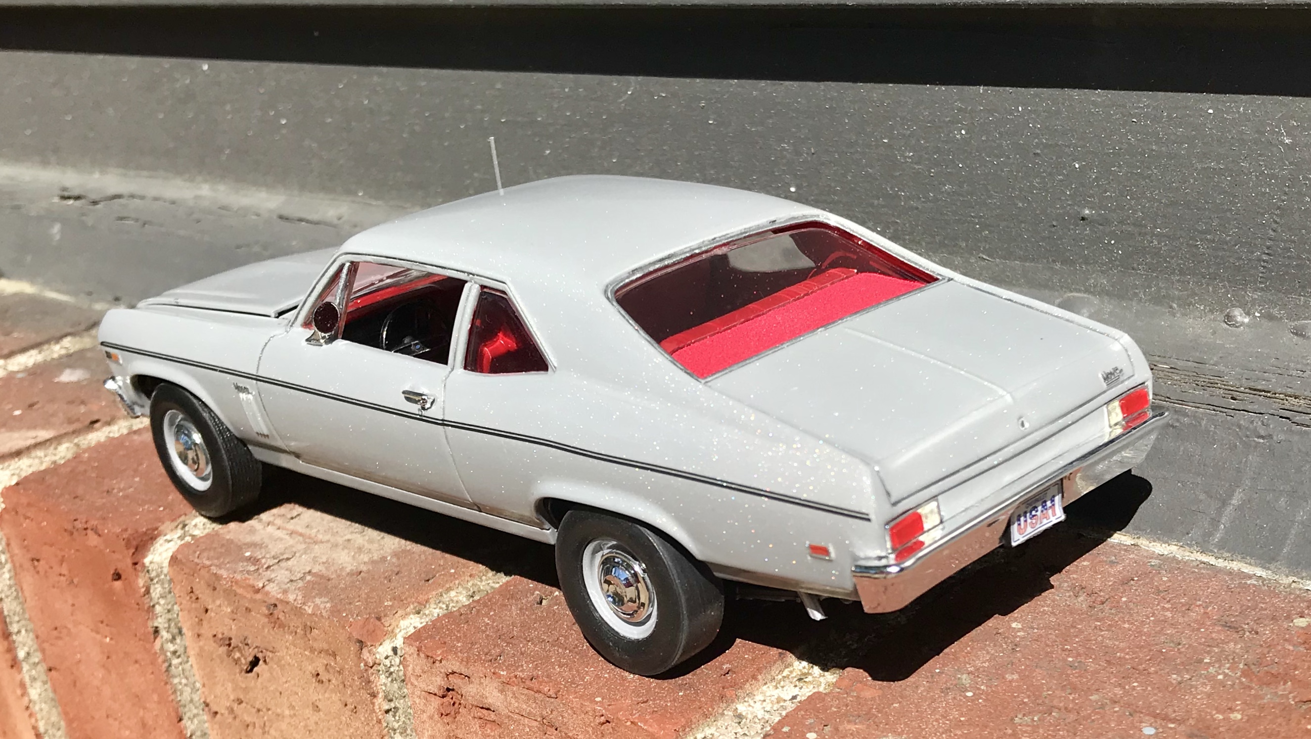

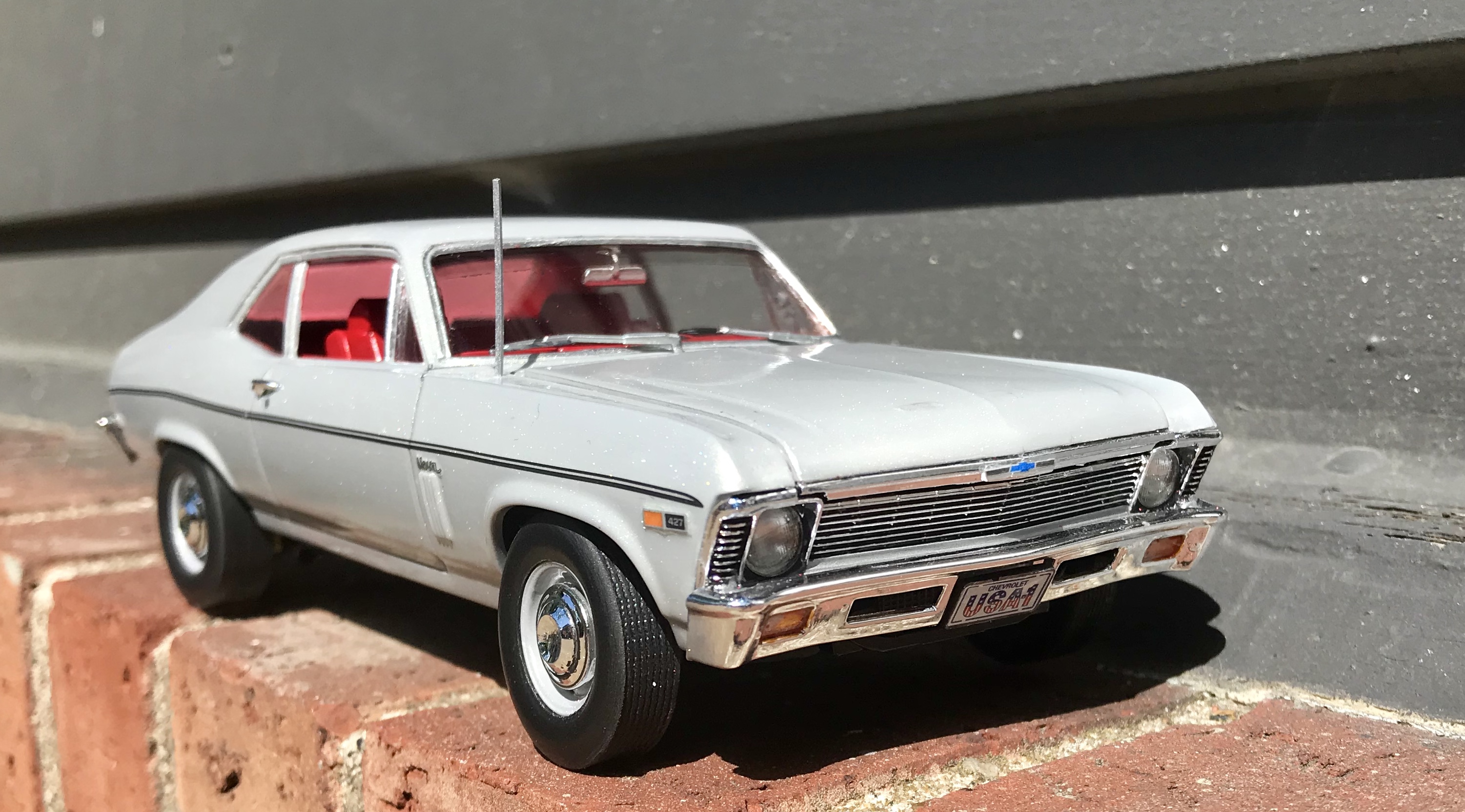

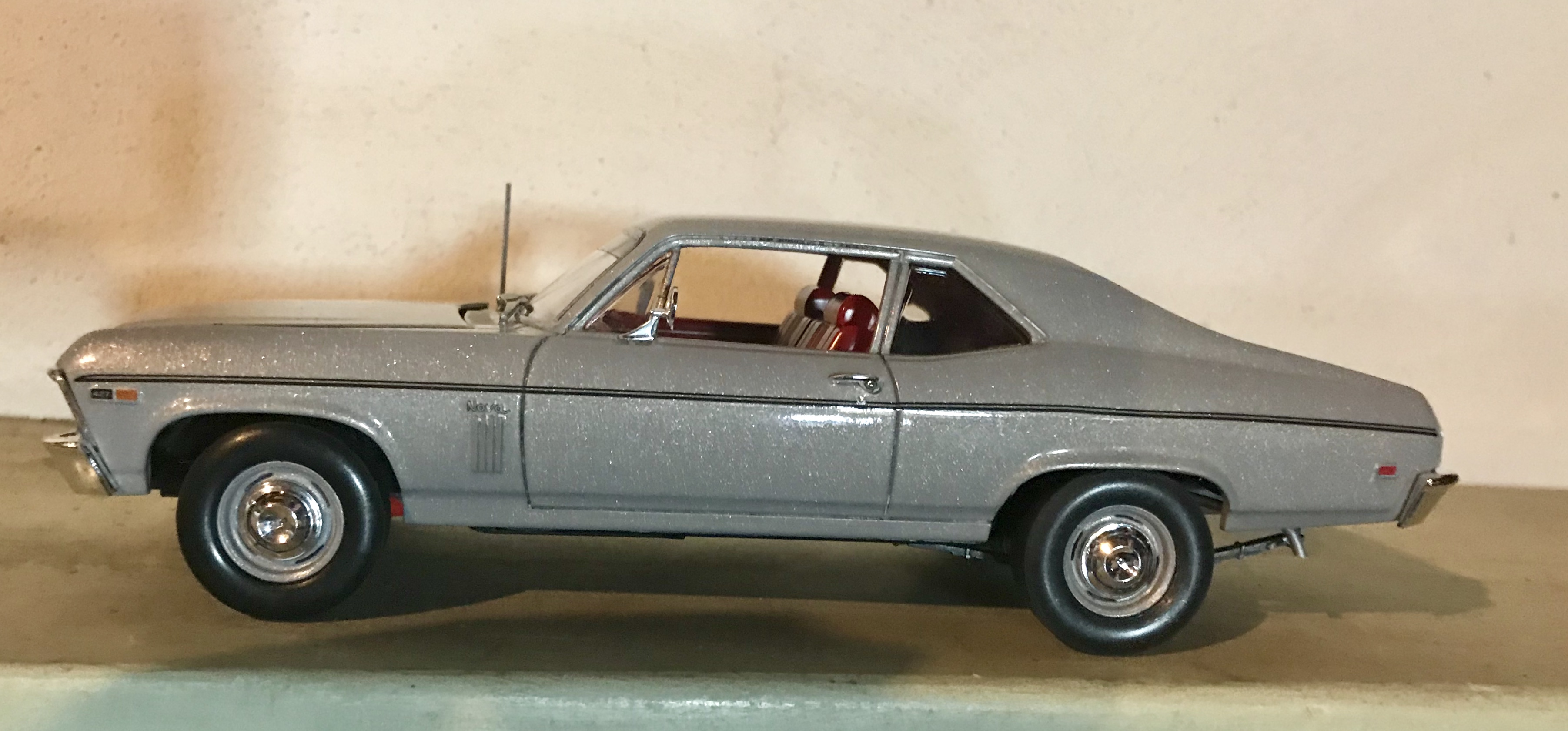

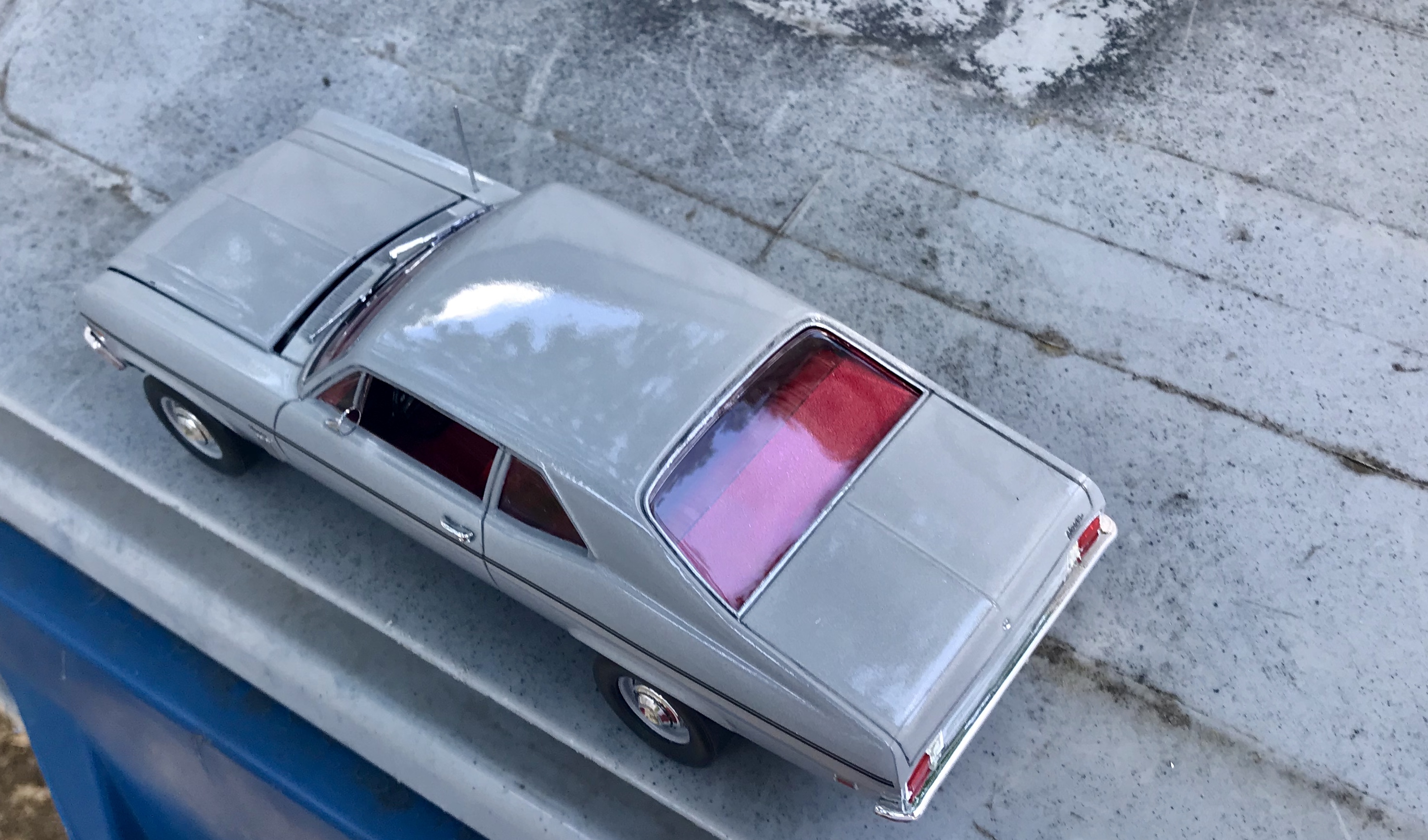

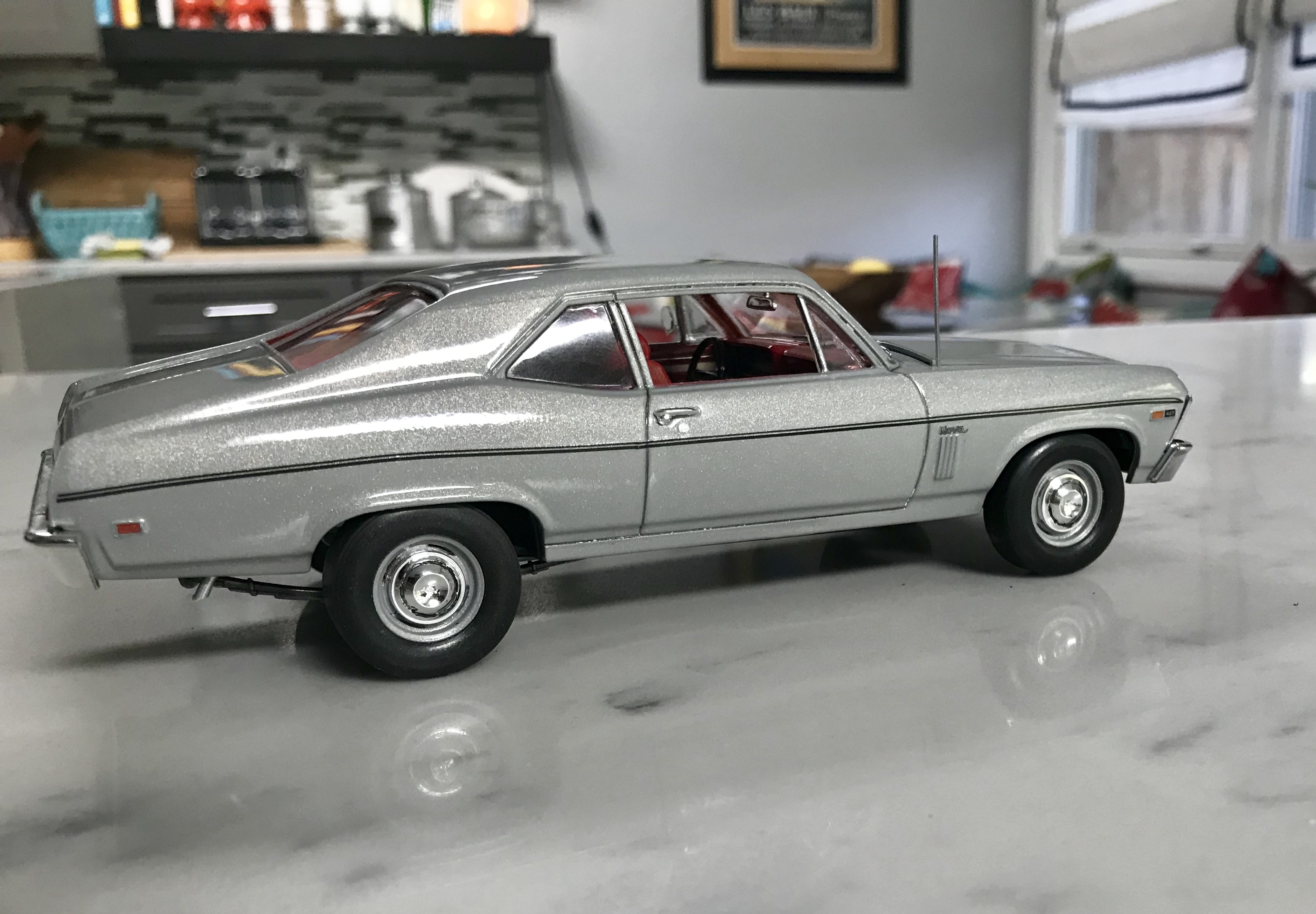

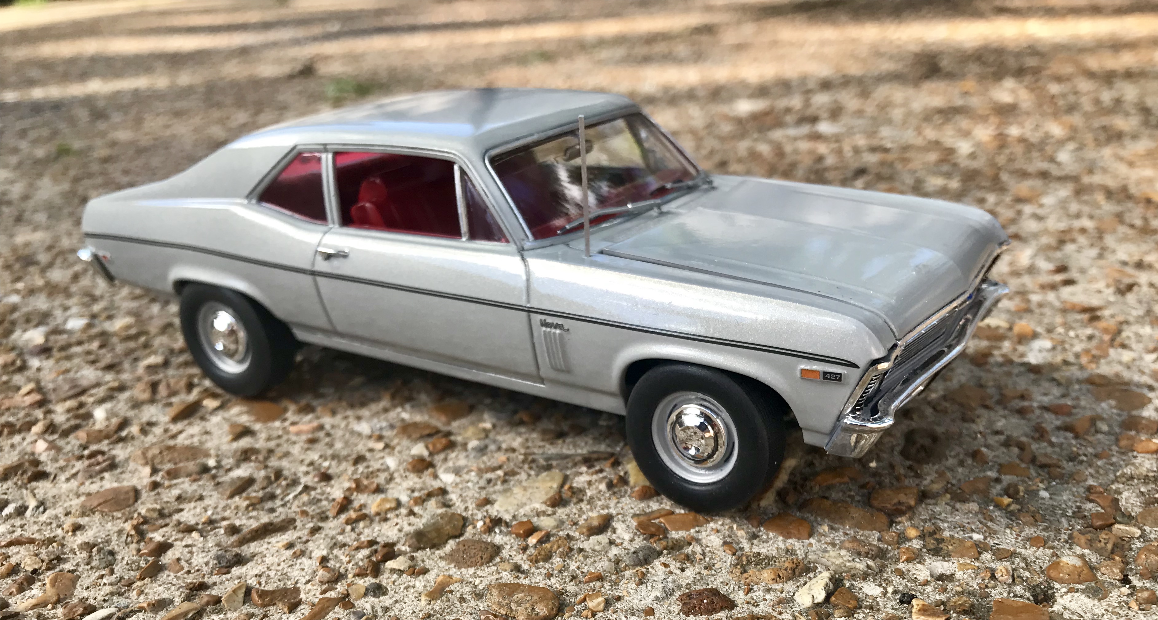

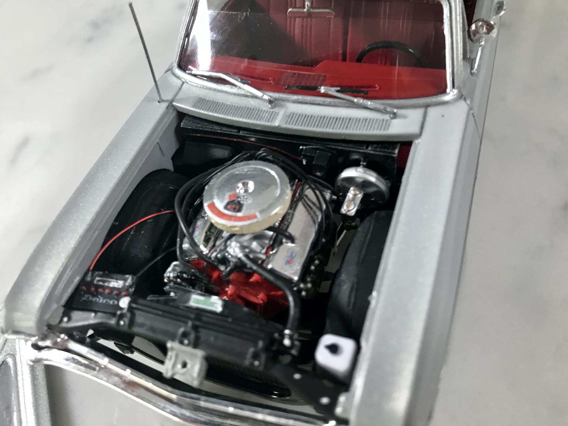

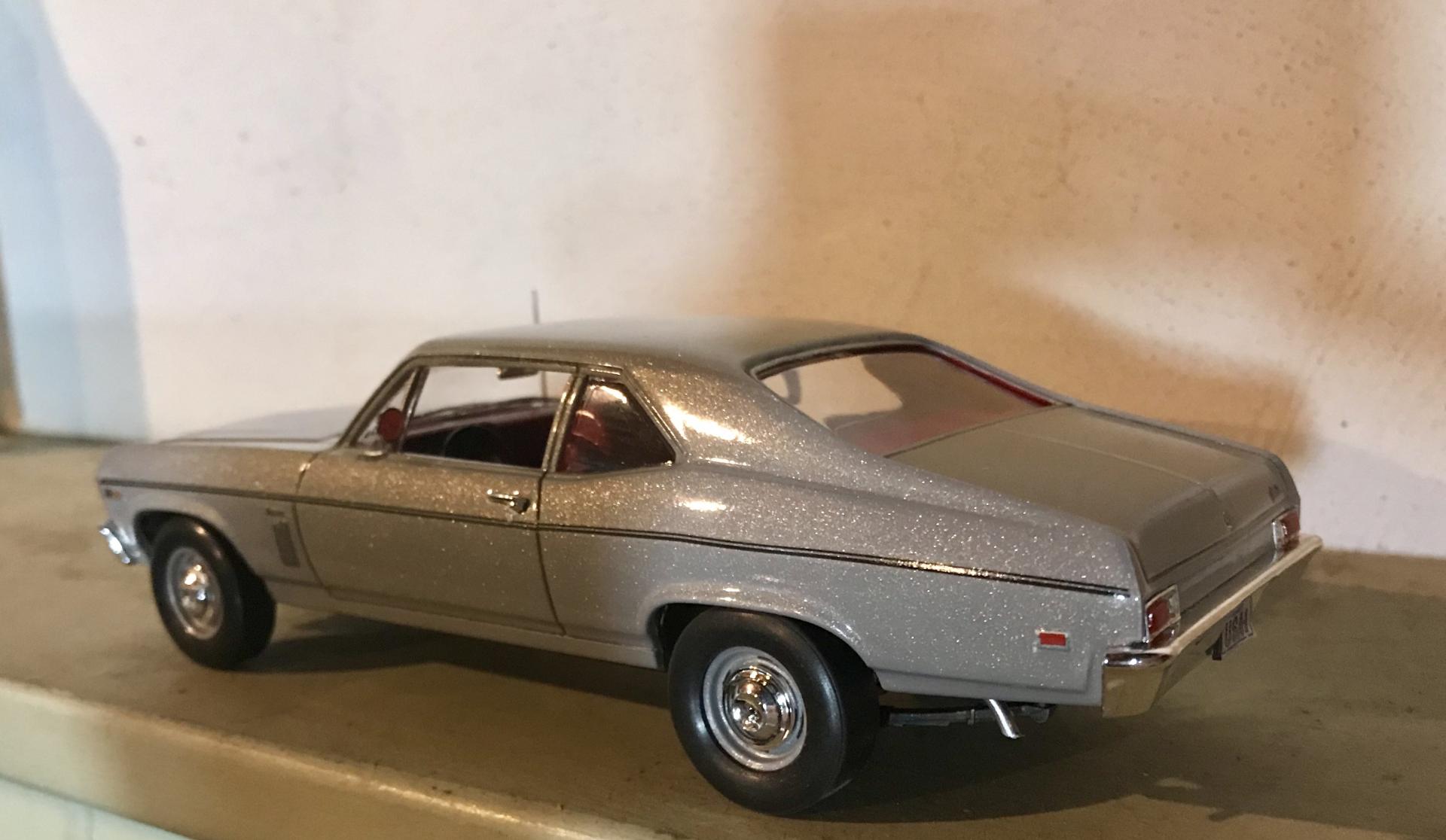

Kmb0319 Posted May 17, 2019 Share Posted May 17, 2019 (edited) I built the 69 Nova SS a couple years ago, and loved the kit, but was never happy with my results. I repainted it twice, changed wheels and tires 8-10 times, but never was satisfied. In the last stripping process, the body was damaged, so it was time to replace it. (I have another project for the sweet 350, though) This time, I bought the COPO kit, as I wanted the dog dish caps, plain rear panel and bench seat. I wanted my Nova to look like grandma’s car, but with just a little serious edge to it... like the COPO was, it should be a real sleeper. After researching, I chose Cortez Silver as my color, but had to experiment to get a good version. After multiple spoon tests the best match was the simplest: a can of Infiniti Pearl Midcoat paint sprayed directly over Tamiya gray primer, then cleared. I didn’t want a black interior, so I went with red, which was an available option in 1969. I wired my engine, and created vacuum hoses, a throttle cable and heater hoses along with battery cables. I also used a little scrap of styrene to make a radio antenna. I raised my rear end slightly, and used the slightly larger tires that were for the NASCAR version of the 69 Charger Daytona I recently completed on the rear. That gave it the stance I wanted. I did have to hold back one temptation: I LOVE a muscle car to have dog dish caps and white letter tires, but to keep this as inconspicuous as possible, I kept them as blackwalls. I also added the side stripes: I think the car looks better without them, but they do make it look more “grandma-ish.” Thanks for looking... hope you like it! Interior: The rest: My 427: Two of my three dog dish Bow ties: Edited May 19, 2019 by Kmb0319 Quote Link to comment Share on other sites More sharing options...

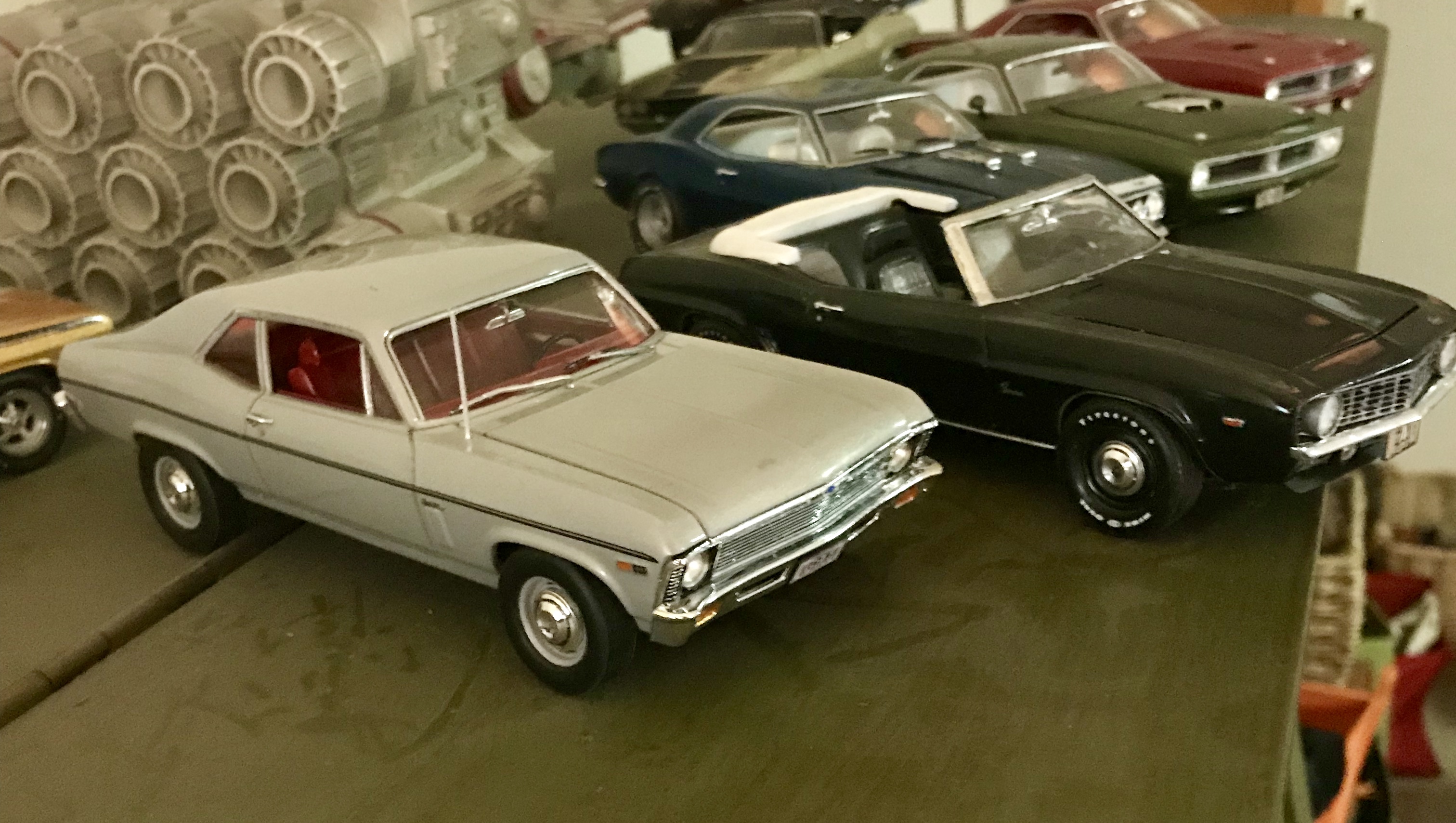

Kmb0319 Posted May 19, 2019 Author Share Posted May 19, 2019 FINALLY.... I took new pictures and these loaded.... my interior pic was taken before the body and chassis were joined, so I couldn’t get a good new pic of it. And, sitting with my other 69 dog dish bow tie... Quote Link to comment Share on other sites More sharing options...
shoopdog Posted May 19, 2019 Share Posted May 19, 2019 It was well worth our wait to see your pics, looks great! Quote Link to comment Share on other sites More sharing options...
bill lanfear Posted May 19, 2019 Share Posted May 19, 2019 Very nice! Quote Link to comment Share on other sites More sharing options...
Shambles Posted May 19, 2019 Share Posted May 19, 2019 Beautiful build. Love those old Novas! What kit was that? Quote Link to comment Share on other sites More sharing options...
Kmb0319 Posted May 20, 2019 Author Share Posted May 20, 2019 1 hour ago, Shambles said: Beautiful build. Love those old Novas! What kit was that? The Revell COPO kit Quote Link to comment Share on other sites More sharing options...
slusher Posted May 20, 2019 Share Posted May 20, 2019 Very sharp Nova!! What shade of red did you use on the interior? Quote Link to comment Share on other sites More sharing options...
Dragonhawk1066 Posted May 20, 2019 Share Posted May 20, 2019 Excellent work! Nice job on the engine details! Quote Link to comment Share on other sites More sharing options...
ewetwo Posted May 20, 2019 Share Posted May 20, 2019 Looks great and the paint is awesome. Quote Link to comment Share on other sites More sharing options...
Jantrix Posted May 20, 2019 Share Posted May 20, 2019 That's terrific man. I really like it. Excellent work. Quote Link to comment Share on other sites More sharing options...
Kmb0319 Posted May 20, 2019 Author Share Posted May 20, 2019 10 hours ago, slusher said: Very sharp Nova!! What shade of red did you use on the interior? I used Testors Flame Red. It’s a gloss paint, but comes out semi-gloss without clear coat. I used a little Testors flat cherry to make the center seam. The red embossing powder is a little lighter than the paint color, but I like the contrast. Quote Link to comment Share on other sites More sharing options...
Dominik Posted May 20, 2019 Share Posted May 20, 2019 very nice combination from paint and interior. like it! Looks really nice in the sun. well done! the only Thing...perhaps you can Change the really massive antennastick to a thinner one? for example, i use 0.5 Diameter metal if it is in my opinion too thick. Quote Link to comment Share on other sites More sharing options...
Kmb0319 Posted May 20, 2019 Author Share Posted May 20, 2019 4 hours ago, Dominik said: very nice combination from paint and interior. like it! Looks really nice in the sun. well done! the only Thing...perhaps you can Change the really massive antennastick to a thinner one? for example, i use 0.5 Diameter metal if it is in my opinion too thick. I wanted to use a piece of guitar string, but it got all bent up and couldn’t be used. This is the only other thing I had laying around and I had already drilled the hole. Next time I change strings in my guitar, I’ll swap a new piece in there instead of the styrene. Quote Link to comment Share on other sites More sharing options...
Peter Lombardo Posted May 20, 2019 Share Posted May 20, 2019 Very well done, I love the way the different light makes it look like a different build.... very, very sharp. Quote Link to comment Share on other sites More sharing options...
Curt Posted May 21, 2019 Share Posted May 21, 2019 Very different but it works! Nice job... Quote Link to comment Share on other sites More sharing options...
