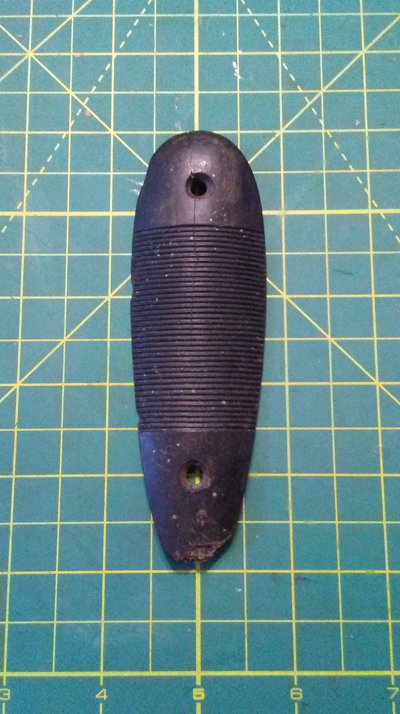

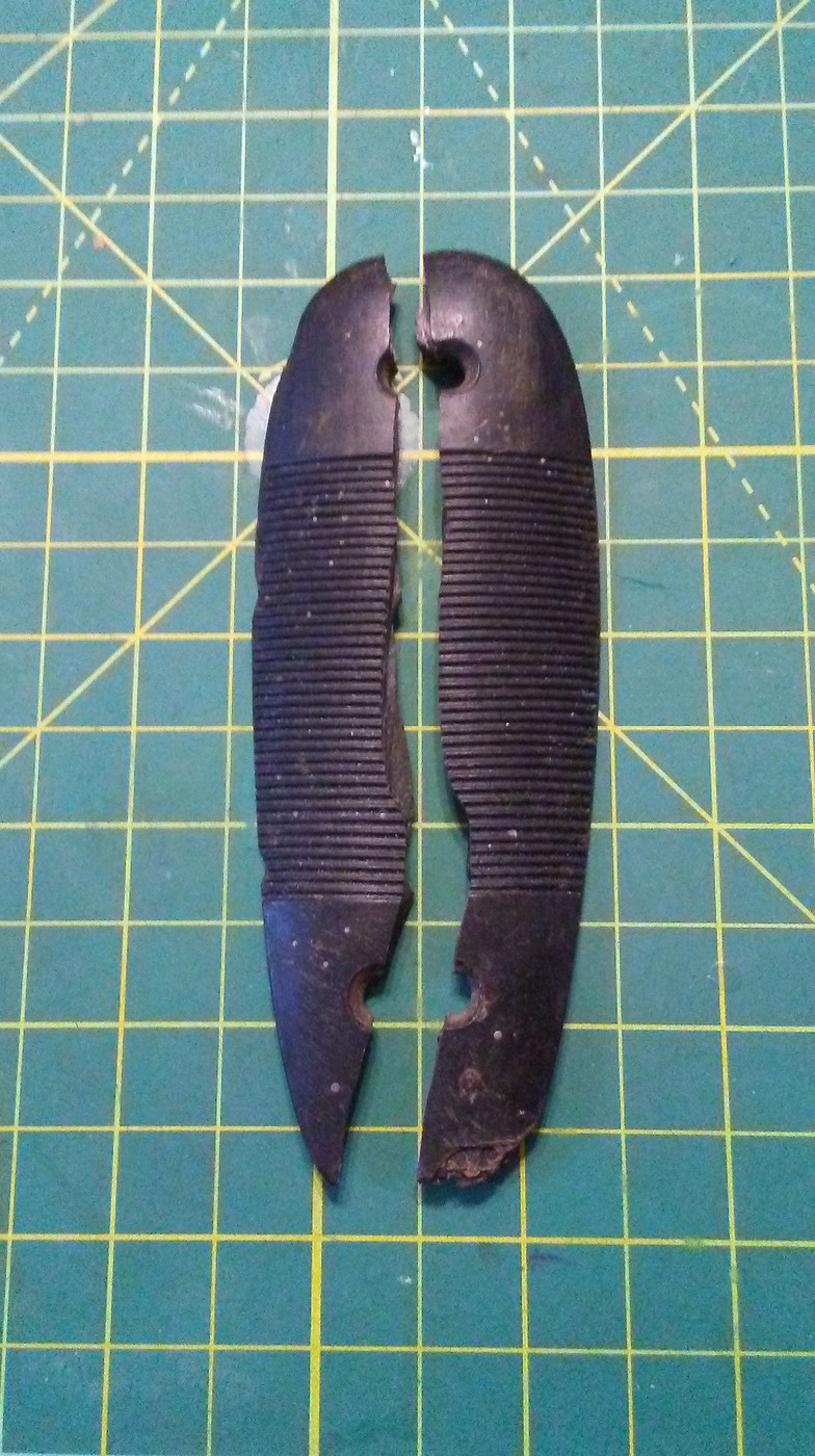

LDO Posted June 12, 2019 Posted June 12, 2019 (edited) I have a 100 year old hunting rifle that was made from a WWI military Mauser. A dog knocked over the rifle and the buttplate cracked. It's not an easy replacement; it's a one-off made of buffalo horn. If I glue this back together and do some "bodywork" on it, could a copy be made in a material that can stand up to use in the field? Not sure if what I'm asking for is possible. Btw- I did not yell at the dog. He didn't know better and I left it out so the accident could happen. Thank you. Lee Edited June 12, 2019 by LDO Add dog details

Ace-Garageguy Posted June 12, 2019 Posted June 12, 2019 (edited) I can do it. I'd need the part for about 2 weeks, and would return it exactly as-is. A two-part silicone mold would be made of the existing part, and an exact duplicate cast. The original would not be damaged. The duplicate would then be corrected as necessary to achieve a perfect master (edge chipping corrected, etc.) Another set of molds would be made of the master, at which time duplicates could be cast in a variety of engineering resins having differing hardnesses, wear characteristics, etc. Alternatively, I can point you in the right direction to amass all the knowledge you need to do it yourself, help you through the procedure and material selection, etc. I've made many prototype and fully functional one-off parts over the last 5 decades for a wide variety of clients, in a wide variety of materials. PM me if interested. Edited June 12, 2019 by Ace-Garageguy
