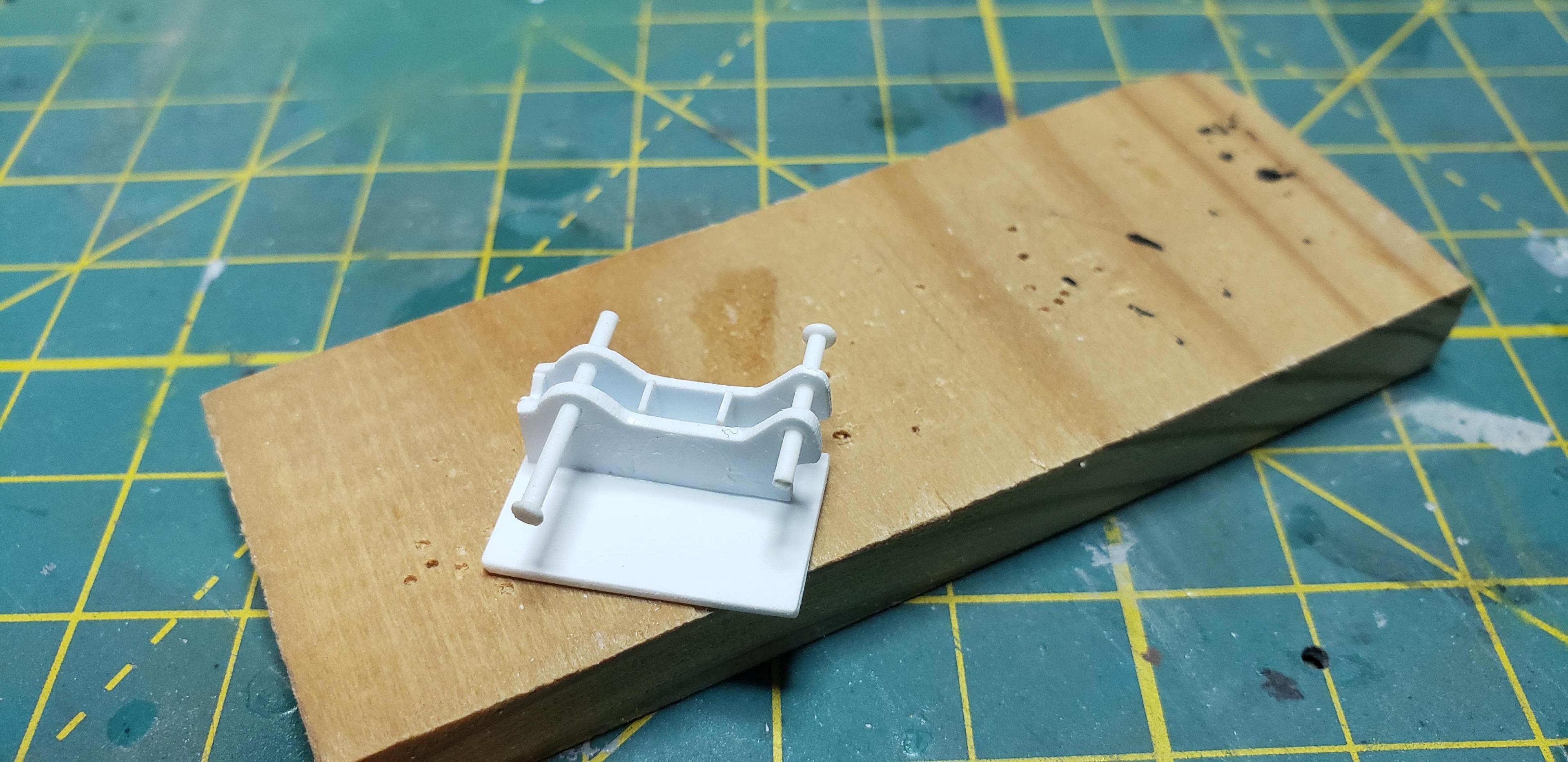

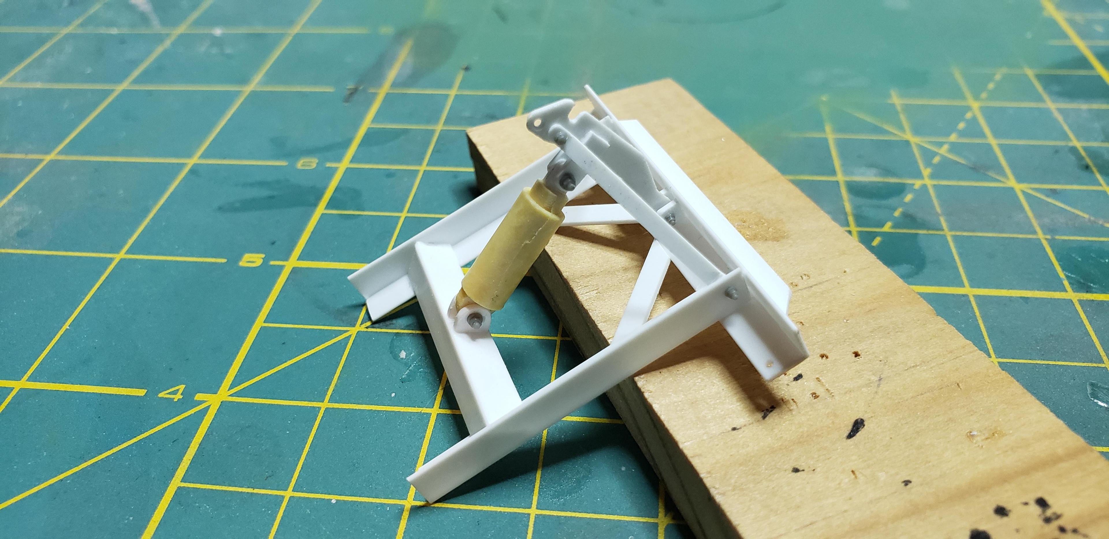

gotnitro? Posted January 2, 2020 Author Posted January 2, 2020 Small update for the New Year detailed out the plows chain lift cylinder mount. That one arm took 3 tries to get a suitable shape I was happy with ! Tossed a few Meng bolts on the tabs ..the lift cylinder came with the plow .The rest is just evergreen items

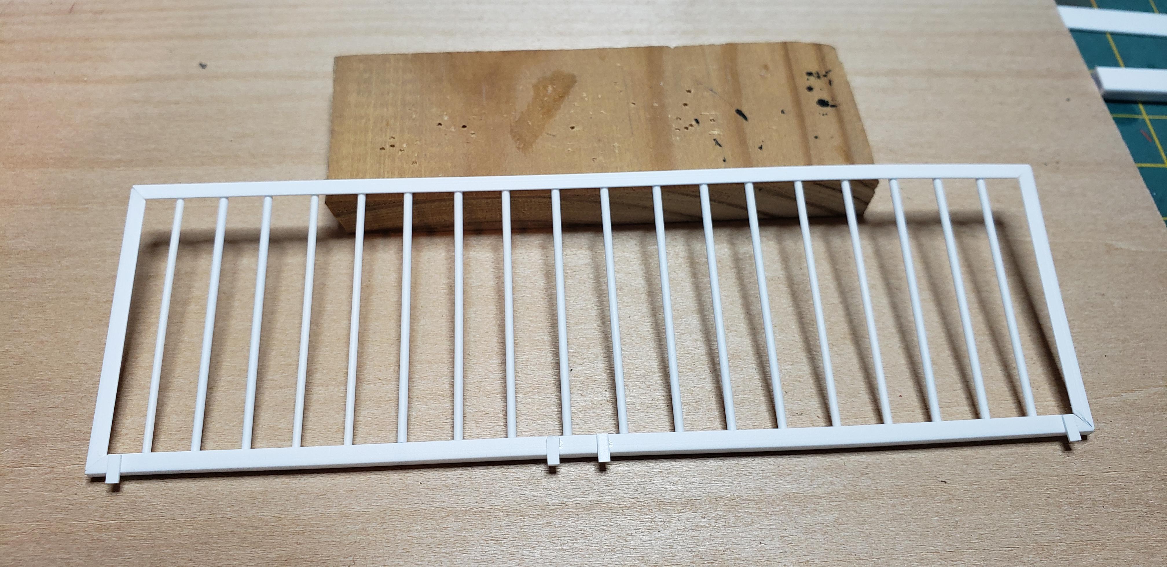

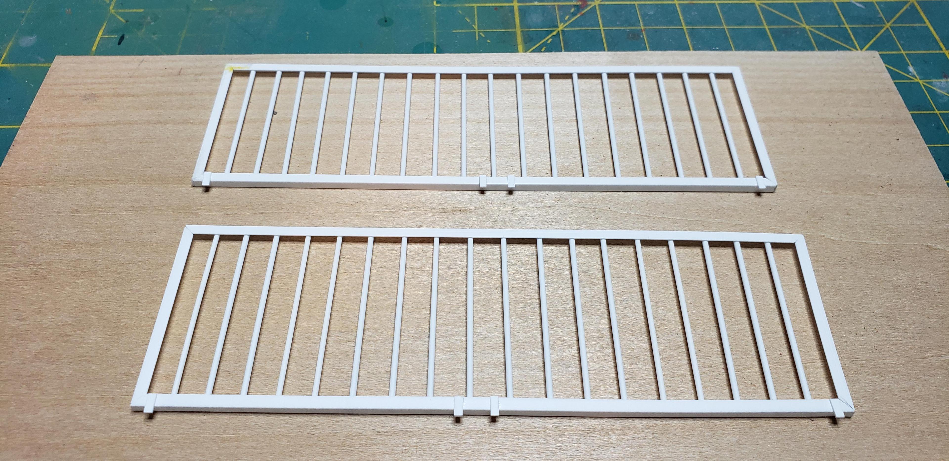

gotnitro? Posted January 5, 2020 Author Posted January 5, 2020 Thanks everyone! I appreciate the feedback Puttering around this wknd I found a minute to scratch the grates for the hopper . Guess those days taking wood shop class weren't wasted ! I still remember how to make frames . It's just angle and rod . Few small tabs hold it from dropping into hopper

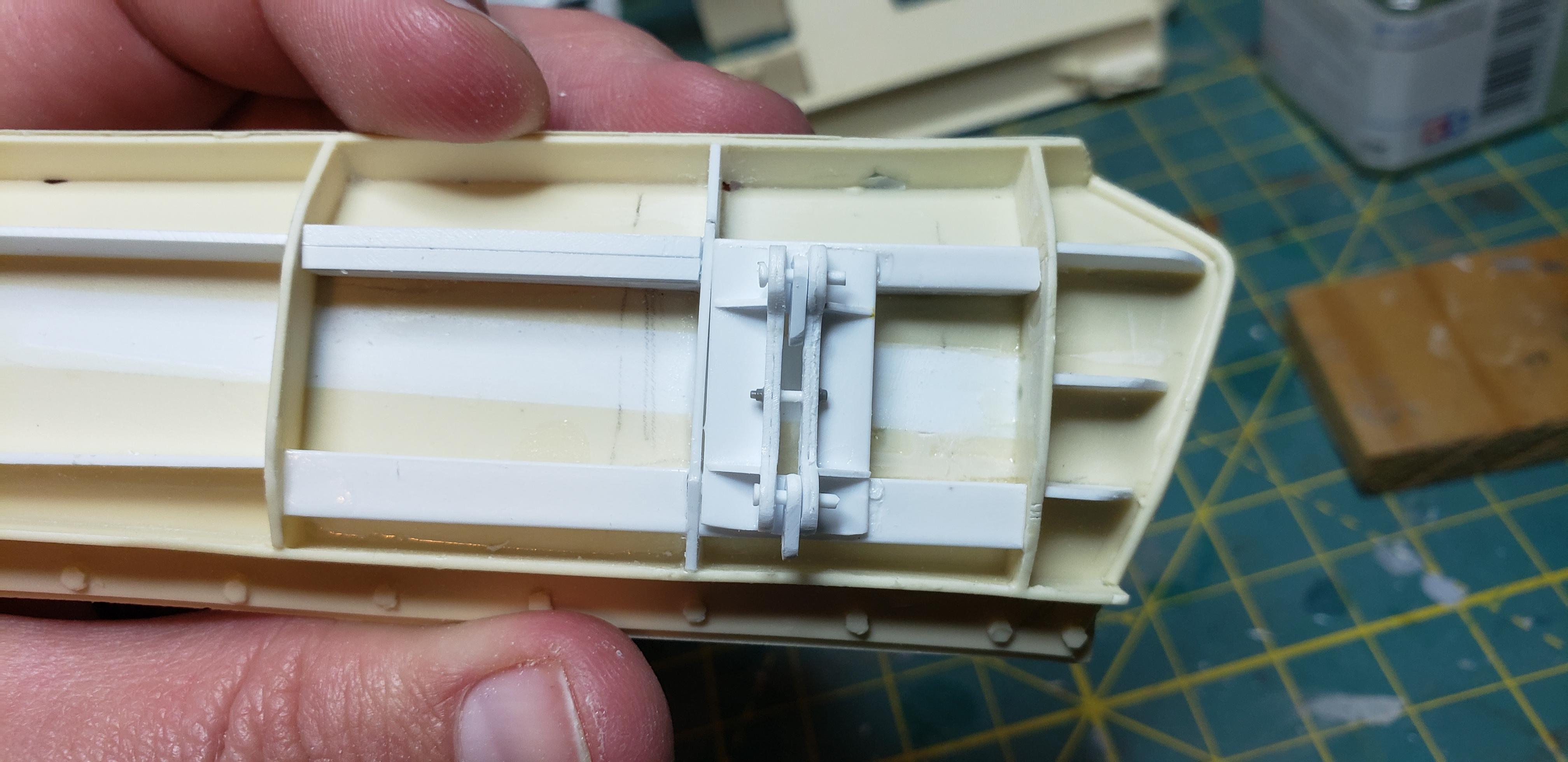

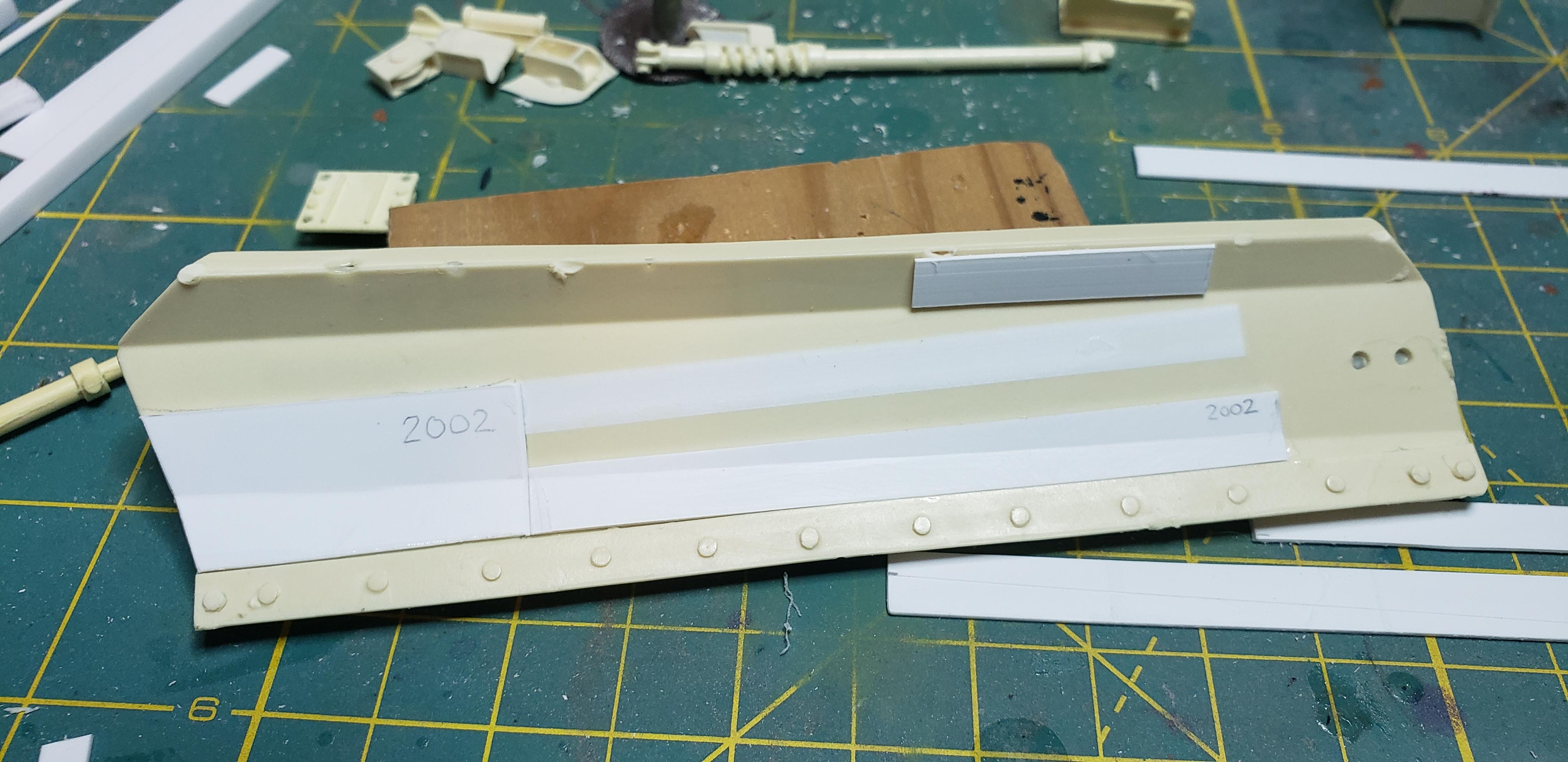

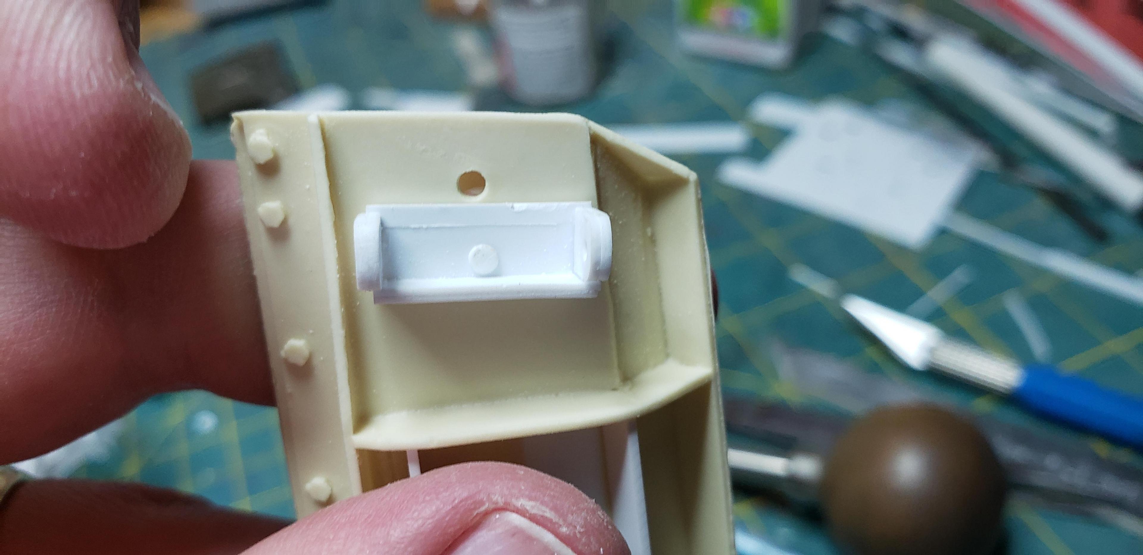

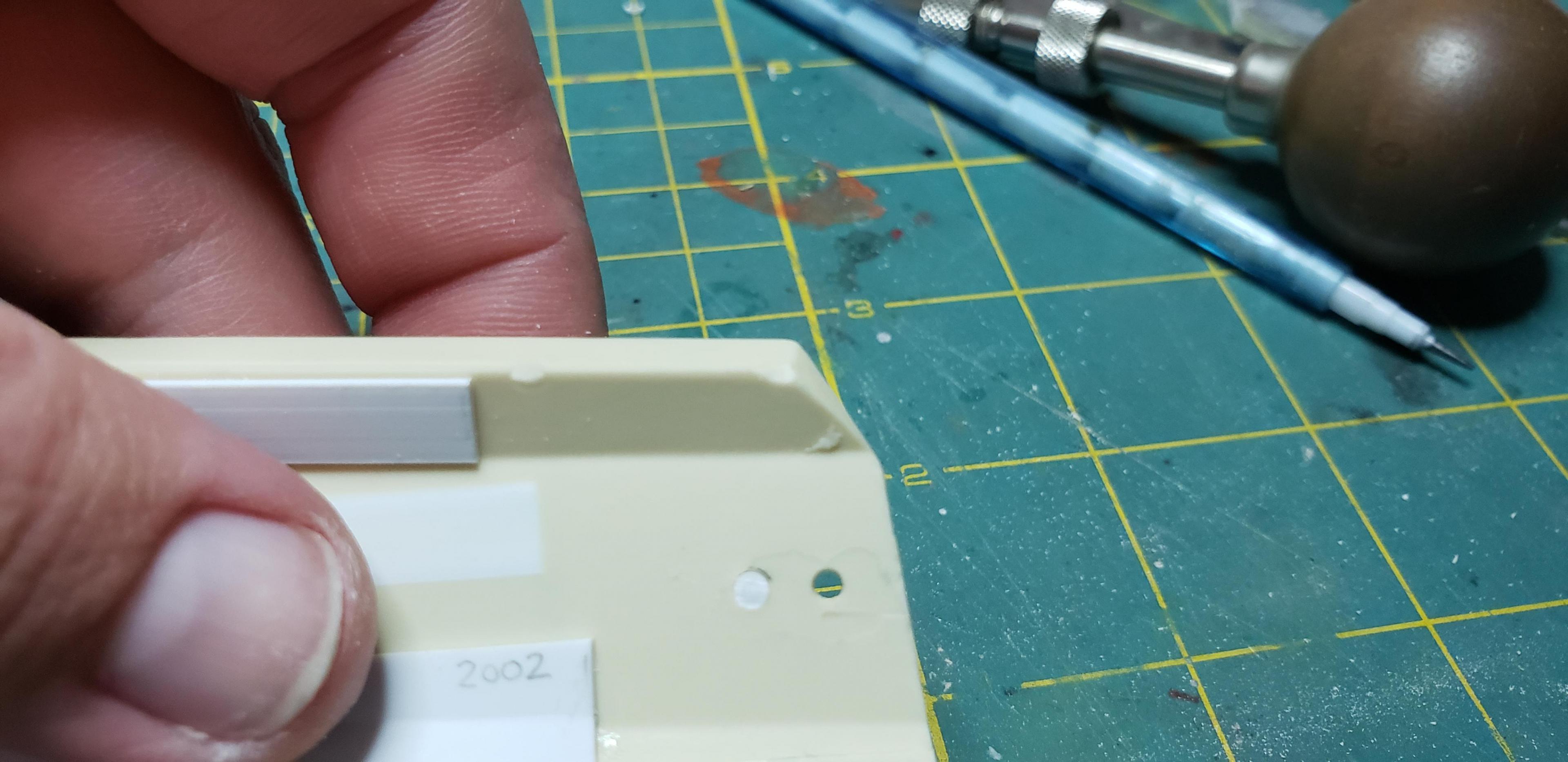

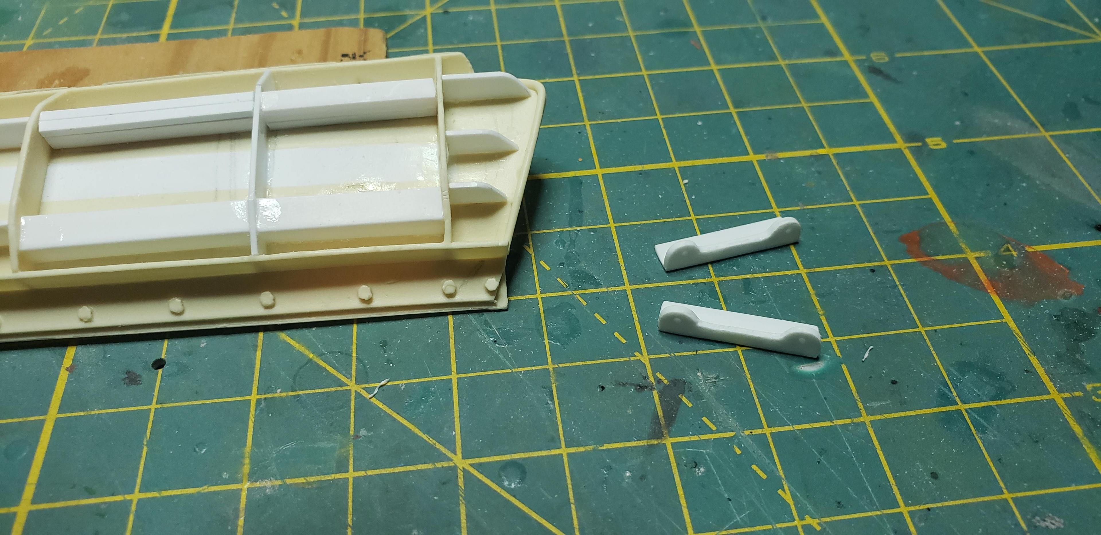

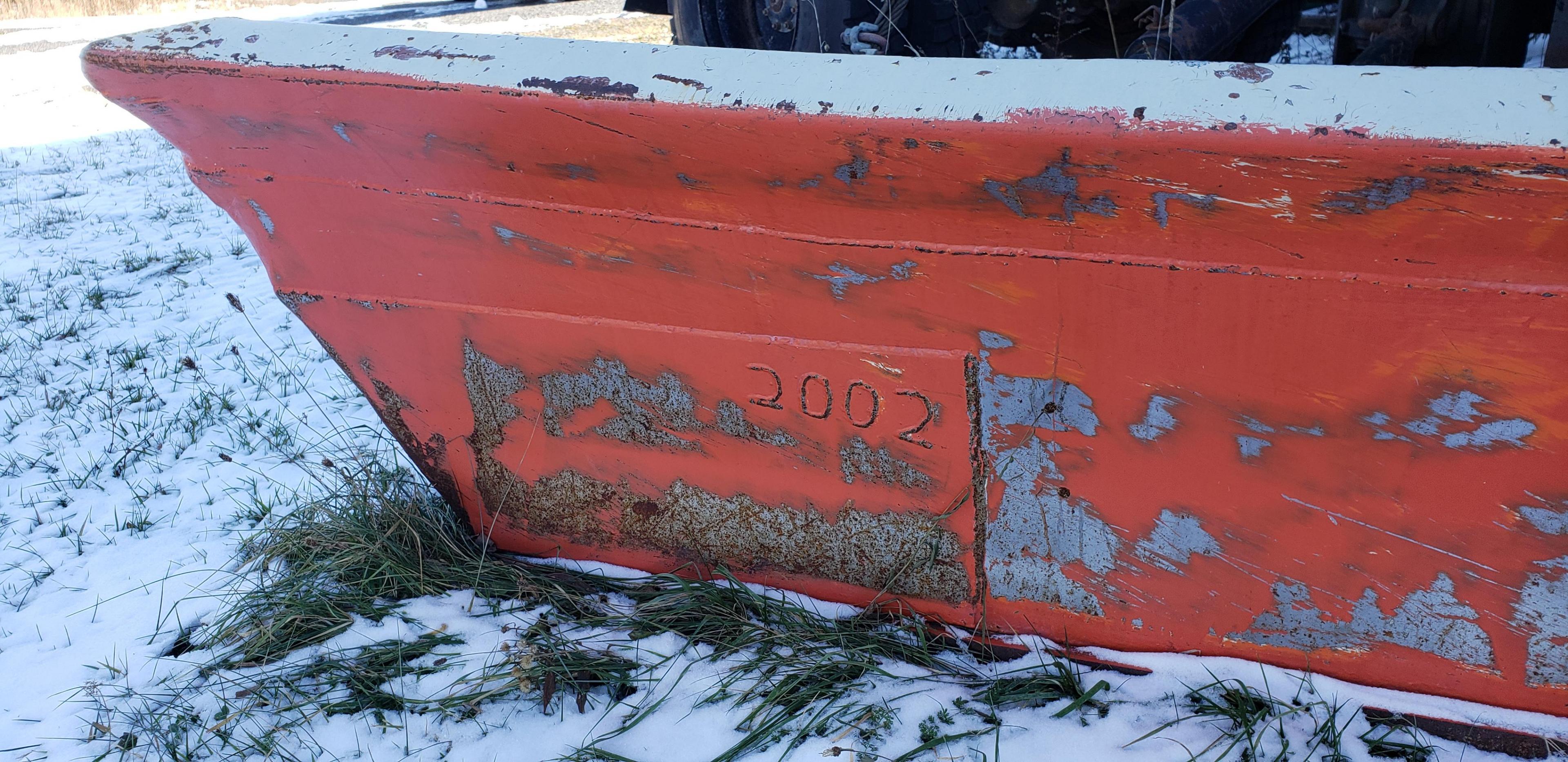

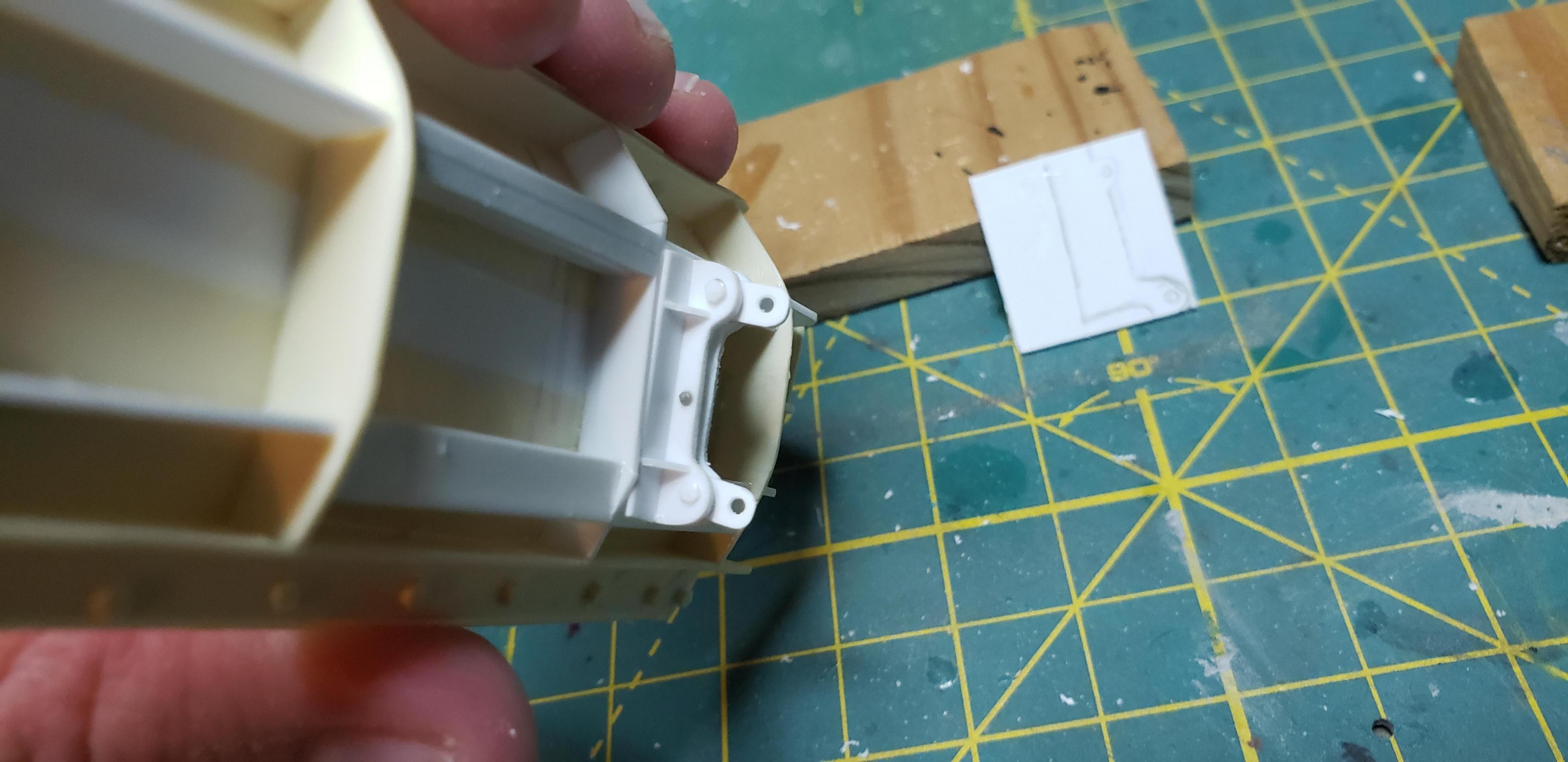

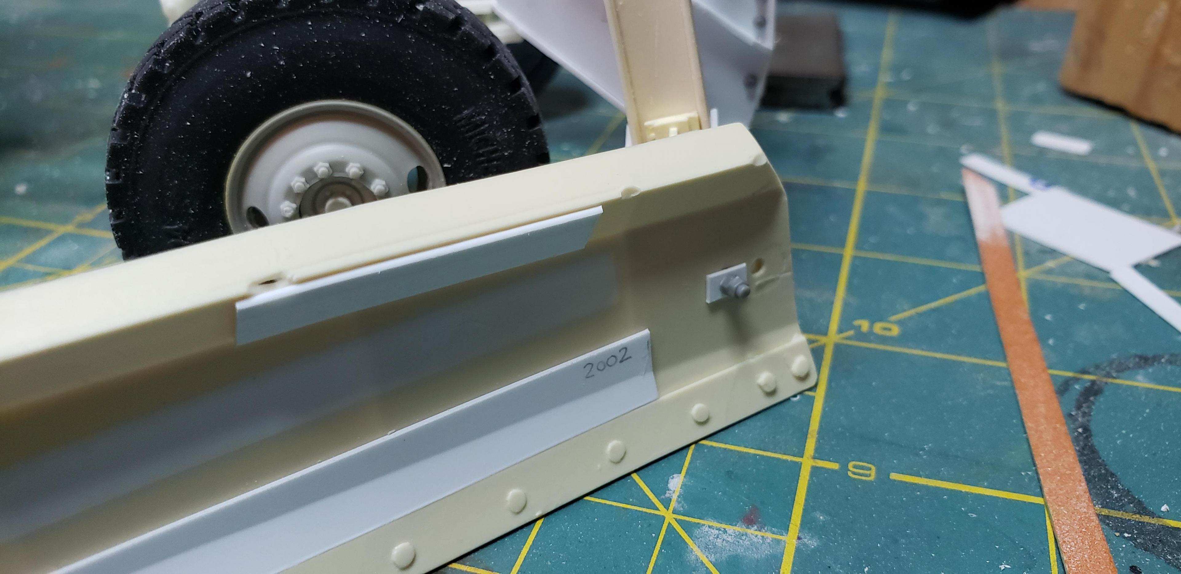

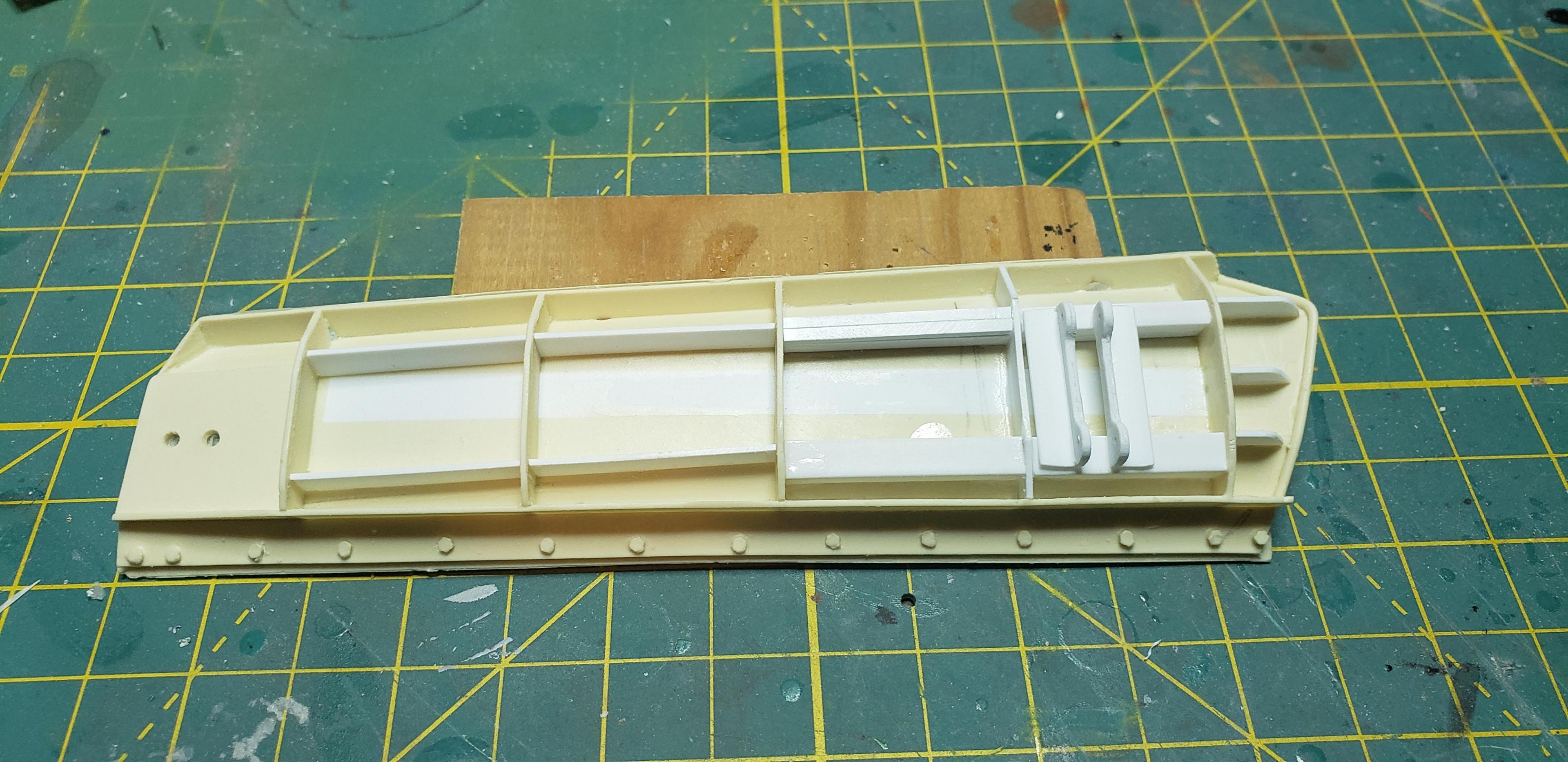

gotnitro? Posted January 11, 2020 Author Posted January 11, 2020 (edited) I started updating the wing supports and mounts . I've been told about several manufacturers of wings , and this was different than my ref. The biggest difference was the mount that secures the lifting mechanism ( rods) to the wing body. I profiled some angle and pinned everything together to keep em even. The horizontal braces were added also . The outside of the wing body had been patched over its lifetime also, so a few scrap bits were glued on. They actually had a 2002 date welded onto the patches ...I may try to replicate that w ctm etch welds thanks for following Edited January 11, 2020 by gotnitro?
Chariots of Fire Posted January 11, 2020 Posted January 11, 2020 Details! Details! I love it! Scratch building offers so many opportunities to make them. Having the real rig to go by is a huge advantage. Doing something special, Jeff!
Tesla Posted January 11, 2020 Posted January 11, 2020 Phenomenal detailing Jeff! Projects like this make me try harder ?
gotnitro? Posted January 11, 2020 Author Posted January 11, 2020 46 minutes ago, Tesla said: Phenomenal detailing Jeff! Projects like this make me try harder ? Thanks ! Glad I could help ya push your skills, it's fun trying different techniques. 4 hours ago, Chariots of Fire said: Details! Details! I love it! Scratch building offers so many opportunities to make them. Having the real rig to go by is a huge advantage. Doing something special, Jeff! I appreciate your comments ! Yes having the real truck for photos certainly helps . I've had to swing by numerous times when I noticed photos missing

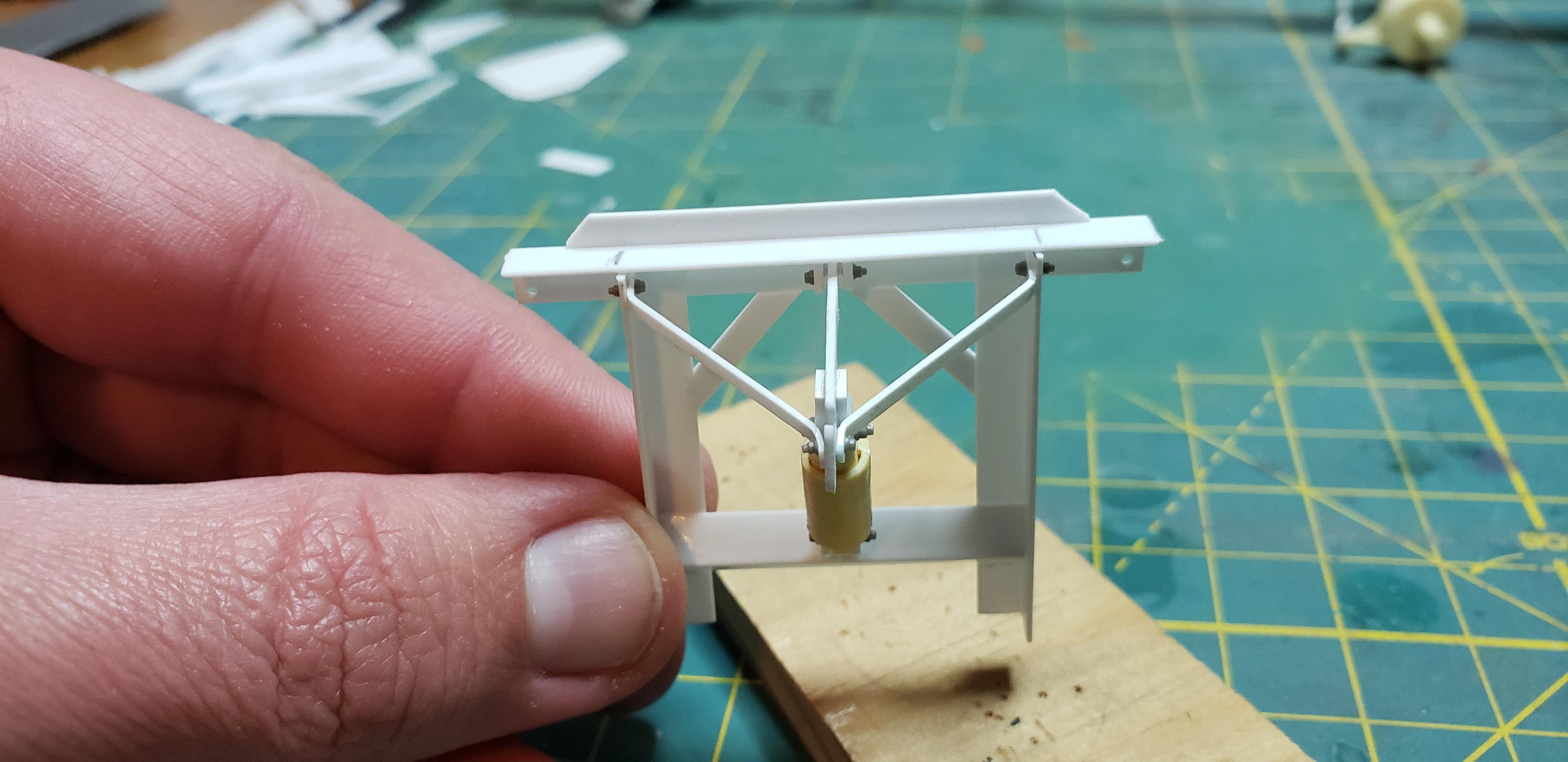

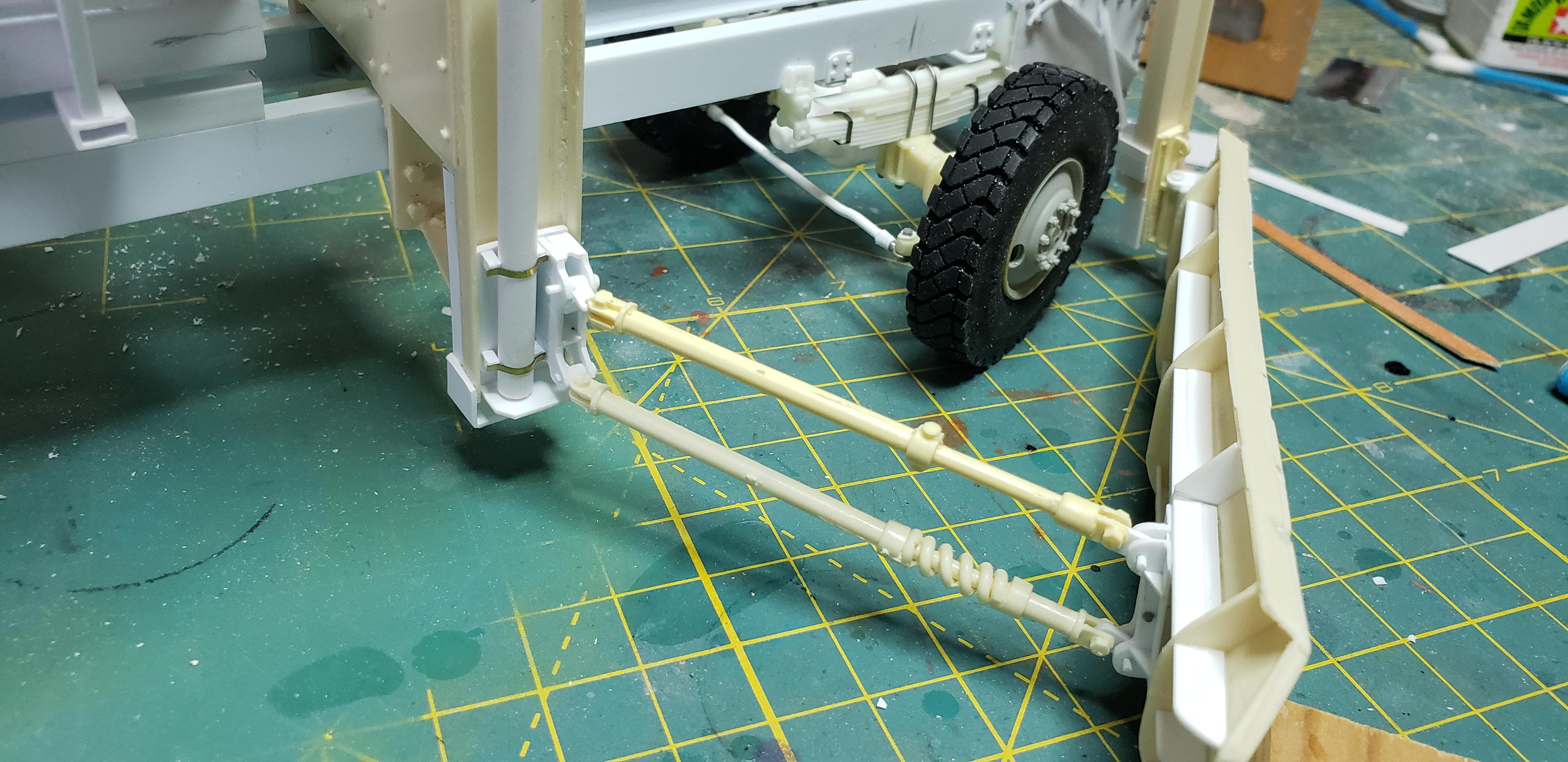

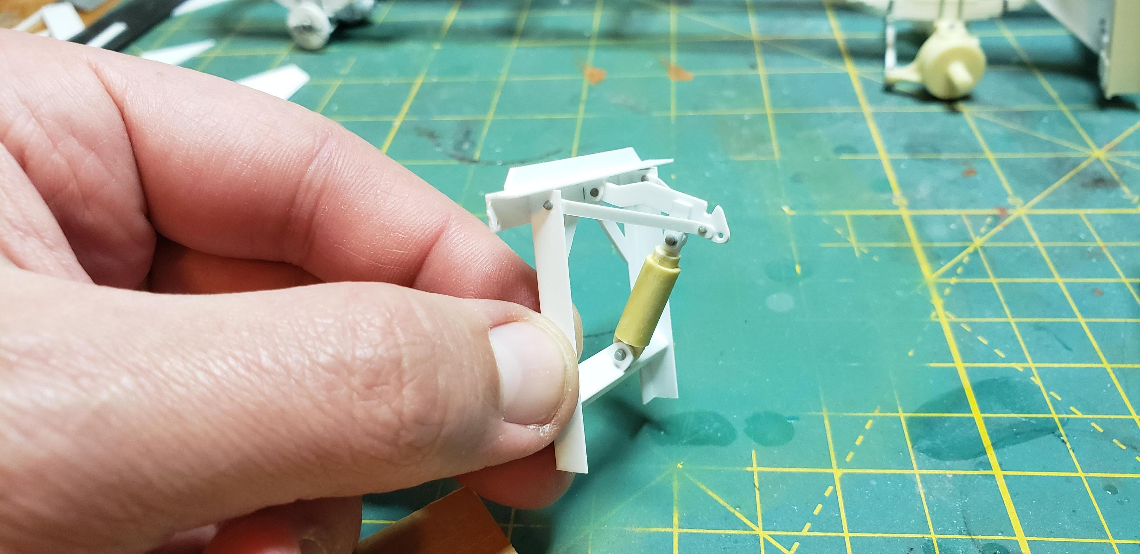

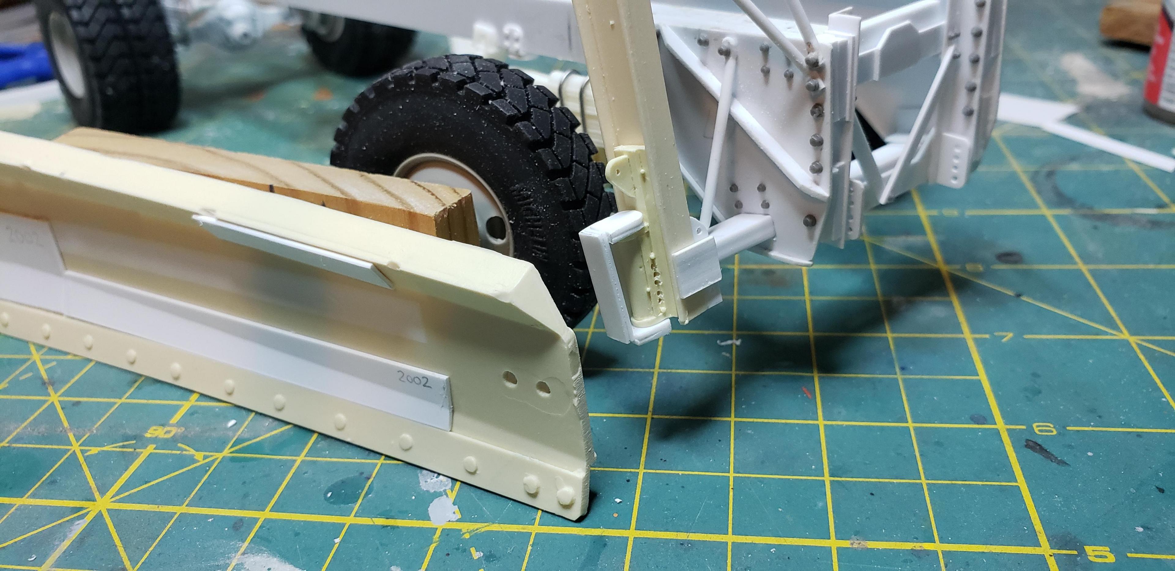

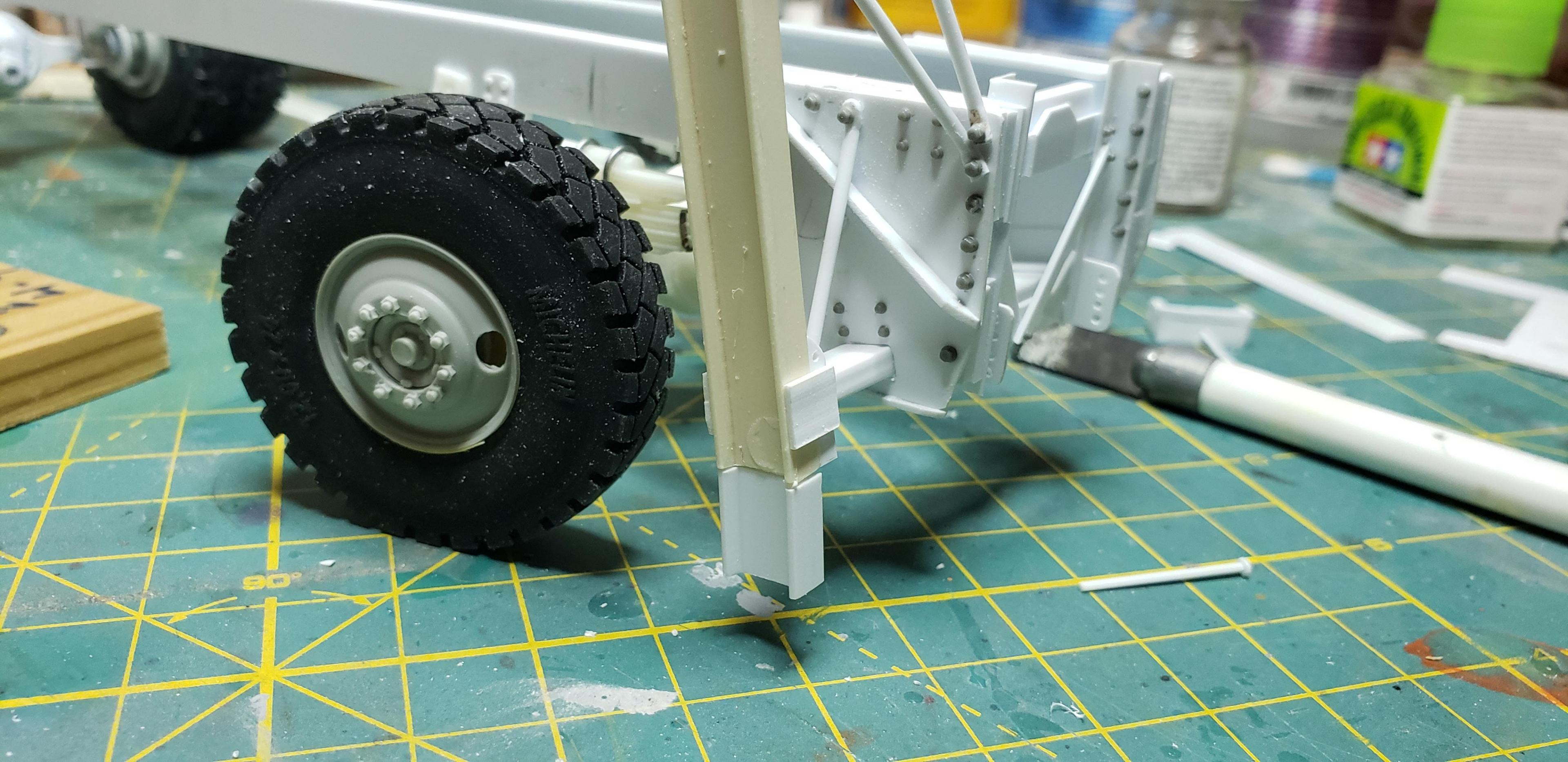

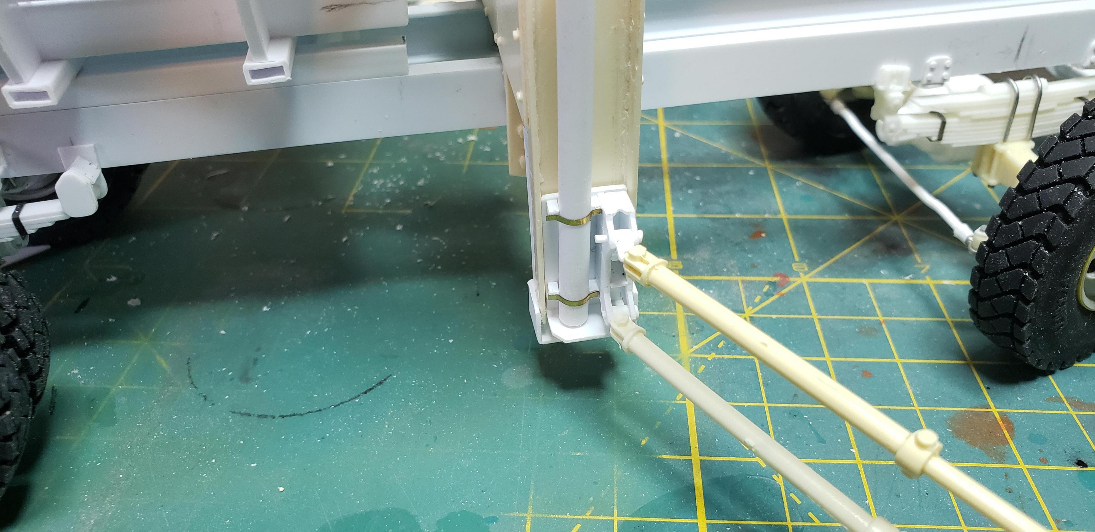

gotnitro? Posted January 11, 2020 Author Posted January 11, 2020 (edited) I had a few hrs to putter today, finished getting the side wing mounted and testing all the parts.Always seems like mockups show things too close and changes are needed . I usually tack everything together so I'm not breaking stuff when problems arise The wing lift had me stumped , theres tons of parts in a small area . The hydraulic cylinder fits tightly against the mounts , and getting the mounts right proved problematic. I tried a few methods then settled on KISS. A few tabs to hold the cylinder along the brackets worked . Heres the lift bracket I really wanted this to have some movement cause I'd been concerned about the wing not resting flat . I made tabs from tube and strip so they could pivot . The effort paid off ...except one rod is slightly short ..easy fix The front post revealed a major issue . I either didnt make the side plates tall enough or attached post too high...either way I ended up adding an extension w I beam to lengthen the post . Before extending the post..whoops After adding the extension. Yeah..its very crooked , just tacked there Pinning the front wing plate will allow it to tilt and slide into the post ...another issue that popped up . I drilled out the wing hole, inserted an appropriate size tube ( bushing) so the pin would fit tightly. hide all this behind a washer and few Meng bolts ..and it's done ! that's it for now ! Edited January 11, 2020 by gotnitro? Added photo

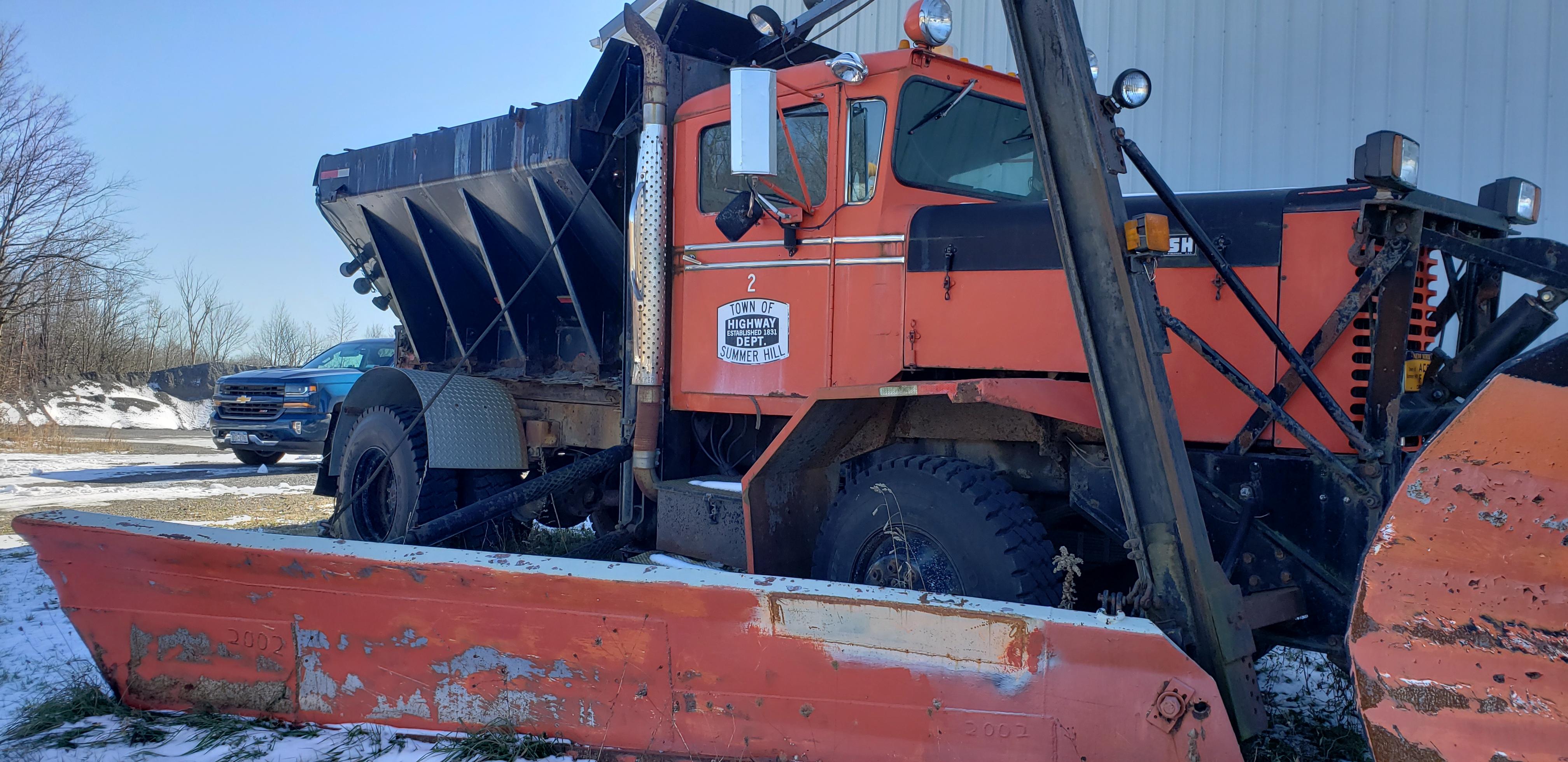

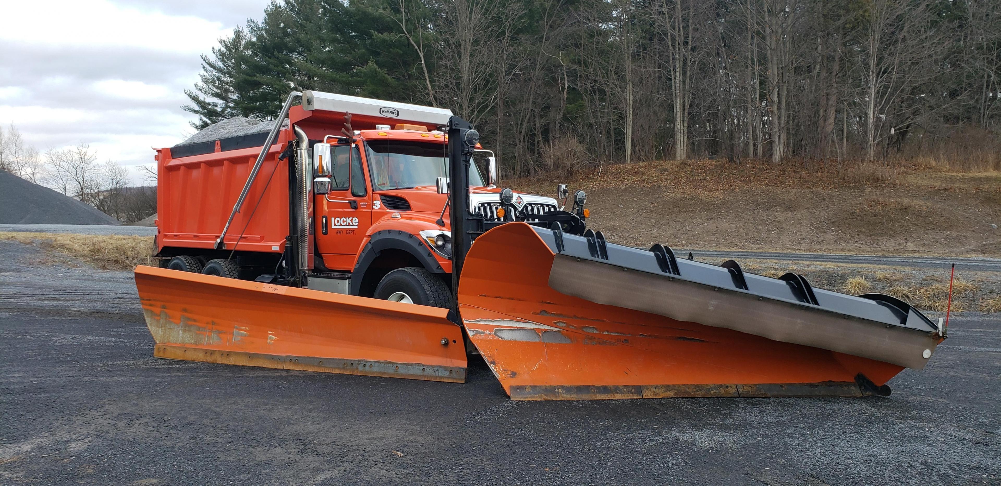

gotnitro? Posted January 13, 2020 Author Posted January 13, 2020 Thanks everyone I appreciate the comments !! I find building trucks like these relaxing , guess using brain problem solving is good for keeping away dementia . I stopped by local DOT today for a few inspiration photos..and this was waiting. Its heavy duty , wearing a plow..and ORANGE what's not to love ..stay tuned
Warren D Posted January 13, 2020 Posted January 13, 2020 Outstanding level of detail. I've never seen a sander that didn't have a screen of some sort on the top. Lumps are death to the conveyor chain and the driver will spend more time outside the truck clearing the spreader than putting product on the road!
