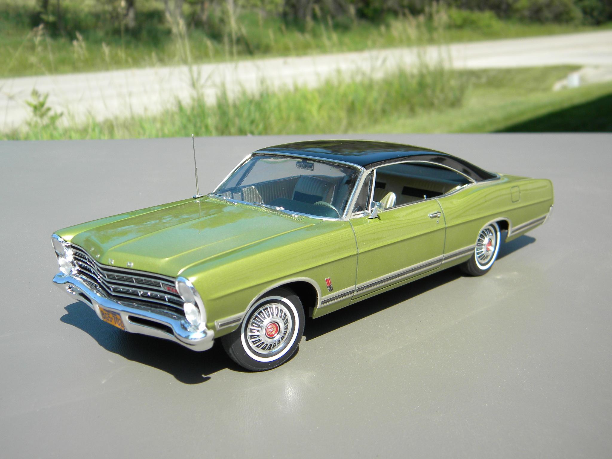

StevenGuthmiller Posted December 11, 2019 Posted December 11, 2019 (edited) That's the way that I do nearly every model. It is often referred to as the "foil under paint" or "foil before paint" technique. As a matter of fact, I think this technique is about due for it's own "initialism".......FUP. Steve Edited December 12, 2019 by StevenGuthmiller
R. Thorne Posted December 11, 2019 Posted December 11, 2019 Steve, every time I see that Ford, I think “that’s not a model, that’s a real car”. Beautiful work.

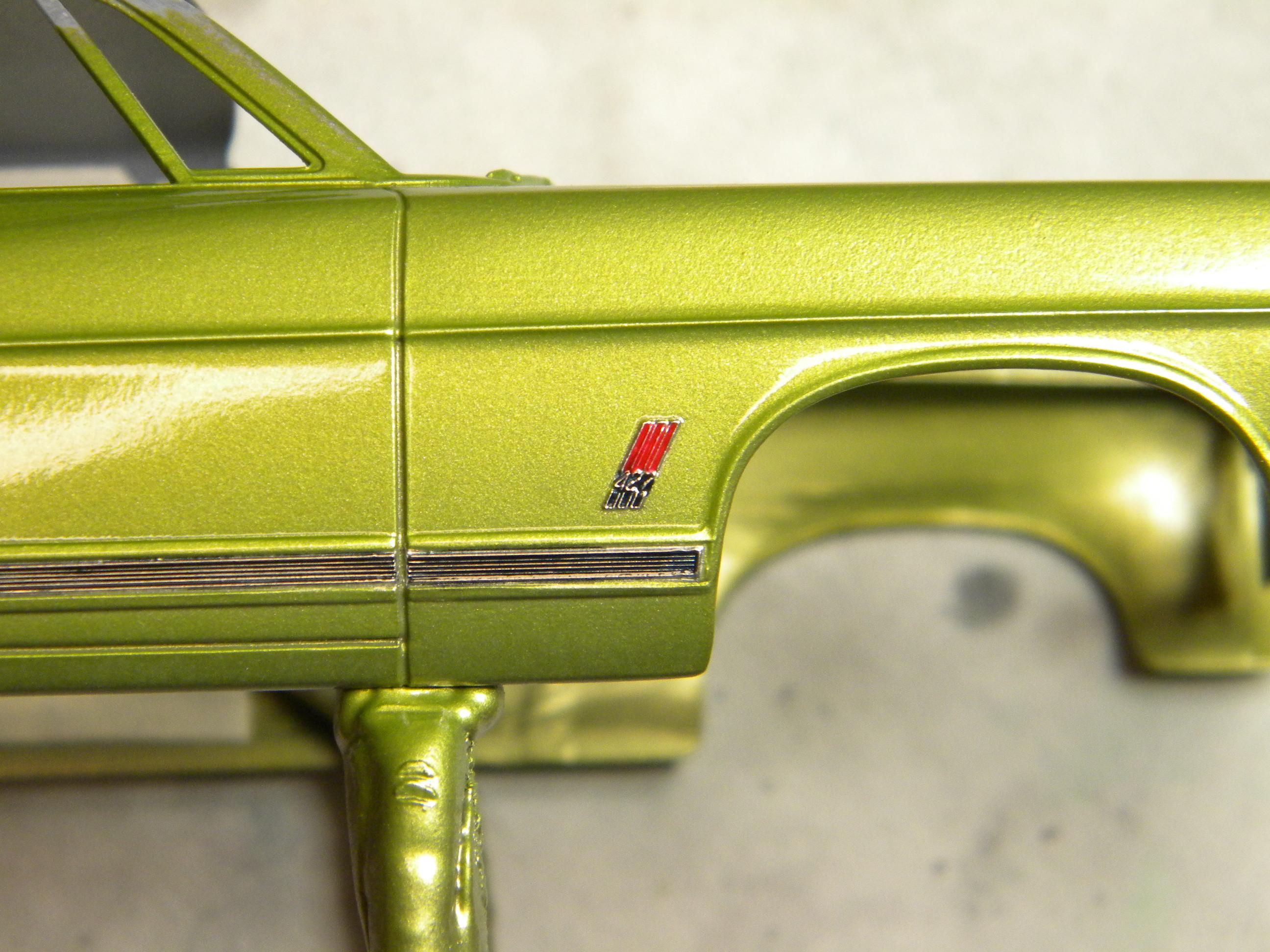

StevenGuthmiller Posted December 11, 2019 Posted December 11, 2019 (edited) 47 minutes ago, drodg said: Steve thanks for that. So I am also doing a black out on the hood so I was assume I would bare metal after I paint the main color before I black out the hood? If you look at this 1:1 picture of a 69 Roadrunner you will see the black out hood option offered on them. Absolutely! My biggest piece of advise is that even though you are painting over the foil, it is still highly recommended that you cut your foil as close to the script or badge as possible. Edges of the foil can be visible under the paint if you leave it too far away from the script you are finishing, especially when it only has a coat or 2 of paint over it. You might not need to worry about this as much if you apply the foil earlier in the paint process, but the less paint that you need to remove from the script, the better. The paint can then be removed from the script with very minimal effort with just a dab of lacquer thinner on a conical swab, and possibly a sharpened tooth pick dipped in lacquer thinner for the finer points. I have done it many different ways. Before and after primer, polishing or cleaning the script with thinner, and in my experience, this is by far the easiest way. Steve Edited December 11, 2019 by StevenGuthmiller

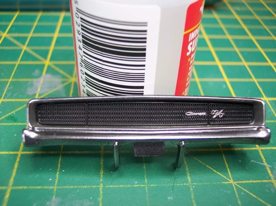

StevenGuthmiller Posted December 11, 2019 Posted December 11, 2019 33 minutes ago, mopargreg said: How does the Lacquer thinner not affect the paint around the script? Some of the script is very small. Using a small conical swab, and/or tooth pick, you only wipe over the surface of the script itself, not the surrounding area. Likewise, the amount of thinner you will be using is minuscule. I dip the swab in thinner and then roll it over a cloth to absorb the excess. The swab is just damp. But with so little paint over the script, it's more than enough to remove the paint. Here's another trick. get the swab damp with thinner and lightly go over the script. Then leave it alone for a few seconds. The thinner will loosen the paint and make it extremely easy to remove. Then I take my sharpened tooth pick, dip it in thinner and use it to carefully scrape and remove the paint. Works like a charm. You don't get much smaller script size than the "H" on the Chrysler 300 H above. Steve
