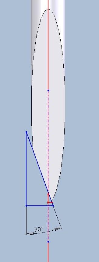

Flat32 Posted December 15, 2019 Share Posted December 15, 2019 This drill is a serious tool for making holes. But you don't need a bunch of drill bits to make holes. In fact if you need a very accurate sized hole to fit a certain size of pin or wire you can make a very simple hole poking bit. The design of the bit has the added benefit of being able to place the hole accurately by virtue of it's sharp tip. With it you can "feel" a scribed guideline. The point sharpness also makes it easier to poke a hole that is not perpendicular to the surface. The bit will produce a push fit through hole in wood or plastic, but can be easily "adjusted" to produce a controlled looser fit. The speed of the Tamiya makes this possible. Grind to shape shown. Technically it will be something like the pics. Actually you can eyeball it fairly easily and be off a couple degrees. Example photo is .028" diameter straight pins through a plastic tube using a same size straight pin as the bit. Quote Link to comment Share on other sites More sharing options...
