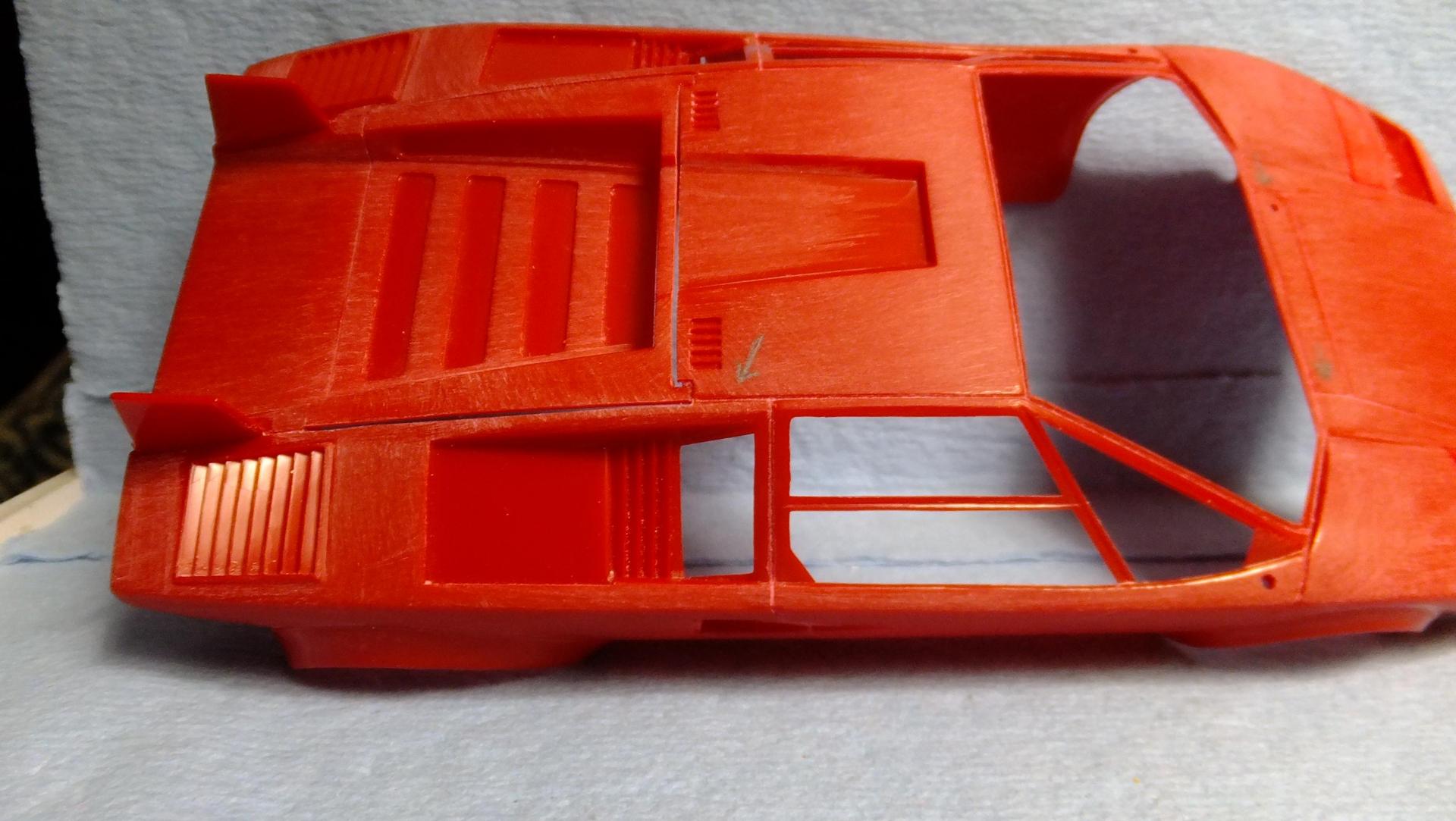

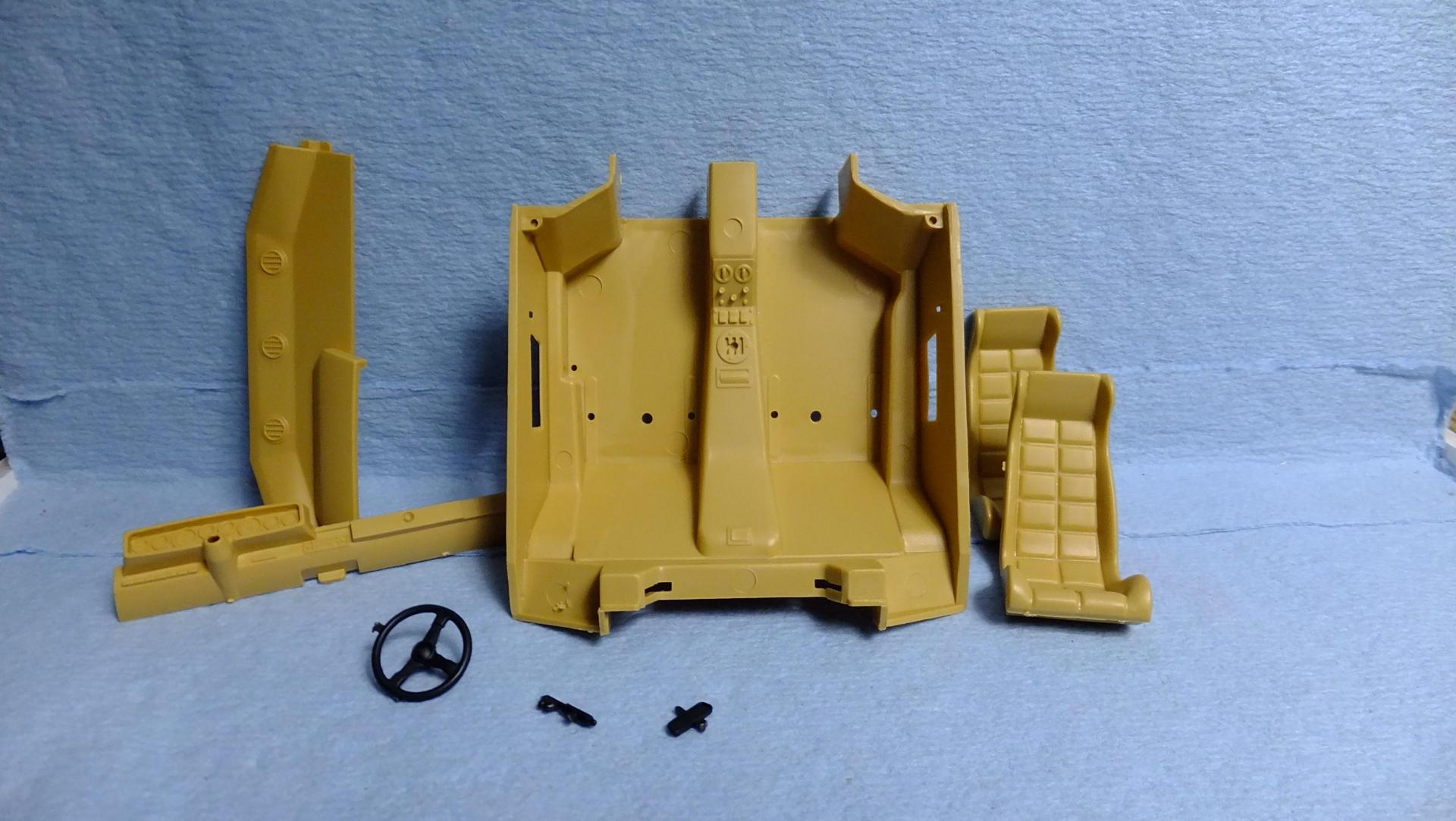

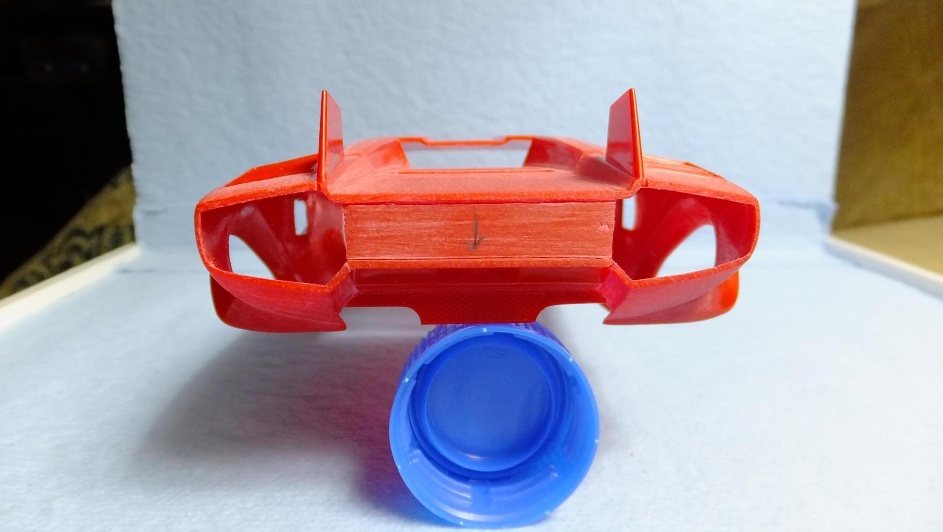

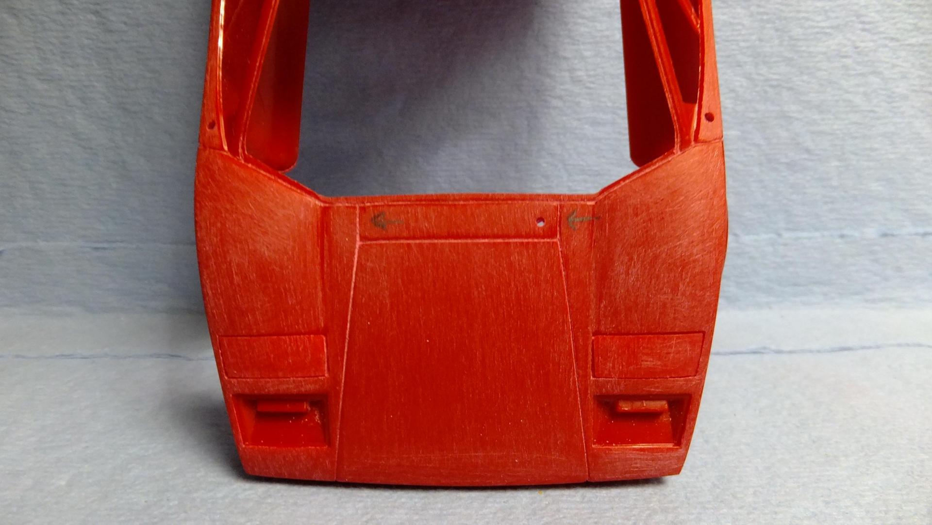

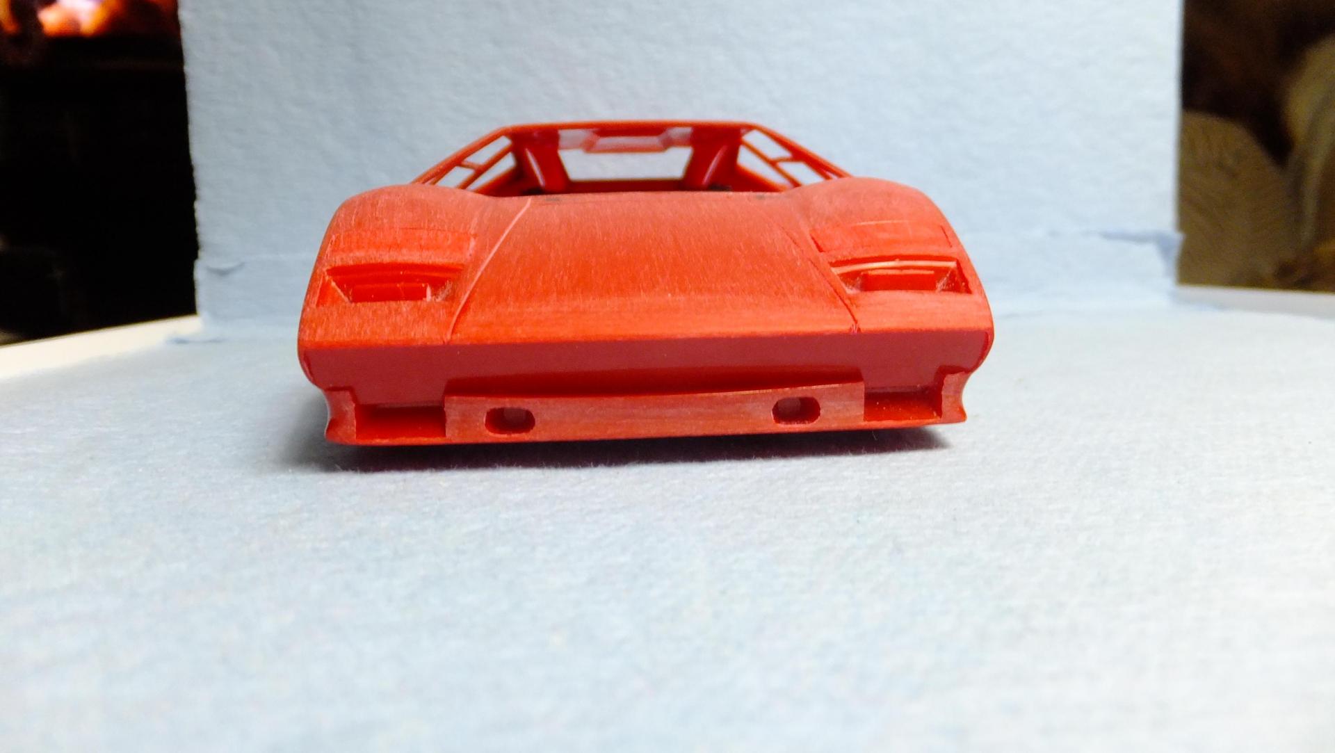

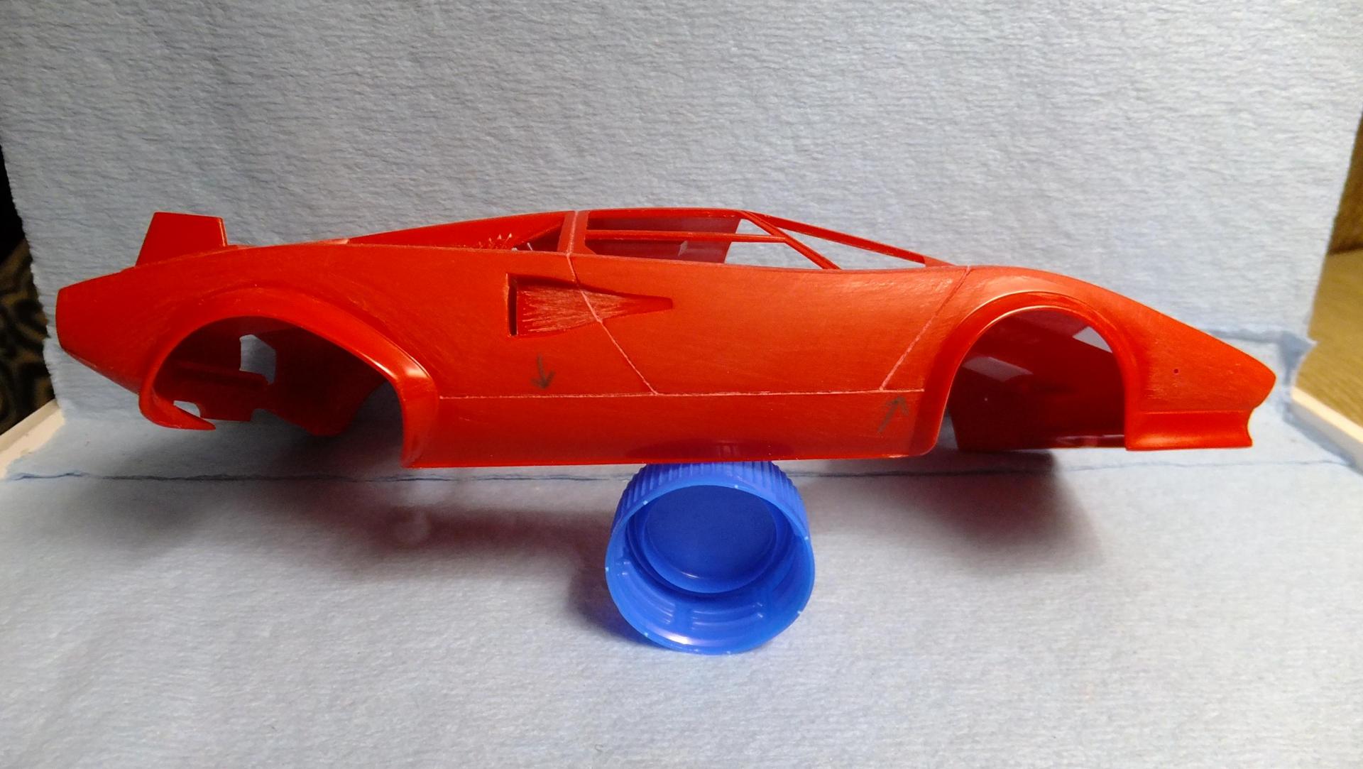

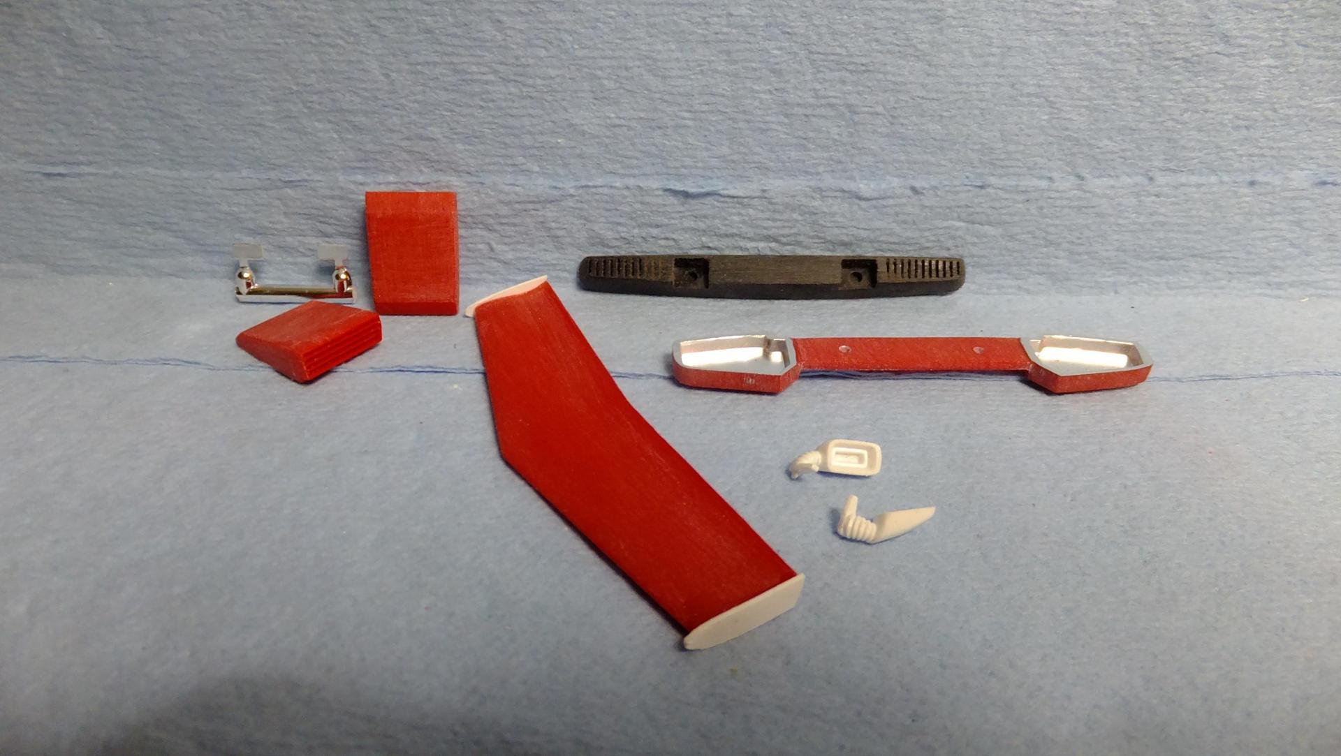

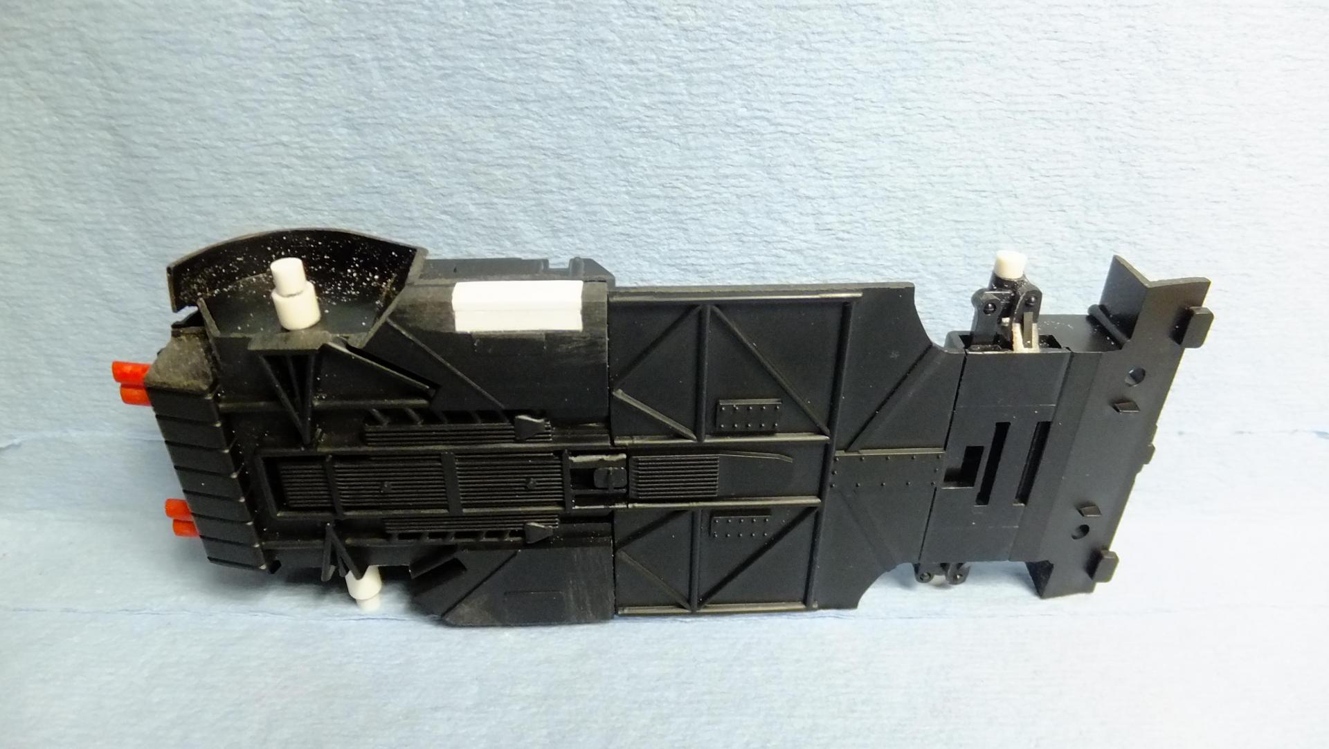

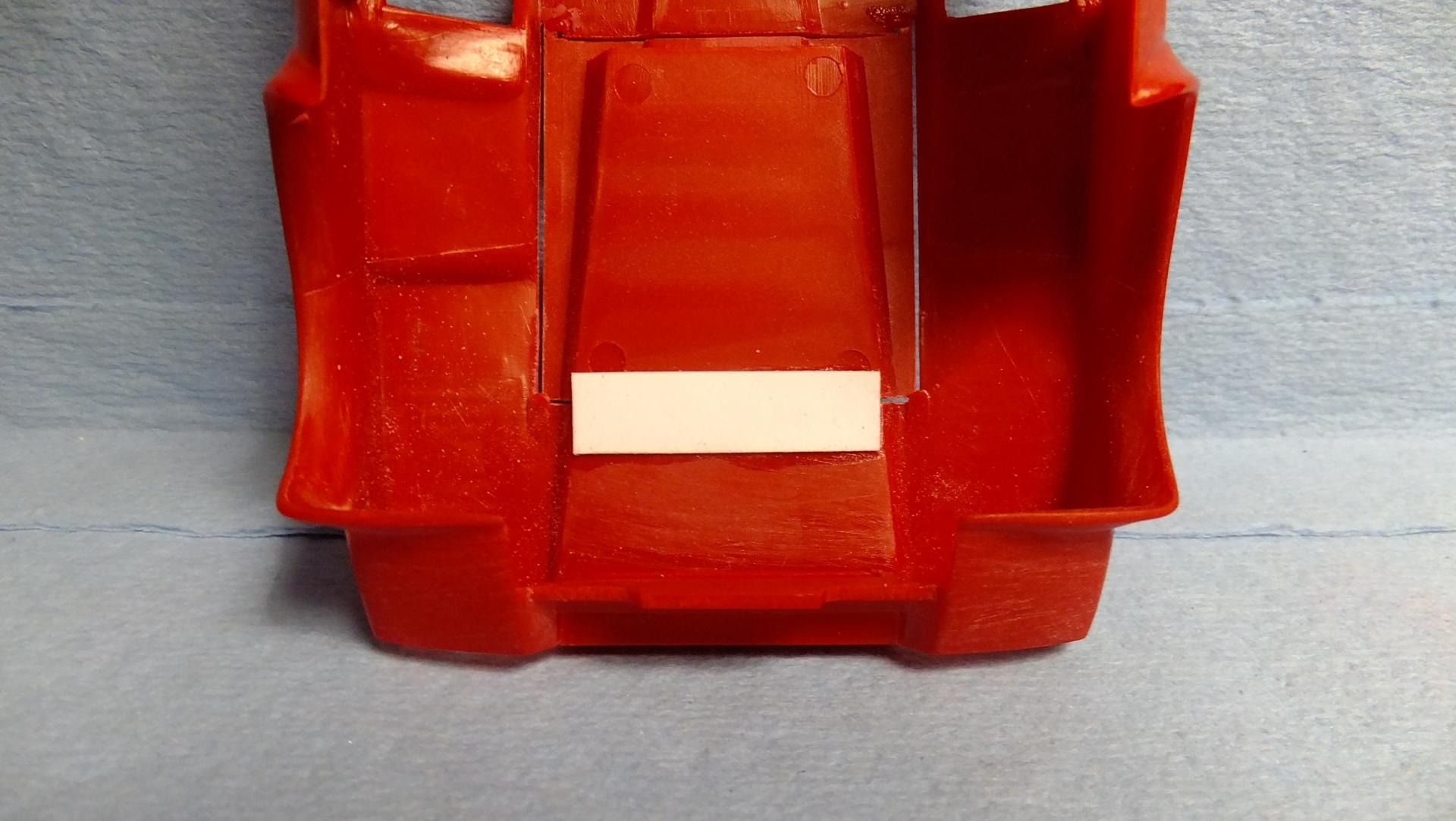

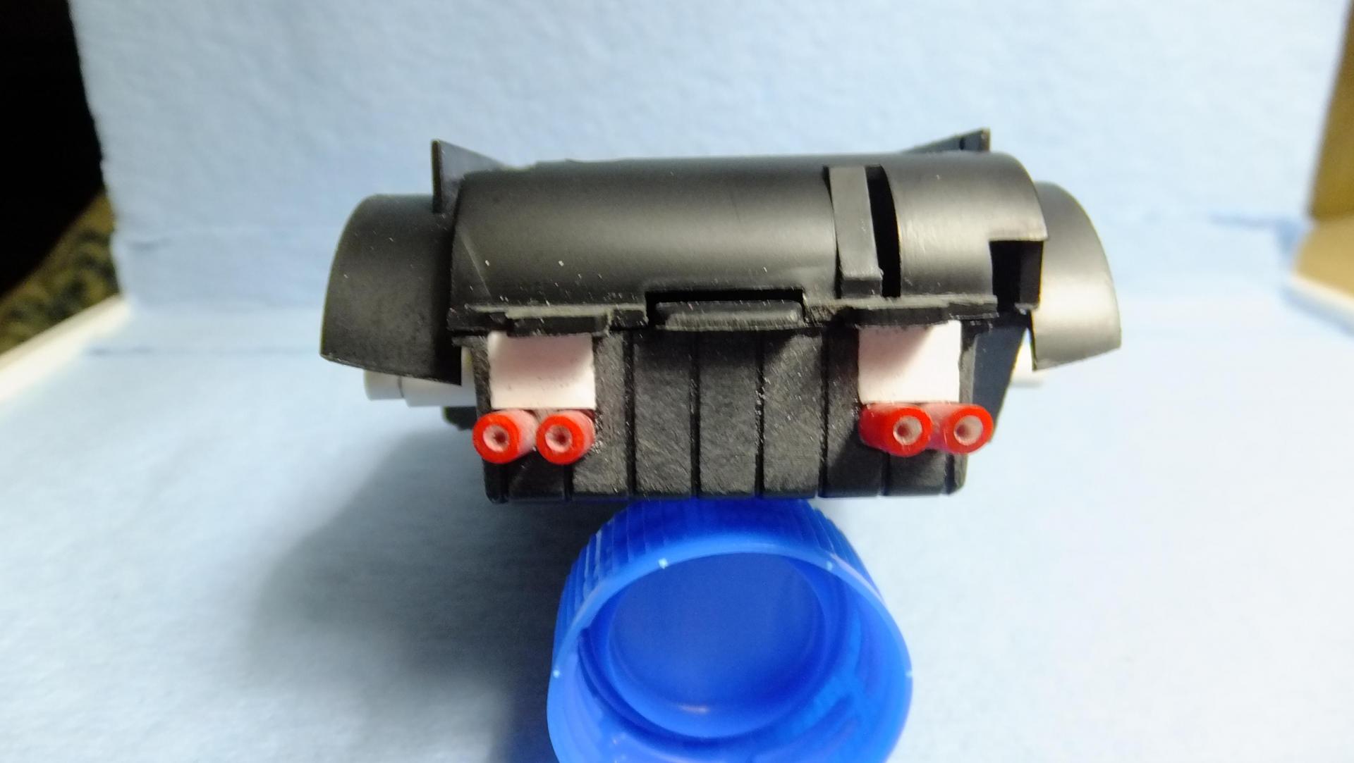

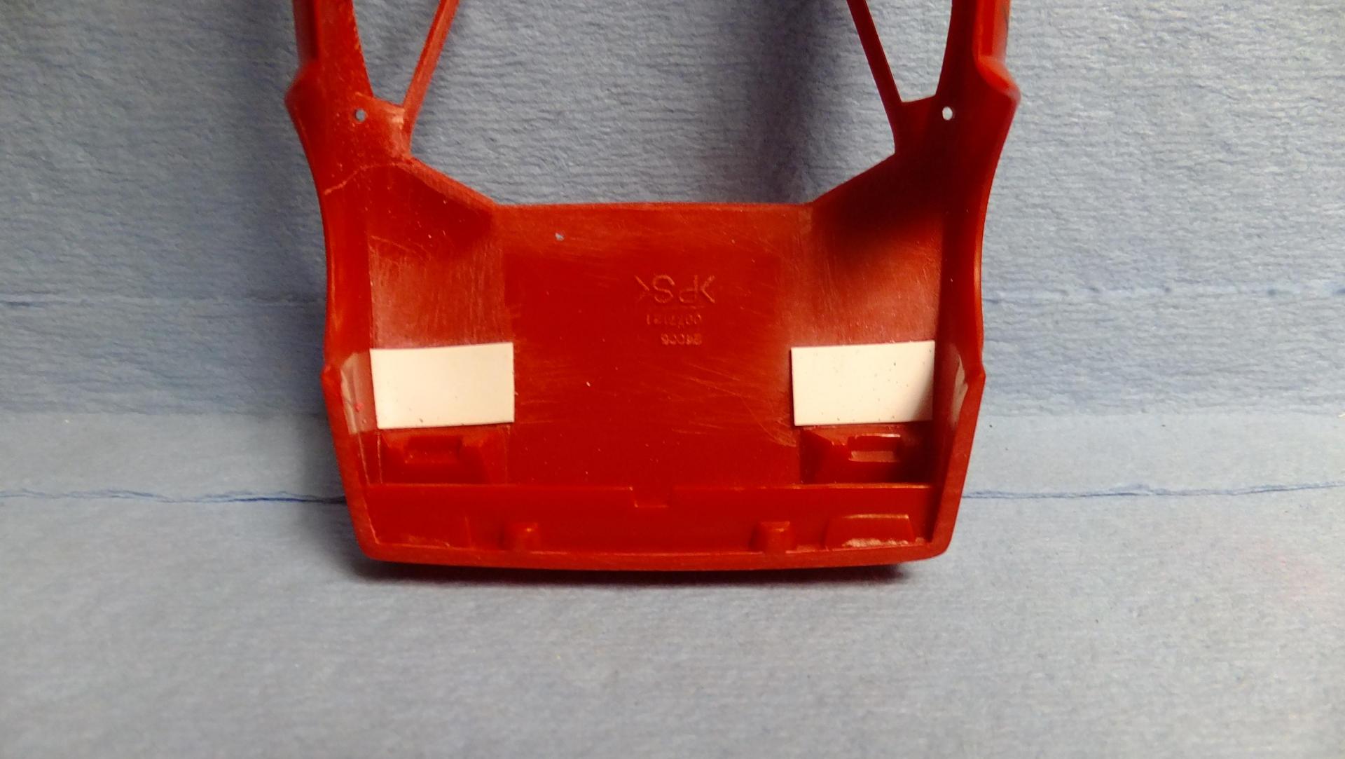

Dann Tier Posted December 12, 2019 Share Posted December 12, 2019 (edited) Hey, everyone!, its me again. I've decided that i will be posting WIPs on more of my started projects...hopefully it will motivate me to finally finish them. Who knows, it may even help someone whose working on one now. My objective for this kit was to just make it look a bit more realistic without having to spend too much extra money. Its actually a pretty decent representation of the actual car, and despite the kits age, it fits together well...is fun to build, and looks great when done! There are a few body style changes i made already.....basically an easier, fun build. Dont know how these photos got all mixed up, but here we go... -Photo 1, 5-7; I'm not sure how many people re-scribe every seam the same, but not all seams should be the same depth. For instance; the arrows are pointing to lines that should be shallow, since they are only body panels that dont open. Things like doors...bonnets...and boots need to be scribed deeper to show a deeper shadow insinuating space. -Photo 2; The kit -Photo 3&4; These photos show my kolor choices for this build. -Photo 8; Since i never intended to show the engine, i glued the hood shut, and needed to use styrene for extra contact. -Photo 9; The Headlamp housings dont have enough contact to be level in the closed position -in the up position they work fine. Since i wanted them down, i cut the box away, added sheet styrene to the under side , then reattached the covers centered in the openings. -Photo 10; I glued together the two-part vent boxes, sanded off the molded in front license plate, and began to SB end caps on the wing. Since i didnt like the mirrors that came with the kit, i took some spare ones from an Aoshima Countach kit. -Photo 11; I glued in the exhaust pipes, and used styrene to fill in the unrealistic openings above them. -Photo 12; Here i filled in the remote control switch, and since i wanted to use a newer version wheel from an Aoshima kit, i had to styrene rods that will fit into the backs of the wheels. -Photo 13; Here are the interior bits i am starting with. Edited December 12, 2019 by Dann Tier Quote Link to comment Share on other sites More sharing options...

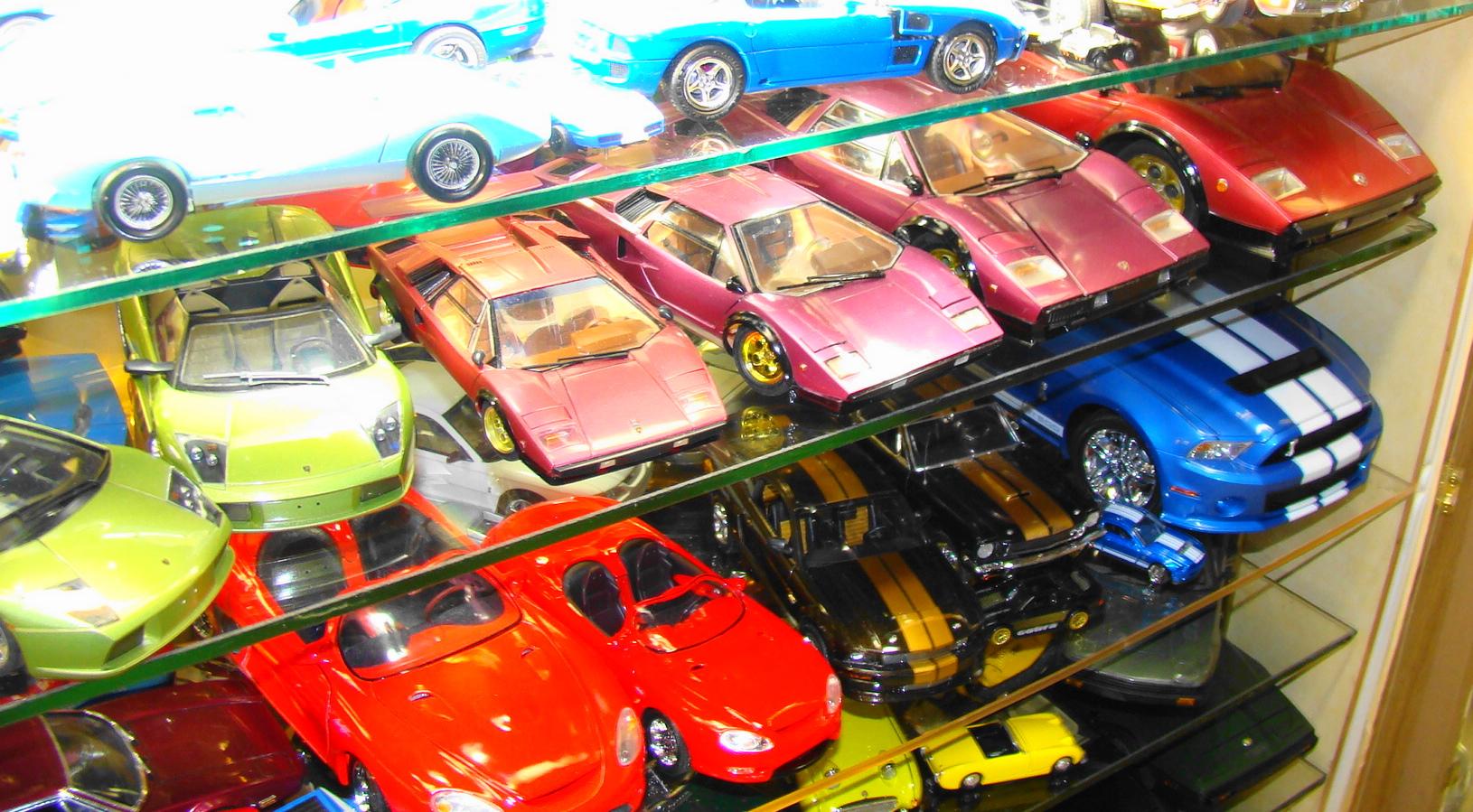

Rich Chernosky Posted December 14, 2019 Share Posted December 14, 2019 Dann...another veiw of the Lamborghini shelf. This time the Countach's. The Tamiya kit is in there somewhere. I did it when it first came out. Its kinda cool having the same model in 4 different scales. Quote Link to comment Share on other sites More sharing options...

Dann Tier Posted December 14, 2019 Author Share Posted December 14, 2019 9 hours ago, Rich Chernosky said: Dann...another veiw of the Lamborghini shelf. This time the Countach's. The Tamiya kit is in there somewhere. I did it when it first came out. Its kinda cool having the same model in 4 different scales. They look AWESOME, bud!!!!...is that a Ggoldstrand Corvette above them?! Quote Link to comment Share on other sites More sharing options...
Rich Chernosky Posted December 14, 2019 Share Posted December 14, 2019 6 hours ago, Dann Tier said: They look AWESOME, bud!!!!...is that a Ggoldstrand Corvette above them?! It sure is...you have a keen eye despite the glare. There is an entire shelf dedicated to Vettes above the Lambos (about 50 of em although I have more on another shelf) and below is the Mustang shelf (also about 50+) I believe the first Lambo in line is the Tamiya. The rest are 1/20, 1/16, 1/12 Quote Link to comment Share on other sites More sharing options...

Dann Tier Posted December 14, 2019 Author Share Posted December 14, 2019 5 hours ago, Rich Chernosky said: It sure is...you have a keen eye despite the glare. There is an entire shelf dedicated to Vettes above the Lambos (about 50 of em although I have more on another shelf) and below is the Mustang shelf (also about 50+) I believe the first Lambo in line is the Tamiya. The rest are 1/20, 1/16, 1/12 You've got a Great collection there, bud!!.......how did you like that Guldstrand kit? Quote Link to comment Share on other sites More sharing options...

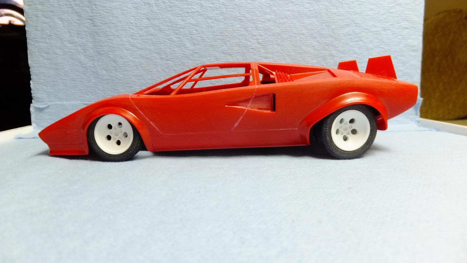

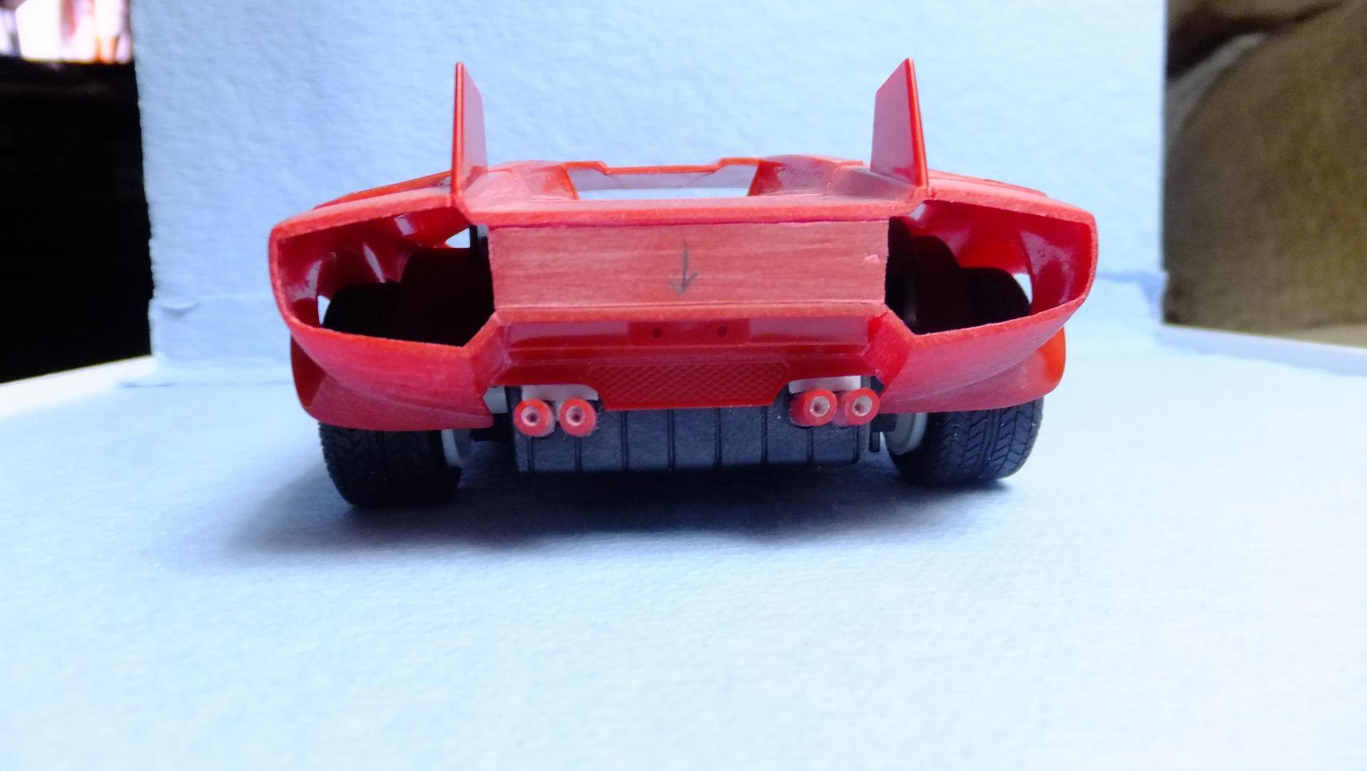

Dann Tier Posted December 16, 2019 Author Share Posted December 16, 2019 Here are the wheels and tyres that i will be using...Wheels are from an Aoshima Countach, and the tyres are from a Fujimi Countach. Looks like i need to raise the front end a bit though. Quote Link to comment Share on other sites More sharing options...

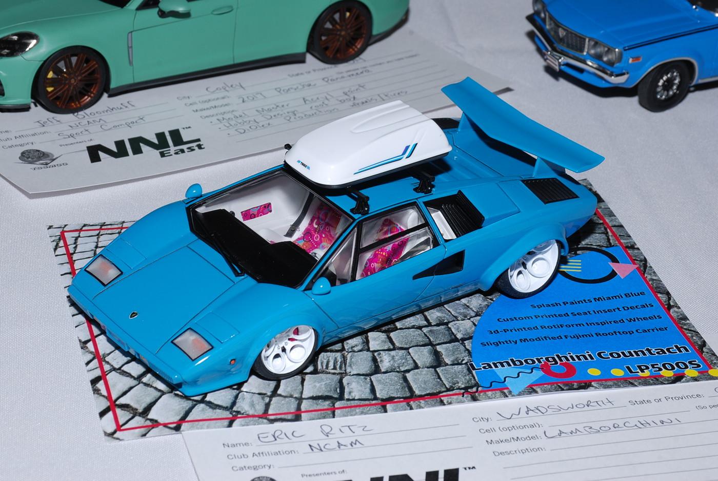

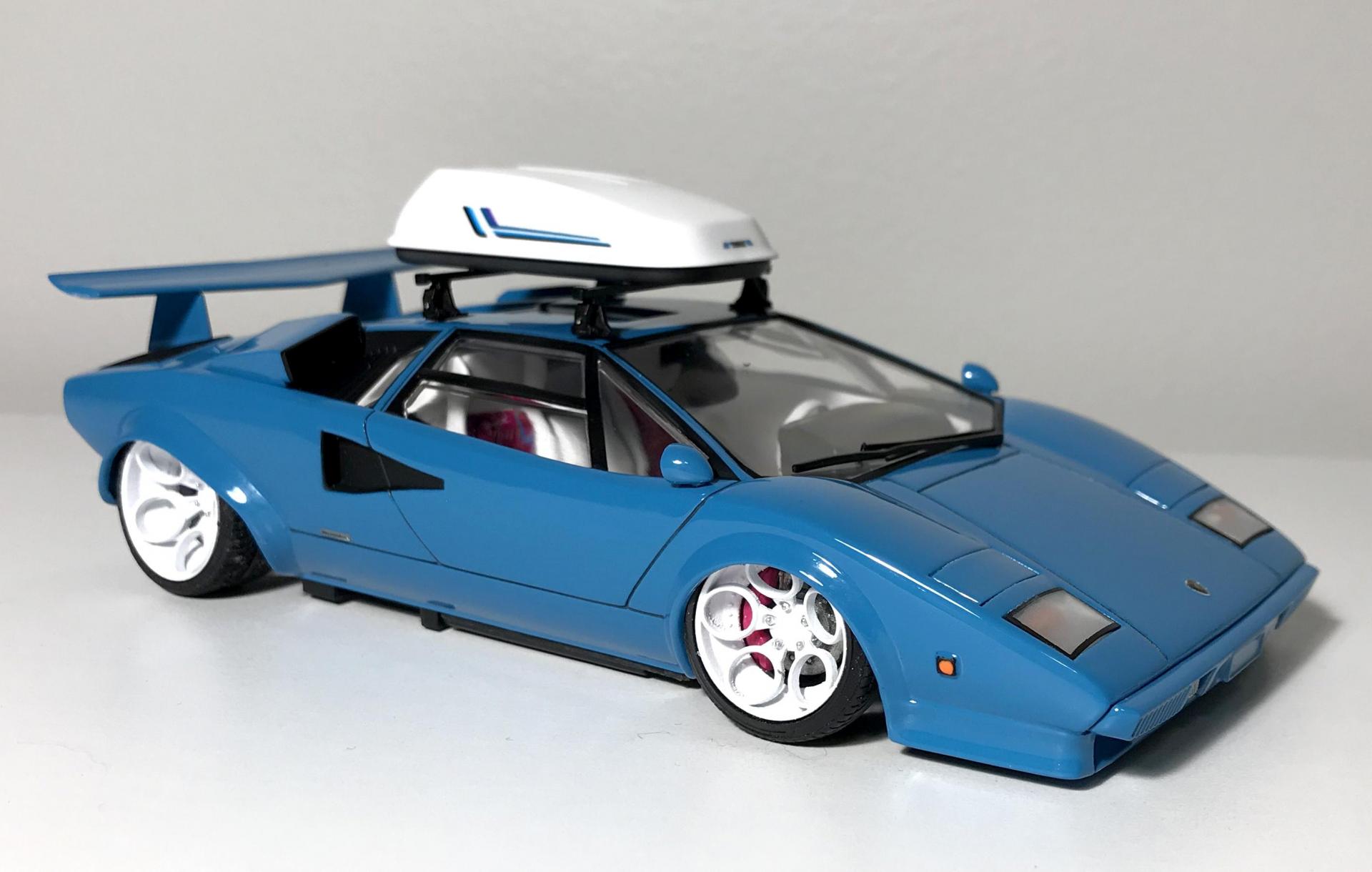

Impalow Posted December 17, 2019 Share Posted December 17, 2019 Excited to see what you do with this one Dann! I built that kit last year and it made for a fun quick curbside project! Quote Link to comment Share on other sites More sharing options...
Dann Tier Posted December 17, 2019 Author Share Posted December 17, 2019 7 minutes ago, Impalow said: Excited to see what you do with this one Dann! I built that kit last year and it made for a fun quick curbside project! Thanks, bud!!.....it is a pretty fun kit.....any photos of yours?!! Quote Link to comment Share on other sites More sharing options...

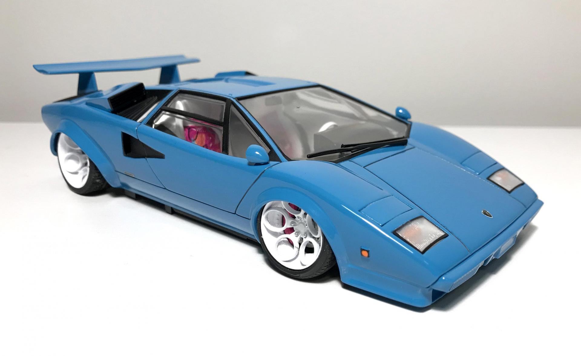

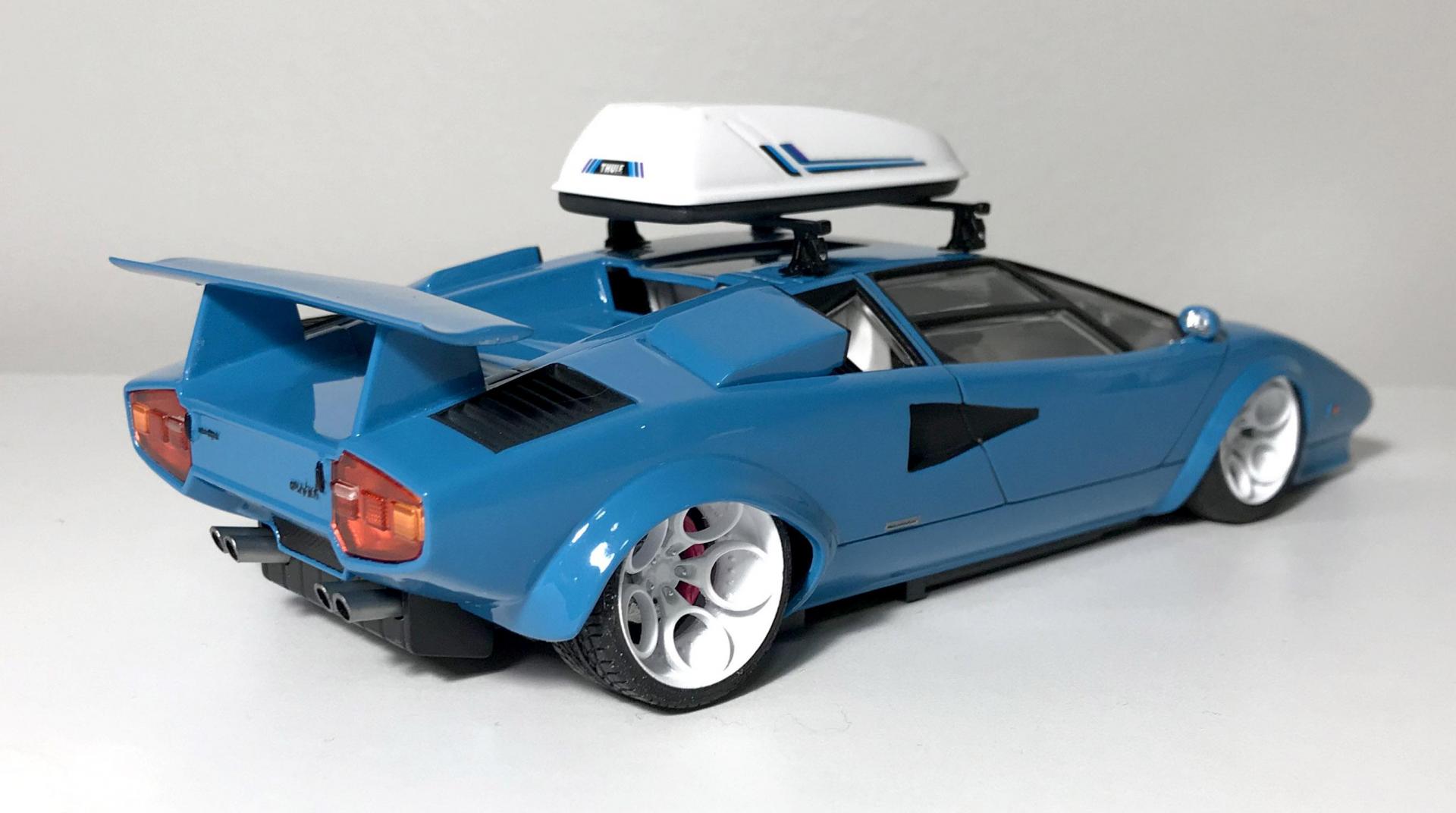

Impalow Posted December 17, 2019 Share Posted December 17, 2019 Oh i have a couple.... I did weird things with mine.. as usual. haha Quote Link to comment Share on other sites More sharing options...
Dann Tier Posted December 17, 2019 Author Share Posted December 17, 2019 35 minutes ago, Impalow said: Oh i have a couple.... I did weird things with mine.. as usual. haha Thats right!!!....i remember now!!....freaking sweet!!!......LOVE those wheels!!!! Quote Link to comment Share on other sites More sharing options...
