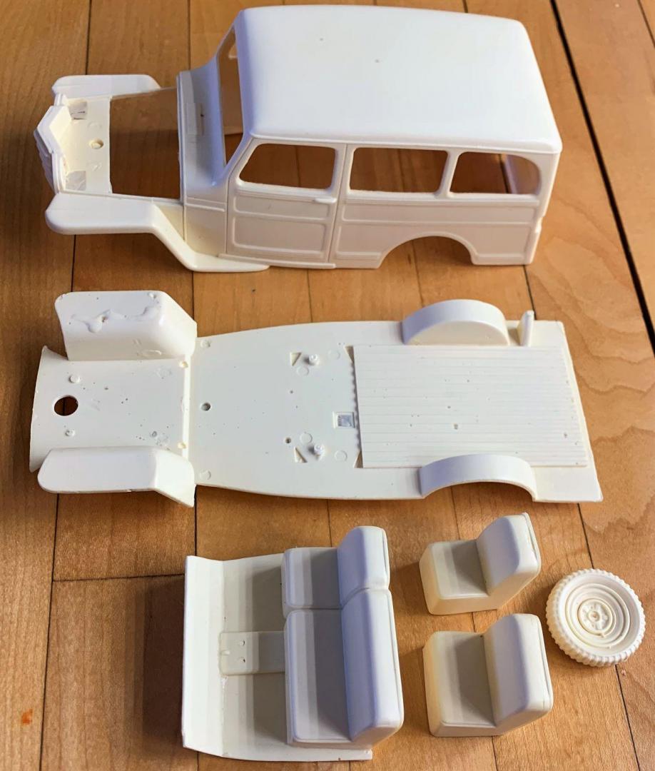

dino246gt Posted December 16, 2019 Share Posted December 16, 2019 Here's all the resin pieces I got from Frank, a partial All American Models 1952 Willys wagon, in 1/25th scale, something I always wanted to build. Quote Link to comment Share on other sites More sharing options...

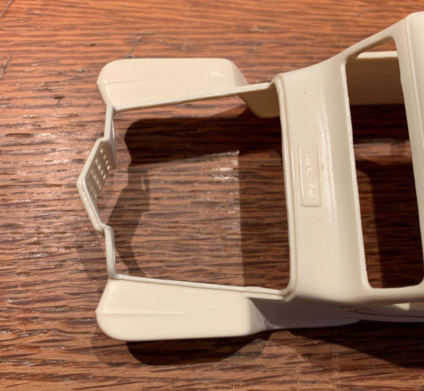

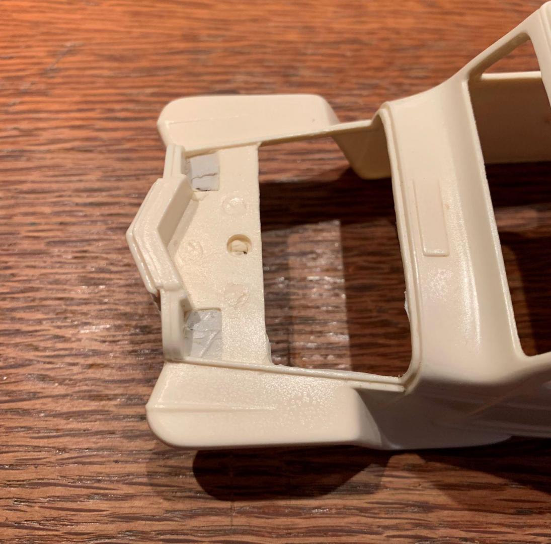

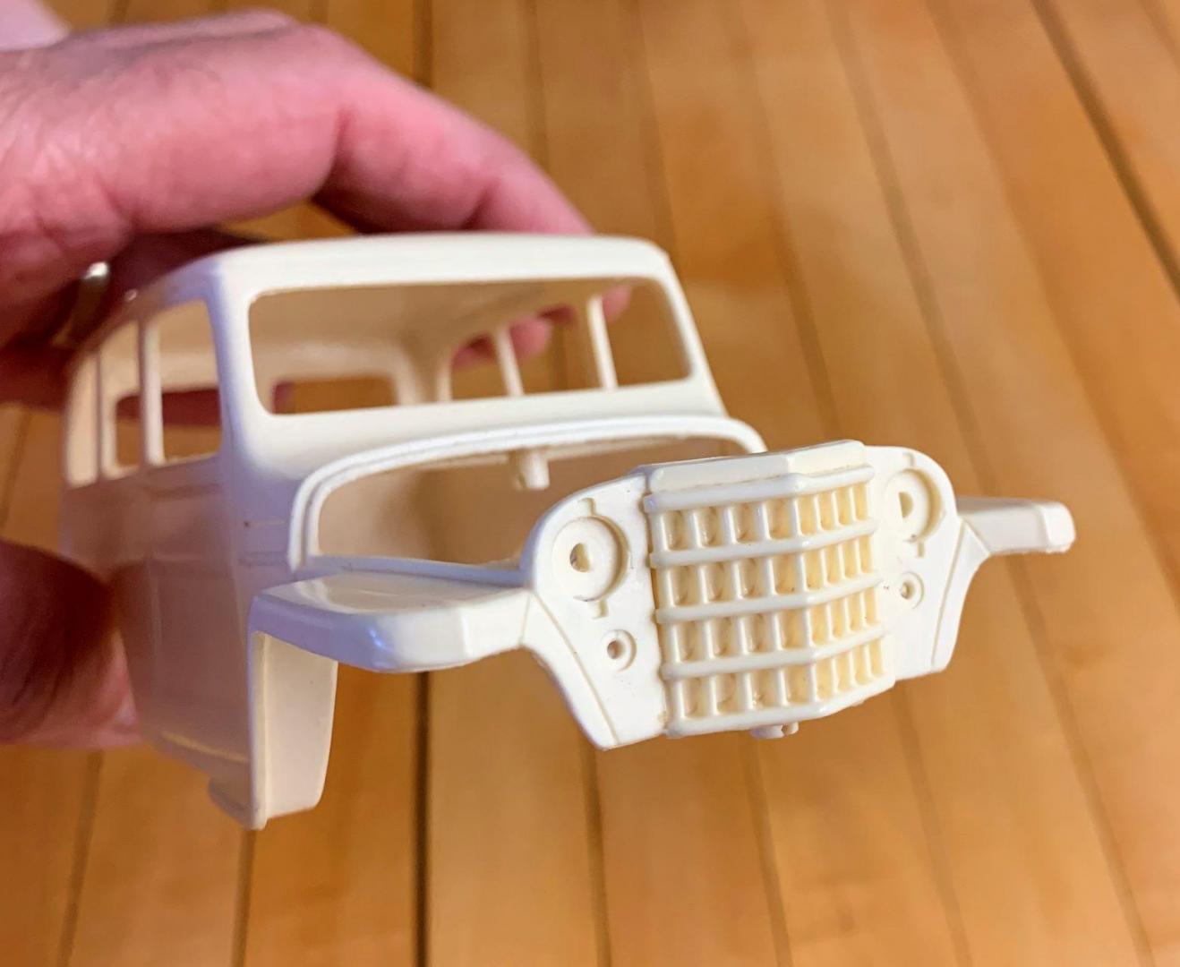

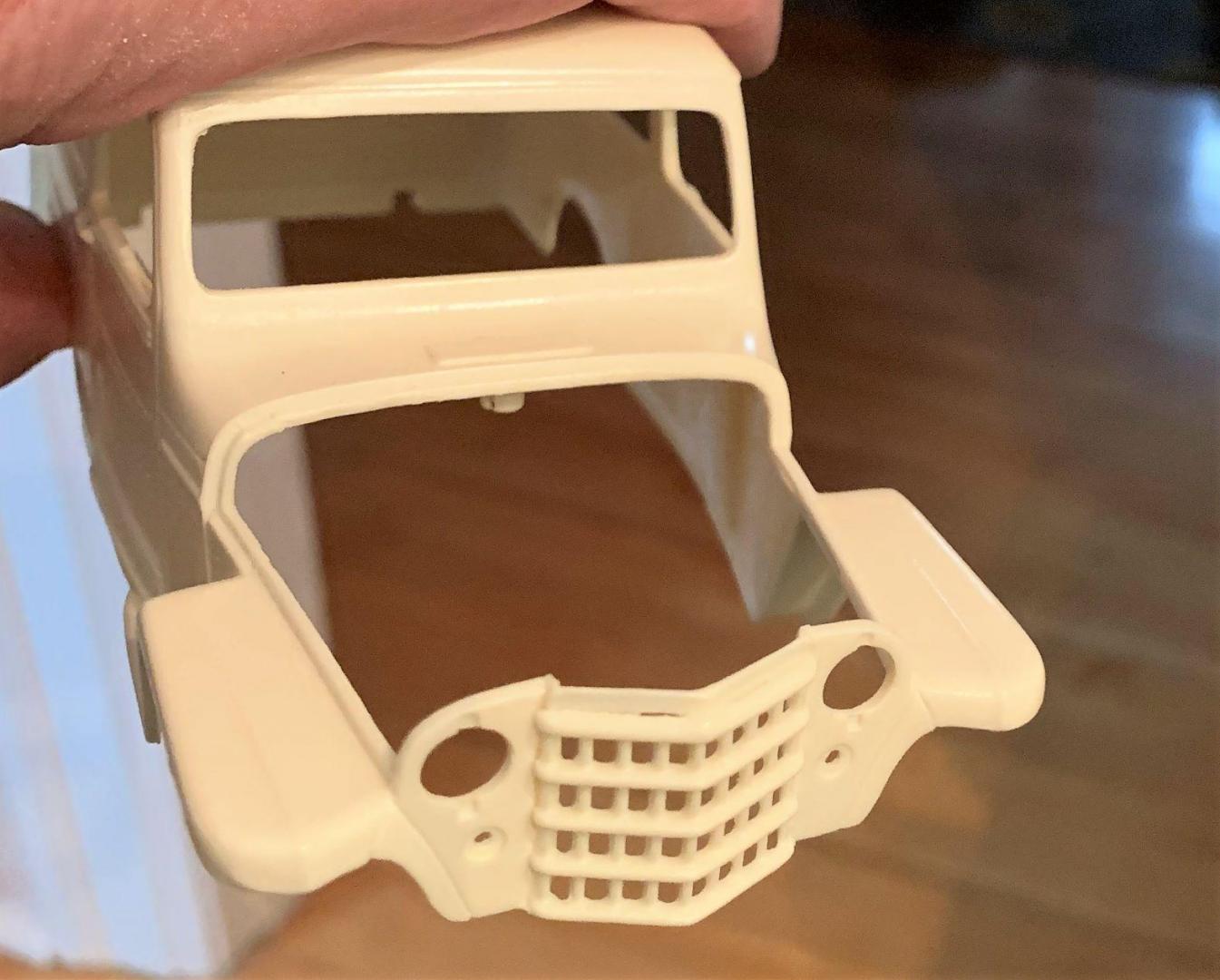

dino246gt Posted December 16, 2019 Author Share Posted December 16, 2019 First I had to remove a lot of resin from the engine bay, and open up the grille and headlights. Quote Link to comment Share on other sites More sharing options...

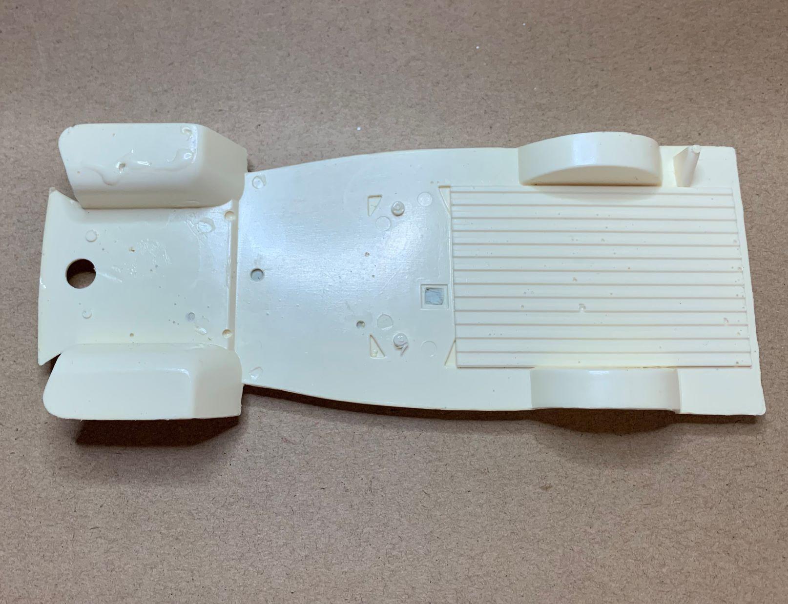

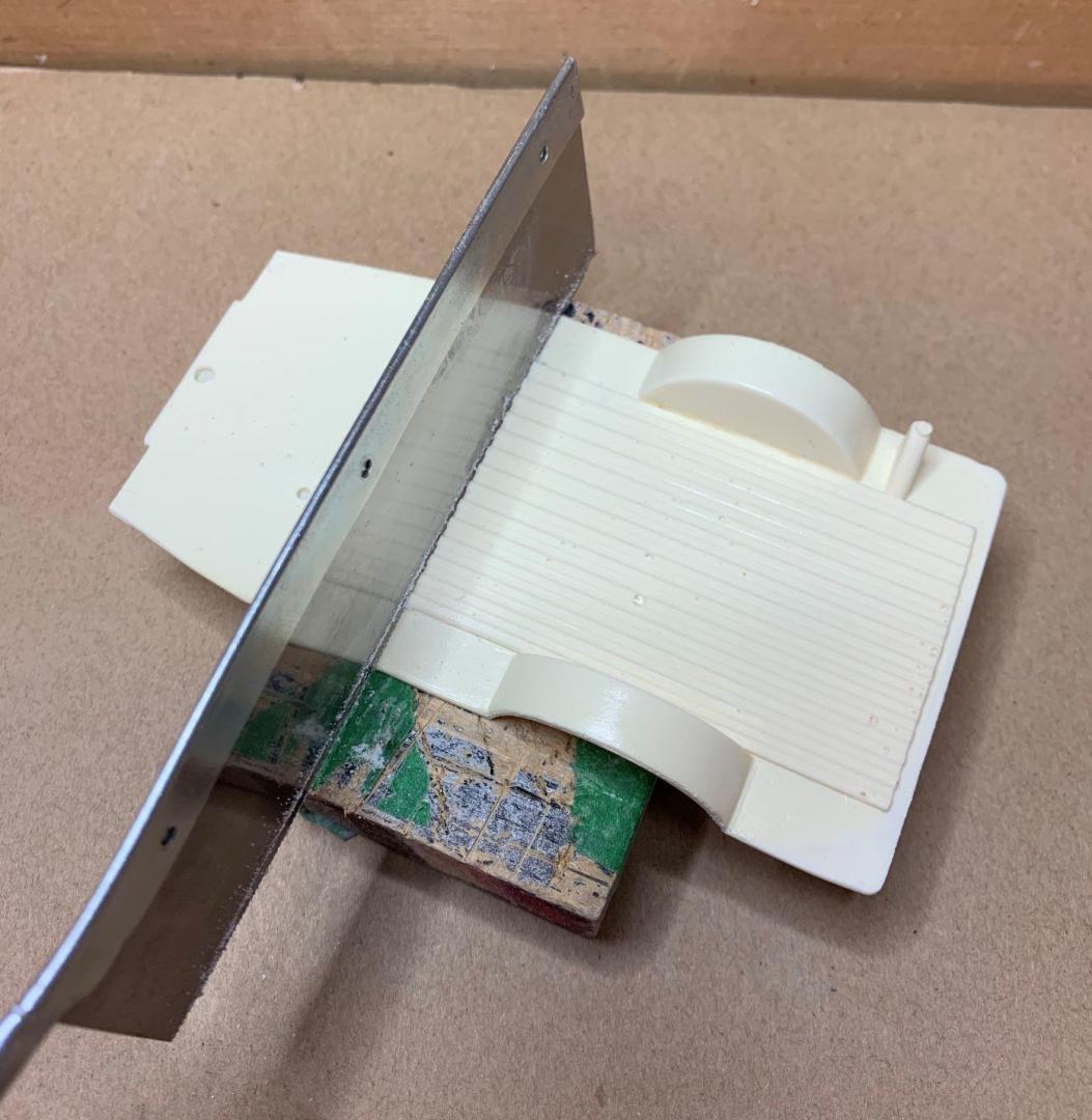

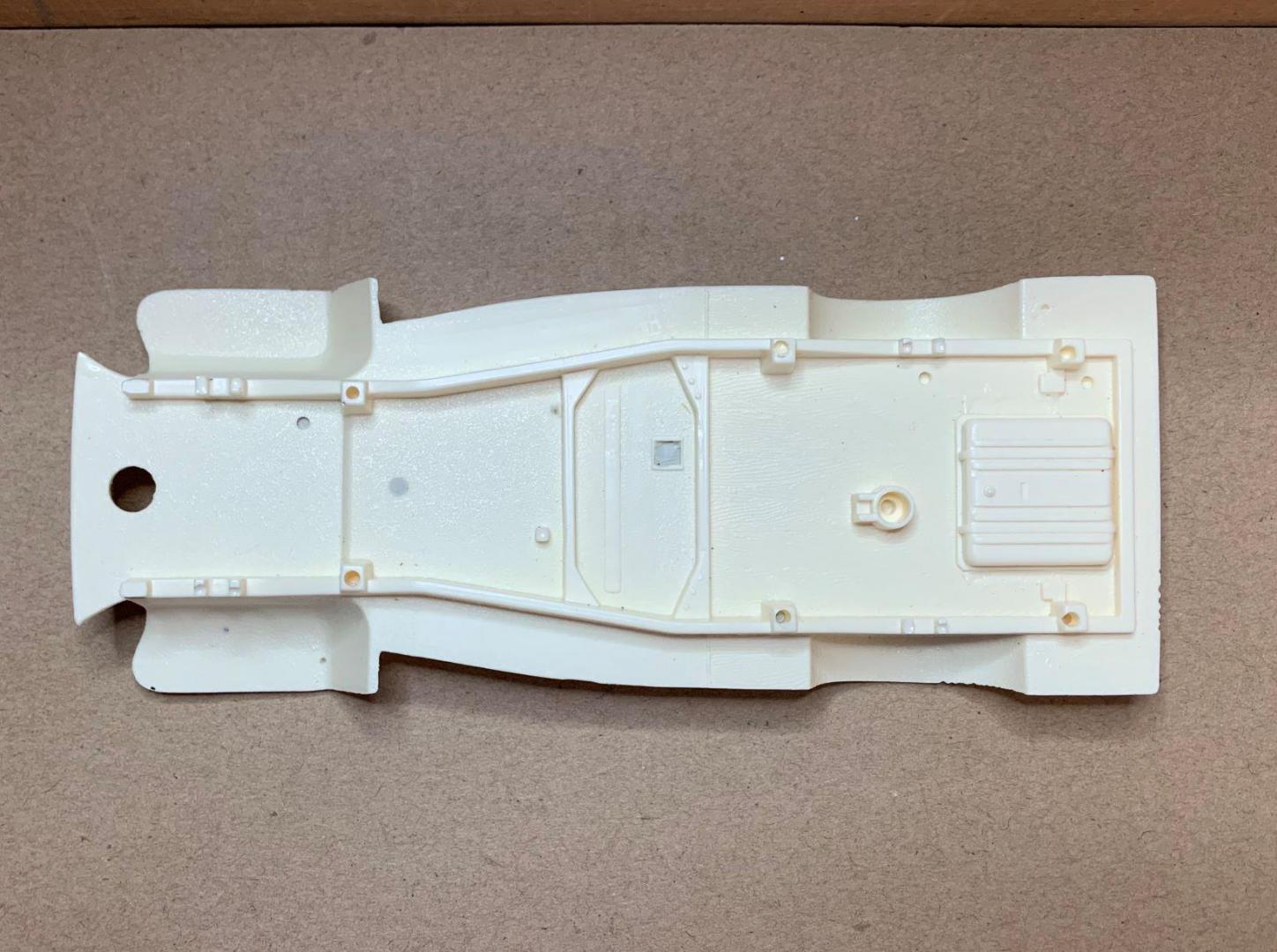

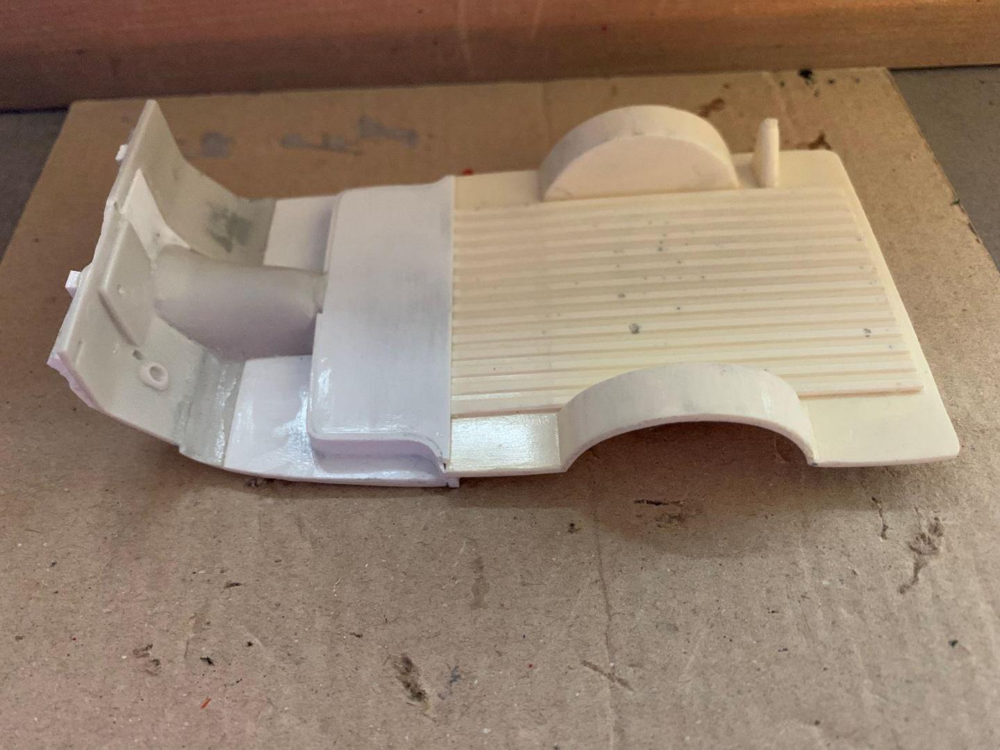

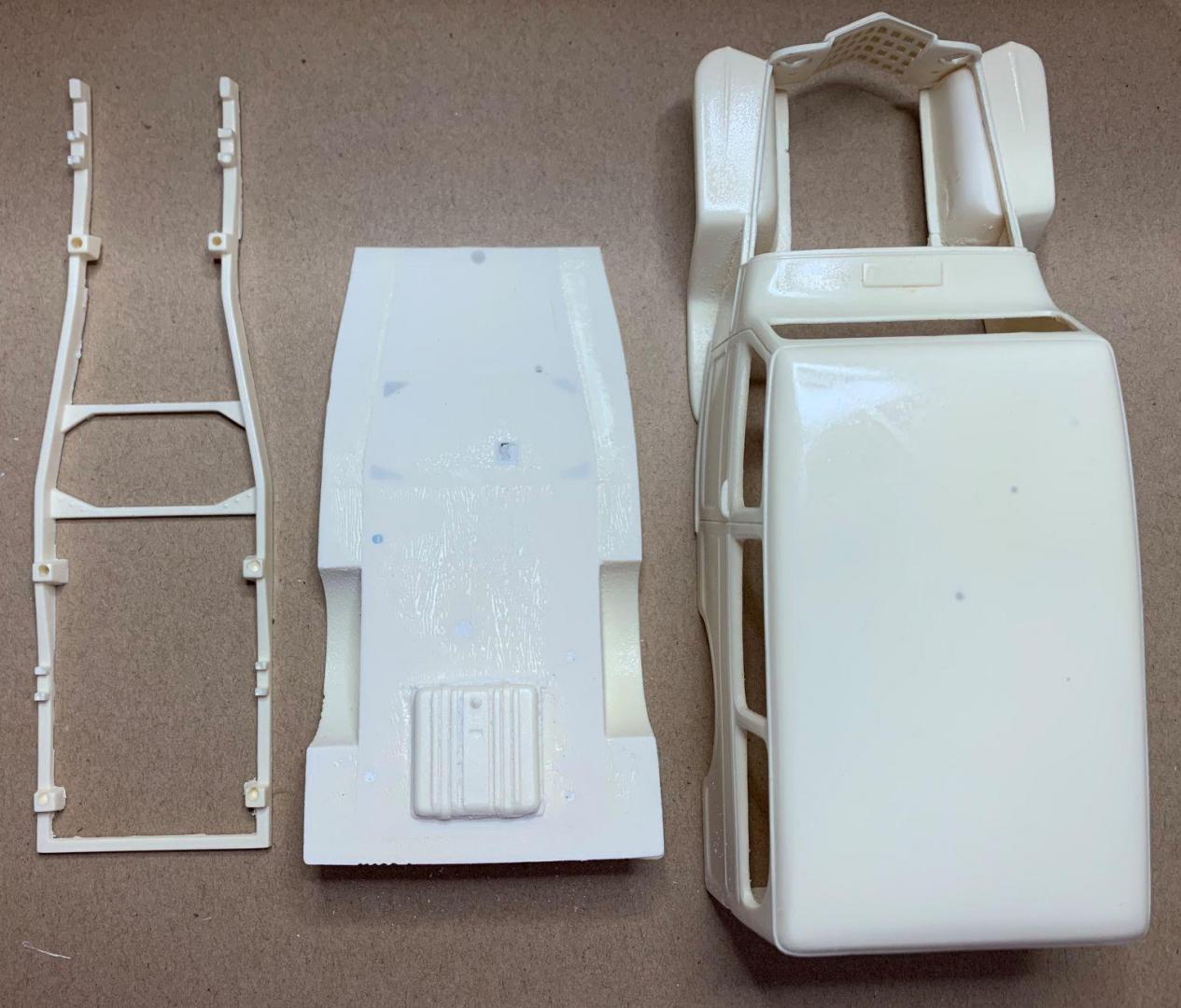

dino246gt Posted December 16, 2019 Author Share Posted December 16, 2019 The floor pan includes somewhat of a frame, but that had to go, so did the area where an engine will reside, and the front seat area should be lower, so it had to go as well. Once I had the floor cut up, I separated the inner front fenders and attached those to the body. Quote Link to comment Share on other sites More sharing options...

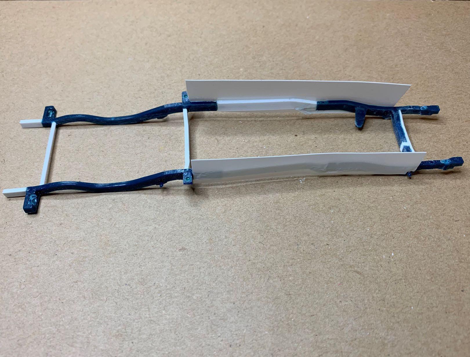

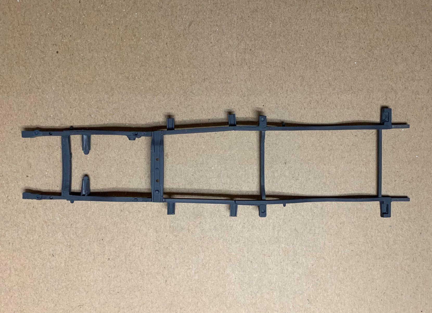

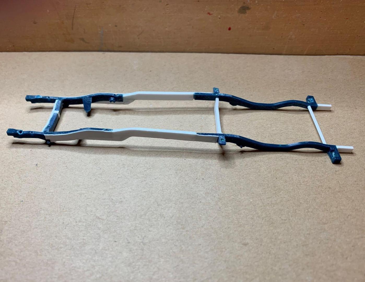

dino246gt Posted December 19, 2019 Author Share Posted December 19, 2019 I stared making a basic frame from a Jeepster and some styrene, tried something for the first time, very thin styrene to cover the joints, seemed to work okay. Quote Link to comment Share on other sites More sharing options...

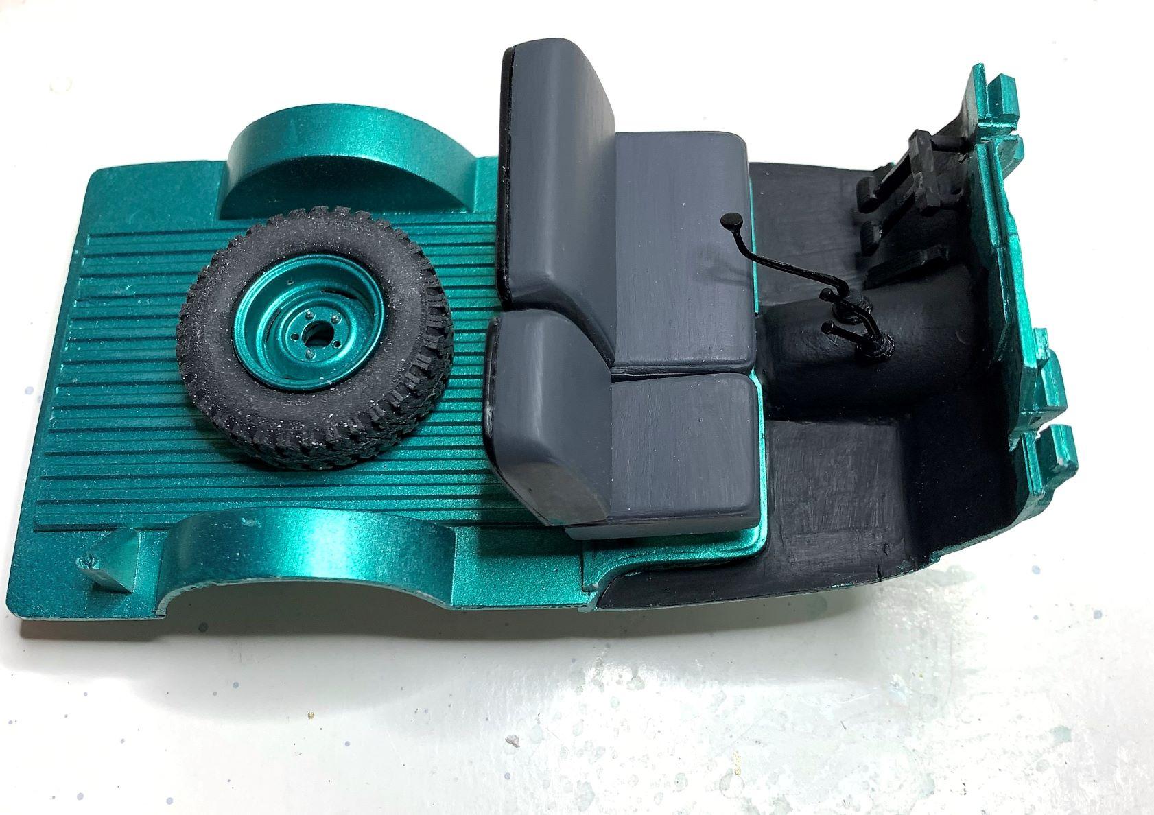

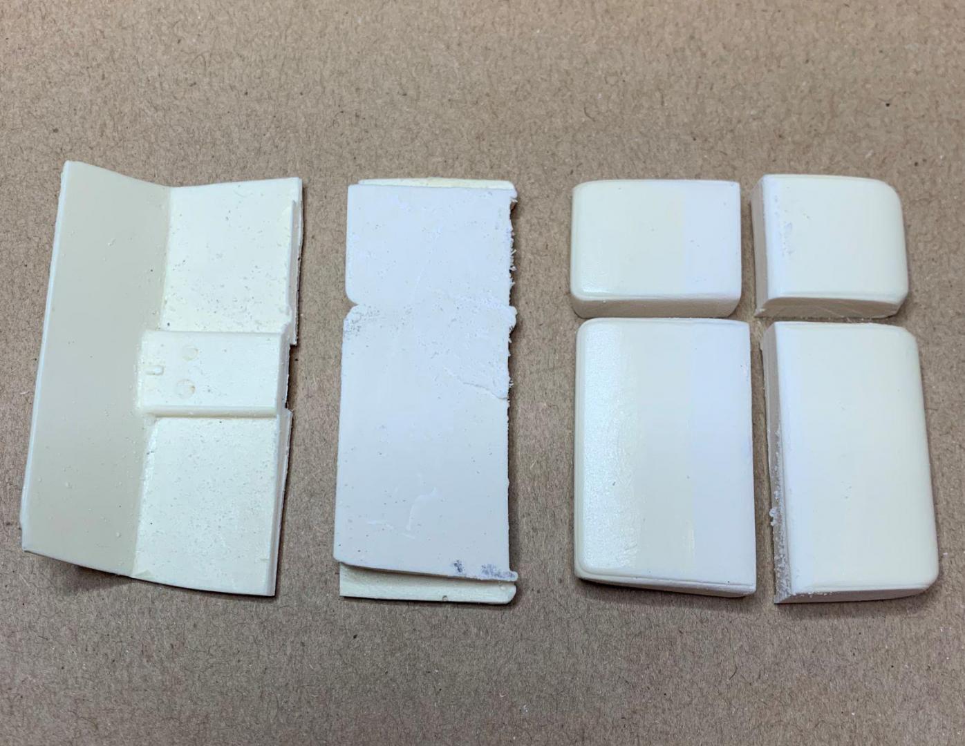

dino246gt Posted December 19, 2019 Author Share Posted December 19, 2019 I cut the seat off, and cut it into pieces, kept the front floor but made a new section for under the seat, more correct with lower part that the door opens into. On the real ones there are tool boxes built into that recess under the seat, opening out and only accessible when the doors are open. Made up a couple of shifter, transmission, and one for 2WD-4WD, and one for Hi-Lo range transfercase, a couple of pedals, and the spare wheel and tire. That seat looks way cooler now too, Tamiya Greman grey! Body color is Duplicolor, the closest I could find to an original color, it's green but with some blue tint. Quote Link to comment Share on other sites More sharing options...

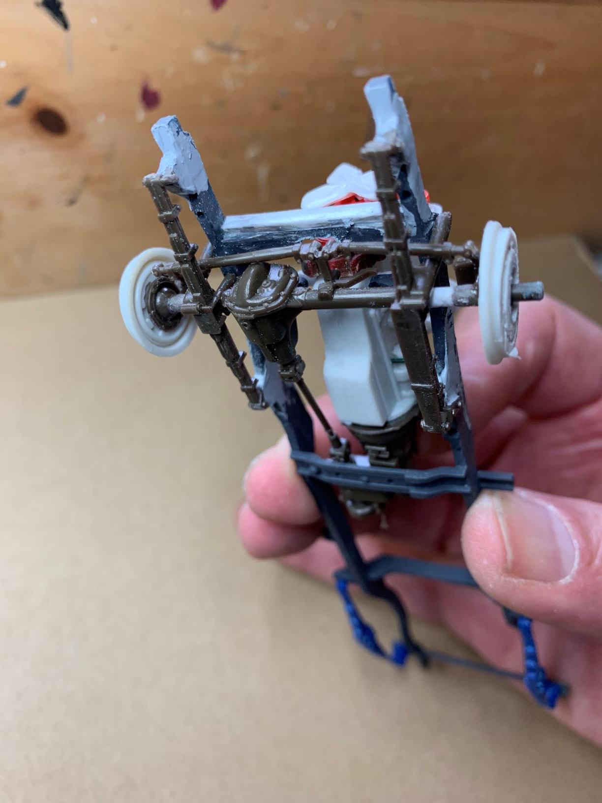

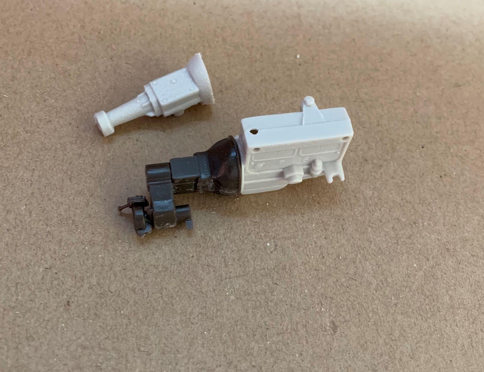

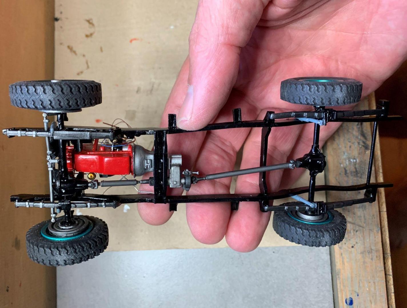

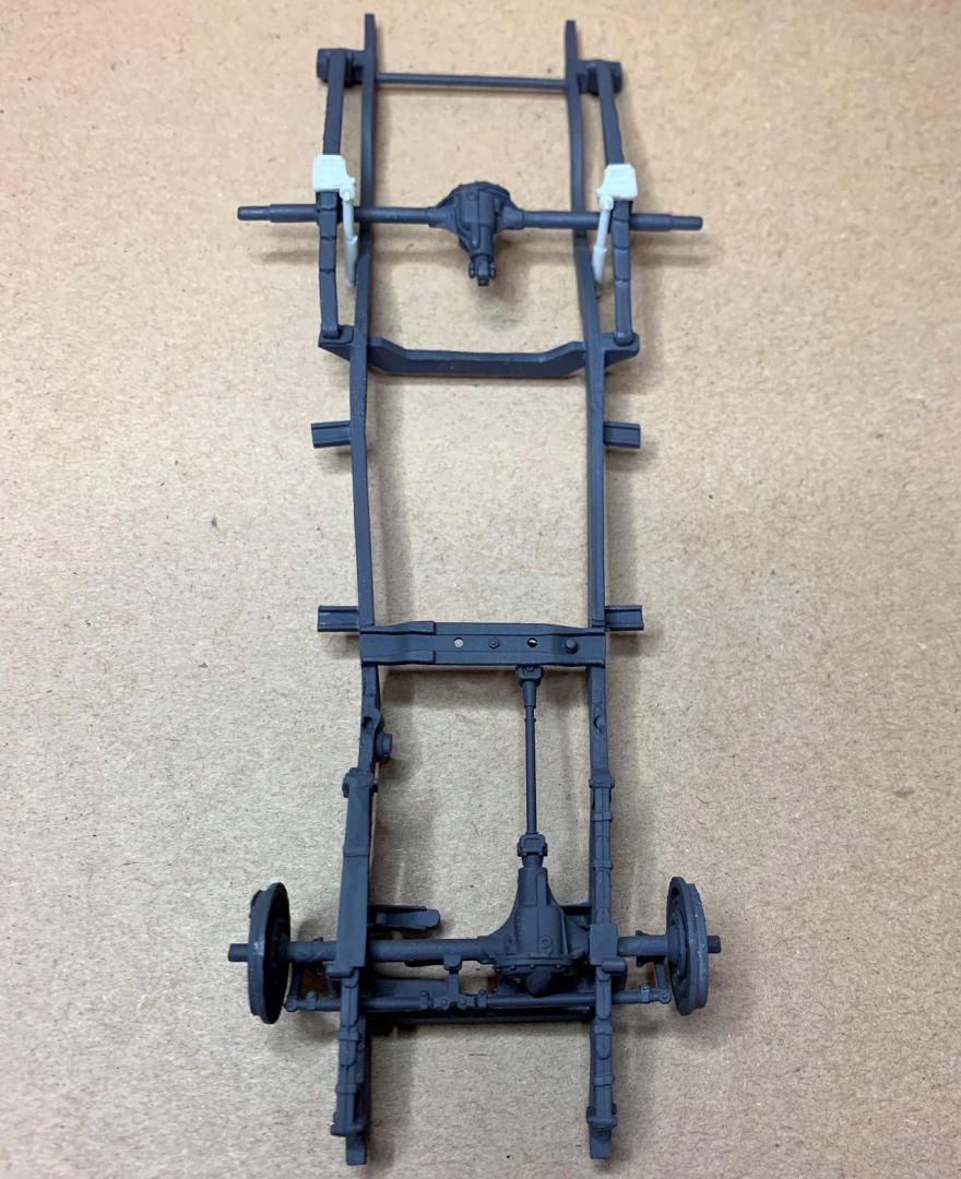

dino246gt Posted December 19, 2019 Author Share Posted December 19, 2019 I took a flathead straight six from a '41 Plymouth and began making it closer to the Hurricane Six from Kaiser! Cut off the bellhousing and added that, tranny, and transfer case from Hasagawa Military Jeep. Front and read axles are also from the Hasagawa kit. It all fits with a few mods, wheelbacks and rear shocks are from parts box. I made my own driveshafts, thicker than the kit ones. Quote Link to comment Share on other sites More sharing options...

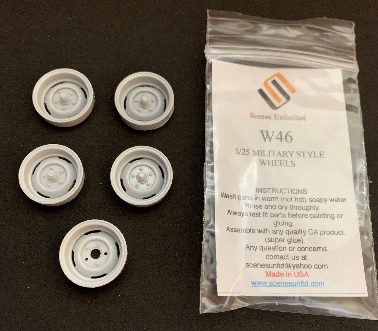

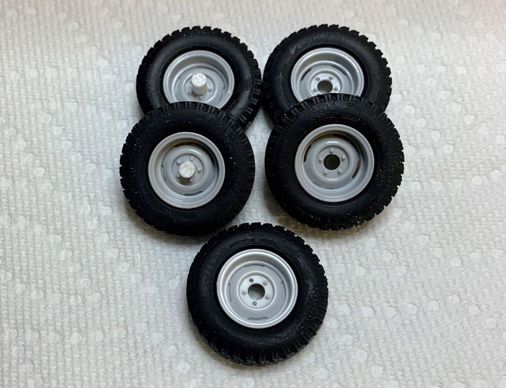

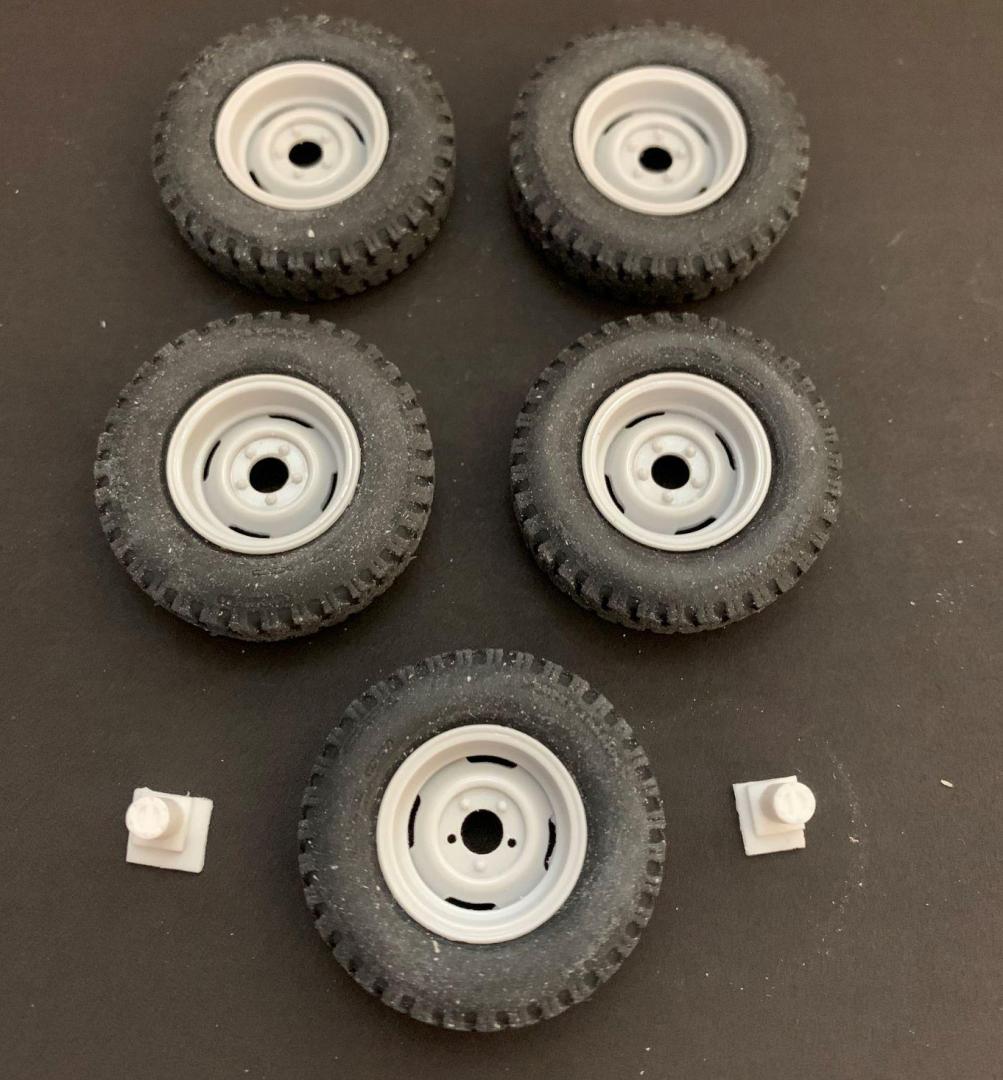

dino246gt Posted December 19, 2019 Author Share Posted December 19, 2019 So, the wheels are Monogram Land Rover resin copies from Scenes Unlimited but I drilled them out and used Fireball Modelworks resin tires, they're for his excellent F-250 conversion of Mobius 4X4 kit. He also sold me some Warn Free-Wheeling front hubs. Quote Link to comment Share on other sites More sharing options...

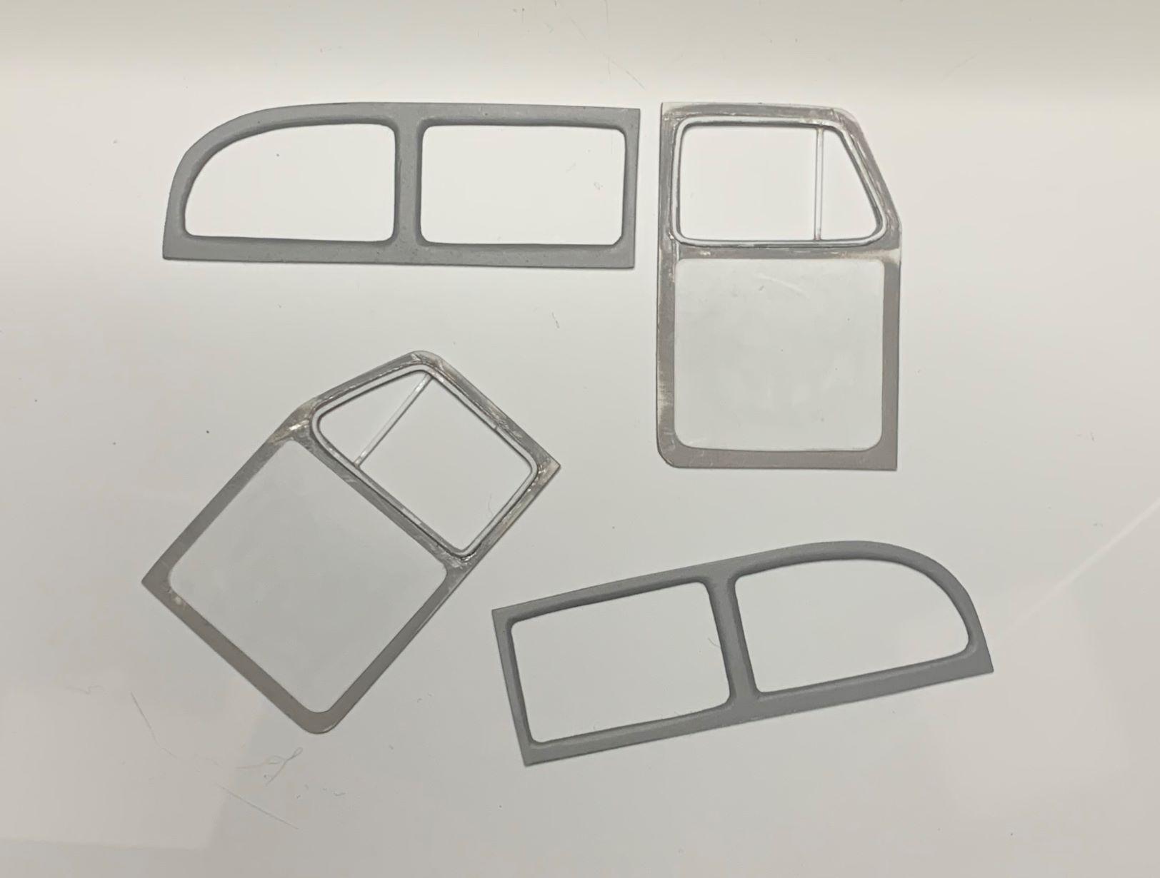

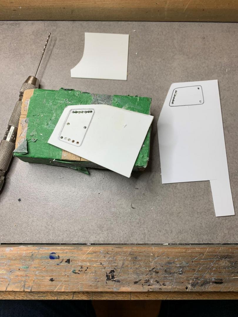

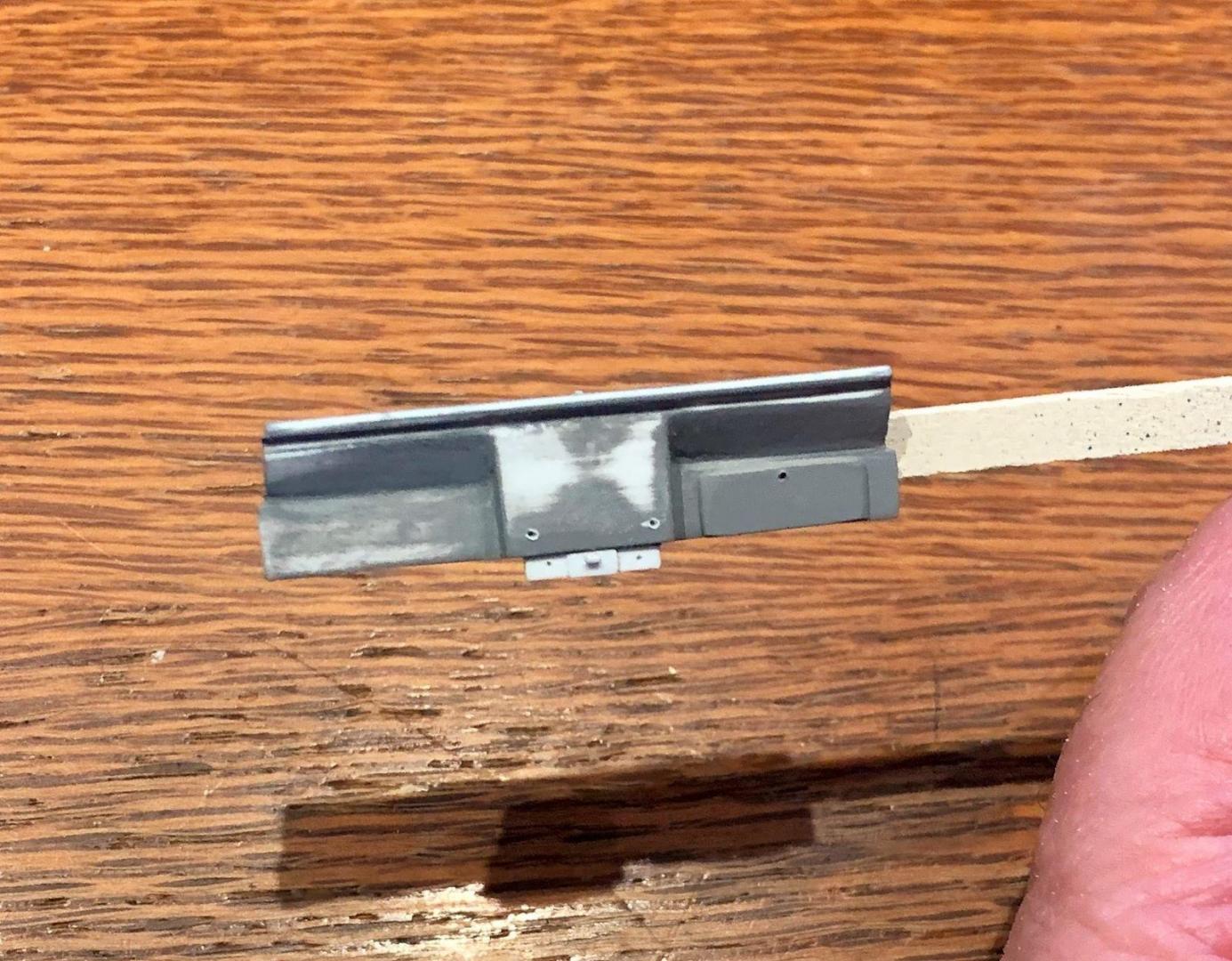

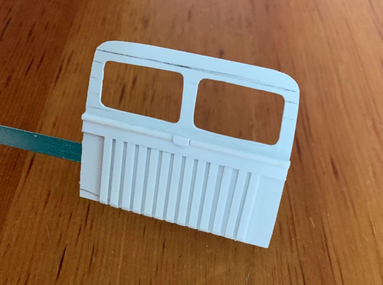

dino246gt Posted December 23, 2019 Author Share Posted December 23, 2019 Have to scratch build some interior for this thing, so here goes. First inner door panels and rear window surrounds. I had to cut nail file boards to fit inside so I could smooth out the resin. Sheet styrene is cut to fit and styrene strips wrapped around the door windows, then vent posts and door cards added. Dashboard shape was created with styrene, and an inner tailgate also styrene sheet with strips: Quote Link to comment Share on other sites More sharing options...

dino246gt Posted December 23, 2019 Author Share Posted December 23, 2019 Here's those parts painted, I messed up on the driver's lower, but it's hidden by the seat, so it doesn't need to be repaired. Here's those parts with the chassis and floor together. I cut three strips for each side below the window trim along each side to simulate the bare rear of the interior, of course they got painted to match. Sun visors and an inside mirror are there as well. Quote Link to comment Share on other sites More sharing options...

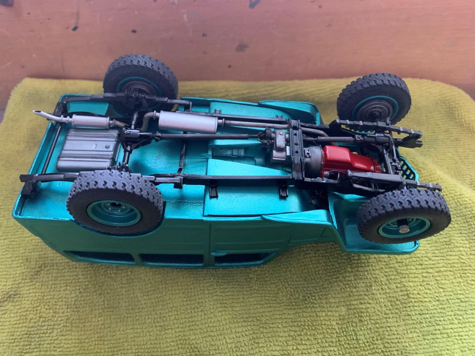

dino246gt Posted December 24, 2019 Author Share Posted December 24, 2019 Here's the chassis all together, still need to weather it: Quote Link to comment Share on other sites More sharing options...
