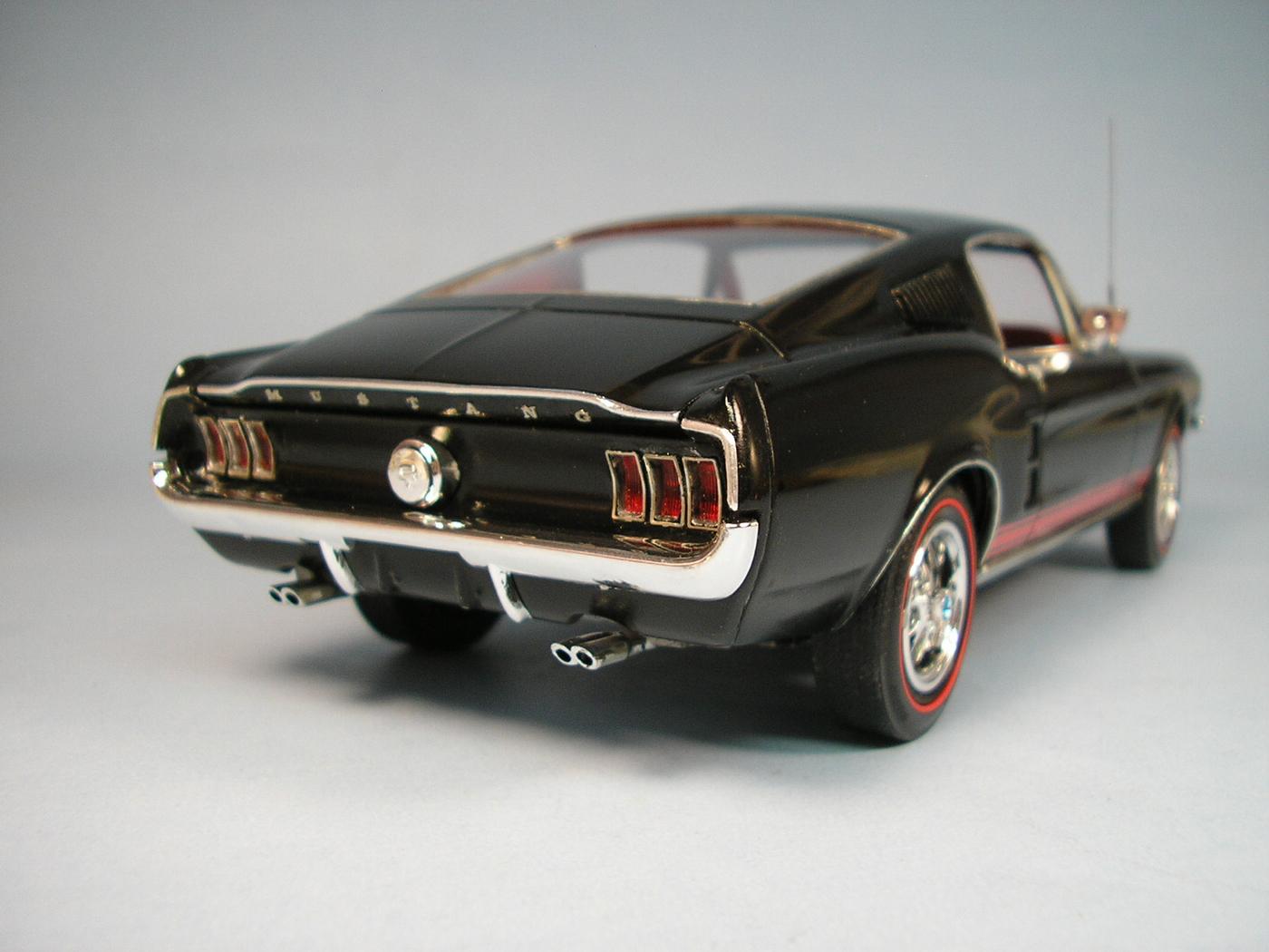

Ace-Garageguy Posted January 2, 2020 Share Posted January 2, 2020 This is as-delivered new. Quote Link to comment Share on other sites More sharing options...

MrObsessive Posted January 3, 2020 Share Posted January 3, 2020 When I built my AMT '67 Mustang, I remember that was one of the things I had to correct......the tail dragging stance. Part of the problem I learned is that the interior sail panels are not tall enough letting the rear part of the body sit too low to my eyes. I added some plastic to the sail panels to make them taller so that when it was time for final assembly, the car sat the way it should. Here's a pic of a "stock" '67........... And the model before final assembly............ After, with some mods done to the sail panels...... The '67 Shelby since it's based off essentially the same tooling, suffers from this malady also. Easy fix and it definitely helps the stance when done. Quote Link to comment Share on other sites More sharing options...
