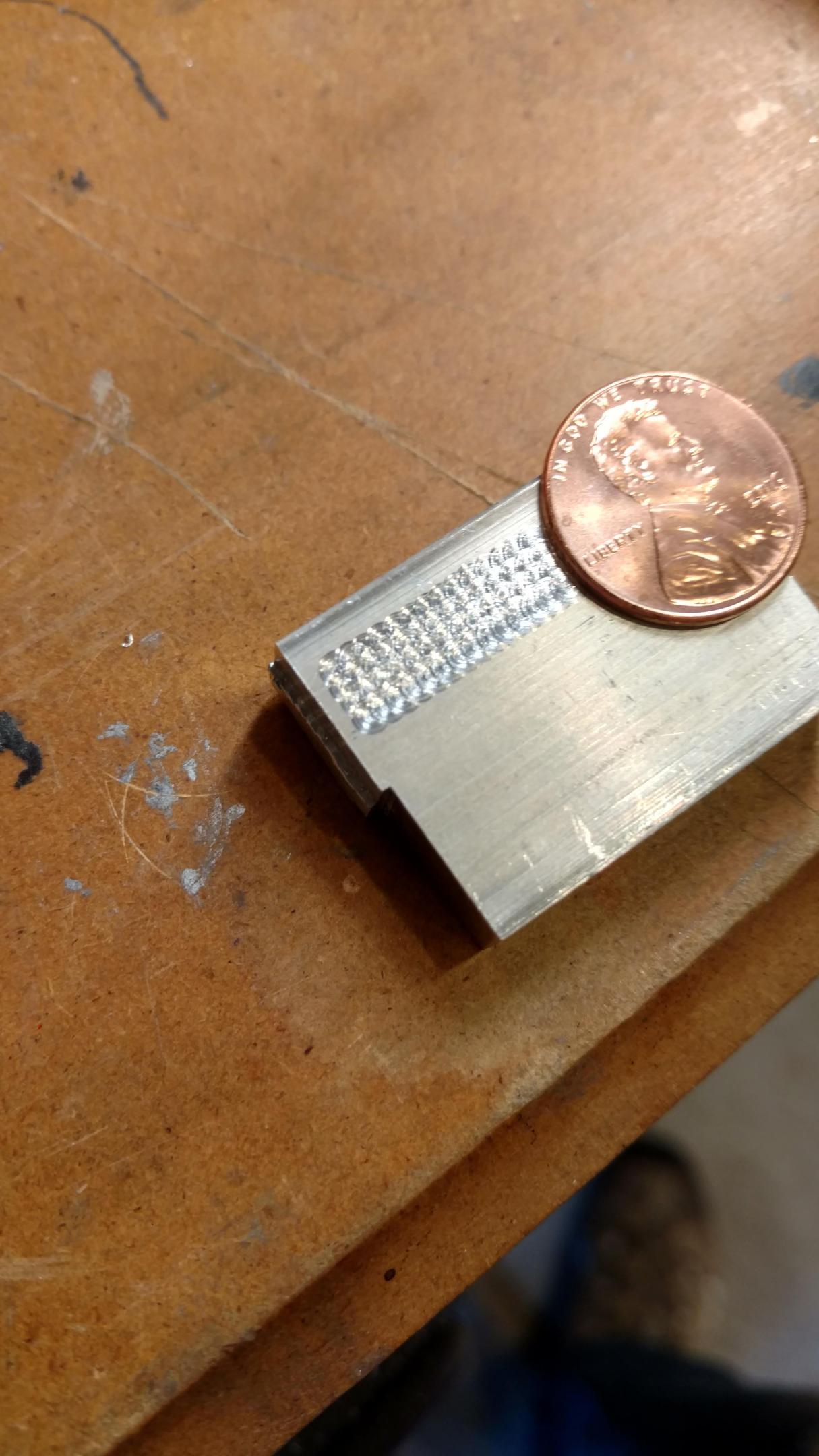

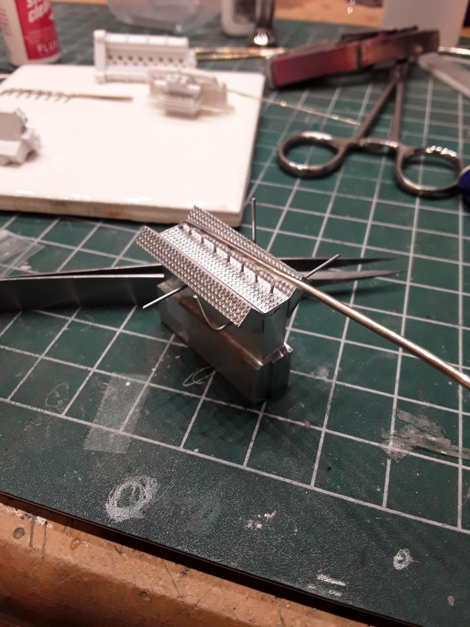

Pete J. Posted January 16, 2020 Posted January 16, 2020 Thought it might be worth showing you some of the stuff you can do with their equipment.
