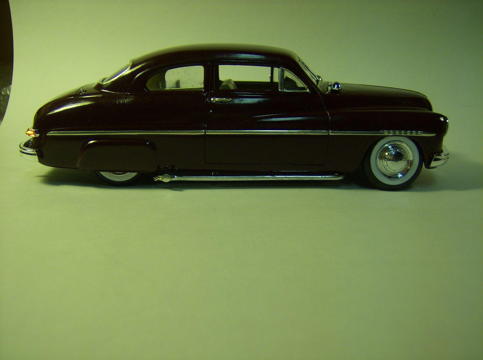

Ramfins59

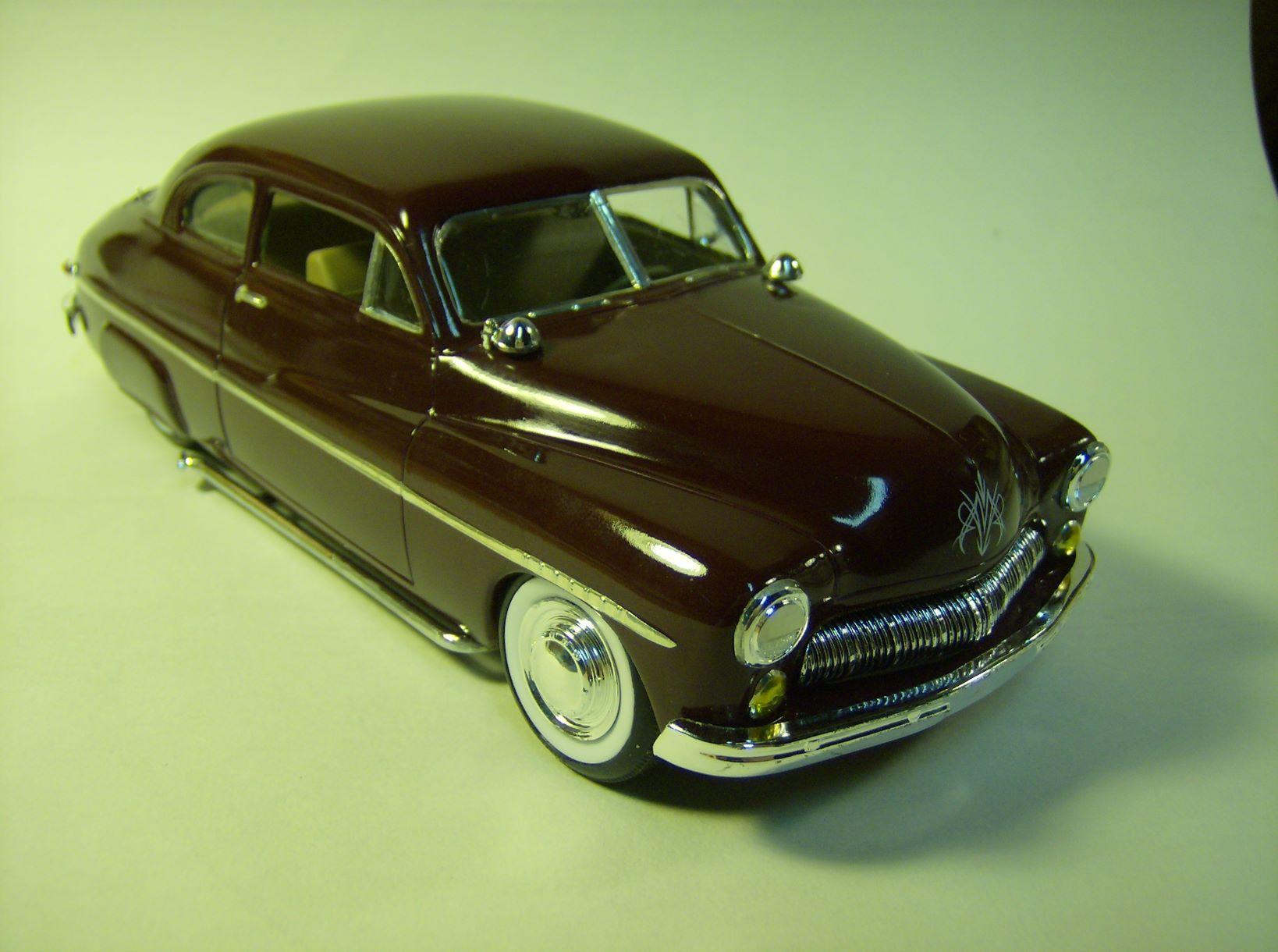

This time it's a 1950 Mercury done up as a very mild Custom.  I used the MPC Super Snap 1950 Merc kit.  It's a pretty rudimentary kit with only 26 pieces.  The color is Tamiya maroon.  I trashed the 2 piece plastic tires and used a set of whitewall tires from my stash, along with the stock hubcaps from the AMT '49 Merc kit.  I gave the grille a blackwash, added PE headlight half-moon covers from Detail Master and applied white pinstripe decals to the hood & trunk.  The lake pipes got PE flames attached to the end caps and I installed a sunken antenna on the passenger side rear quarter.  I gave the taillights a coat of Tamiya clear red along with tiny MV lens blue dots.  The outside mirror & license plate are parts box items.

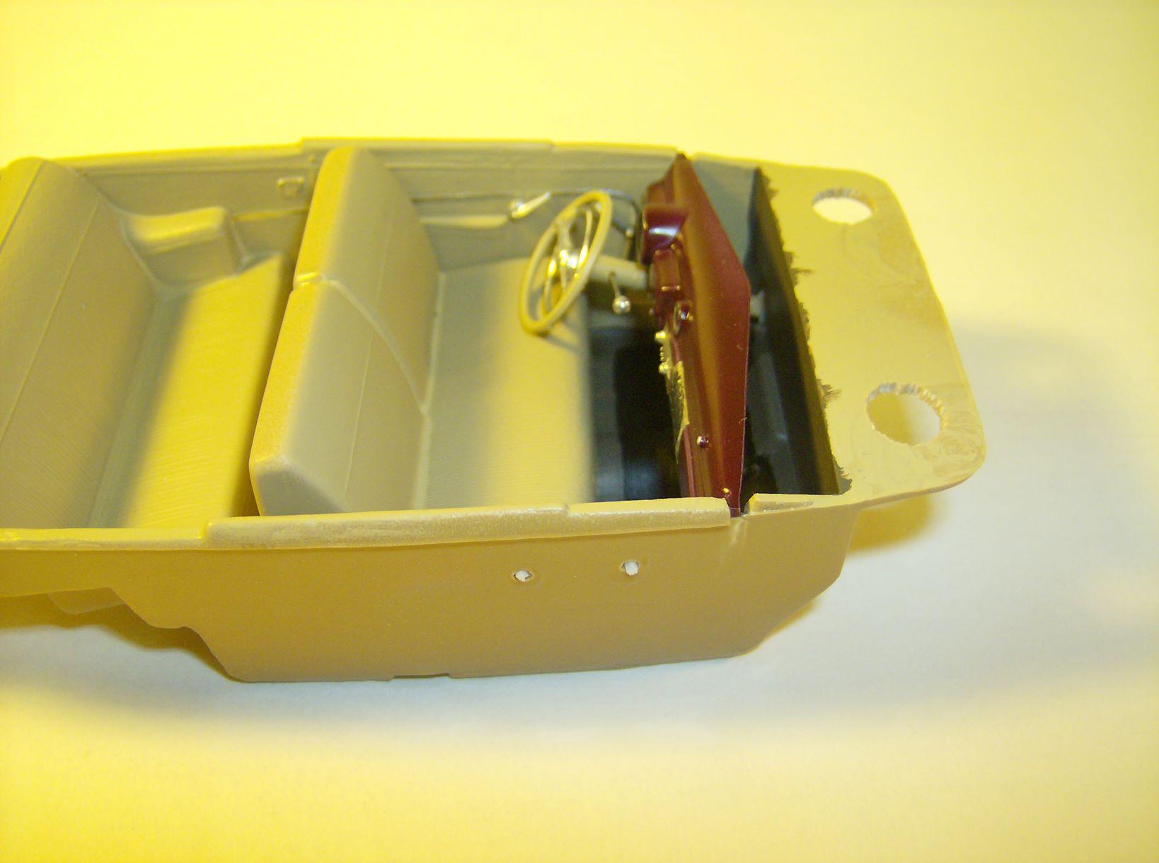

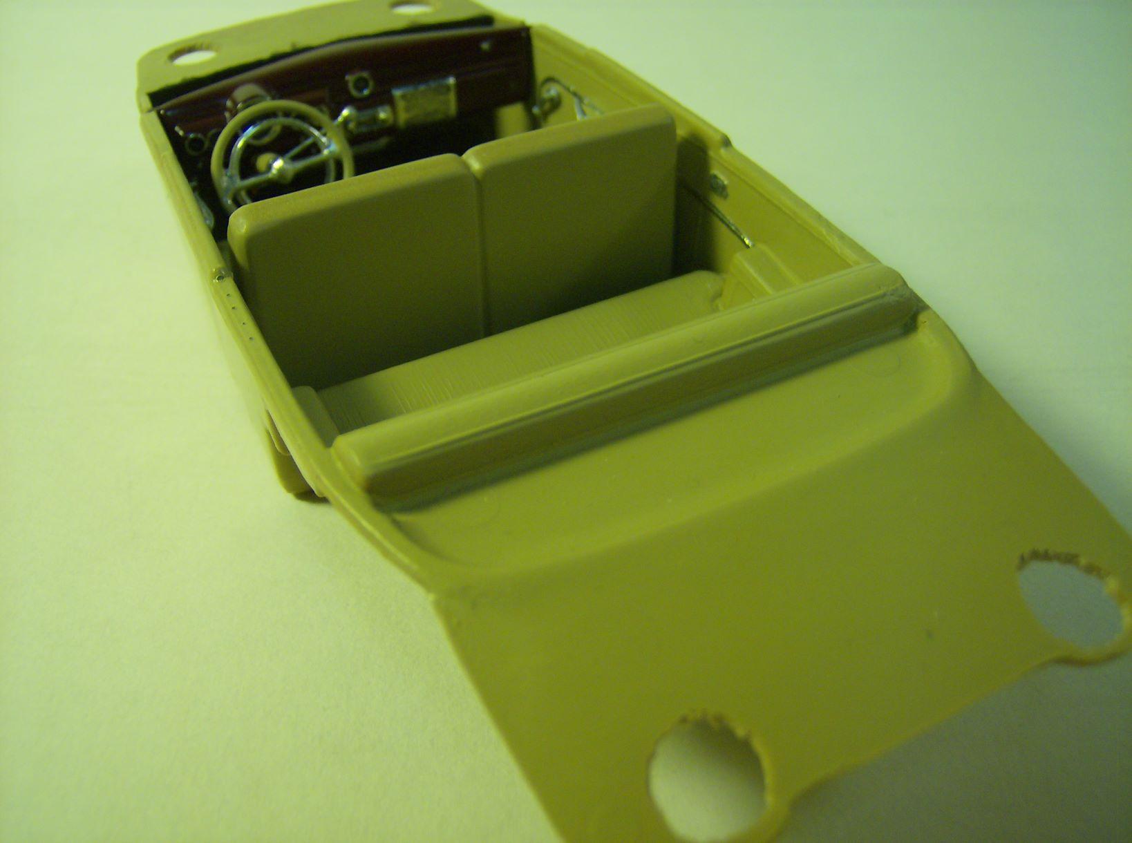

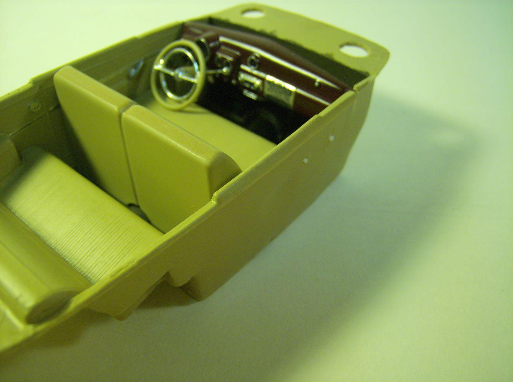

The interior was painted Tamiya light sand with brown painted "carpet".  Resin door handles & window cranks were chromed with Molotow ink and side trim was done with BMF.  The dashboard was painted body color with BMF & Molotow trim, and a piece of shirt pin was added to the steering column for a shifter.  I also added an interior mirror, visors and a dome light.
This was a quick and relatively easy build to add to my Class of '50 collection.
Thanks for peeking in on this.  As always, any and all comments are welcomed and appreciated.
Stay well all.
Rich

Nice looking Mercury.  The fit looks a lot better than the AMT kit.
There's not much to have to fit in this snap kit.  It's a one piece body with separate headlights, taillights, grille & bumpers.  The interior is 4 pieces that fit together well.

It looks good What is on the end of the Lakes pipes That is new to me.
Thanks Larry.  Model Car Garage makes photo-etched metal flame tips to wrap around exhaust pipe tips.  I cut small pieces off and CA glued them to the back of the lake pipe end caps.

Good work on your model Richard.
But this kit is a 1949 and not a 1950.
There are lots of small differences between them and one giveaway is the dash panel, on the 49 all gauges are round and the 50 has one large half round speedometer and the other gaugs are squared (the same dash was also in the 51) the rear glass was separated into three pieces on the 49 and was a one piece in 1950
The side trim is slightly different between the two years, the hood has MERCURY spelled out with separate letters on the 49 and a badge and a trim piece with MERCURY stamped in on the 50, the trunk badges are different, the door handles are different.
Here are some pictures to show the most significant differences.

Thank you very much for your information and reference pictures to show the differences between the '49 & '50 Mercurys.  Obviously MPC mislabeled their snap kit.  I knew that the '50 had rectangular front parking lights.
Link to comment
I had to go back and read the intro again, because I was also thinking this must be the AMT version. I had no idea a snap kit would look this good.
and how many fathoms deep, is that shine? Beautiful.
 I tried using blue dots from RMM, or was it Modelhaus.. anyway mine looked black, but yours look blue. Nice touch ?
