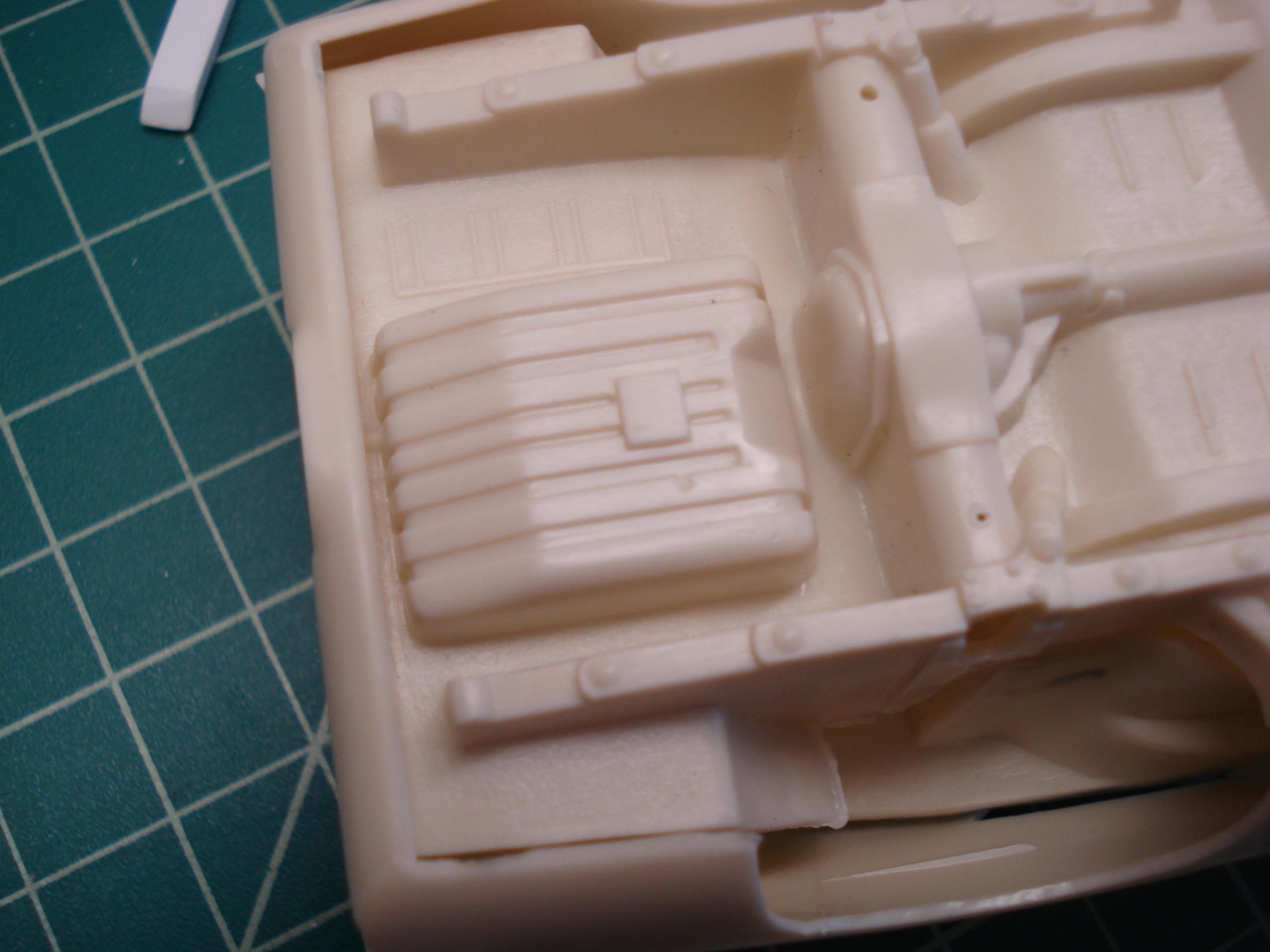

mustang1989 Posted February 16, 2020 Posted February 16, 2020 Here's a photo shot of mine after shortening the front subframe approximately 5/16" and cutting about 1/8" off of the rear of the chassis behind the fuel tank like John Pol was talking about. You've gotta shorten the chassis up front so it'll fit under the body nicely and to put the front wheels in the center of the front wheel opening.

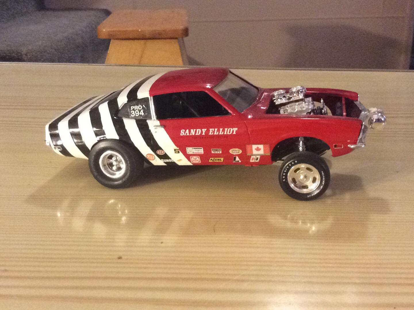

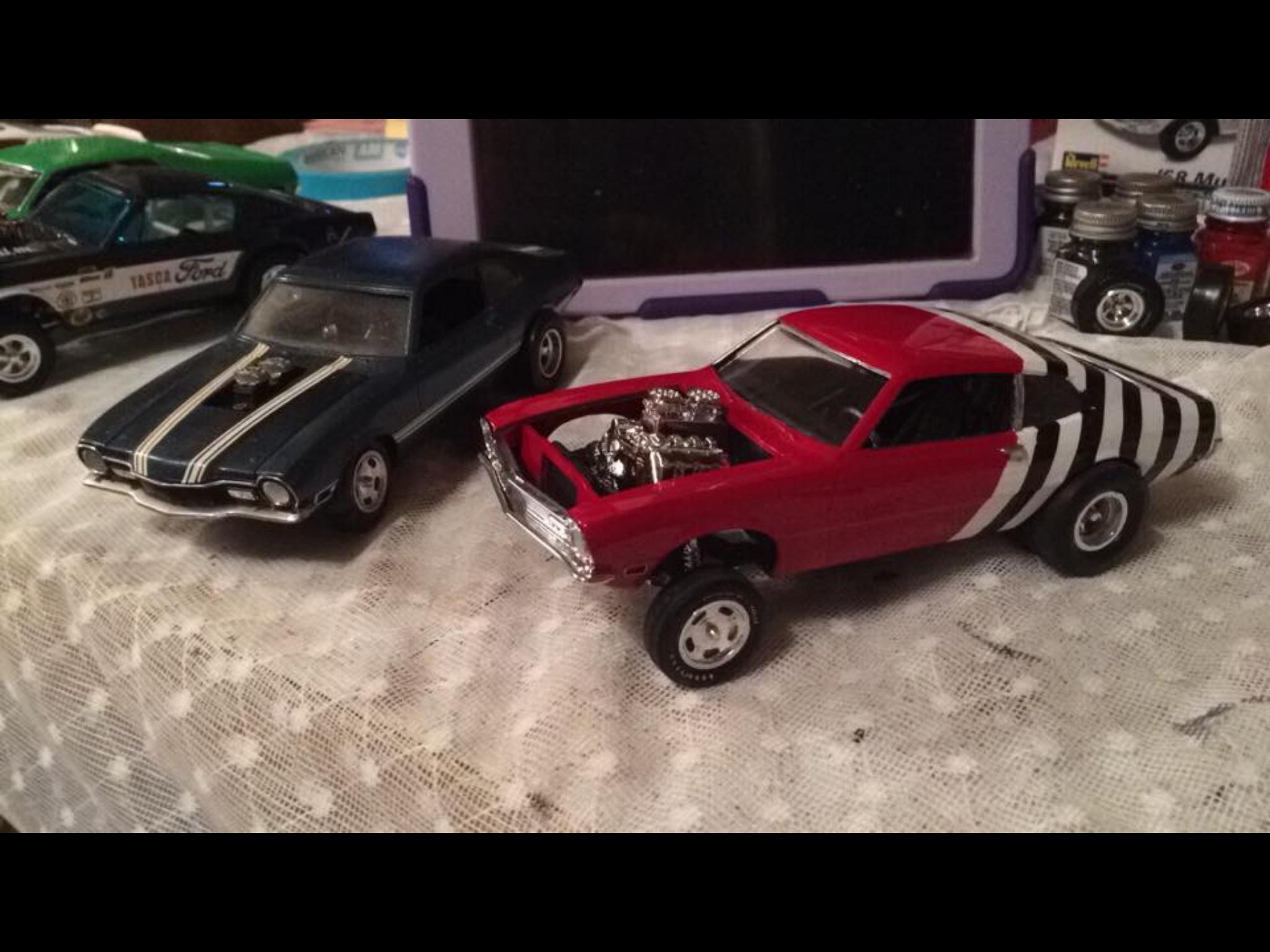

dragcarz Posted September 18, 2020 Posted September 18, 2020 On 2/22/2020 at 6:01 PM, AAFC said: Thanks to everyone for all the information. I have some decisions to make. I’d like to see a pic of the chassis after your mods. Your build looks great by the way.

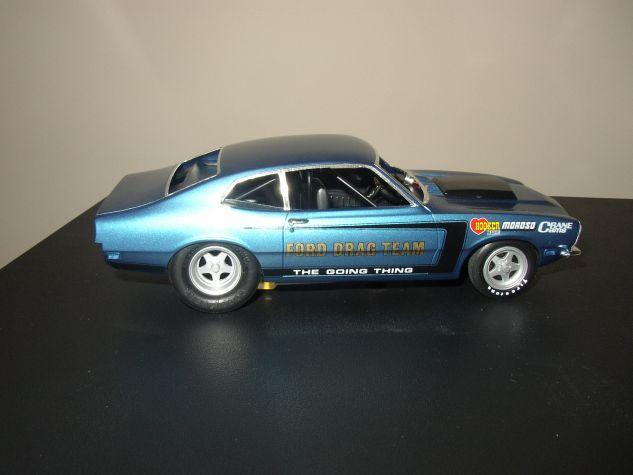

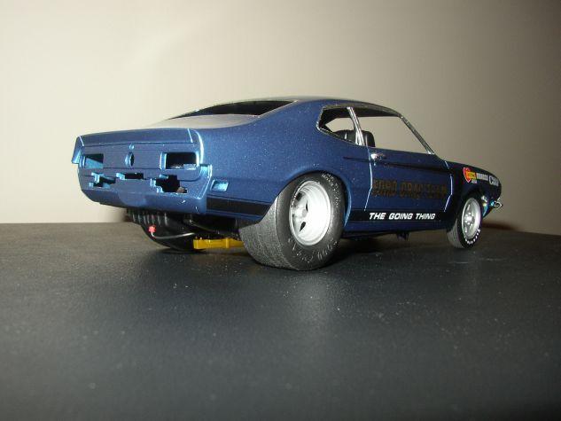

David Miller Posted September 18, 2020 Posted September 18, 2020 I bought both of these kits over 35 years ago . The blue one I built when new , the other just couple years ago . Looks good on my shelf , I don’t turn them over very often .
