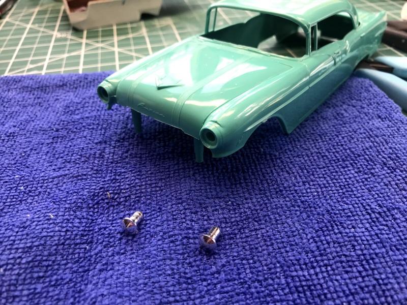

hedotwo Posted March 20, 2020 Author Posted March 20, 2020 I've begun a project of painting and detailing on this '56 Pontiac X-EL by dremel-ing away the hold down mushrooms and removing the headlights and glass. I'm now wondering if this is ABS or styrene. It seems softer than styrene and if it is ABS how will it hold up to any sanding I'll need to do? I might use a '56 Chevy Del Ray donor for the interior as it seems to fit decent, or cobble together something from my spares. Hate to steal the interior from an unbuilt Del Ray ?
SfanGoch Posted March 20, 2020 Posted March 20, 2020 There are no issues or problems sanding ABS. Medium-fine grit wet/dry paper is sufficient. As with polystyrene, exercise care not to overdo it.
hedotwo Posted March 20, 2020 Author Posted March 20, 2020 38 minutes ago, SfanGoch said: There are no issues or problems sanding ABS. Medium-fine grit wet/dry paper is sufficient. As with polystyrene, exercise care not to overdo it. I'm finding that out now. This stuff is really soft and cleaning up mold lines takes patience ?
SfanGoch Posted March 20, 2020 Posted March 20, 2020 If you have a combination scribing tool/scraper, lightly scrape along and perpendicular to/on the mold lines to remove them: and, if you have multi-grit sanding sticks, use the medium, fine and extra fine sticks to lightly polish the areas out. Bada-bing, bada-boom, mold lines in ABS gone.
hedotwo Posted March 20, 2020 Author Posted March 20, 2020 One thing I don't have a shortage of is tools ?. I'm good with removing mold lines, it's just the softness of whatever material this is. Around the headlight buckets is really tight and just need to go a little at a time. Thanks!
